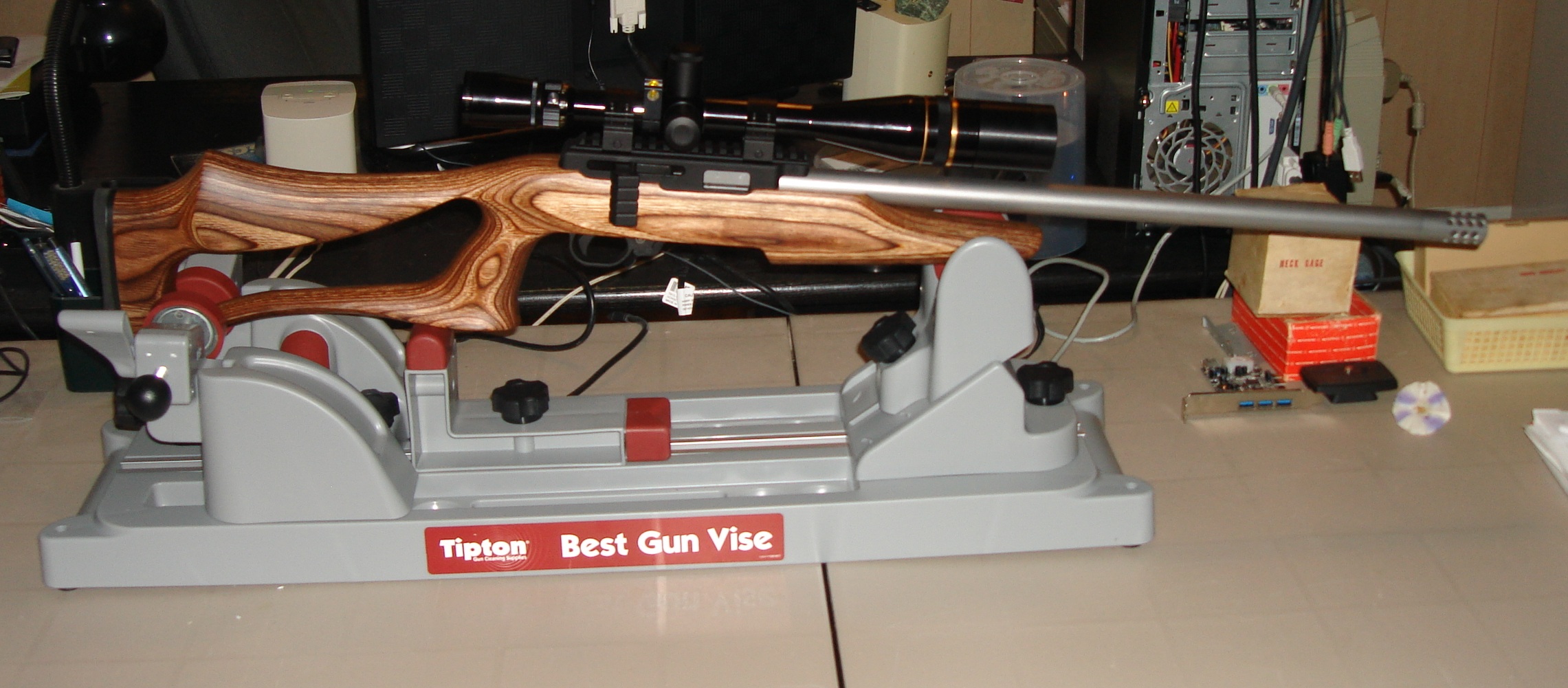

I bought the receiver trigger group and put it together with a KIDD barrel, I only got about 100 rds through it with the first 70 flawless before it began having fail to fire issues. Bolt face to barrel face has opened up to .022, apparently it should be .004 closed. At first PWS and Questar there Canadian importer tried to blame the KIDD barrel. Awaiting their resolution now. Ill update when it happens. Heres a pic of my completed project. Pretty disapointed right now.

I bought a brand new T3 complete rifle. It went back to the dealer for a refund after several months of issues, warranty, and less than good customer service. I have a post in this section about it. I've seen a few people say theirs shoots great... I'm curious what "great" is (group sizes). Mine shot terrible before and after warranty. And would not completely eject the brass at all. Just my experience. It is a really cool rifle though. Good idea and design. I wish mine would've worked out.
I have a rifle I build on the T3 Summit action. At first, my rifle shot terrible with many failures to extract and bullets simply not firing. Upon further inspection, I found that the bolt wasn't headspaced properly to the barrel leading to this problem.
I sent it back for repair and am happy to say the repair action has been flawless. I run a 1:9 twist barrel from Tactical Solutions and built my rifle to specifically shoot the Sniper Subsonic 60gr round. The grouping is pretty good. I get a 1" group at 50 yards. With a Thunder Beast Titanium 22LR suppressor screwed on, I have no POI shift and equally if not tighter groups.
