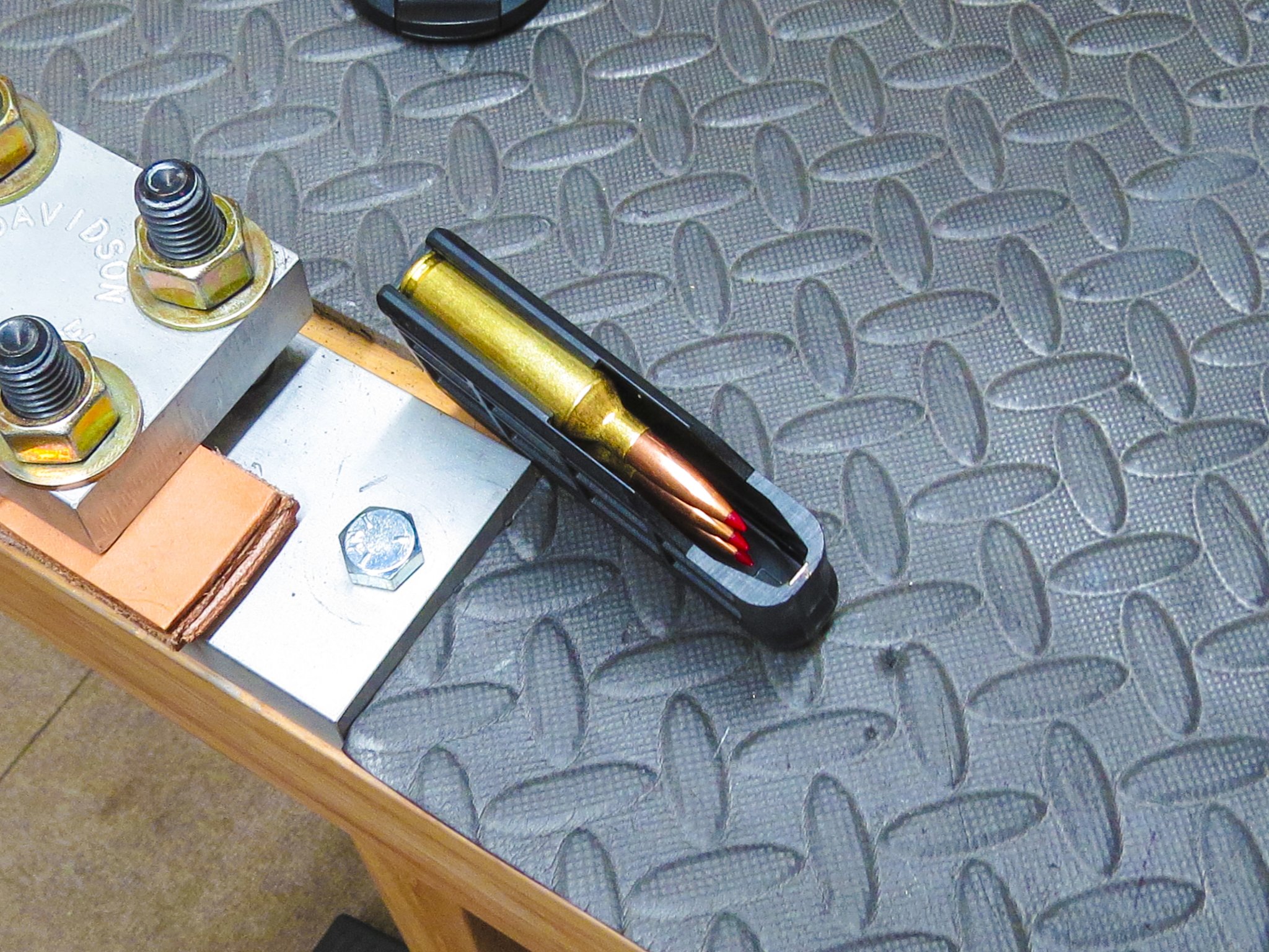

Yes that's it....
Been using factory plastic for 2 years now.
3 in the mag and 1 chambered.

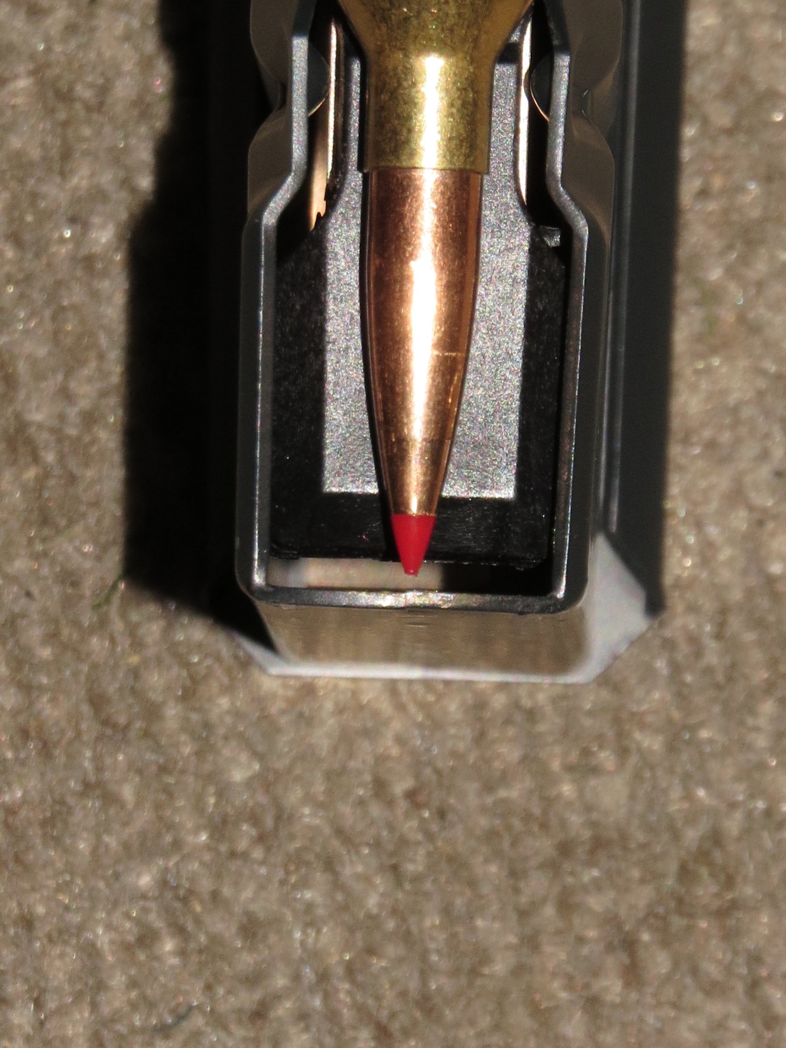

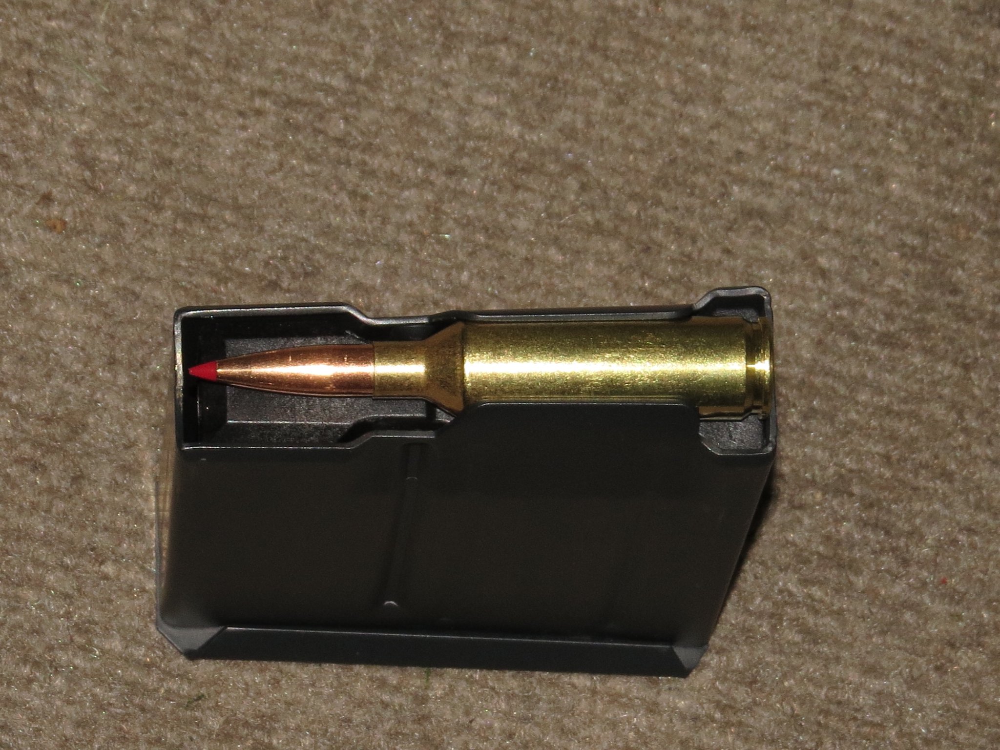

This is for the MDT....
Your COAL is listed wrong it should be 2.955 on the WSM which is listed without the binder plate.
They list the .308 without the binder plate 2.960 which is what I use on my LSS XL gen 2 short action I bought for 6.5 CM and there is no wiggle room at all when I switch over to my 6.5 PRC barreled action but the .308 mag works fine with the PRC and no adjustment to the feed lips for me.
If your wanting to get out longer you'll need to go long action which is listed 3.56 mag length for their Tikka actions with a COAL of 3.47
This is what the .308 without the binder looks like with the Hornady PRC 147 ELDM loaded.
Reactions: drew_235
