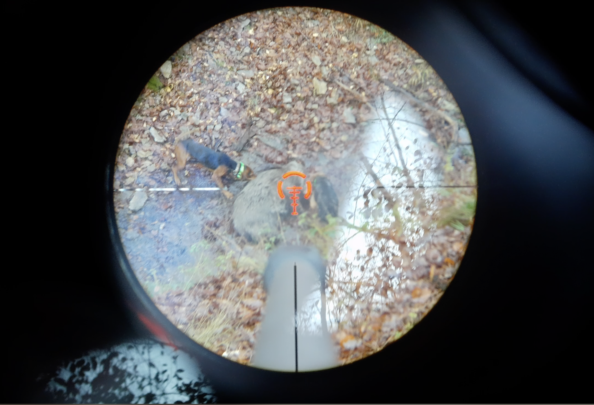

I'm having issues with reflections "bleeding " into the playback. I have an Athlon optics Midas TAC scope. Ive heard that the light is "leaking" into the FTS at the split where the two screws tighten down.
You can see this aberration in one quadrant of the videos.
I'm thinking of purchasing one of these, but would like to see a pic of where the light is leaking in. Hopefully fixing it is only a matter of tightenin down a couple screws. Does this occur all the time or when shooting with the sun at a particular angle?

I believe that the problem with light leaking is not related with the gap between the screws of the mount, but mostly with the light which is captured backwards from the ocular glass by the mirror prism inside the mount. This problem is almost always apparent when the rifle's muzzle is pointing downwards and the ocular piece of the FTS is pointing into the sky. The light gets caught within the FTS and it is reflected by the prism, eventually captured by the camera itself.
I hope that the posted image is clarifying. This rifle is pointed towards the ground from a higher position. The reflection of the surrounding trees is captured into the image:
