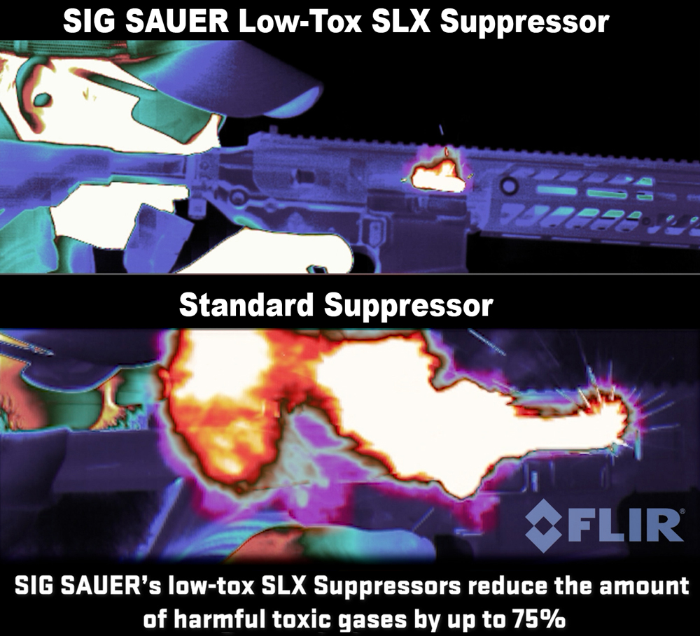

Look at one of the new Sig SLX cans. Either QD or direct thread, they make several sizes and were developed for a military contract, with flash suppression (using a flash suppressor end cap) and their biggest feature, up to 75% less back pressure due to their 3D printed baffles.
I currently use a Sandman S on my 11.5 MCX and am seriously considering one of these as a dedicated 5.56 for that gun.

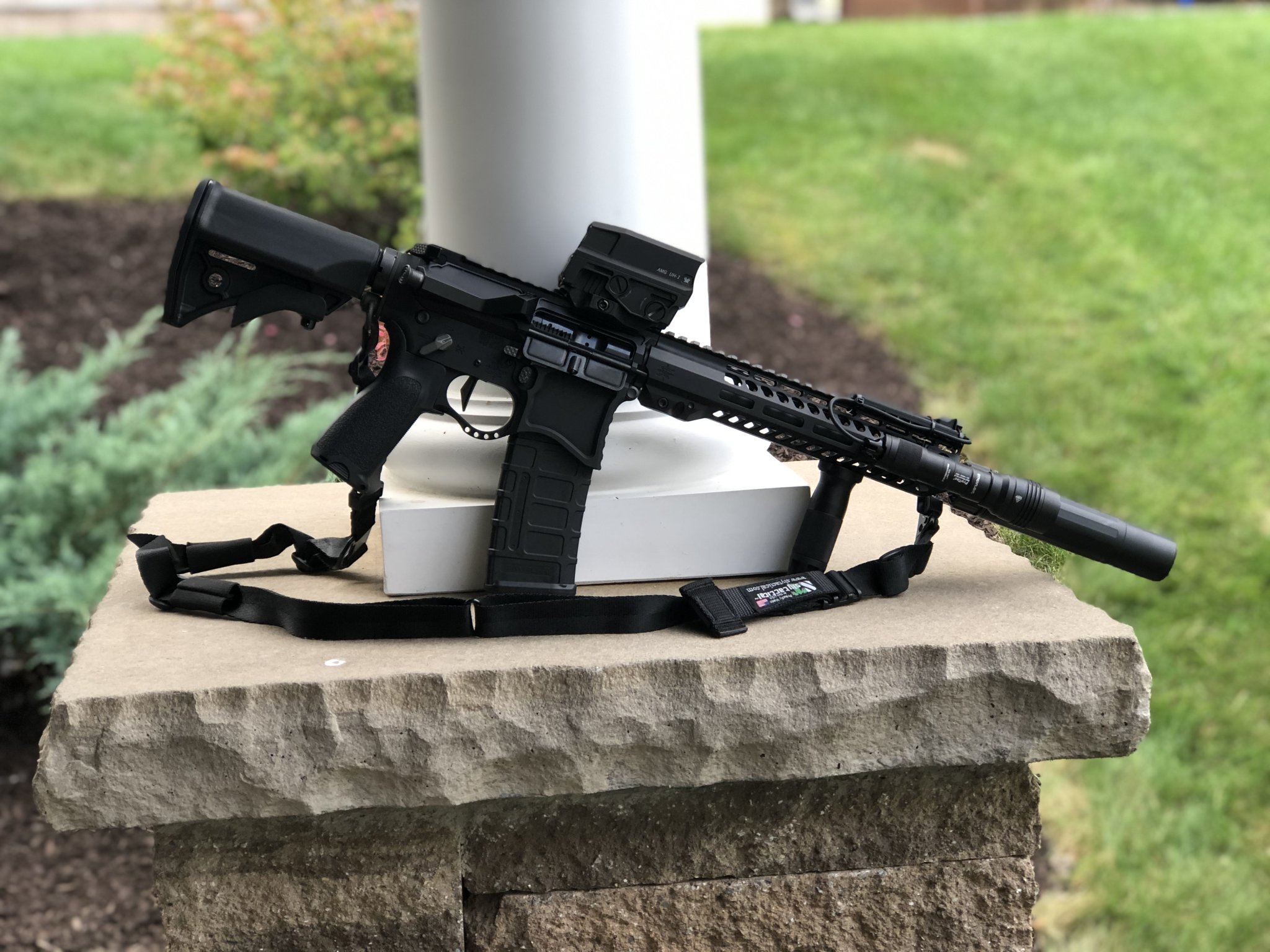

Here’s my Sandman S on my 10.5 SBR. The gun feels extremely small and nimble when maneuvering. Not once have I felt the need for a K can. I just can’t imagine it feeling obnoxiously long with a 11.5-12.5 barrel.
