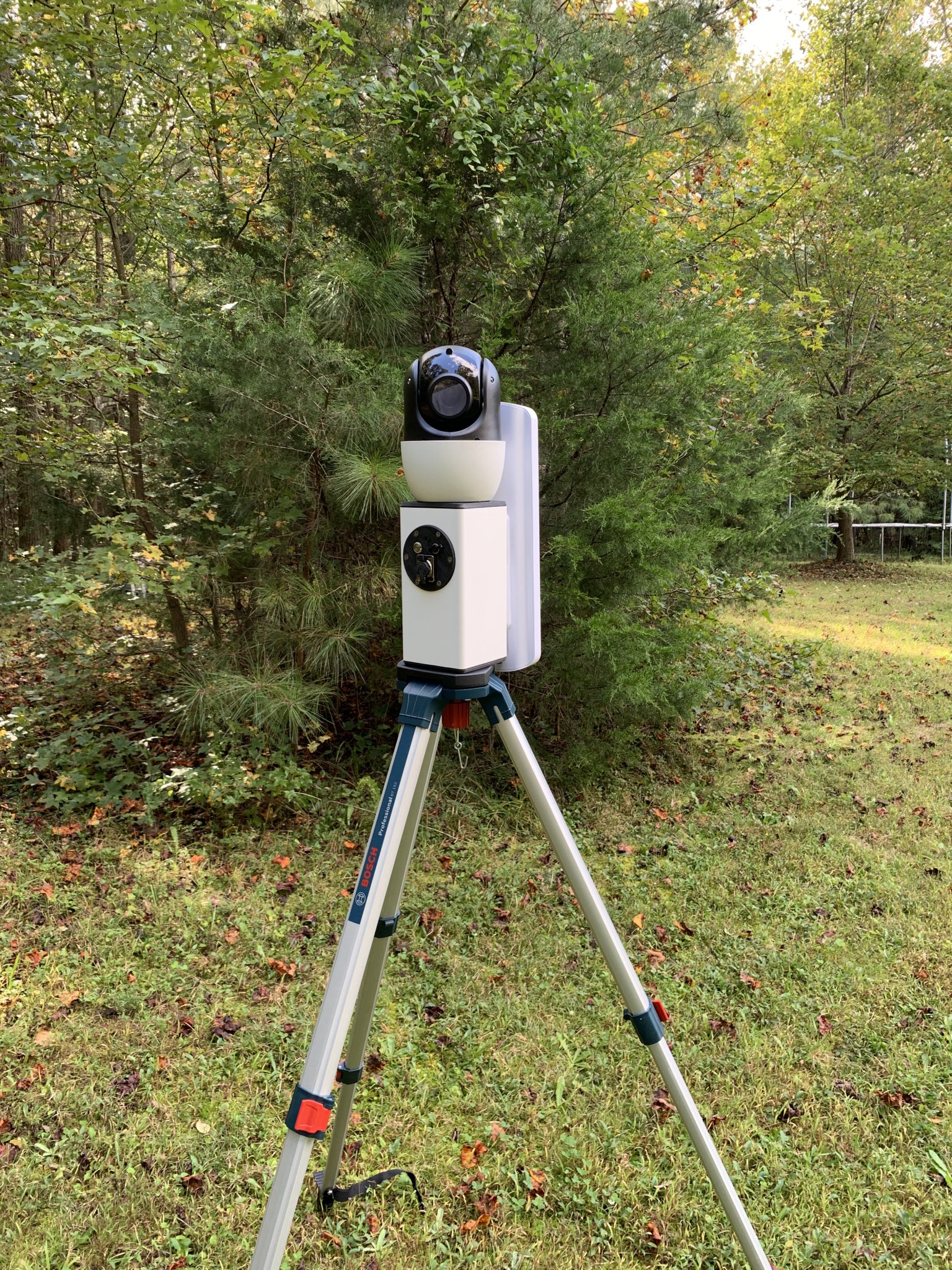

Cameras aren't an issue... I make these specifically for ELR matches. Gives us enough zoom to place the cameras well out of the danger zone and they have very low latencies so we can get shooters hit/miss feedback as quickly as possible. Audio feed gives solid feedback and makes watching the feed a lot easier. Not entirely sure how far out they will link up, I haven't tried them passed 4 miles but in theory they should work out to about 11 miles.

Not every venue has internet. Some I've been to you'd be lucky to get cell coverage. Especially a couple thousand yards down range.
-Alex
These things were great to watch at Black Bear. Wish all venues had them.
there's this baby...
Where I shoot they use the SME Bullseye system out to 2k and it's fantastic. Video, screen shots etc. Crystal clear and I'm not a huge tech maven, but it's made shooting longer a ton more doable since the berms are constantly soaked.....even 338 is just digging bug holes with south Florida summer rains every day. Streams to iOS and Android....phones....tablets....really pleased with it.

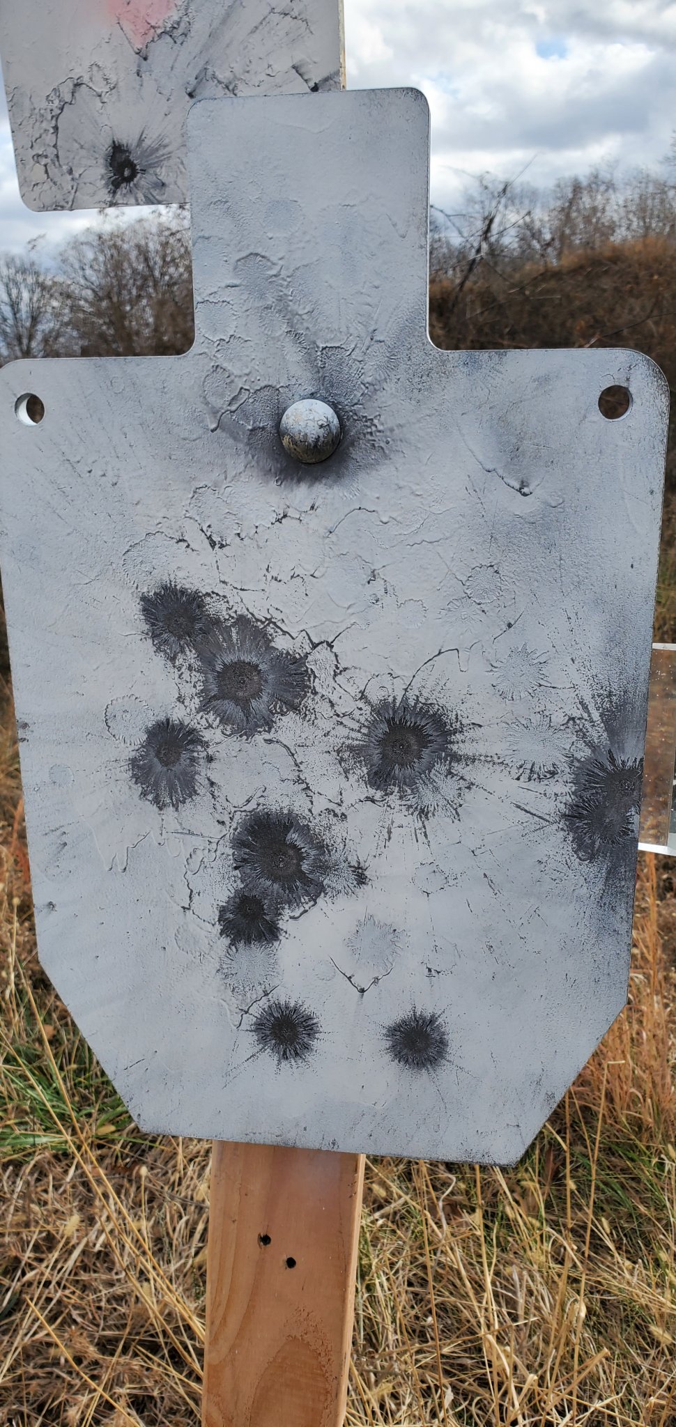

We have 2 MOA plates (square) with 1 MOA hole in the center with a hanging plate behind it. It's a pretty simple concept and it can accommodate shooters with different levels of skill.
I really like that idea.
At the 1 mile match I go to I want to say it's either a 36x48 or 48 square. I got 2nd round with my 6.5 creedmoor and 135 atips. There were some guys slinging 338 lapua and 300prc that missed all 10

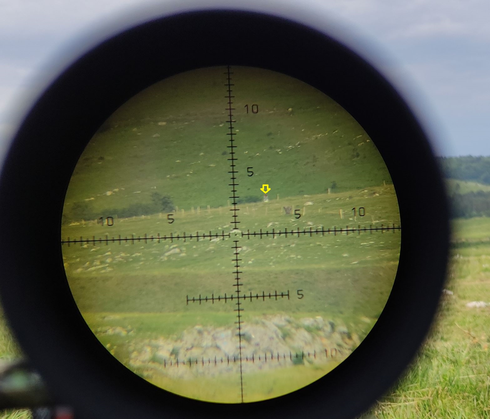

Practical sized targets so Full IPSC or military style 100x50cm torso plates ,if nothing else who wants to lug more steel around.
Worked well on 1100, 1530 and 1590m but got very tricky at 1790m(cca 1950Y) with .284Shehane tactical rig frst and second round hits on the first three then needed 15 rds to land a hit on 1950Y
1790m target in question.
