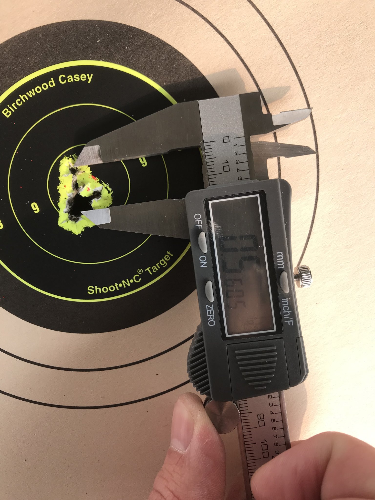

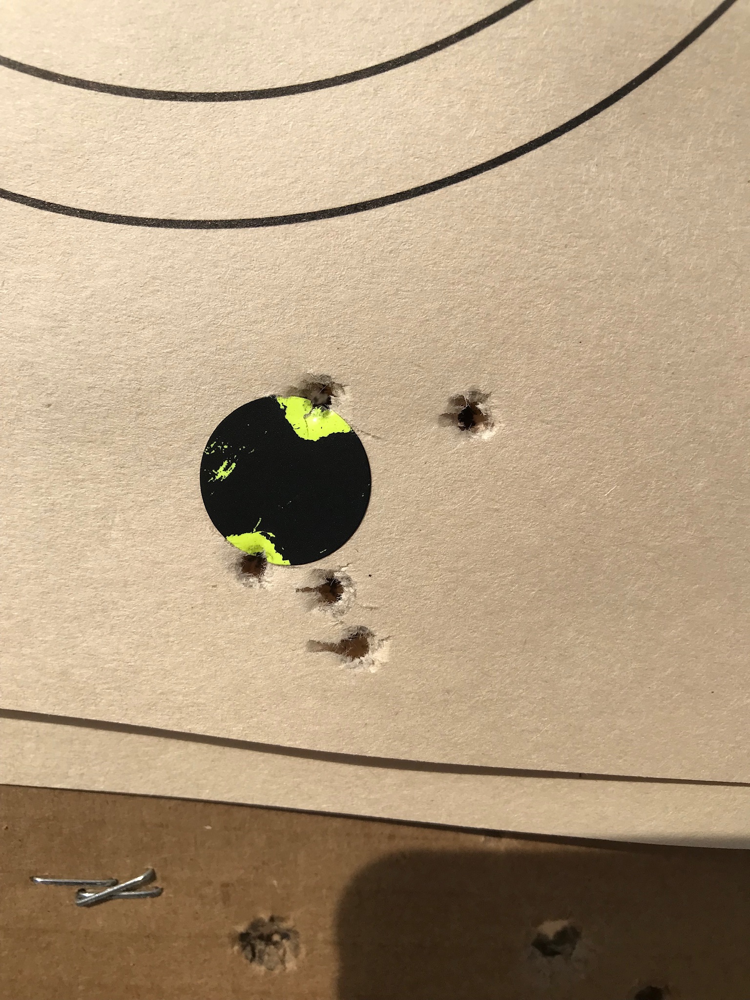

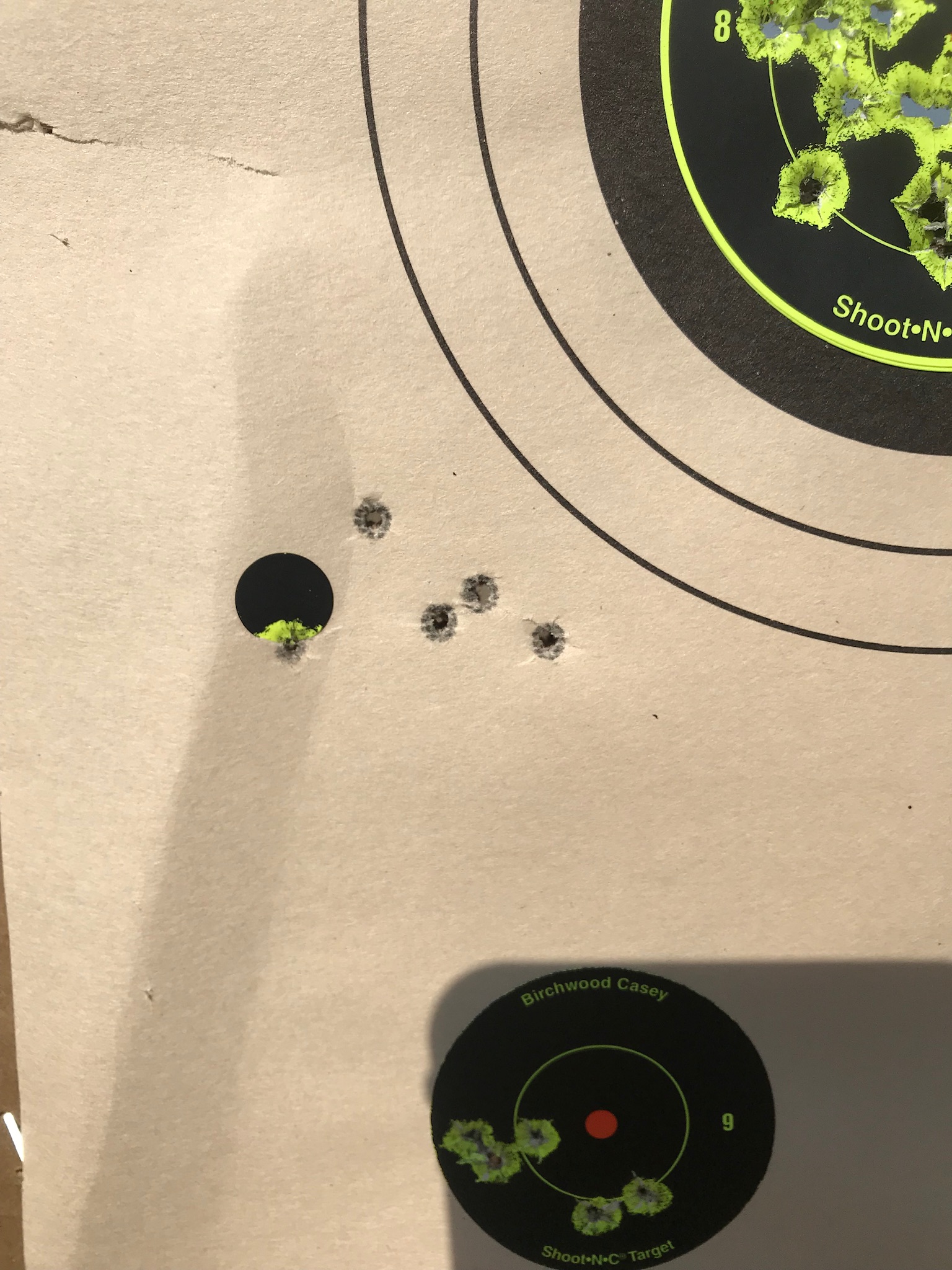

Average for first 100 rounds @ 50 yds was .49" using Federal Gold Medal Target (mostly 5 shot groups). 10 shot group also measured .50" exactly.
Here is ammo test:
First three groups of each ammo are 5 shot groups and last is a 10 shot group. Shot at 50yds prone with rear bag and bipod. Super calm conditions until about halfway (Eley Target and lower groups) and wind began drifting left to right slightly. Quarter in middle for reference.
  • Fed AutoMatch .66" best/.72" avg/ .94" 10 shot
  • Fed GM Target .31" best/.64" avg/ *.30"* and .75" 10 shot groups*
  • Fed GM HV Match .29" best/.37" avg/ .51" 10 shot
  • ELEY Contact .8" best/.84" avg/ .73" 10 shot
  • Eley Edge .34" best/.61" avg/.49" 10-shot
  • Eley Force .74" best/.61" avg/1.09 10 shot
  • Eley Target .37" best/ .56" avg/ .47" 10 shot
  • Eley Tenex .35" best/.49" avg/ .53" 10 shot
  • SK Std Plus .44" best/ .69" avg/ .66" 10 shot
  • SK Rifle Match .27" best/ .44 avg / .36" 10 shot
I pulled one round out of each 10-shot group when measuring for a very specific reason. I've found a very high correlation between shooting (3) 5-shot group avg and measuring 9 of 10 shots in terms of predictability. Usually within .1" or better of avg 5 shot group. Have run this test twice (factory barrel and this barrel) and most groups bear this out. Also, only shooting 25 rounds of each ammo back to back doesn't seem to allow the barrel to acclimate to the new ammo as well as say 50 shots then measuring groups for next 25-50.
Also, I wasn't happy with the first 10 shot group with FGM Target so I reshot at the very end because something seemed off during first group. It fired a near perfect circle that measured .3" and 10th shot jumped out group by .25". Making it the best 10 shot of the day except for SK Rifle Match.
