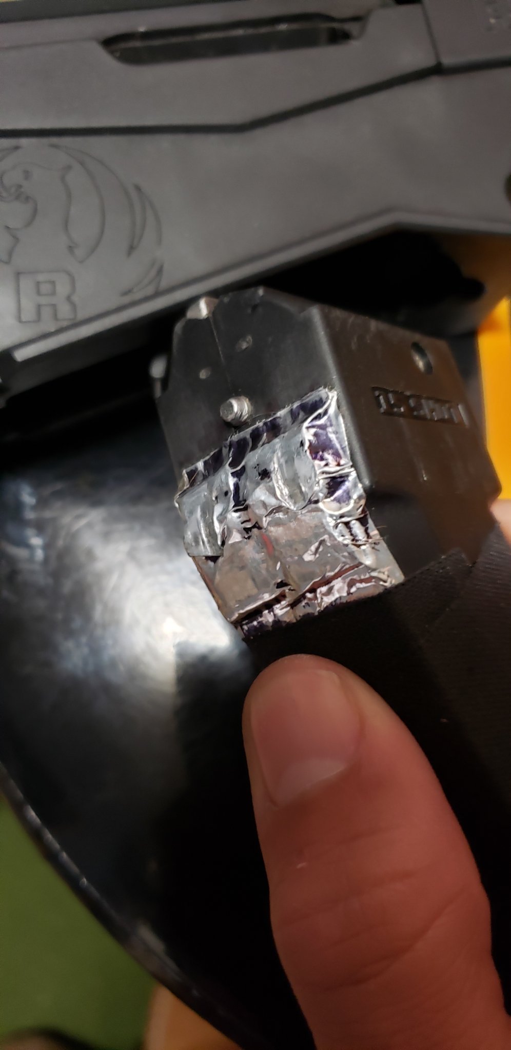

Have any of you guys with the Shaw barrels had feeding issues? mine just will not feed any types of rounds i have to slam the bolt basically every time and i know the edge of the barrel cuts the round so its probably messing with the accuracy big time. Also, i know these are notorious for extracting which mine was but the new barrel made it 10 times worse. half of the rounds get stuck in the chamber and the other have barely extract. not sure if it needs shimmed or what the heck the deal is but its frustrating. I've emailed Shaw about it twice and have not heard back. pretty disappointed if I'm honest. Thought a 280 dollar barrel would make life easier not worse.
No feeding issues at all with mine. I get an occasional an un-extracted case every now and then with federal am but that’s it. May want to check your mags to make sure the round isn’t nose diving into the chamber. I bought a Kidd SS plunger and high tension mag release spring and there is no more slop in my mags and no nose diving.
Yea it does that with all of the about 10 mags i've got for it. i talked to the folks at shaw and they're going to take the whole gun and fit the barrel to the bolt and receiver. will update once i get the gun back. I'll check out that stuff from kidd. thanks for the input.

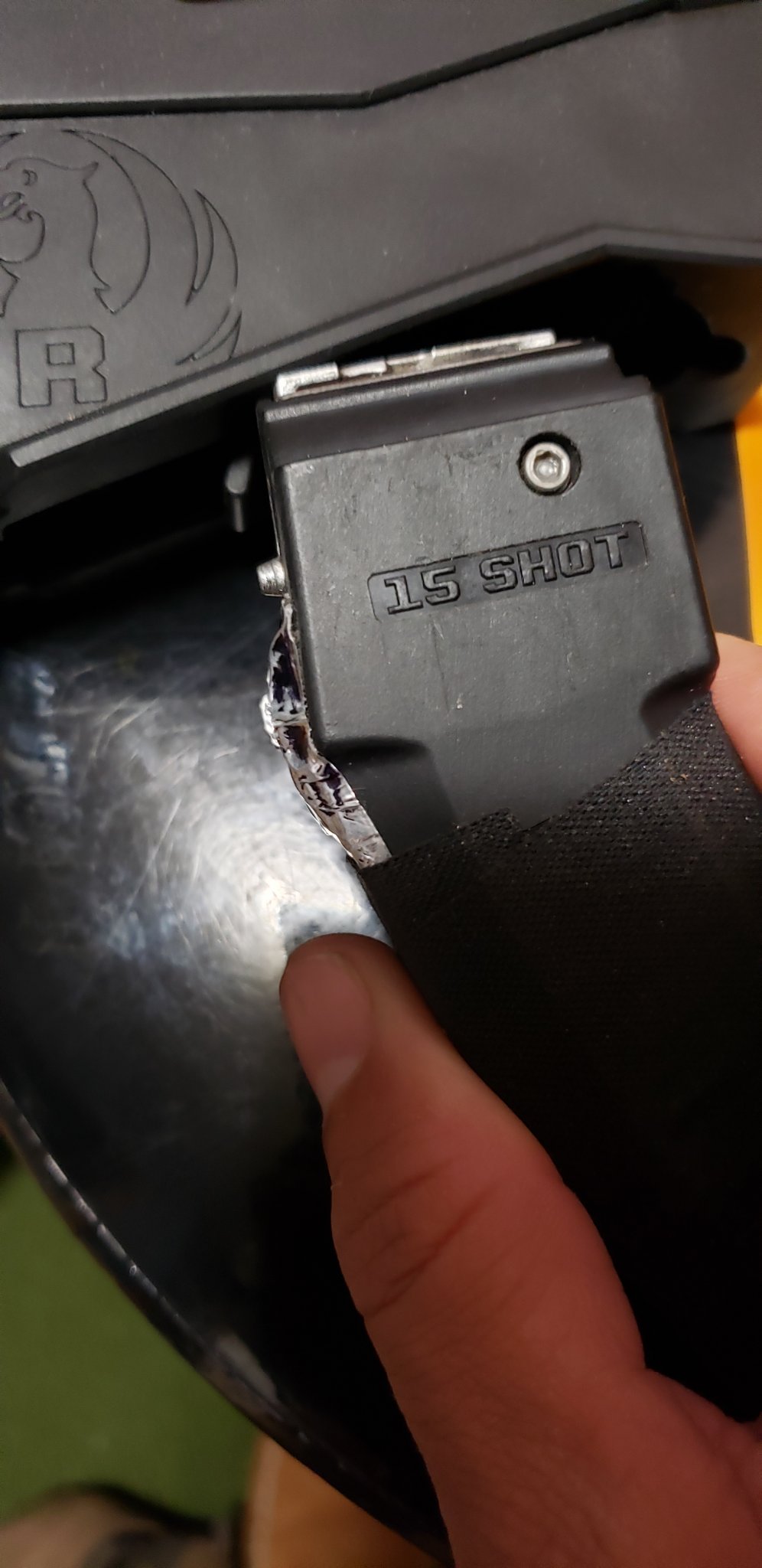

The only feeding issue I really had when I installed my Shaw barrel was how hard it was to close the bolt. I thought that might go away after a while, but it didn't. Because it was closing so hard, it was also hard to unlock, causing me to break my cheek weld. So, I put a shim in to take up about .003 using some aluminum foil. Now the bolt cycling runs as it should and I can cycle it without having much movement of the rifle. The cartridges feed just fine and when extracting an unfired one, my barrel leave a rifling impression on the bearing surface (as match barrel's will do). Using cartridges designed with a larger diameter (like all Winchester's), get stuck in my chamber whether fired or not, not I'll never use them in this gun (though this wasn't a problem with the factory barrel).

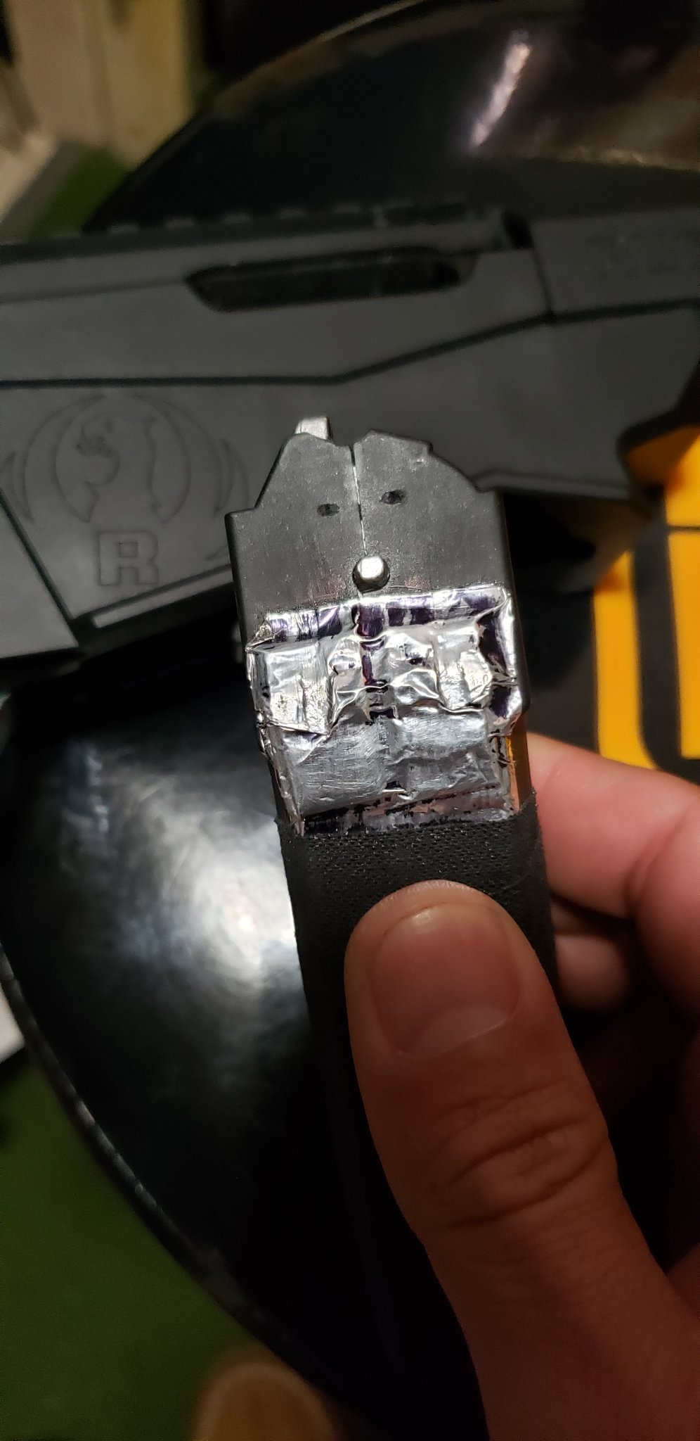

When I saw your solution in using the Kidd plunger, I was about to go that route. But first I deiced to put a shim under the mag assembly (where the bolt fastens to the lower receiver) in order to raise it and get the mag to function as it's supposed for ejection. It worked and the mags now not only are ejecting the cases but the mags are held much more firmly and not requiring a higher tension spring. All's good now. :)
Thats interesting. i'll have to try that
I cut them out of some aluminum foil from my kitchen (from heavy duty foil I had, though still pretty thin and requiring more than one piece).
Awesome. thanks for the info.
I had intermittent feeding issues (usually first round only and only occasionally) but I tracked that down to magazine fit/placement. If the bottom of mag gets tipped forward (towards muzzle) it creates a weird angle that caused ammo to bind.
I solved by shimming the magazine with several layers of aluminum tape. Mag is now solid in stock and zero feed issues.

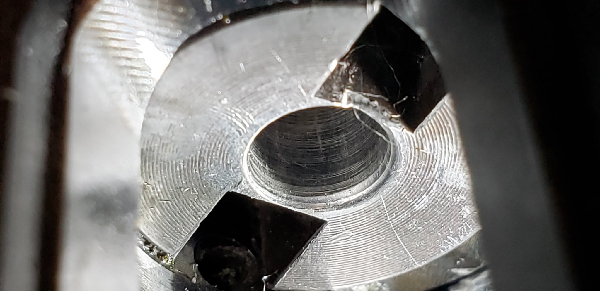

Also, I disassembled rifle and "crowned/chamfered" the entry to the chamber. Mine was very sharp/crisp, so I used a brass lap to very slightly round the edges of the chamber where bullets feed up into barrel. Helped immensely with consistentcy and with no bullet damage.
Cation: do not alter your chamber without knowledge of possible downsides or dangers.
Reactions: copterdrvr
Do you have a pic of your barrel chamber after you did the rounding?
I took a few but it it's really hard to discern the difference from photo. Basically, I used a light tiny round file to just break the edge (45deg) then used valve grinding compound on a boatail of a 6.5mm bullet chucked backwards in drill (maybe 15-20 seconds) then finished with JB Bore paste to lap and smooth further (2-3 min).
It took very very little metal off but it round the outside edges of chamber so that lead doesn't get cut when entering chamber.

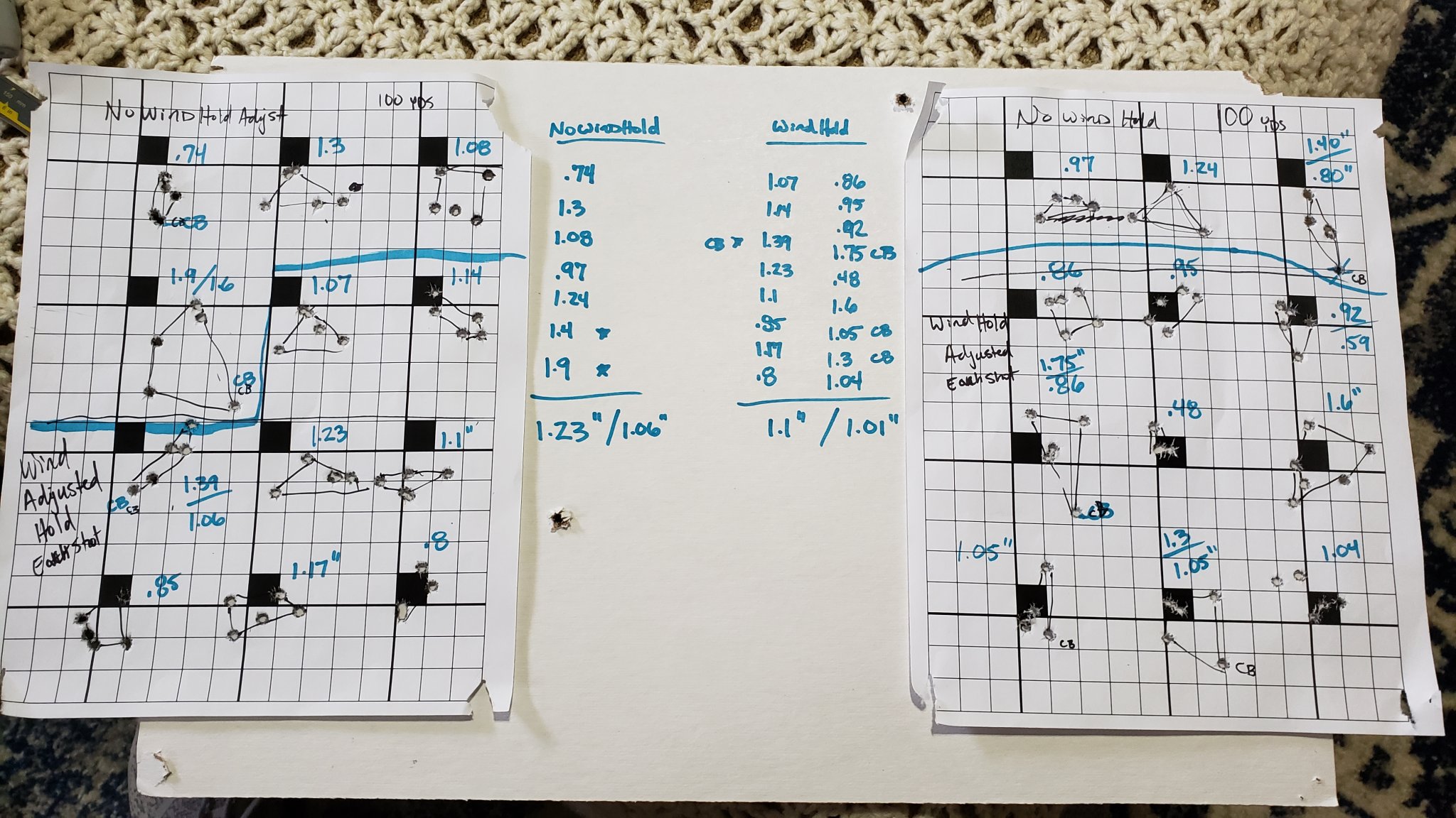

@Hardpan Grabbed a photo of the chamber now and the mag mod. Photos below of several 5 shot groups at 100yds with SK Long range.
When barrel cools off in cold weather, the wax hardens and first shot is dramatically slower (40-60fps slower) which is why I've tossed those out of groups.

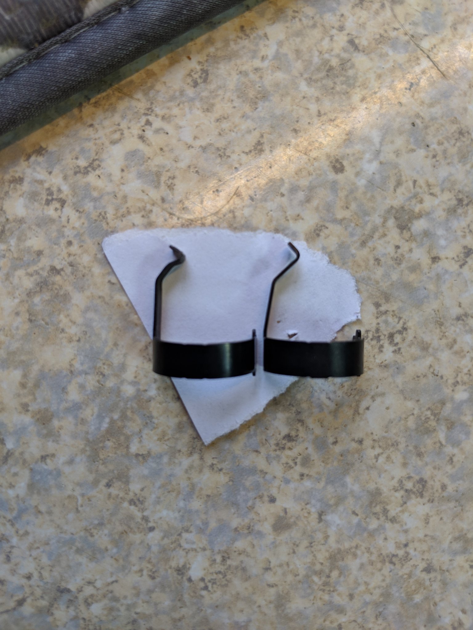

Three reasons it may not be extracting: extraction spring clip too weak; extractor is not "sharp" enough or at correct angle to case; the extractor recess (notch in right side of barrel) is too wide forcing extractor to contact too far outside of rim and slips off.
My guess it's a combination of #2 & #3. Ruger will fix it but I can understand the frustration!
I tell ya, in my 20 years of shooting i have NEVER had a 22 with as many issues as these and a BOLT gun none the less. Shimmed barre, kidd plunger, so on and it still will not extract rounds. It's super frustrating. I got a hold of ruger a week or so ago and they're sending a replacement extractor/spring but my confidence in that working is very low.
My RPRR has been perfect. It doesn’t toss a first round flyer like my marlin or savage mk2. My magazines all feed fine and eject fine. My friend played with the Rprr of mine and is now buying one he liked it so much.... I’m sorry your having issues with yours. A co worker bought essentially the same rifle in 17hmr and says it functions fine and he’s had no issues with extraction or chambering his. ?‍♂️
I will admit though I did bend the extraction spring thing a touch to make it really kick the casings out further than it did from the factory.
So i called ruger last week and they sent out a new extractor spring and extractor. they came yesterday and I only had a chance to to run about 10 rounds through it. I used cci std vel which was the worst for me for not ejecting, normally would get 7-8 out of 10 that would not extract. well out of all 10 it threw them out and seemed to work better. the spring is a BIG noticeable difference but not so much with the extractor. didn't look like it was any sharper than original but did fit more snugly in the bolt. But out of a small sample size it seems to be working properly now. Left is original, right is what ruger just sent me as a replacement.

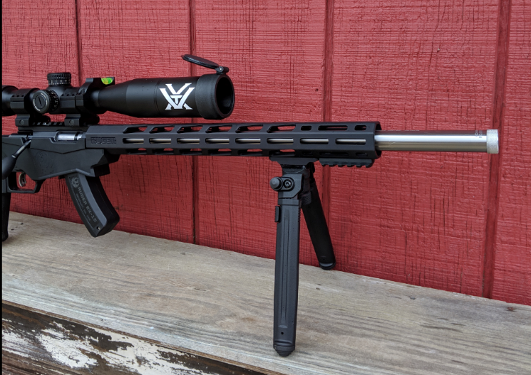

Just put on a new ER Shaw barrel for the RPR... Night and day difference over factory barrel. Have about 400 rounds through it today both breaking in and group testing.
Factory barrel shot okay (.6-1" 5 and 10 shot groups and depending on ammo) this is Ruger Factory Barrel after bedding:View attachment 6941632
Enter ER Shaw barrel....
Highlights:
  • Fits VERY tight into receiver.
  • Bolt is very stiff to close but relaxing a bit as surfaces get lapped together.
  • Fit and finish is great, especially for the cost ($250).
  • Side note: If you have a factory barrel, I would highly recommend removing it to clean up the shitty/nasty/gritty anti-seize they use from factory. My barrel and nut had a ton of sand/grit/dirt like stuff all over and probably didn't allow consistent contact with receiver.
Here are photos of new barrel:
View attachment 6941620View attachment 6941621
