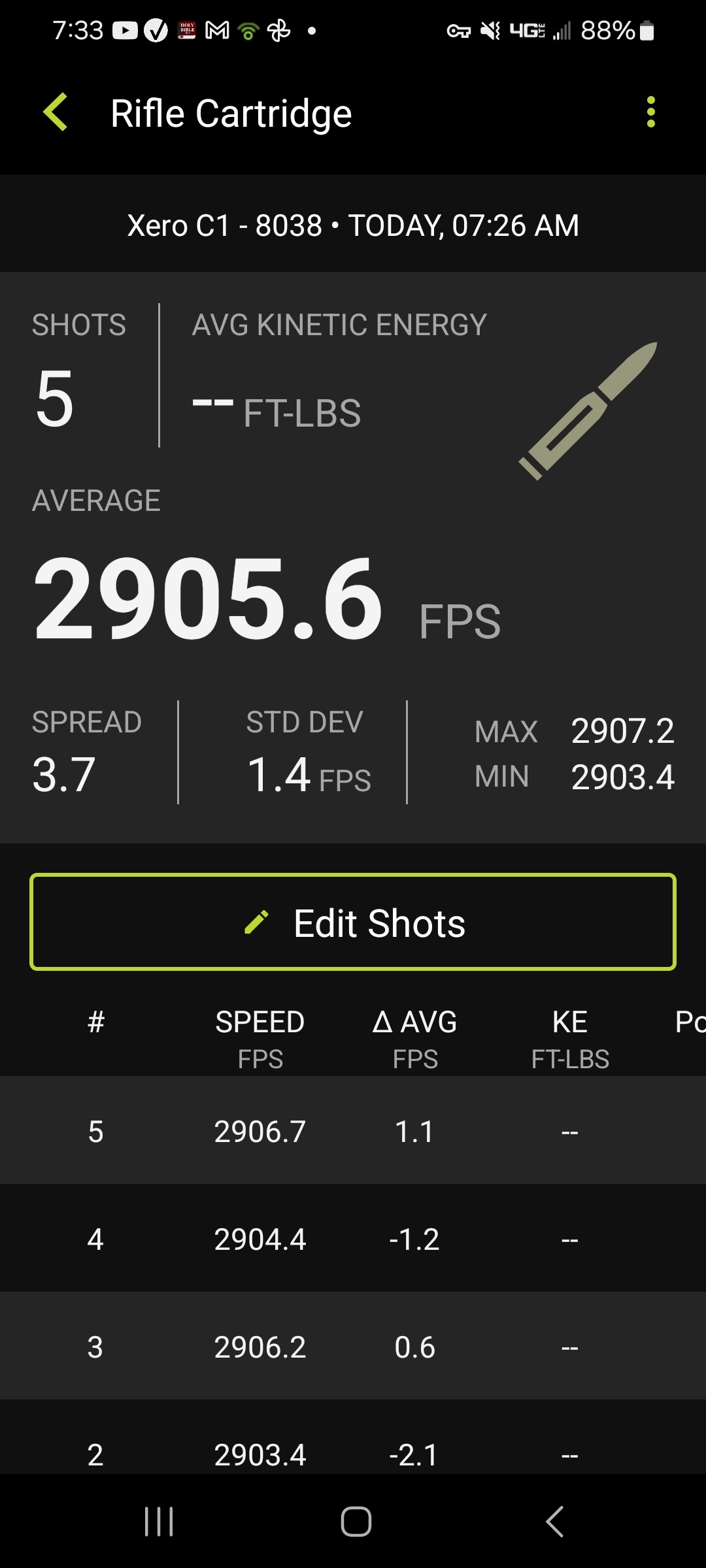

I'm pretty happy with the load at the moment. This morning was better than most. Sd is usually in the 5-7 range on longer strings. If I get single digit sd I'm happy. This morning was a few months ago.
