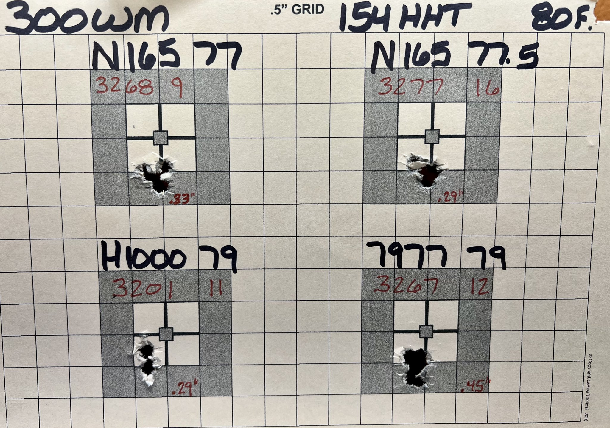

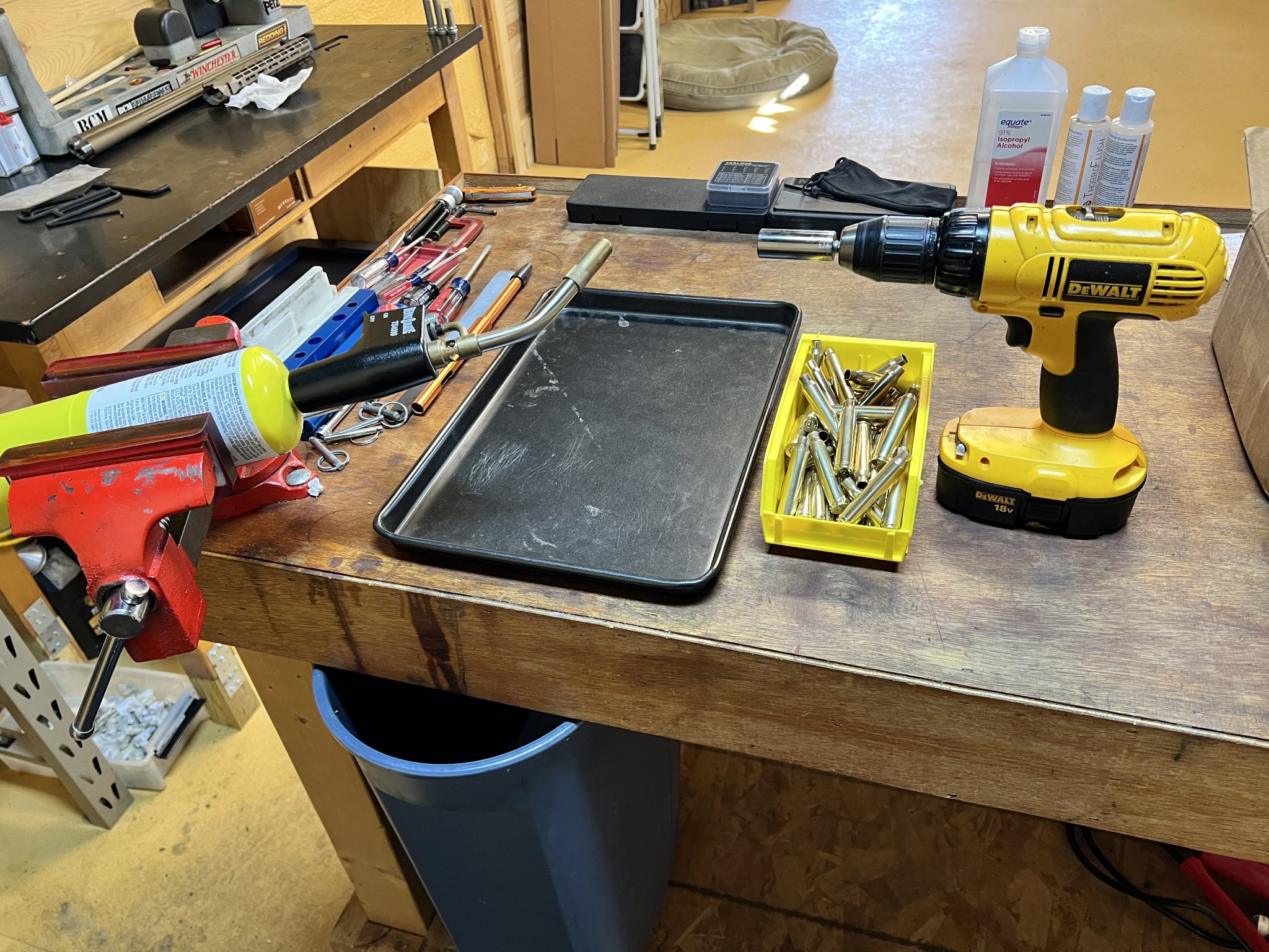

    Pinned seating depth by .0005 for 200 300WM. Yup, so easy they even let me do it!

    I did the cordless drill annealing for a long time before going to an AMP...
    Yeah, the AMP is much easier, faster, more consistent, all that... but don't sleep on the cordless drill method, it still works and is way better than not annealing at all.

    Love to see all your trophies and checks, but really someone with those accolades would have some group pics.
    I wouldn’t do something that didn’t show positive results. .0005 consistency good enough in my book.

    Who said anything about cooked necks? I used to use a timer set to a certain number of seconds, the same way those Bench Source and Annealeez thingys work. Not perfect, but isn’t useless.
