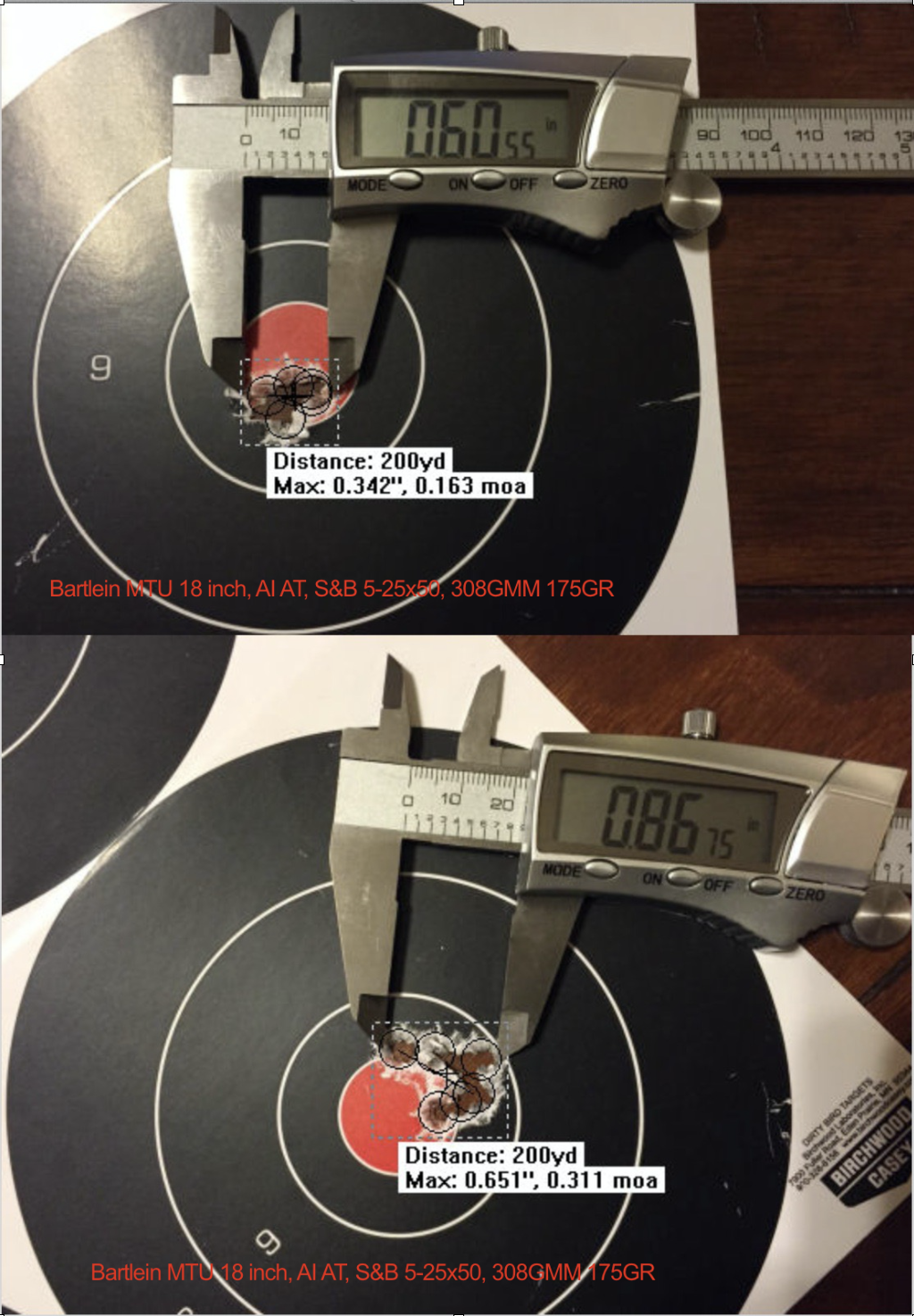

Attached my best group ever @ 200 yards with one of your barrels spun up by GAP: AI AT, S&B 5-25x50, 308GMM 175, Bartlein MTU 1/10 twist 18 inch

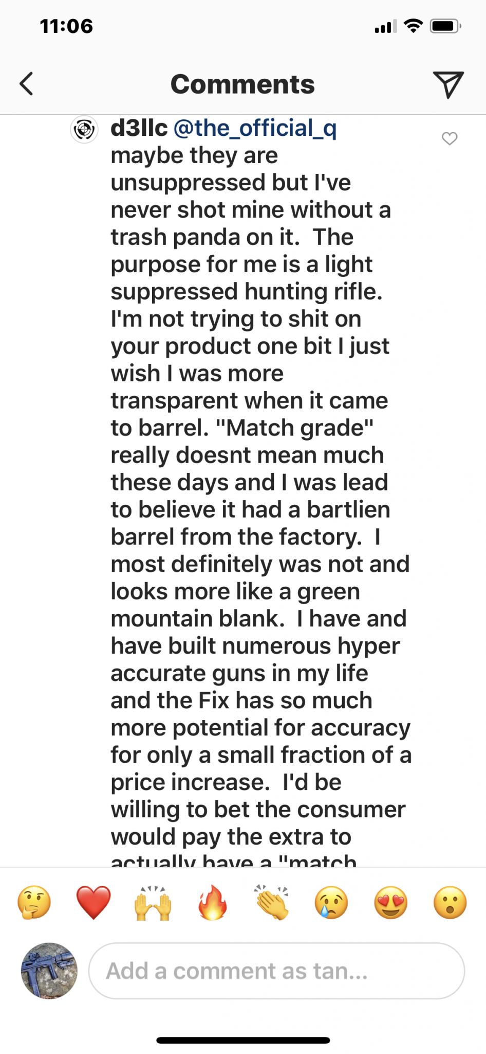

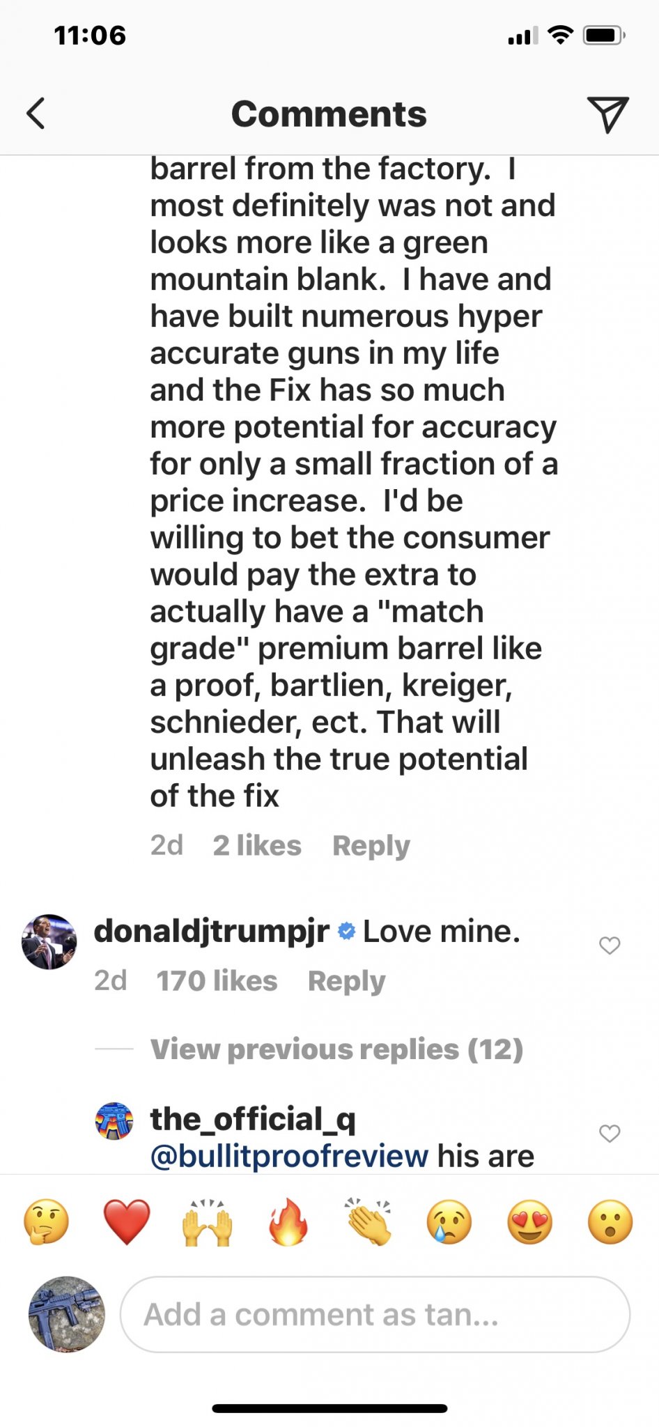

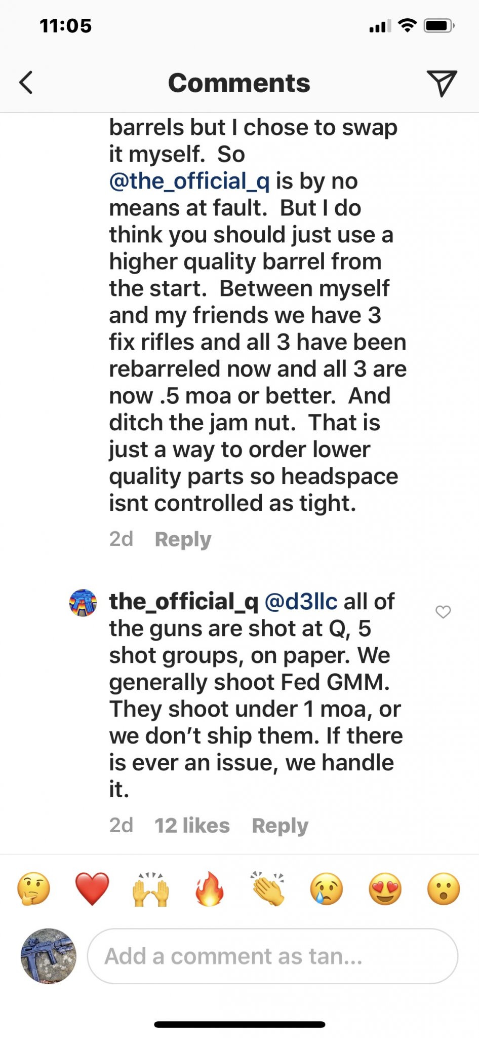

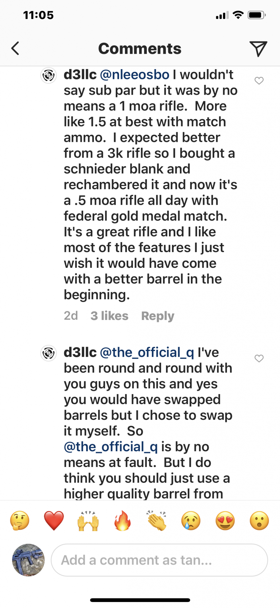

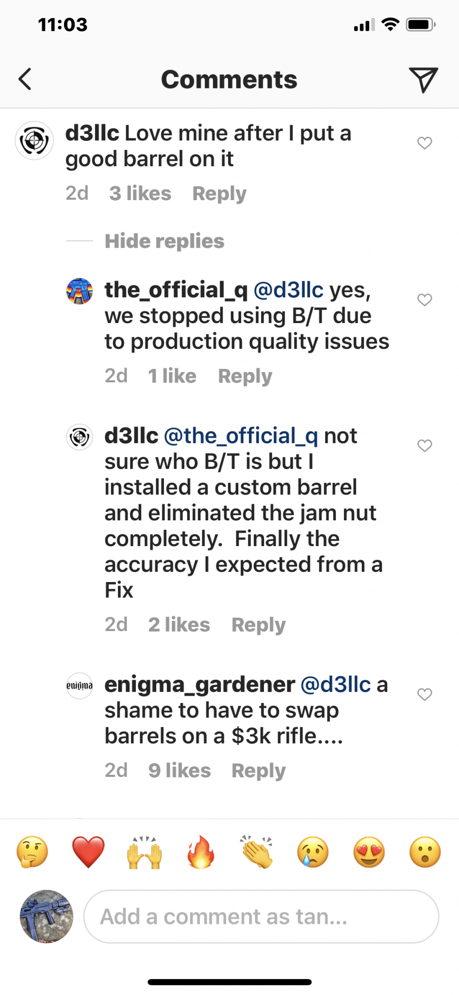

Get a Bartlein & Tooley Barrel and Then contact D3LLC (Desert Design & Development) he spelled out in a post on The Official Q’s IG page how he “FIXED”what was hurting accuracy with The Fix. I am gong to get in touch with him and have him make the Jam Nut changes he did to several buddies of his and his own to go from 1.5-2 MOA to consistently shooting .5 MOA groups.
Can you put up a screen shot of that post? Im curious what he said
Forgive me if they are not in order. Wish I had the link to the original post. I Don’t know if Q left it up or took his comments down. I know they left post up because Donald Trump JR posted in it. I am sure they didn’t delete that.
D3LLC was giving the gun a thumbs up, even told them how to fix it, just didn’t like the “Shortcuts taken” was to increase Profit Margin on a $3000 rig. If I can find more of the conversation I will post it.
Sorry wrong screen grabs, let me find D3’s
Reactions: White Mamba

OK, so that’s what they changed to save money and causing issues.. Man, they changed so much since the original design and all to save money or cut corners, but I am not a gunsmith so.. just sucks. All I can say is get with @Frank Green & or MR Tooley with a quality barrel.
So what’s the accuracy like on the current ones ?
What’s this fix ha described here ?:
