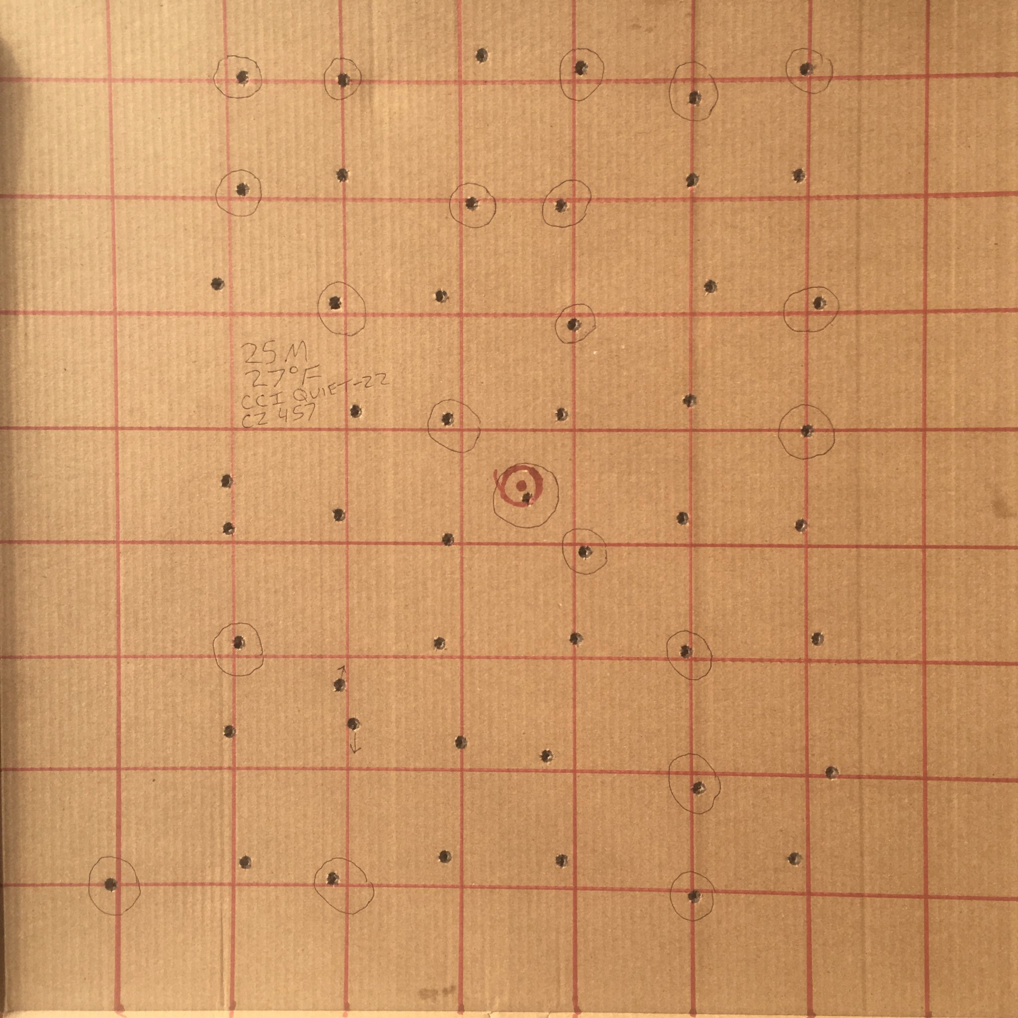

Had the two Grid targets on the bench for measurements,
and a youngster walked over to check out the results.
"That's not very good, is it?"
"Nope, not really."
"Why are you taking pictures of them?"
"I post 'em to show what happens with this ammo."
"I wouldn't, look how many missed."
"That's the point, most folks only show their best results, I show them all."
"I wouldn't."
"Why not?"
"Don't need to, everybody already knows how bad their shooting is."
There's some truth, eh? :D

Even with the Fuglie removing me from the results
the CCI 22wmr is still a 2 moa cartridge at 50 yards.
Yeah, you do get random acts of accuracy
but for 50 shots there's still an inch plus of spread.

I carry two boxes of each cartridge attempted.
Warm up with a group or two of 5 shots, adjust to match conditions.
I am attempting to punch center every squeeze of the trigger.
Suppose I was missing every shot 0.14 high and 0.17 right,
the pattern would be evident over the course of 5 or 6 shots.
I would readjust to fit the pattern.
Problem, the cartridge quality isn't good enough to do so.
Look at the odd strays and vertical fliers, that's not me or wind.
I'm not that clueless with my 455's....been working with them for over 8 years.
If I was consistently off the same amount and direction,
then yeah, my scope isn't set correctly. But when results are high, low, left, right at random,
that's going to be wind or cartridge caused strays. It's rimfire, mass produced ammo.
Production line variations in assembly and components causes trajectory variations.
Aggregate group size is measured relative to grid intersect for each shot.
Spread is furthest left of grid plus furthest right of grid for total horizontal,
vertical is furthest above grid plus furthest below grid.
Even if my scope wasn't zeroed correctly, the total spread is still the same.
All measurements are referenced to where I am trying to hit.
Meeting the requirement of Rule #1, isn't easy. ;)
The only reason I have to shoot groups, is to adjust my scope to fit the current conditions
and to match the performance of the current batch of ammunition. Once that is done
my preference is shooting for score or a one dot one shot type target. The Grid is a cheap
method of doing so, without eating up printer paper or ink. As a plus, the Grid allows easy
measurements for calculating aggregate group size for however many shots desired.
Measure for 5 or 50, entirely up to you.

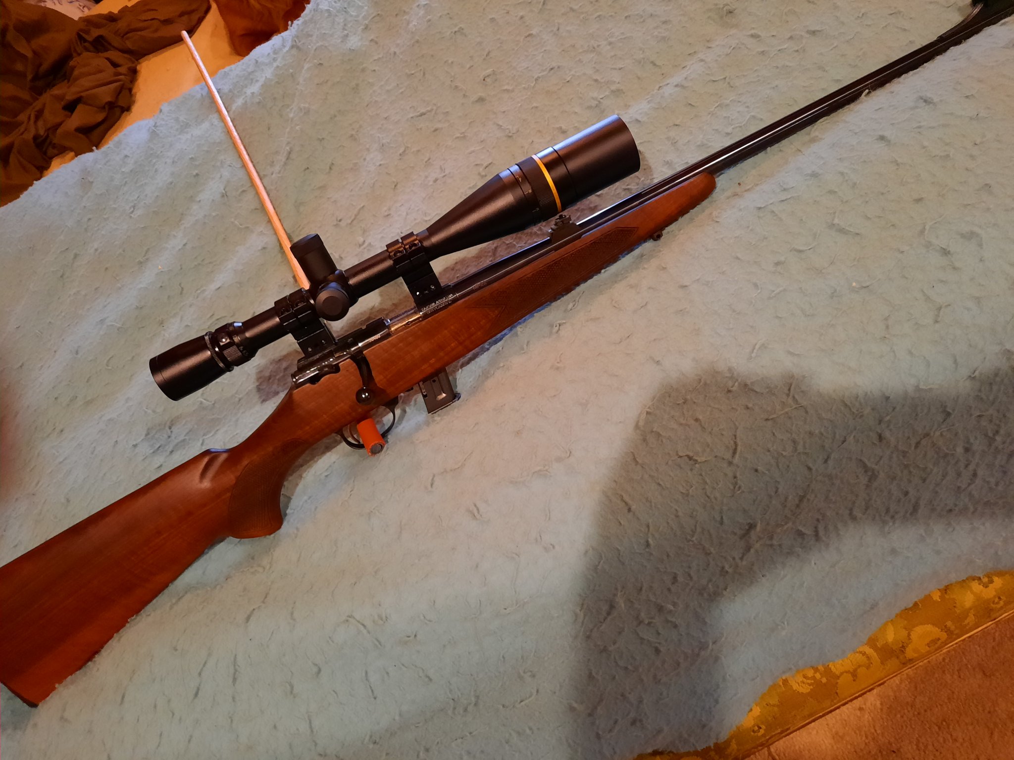

Pulled the 455 SOF out of storage.
Installed a Lilja 17hmr barrel and a CZ Fly trigger which is currently being tested for function.
Previous owner didn't like how it felt. I like tinkering so it'll be fun.

I tried my first grid yesterday and really enjoyed it. My home range is only 25 meters though, and I shoot from a section of scaffolding which adds its own issue. I'm happy with the first attempt with plenty of room for improvement. Circled ones don't meet your requirements, they are 0.25" or less. One issue I found is that the grid and crosshairs started swimming after awhile with my old eyes. I'll need to slow down and rest them, but it was friggin' cold!
CZ 457 with factory 24" barrel
CCI Quiet-22
Bipod and rear bags
(Edit:) Seems my full size JPEG exceeds the sites resolution capability as it's cutting off the bottom. I'll try a smaller one next time)
Morning Turbo...2 out of 30 is funny as heck.
I was trying but hitting a 3/4 inch bull ain't easy.
Not at 200 yards. ;)

using inexpensive 22lr ammunition, is it? Although there are those who claim otherwise.
When someone claims sub-moa "all day long", I ask them to try a Grid at 50 yards.
As y'all have seen, not too many takers willing to post their results. :(
Kinda makes you wonder why, eh? :D
Side note...I receive comments, messages, emails, thanking me
for posting all of my results, not just my random acts of accuracy.
Allows folks to compare their results to mine, when using similar equipment and ammo.
They appreciate the transparency.
Good morning Turbo...nope, sticking with what I have and the method being used.
Factory CZ 455 Varmint, pillared and bedded, single set trigger that breaks at 10 ounces.
Practical accuracy at an easy to duplicate distance with all the results shown.
No pretending I can do better than what is posted. This is a factory Sporter in 22lr

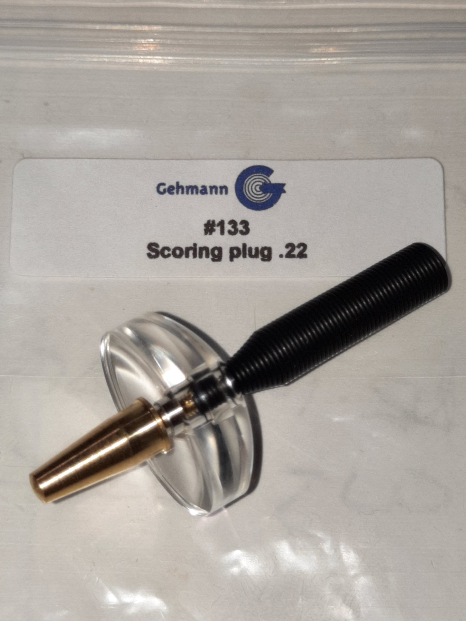

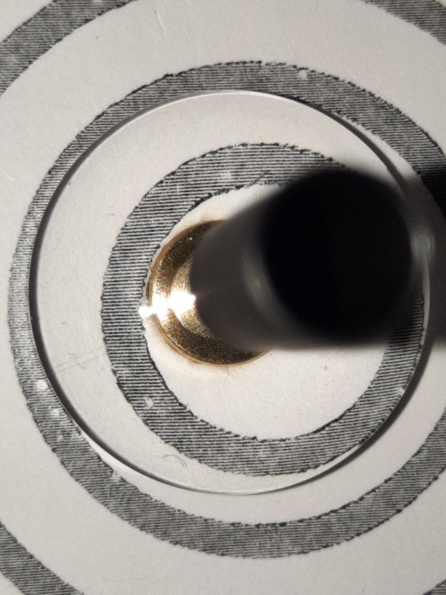

I recently bought a Gehman E-Z scoring plug for $12.00 on evil bay. #372097272349. It makes scoring super fast and eliminates
any guess work. I only want points that I deserve and this makes it clear if I do or don't. This is .22 Magnified model and I feel it is the
way to go. You can see in photo number 6 how clear the magnifier makes it.

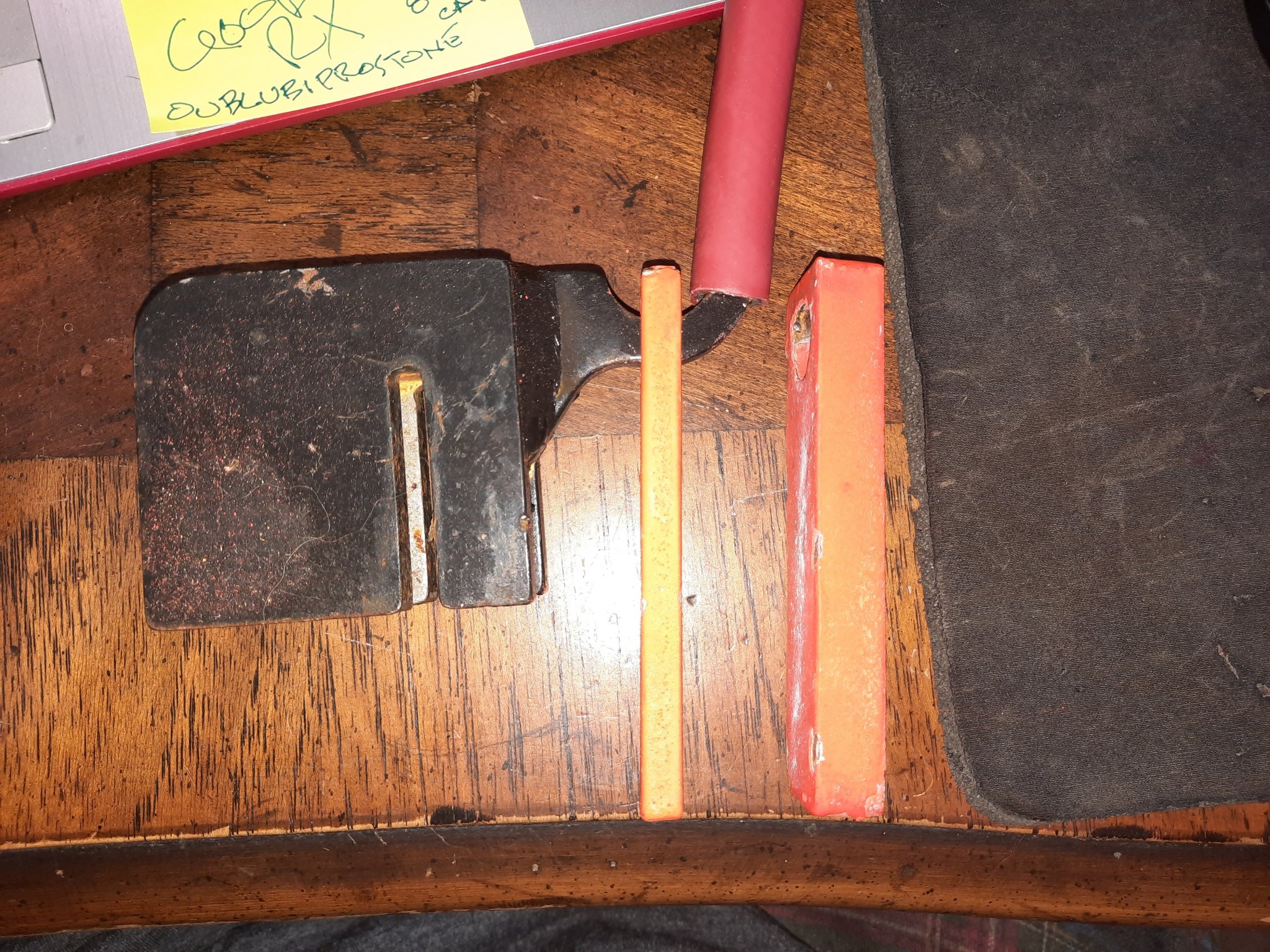

I have about 15 guns at this time and they are basically factory guns. The one thing I will do is some trigger work and that is generally
lapping with Aluminum Oxide lapping film. I start with 9 micron and finish with 3 micron. Currently lubrication
is done with Dupont Krytox grease. It's basic description is: Extreme Pressure Grease, Synthetic, PTFE, Molybdenum.

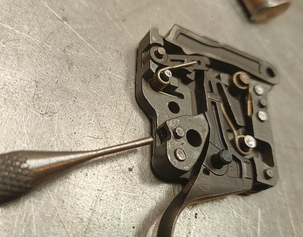

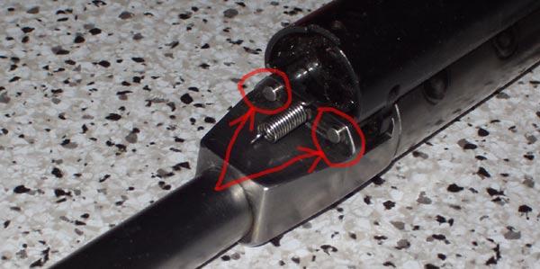

And I may change the spring arrangement as required. In my B14R, I added a long nose spring plunger to counter act the internal factory
torsion spring. There is an existing hole, indicated by the pin punch that needs to be opened up for a #6-32 thread. It's a $5.00 / 20 minute job
and brings the trigger down to 11 ounces and also incorporates an adjustable sear feature.

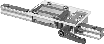

It looks like your Fuglie locks the gun in place via the barrel.

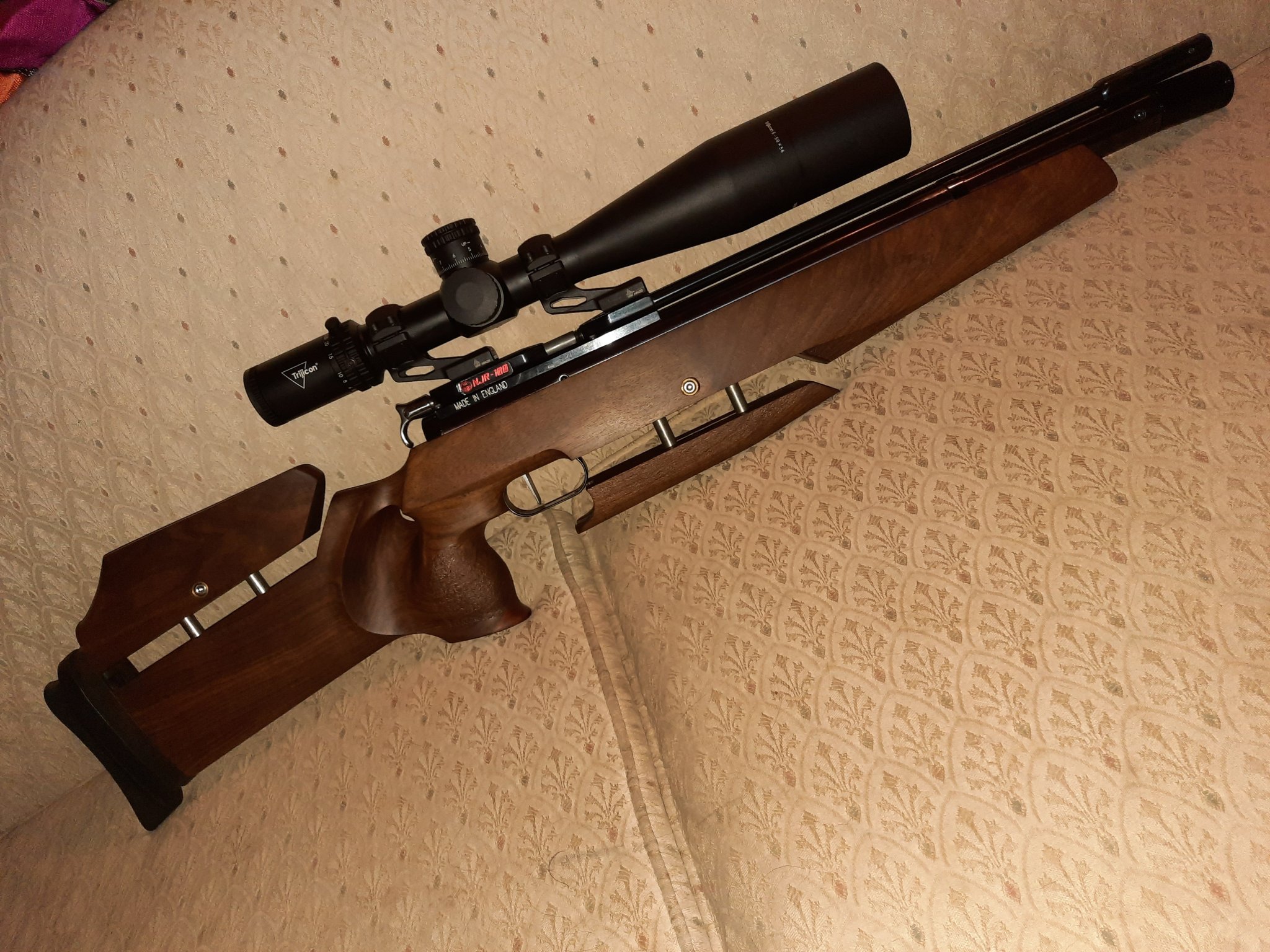

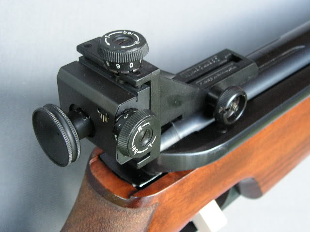

Have you ever considered mounting the action to a bearing block that would allow rearward movement only.
We all know newtons third law.... as soon as you detonate the cartridge your rifle has no choice but to recoil.
If you allow it to move rearward in a controlled fasion for about .50", your bullet will be out of the barrel before
you experience any.... muzzle raise motion.
Feinwerkbau did this in their Olympic air rifles and pistols. FWB 65 and FWB 300.
They took more gold metals than any other guns by far.
My Vudoo was just over 18 pounds and it still moved around a little. The muzzle energy of our match bullets (40x 1070) is just over
100 pounds and that is pushing your gun rearward. It only has muzzle raise because the center line of the butt plate is
below the bore axis by about four inches.
If you look at the FWB stock just below the rear sight you will notice a black metal tongue and a slot in the wood. When fired, the entire action moves rearward about 1/4" while the pellet is moving forward. The gun does have muzzle raise when it runs out of travel but it only occurs after the pellet has left the barrel. The action is guide by three pins, two in the front and one in the rear. Three pins create a stable plane.
I'm just tossing it out for you guy's to consider.

I recently spent $12.00 on a Gehman scoring plug. If you zoom up on it you will see how beneficial it would be.
