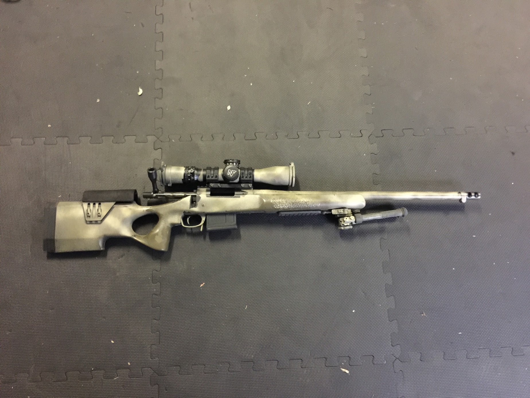

"GoLite" vs. "GoHeavy" ...
GoLite sitting at 11.2 pounds w/bi-pod
GoHeavy is an AI/AT w/ .243 barrel provided by MileHigh with Premier 3-15 sitting at over 17.5 pounds ...
Both guns shoot 1/4 - 1/2 MOA, the AT is slightly faster shooting Berger 105gr hybrids @ 3,130 fps GoLite is sending them downrange @ 3,080 fps ...

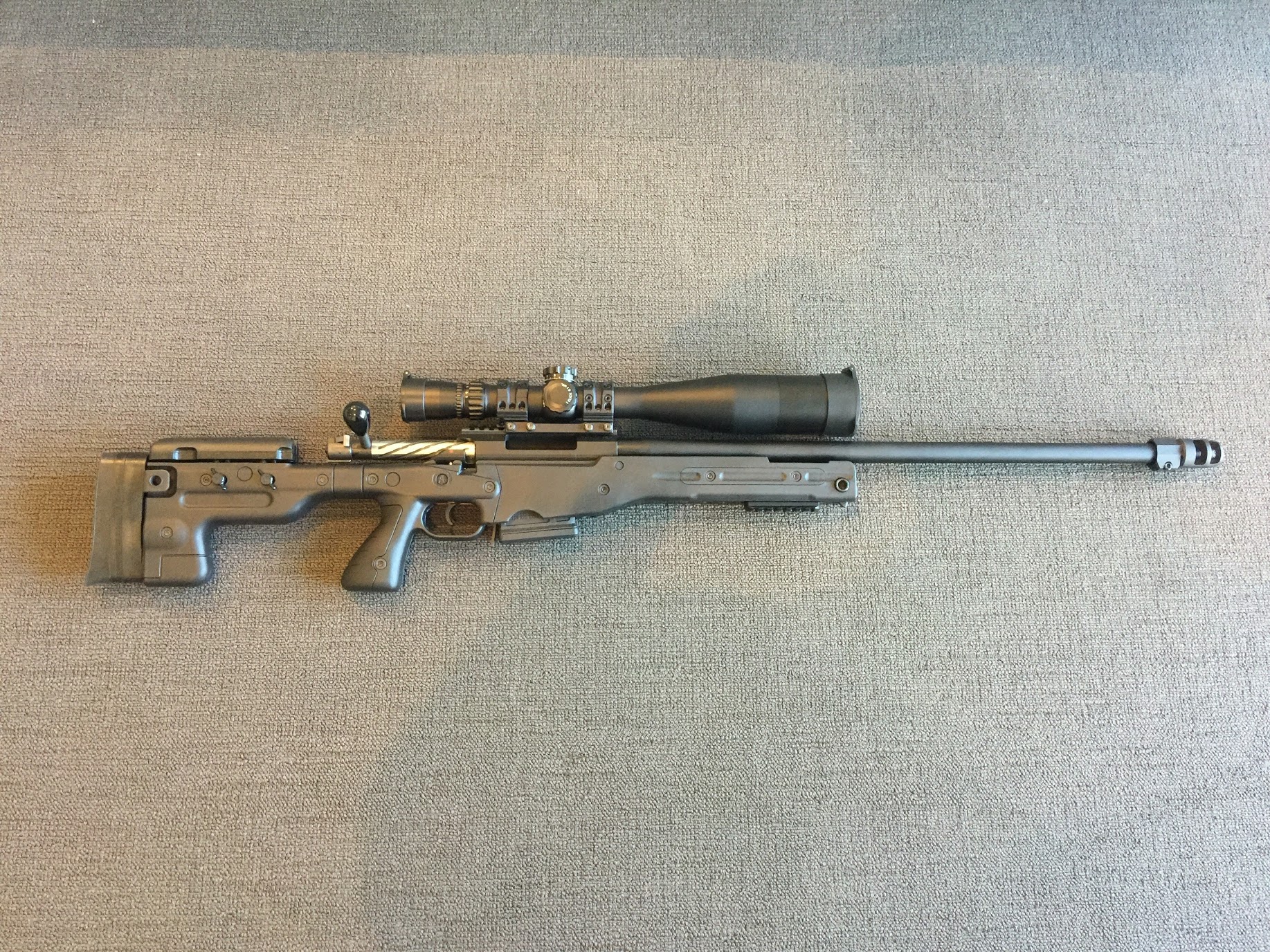

I moved towards a lighter weight setup back in 2015. This is my primary comp rifle and the rig I used to win the national and state APSR (https://www.australianprecisionservicerifle.com) titles in 2016:
Surgeon 6.5x47 - 23.5' barrel, Nightforce 4-16. Total weight as pictured 13.2lbs - I can drop the bipod for certain stages and be at 12.3lbs
I won a much heavier rifle, a Nimrod 6.5x47 that weighed 17lbs - the Nimrod is an absolute laser - but I found the combination of extra weight and my inability to adjust to the AICS stock caused real issues during unsupported stages.

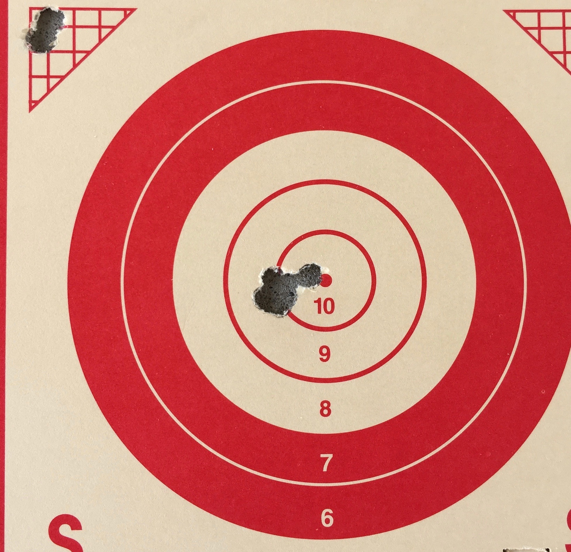

There's a lot to be said for pure precision, here's a 7 round and three round group with the Nimrod.
Despite being able to stack lead on holes she was a real pig - and ultimately not a rifle configuration that interests me these days.

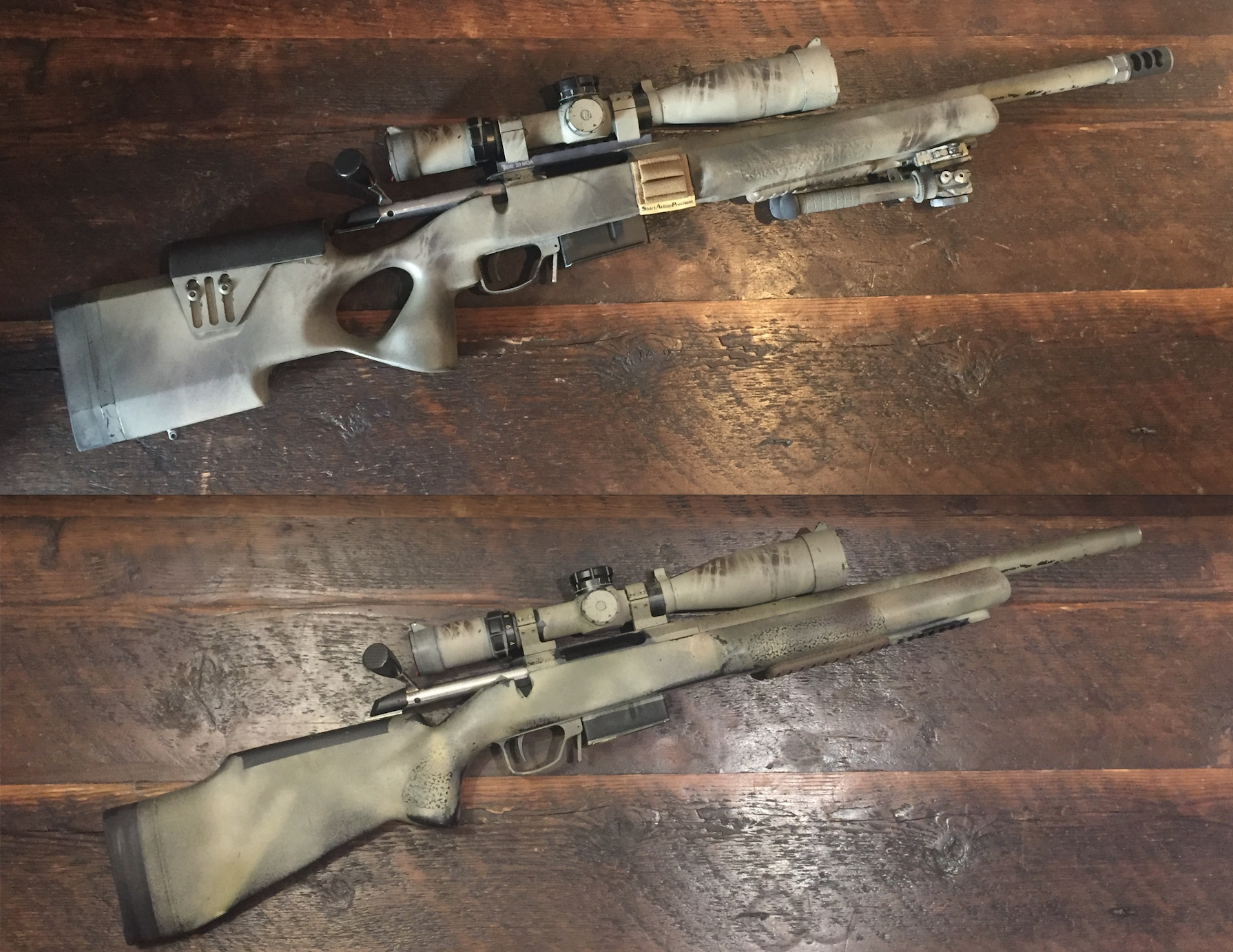

I've continued to experiment (it's at least half the fun) with weight saving by using the same barrelled action in different configurations - here's an example with a SBR Tikka .308
Top configuration = 11.7lbs, bottom setup is 10.1lbs, they both have pros & cons. It helps to reflect on the fact that each build is designed to accomplish specific objectives which requires a mix of compromises weighted for a primary use case.

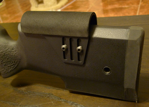

I can shoot a light gun okay-ish (good enough to hunt with from 100 yards and in) with my left arm stretched out and right elbow tucked, and it's honestly the way I usually shoot when hunting if I need to take a quick shot and can't brace against a rock or tree or something. I have no hope, however, of shooting a heavy gun that way.
How do you attach them, and what stock are you using? Is the open width correct, or did you adjust it somehow?
They come as a kit with required hardware for installation - no adjustments required. I had my smith fit them while he was doing barrel work - Manners T5 stocks are what I have them on.

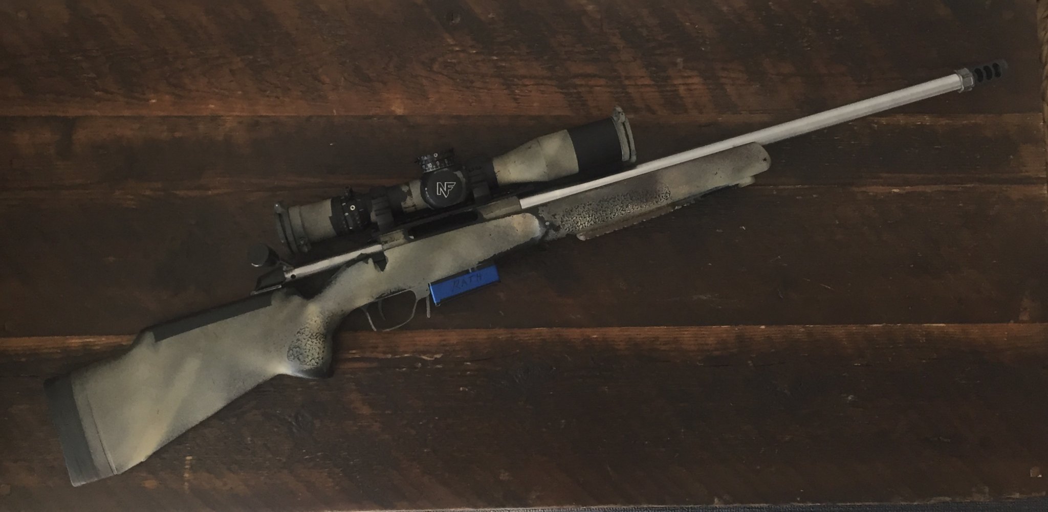

Here is another shameless plug for MileHigh and the "GoLite" approach:
After seeing how well my GoLite 6x47 shot, my father HAD to have one ... for "deer overwatch" this coming hunting season:
Picture of the rifle he had Mile High build, on the counter the day it was delivered.
Specs:
.280 AI
Mausingfield Long Action
24" Proof barrel
Manners MCS-EH2
Jewel Trigger @ 2lbs
S&B PM II 5x25 P4 fine in MOA
He was surprised at how "light and tight" it felt. Mostly he was impressed with how it shoots (3 shots 168gr accubond LR) 2,978 fps at 100 yards:
I know some will say 3 shots does not a group make but not bad for a "deer rifle".

Update on the Mile High "Go-Lite" project - First match results:
I decided to take the gun to a local steel match with targets from 75 - 1,250 yards. To date, I have only shot the gun to 200 yards and thought that maybe I could kill two birds with one stone and get some long-range truing data for the rifle while shooting the match. So I showed up with a good 100 yard zero and a muzzle velocity and Shooter on my iPhone.
Lessons learned:
1.) Its better to show up with your dope all sorted out a head of time - gun connected out to 800 yards but I did not hit anything beyond that and there was no splash or feedback on those longer stages so my plan/hope of getting truing data during the match was "opimistic" at best.
2.) The mausingfield action ran flawlessly
3.) The gun was is very easy to maneuver and I only dropped one point on the barricade stage - it's all phycological but I was thinking as I was moving the rifle around the barricade - "Man, this gun is easy to shoot."
Lessons learned:
I was actually inspired by this thread and I’ve got a TL3 that should be here hopefully next week. I took a slightly different approach though. I have a marksman contour 6.5 to compete with, then switch to a hunter type profile or proof barrel for hunting, haven’t decided yet. Reason I’m doing that is because I chose the kmw sentinel stock as I’ve absolutely always been in love with the stock, so I figure the barrel profile is the next best place to cut weight.
kmw sentinels are great stocks. Your best bet is to cut wt. with the barrel with some combination of contour, fluting or carbon.
After this you can cut up to a pound with your optic choice. Sounds like a great build.
Did the hardware that came with it work with your stock or did it need different screws?
I believe it came with hardware but it's been a few years and I can't be sure - my smith installed it while he had my rifles for barrel work.
Lessons learned:

Whiterabbit,
I am not sure if the long action Mausingfield uses AI magazines - the .280 AI my father built uses single stack mags. You could call Mile High and they can sort you out on that question.
I use the ARC magazines that start double stack then taper to single stack in my short action Mausingfield 6x47 and they function flawlessly. The other CRF action you might look at is the BigHorn TL3 ... I had one of the early Big Horn actions (not CRF) and they make a great action.
I will say this: Both the 6x47 and the .280 AI "Go-Lite" guns that were built at MileHigh are the most accurate rifles that we own. They are about 10-11 pounds (with optics) but are solid and just hammer. Both rifles have "good Karma" that you can feel when you pick them up and are great fun to shoot. My father has owned 100's of rifles (including Holland and Holland African doubles) and likes his "Go-Lite" 280 AI the best. Both guns are sub 1/4 MOA, the .280 AI is 1/4-1/3 MOA with factory ammo (hornady and nosler).
This project has been great fun but I understand the agonizing, getting the trade-offs right is the big challenge as every little bit quickly adds up. You have constantly ask - "Is this ounce worth it?"

Took the "GoLite" gun to the range test out 108gr hornady ELD-X bullets for an upcoming deer hunt in UT this weekend. Used the same load of H4350 that I use for 105gr Bergers - noted a slight shift when shot through the SAS suppressor. Shot off a bench at 100 yards.
Got to love a well-put-together rifle:
I will upload some pics of the hunt and the results ... not so much a hunt as it will be "deer overwatch" ...
