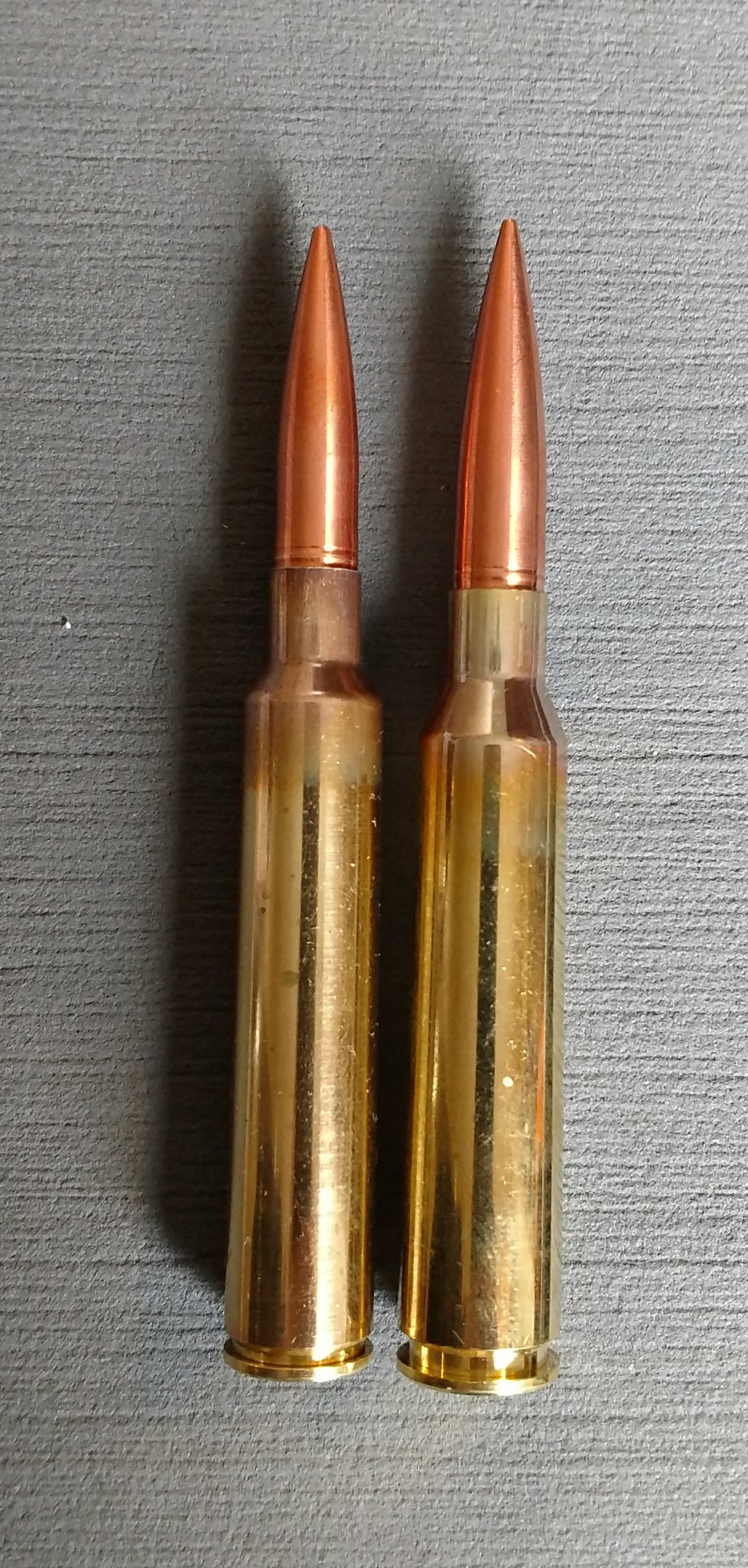

Anyone else building or already built a 33 or 37xc? I just received my brass for the 33xc and made a modified case for checking seating depth. Here is a comparison pic of the 33xc vs 375 cheytac:

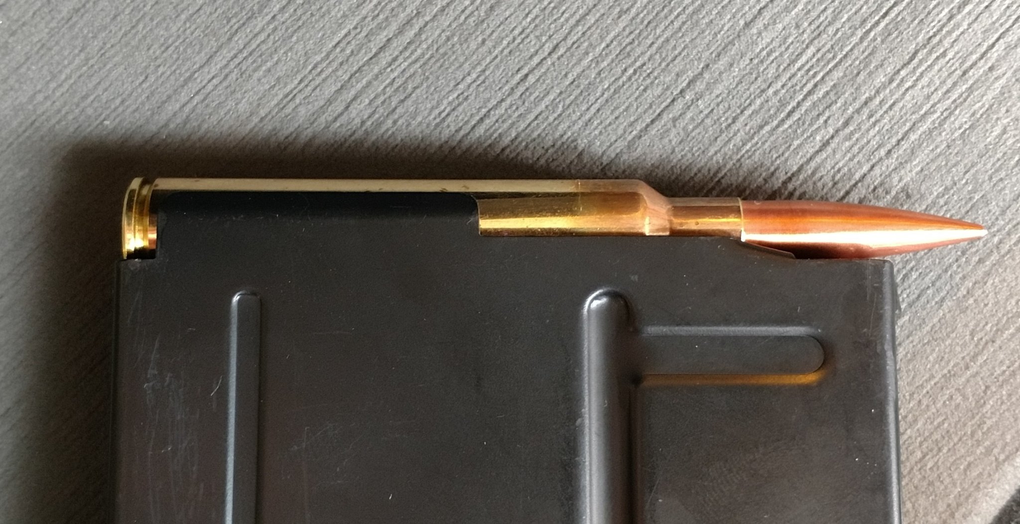

Here's the 33xc with a 277 single feed cutting edge mtac in a CIP length AI mag:
Just wondering what action you guys chose to build on? It's definitely going to be a single feed cartridge unless you build on a cheytac length action.

What COAL is that.

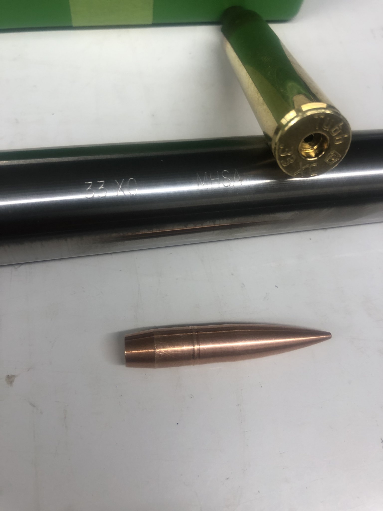

Picked up my barrel from Mile High today. Hoping to get it out this weekend and send a few down range. Plan on trying h50bmg and 277 mtac’s.

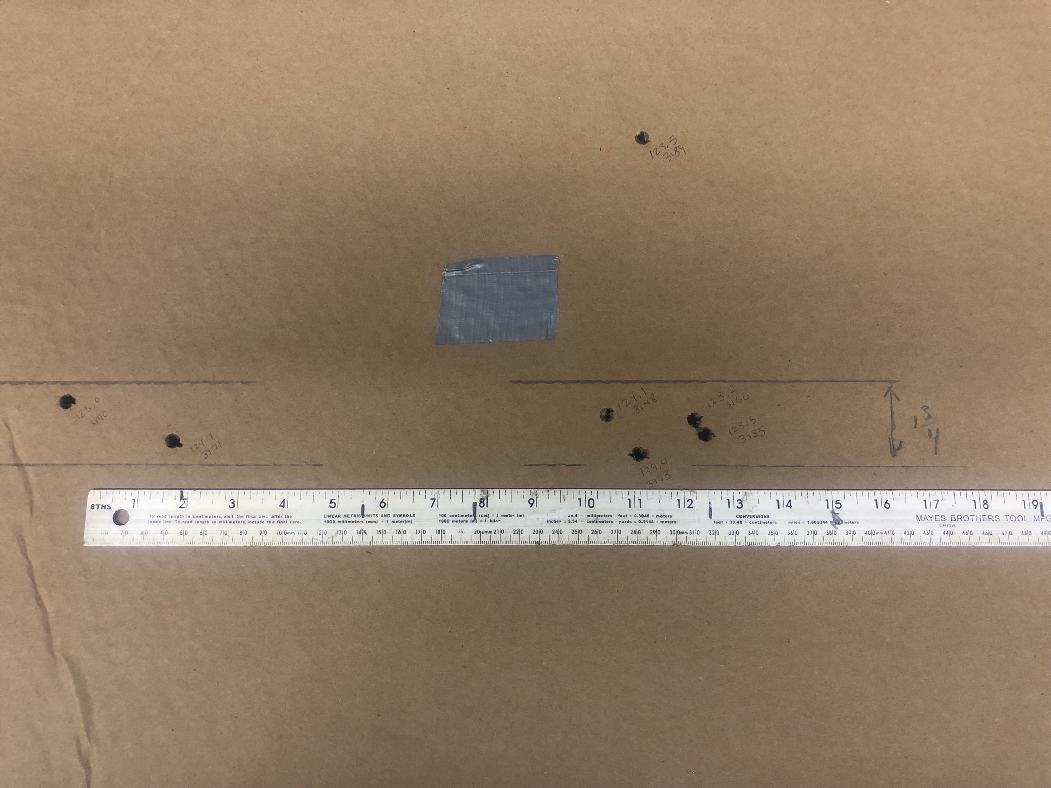

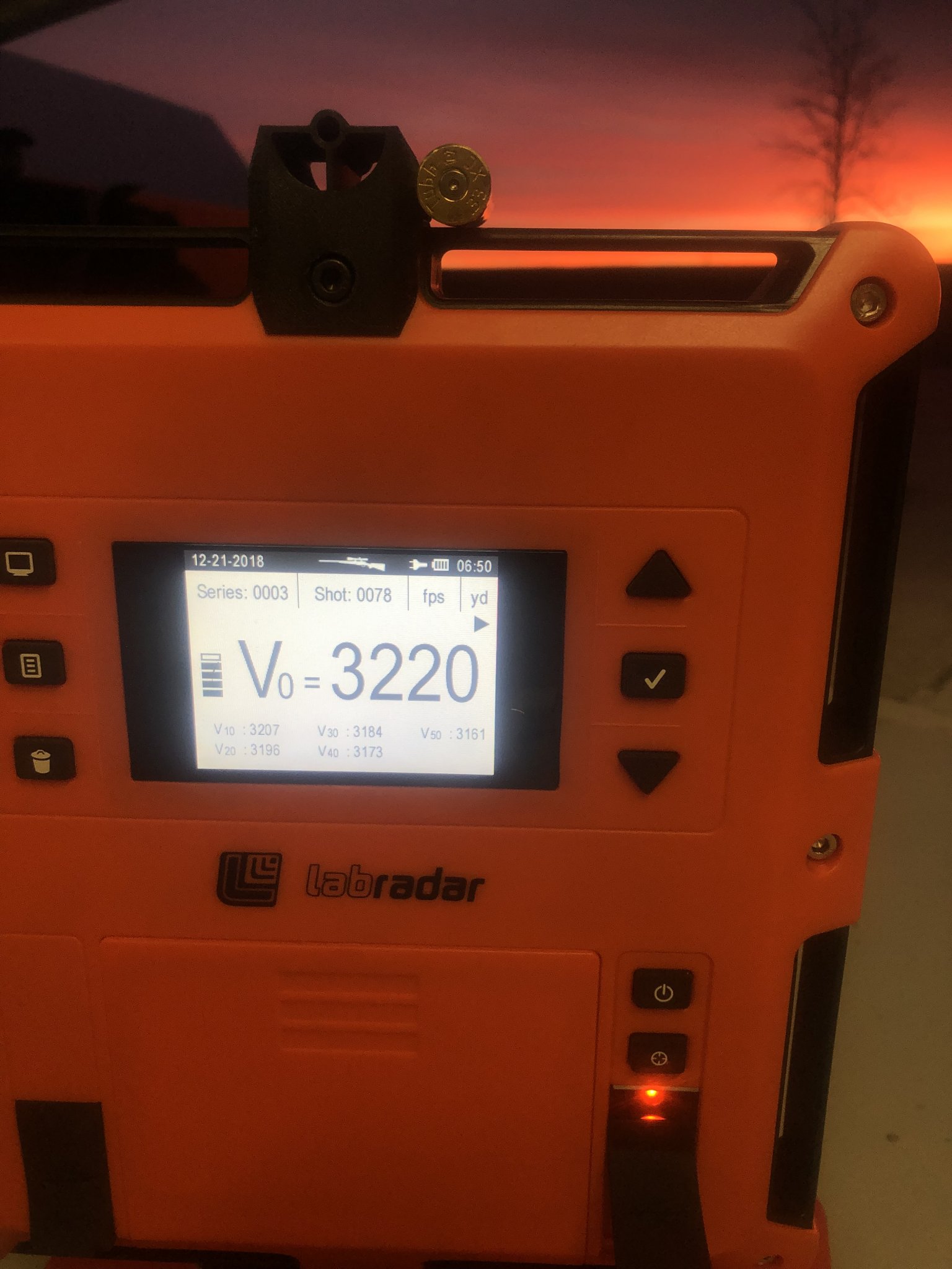

Got out to the range today to run the ladder. I had about a 3300da, 39F, and full value 5-6mph wind. Target distance 510yds. Velocities from the ladder kinda have me puzzled still but the only brass prep I did was run a .0025 mandrel in the case. Nonetheless accuracy seems to be good. Never encountered stiff bolt lift but a faint ejector mark was noticeable on all pieces of brass.
277 mtac @ .015 jump
H50bmg powder
I had one “flyer” at 2 oclock which I’m assuming was my error. Last two on the left I dialed over so my colors for those rounds didn’t get mixed up, (saves me a trip to the target) only have 5 sharpie colors that show up well on cardboard.
I shot one round at a 100 to check zero, one on steel at 510, then proceeded with ladder
