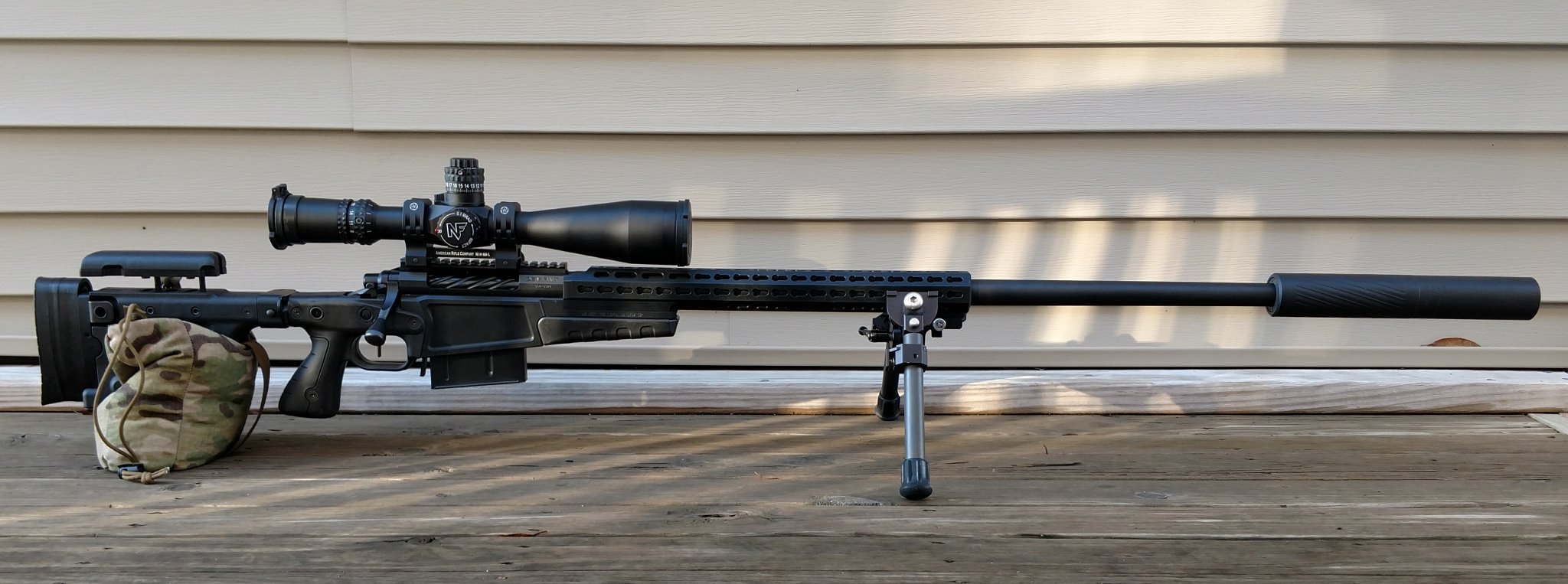

Ran a 500 yd. ladder on the 33xc today with 300 Berger OTM’s an h50bmg. The 277 mtac’s I tried just seemed erratic at 2010yds on two different occasions. Ran the ladder today and then hurried back to the shop before the sun went down and loaded up 6 rounds of 122.7 Took a couple rounds to get dope and ended up with two hits on steel as the sun was going down. The Berger’s seem way more consistent than the mtac’s at 2010yds. When I get more time I’ll mess with this load and seating depth if needed as it looks to have good potential.

what twist are you running?

What velocity were you seeing with the 300 bergers? With a throat cut to run 300 bergers, will the flatlines still reach the lands in your chamber?
My chamber is actually cut for solids. The 300 OTM’s ended up seated a bit deeper than I wanted but not by much. I started out with 277 mtac’s but just wasn’t getting the accuracy I wanted at 2k so I tried the 300 OTM’s. I didn’t push them real hard because of the fast twist but I ran a quick ladder at 500 yds with them and found a good node. Sent about 7-8 at 2000 yds and accuracy looked significantly better than the mtac’s. I have some 285 flatlines now that I’m going to try. Those were my intended bullet all along just took longer to get them than I first planned.
