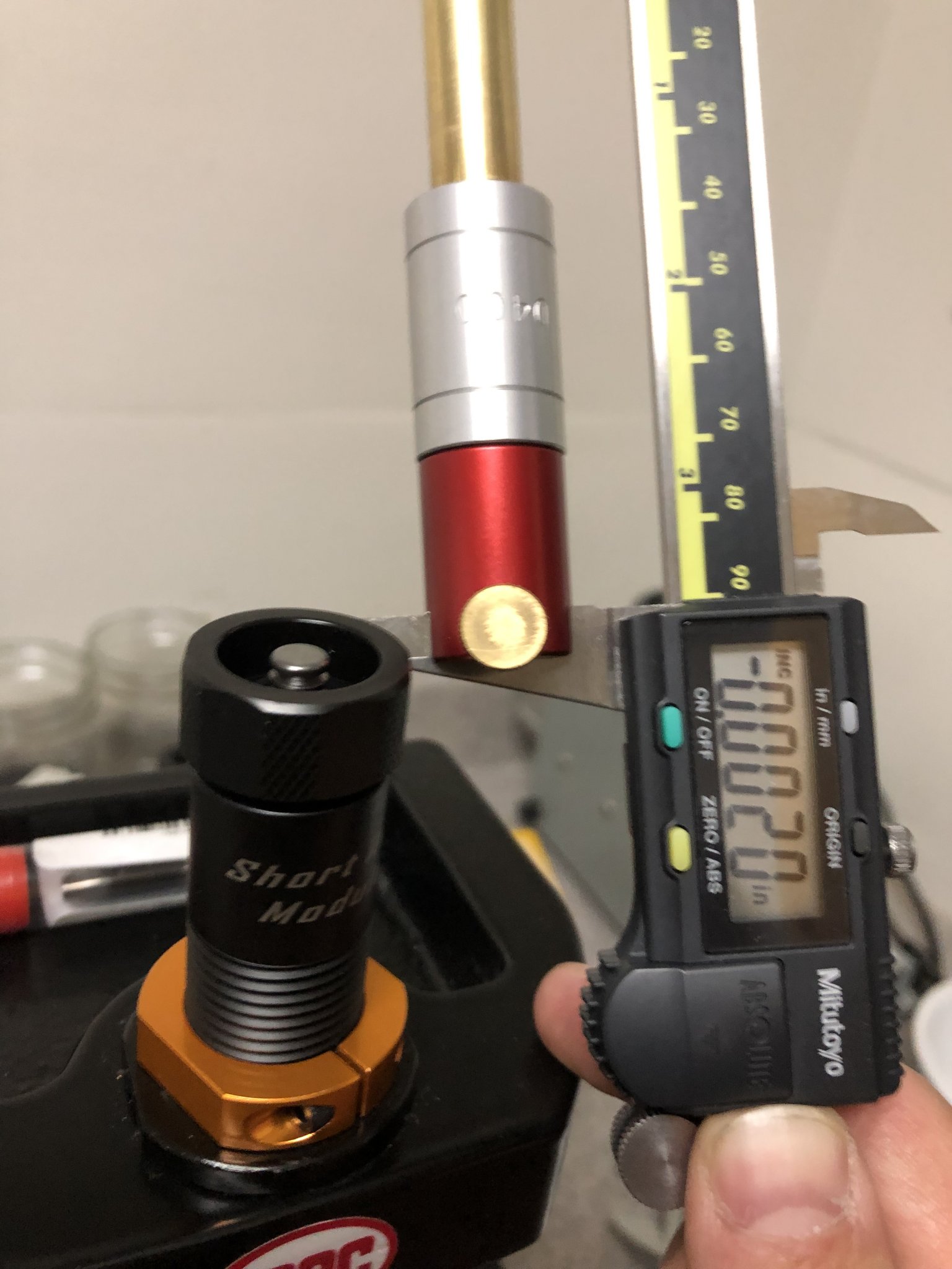

For those wondering the above was done with a +.010 Redding shell holder and some cam over.

Has anybody taken measurements on their new carbide expander mandrels? was excited to get mine and I have 4 of the older gen nitrided mandrels, all of which measure right down to the .0005" as ordered however I've ordered 2 of the newer carbide in .2210" and .3060" and both come up short at .2205" and 0.3055" respectively when measured.
Before ordering the mandrels I had spoken with Mark about which mandrels would be best and the guidance was to bump up .0005" to account for springback but these are undersized if anything. Additionally as I had thought would happen with these new mandrels when sizing brass that was annealed on an AMP the pin gauges (all minus gauges) I used to test neck tension is having the neck inner diameter come up .0005" short of what I ordered/is laser engraved on the mandrels
Is anyone else experiencing something similar? I could think of one of them being under spec but having both of them is suspicious as the 4 nitride mandrels again are right on the money.

Both measure dead nuts with a mitu mic.
Thanks for taking a look at yours, having a convo with Alan now about it hopefully can figure something out!
