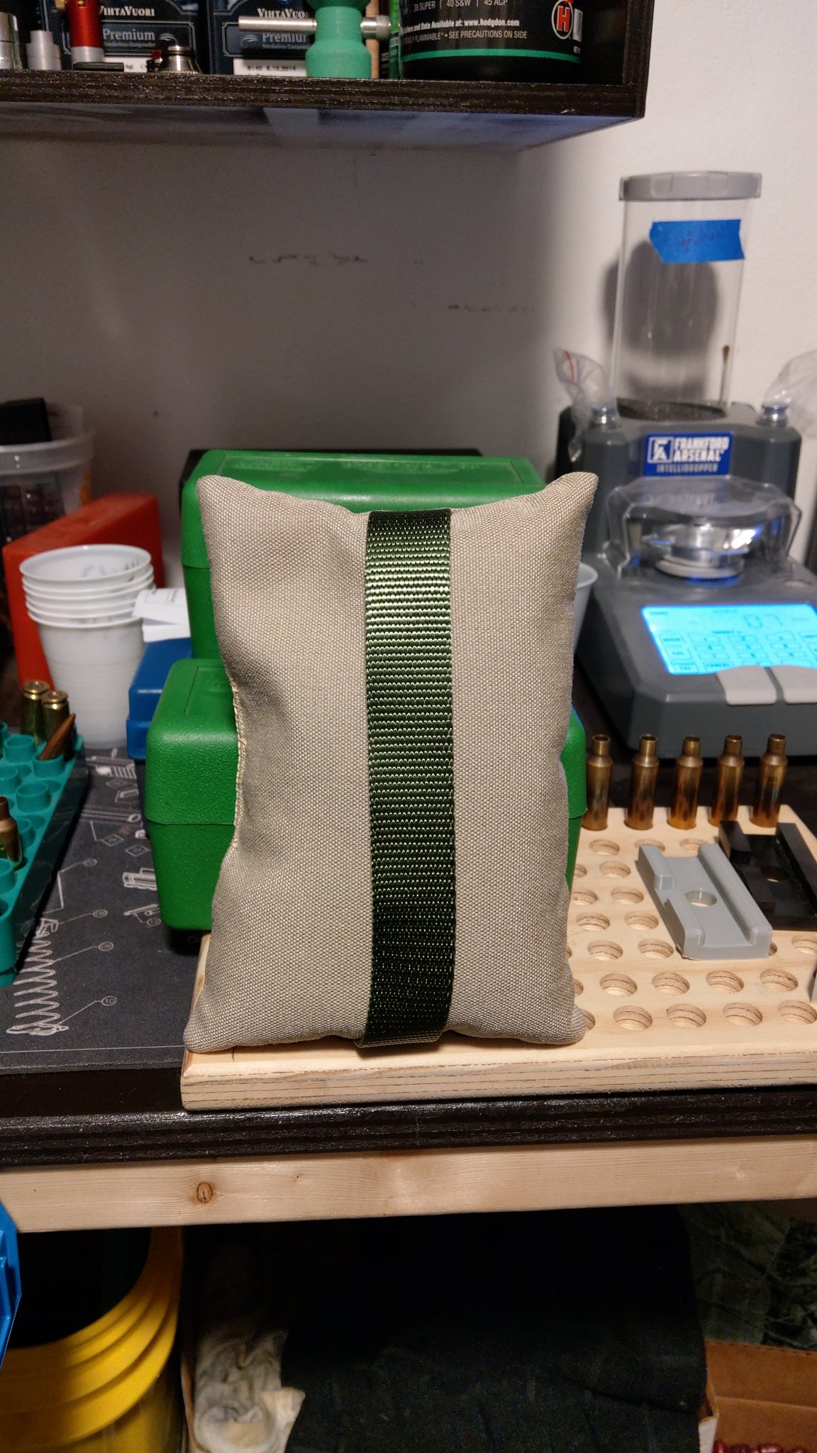

Got mine today. Like the color.

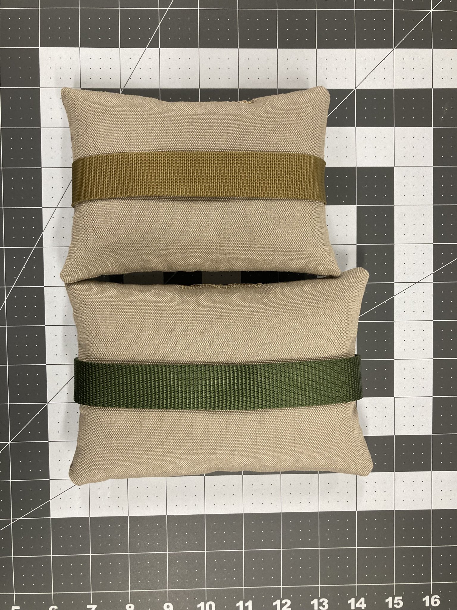

What is the height difference between the two bags?
There's a cut difference, filled and closed difference and usable difference, so it's hard to answer that question depending on how you are utilizing the bag exactly. I call it an inch, but it comes out to 10+ Mils of usable gain through the scope.
I hand-sewed that fucker closed myself and that half-hitch cinch stitch line is absolutely beautiful. Agree? LOL
I then hide the loose end underneath with two knots toward the anchor end. Thing of beauty...
If your mass-produced bag has a sewing machine stitch line as the closing stitch... It doesn't have enough fill in it. You can't properly fill the bag and then get it to fit under the foot of the sewing machine!!! One-at-a-time, baby! :-]]
...Taylor
...Taylor
It is a beauty. If you need a new gig, you can always become a seamstress.:ROFLMAO:
