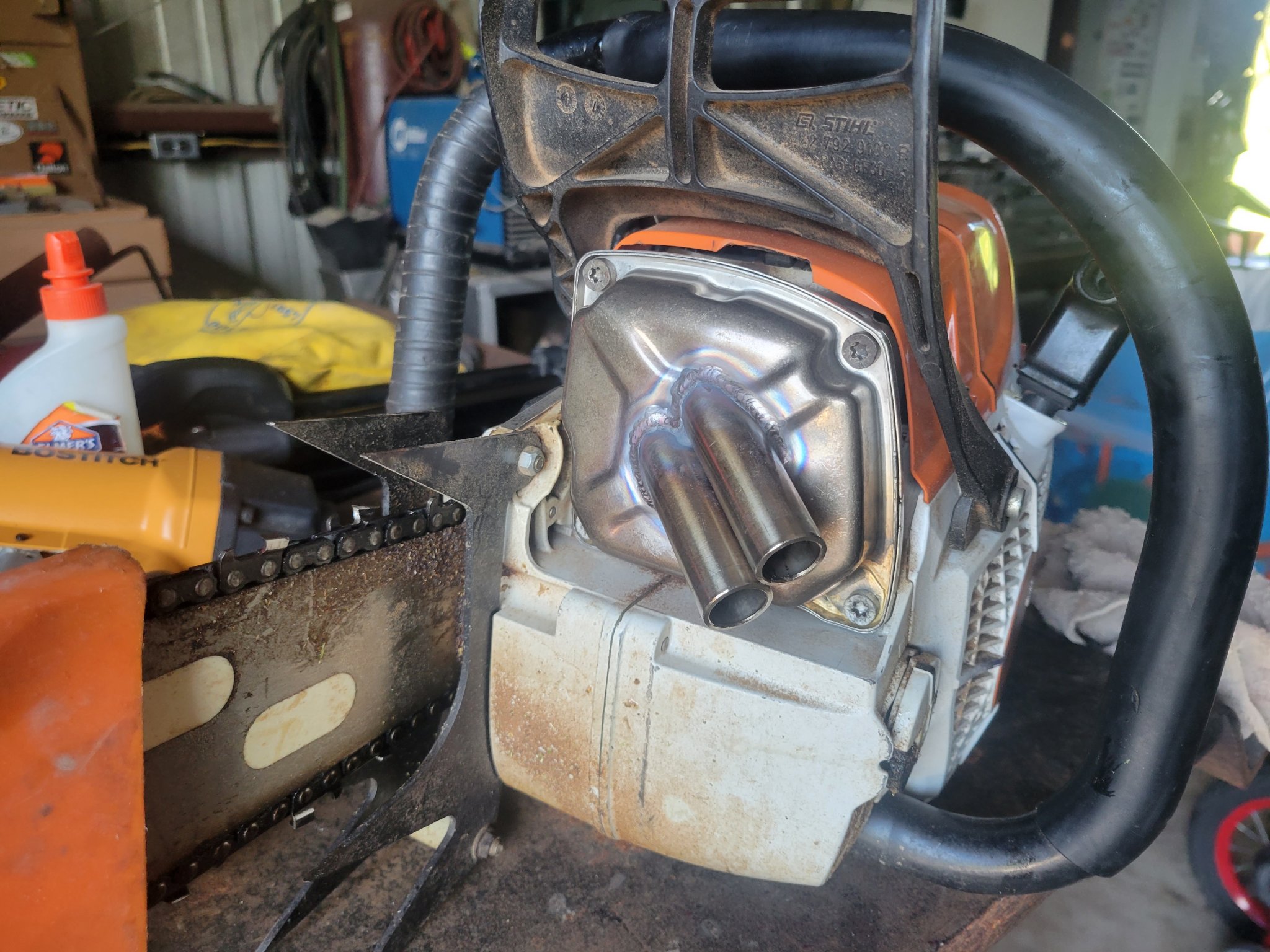

Maybe we can get Tbac to make a muffler for the 261?
Generally they do exhaust ports and different air filters not mufflers. More like asking for a muzzle brake.
Don't have any of their stuff yet. If you've watched any of Guilty of Treeson stuff and seen Gordy it's his company.
I've got his air filter and the three point dawgs on my 462. And I built a knockoff of his bark box. It sounded beefy but I had mixed feelings about the flat front cover on the muffler. Seemed like the saw ran hotter. Now I use a modified version the chainsaw guys buckshot cover. Two pieces of ⅝" tubing, ½" id, put of the front of the cover.
The air filter I like. I chopped the airbox on my 462 to run the filter exposed. After I did that you could feel the difference. If you've ever muffler modded a saw, opening the airbox felt equivalent to that. And I like oiled foam filters.
The three points are nice but they're a little big for my uses. I wish I could get a set about the size of the factory R model dawgs.

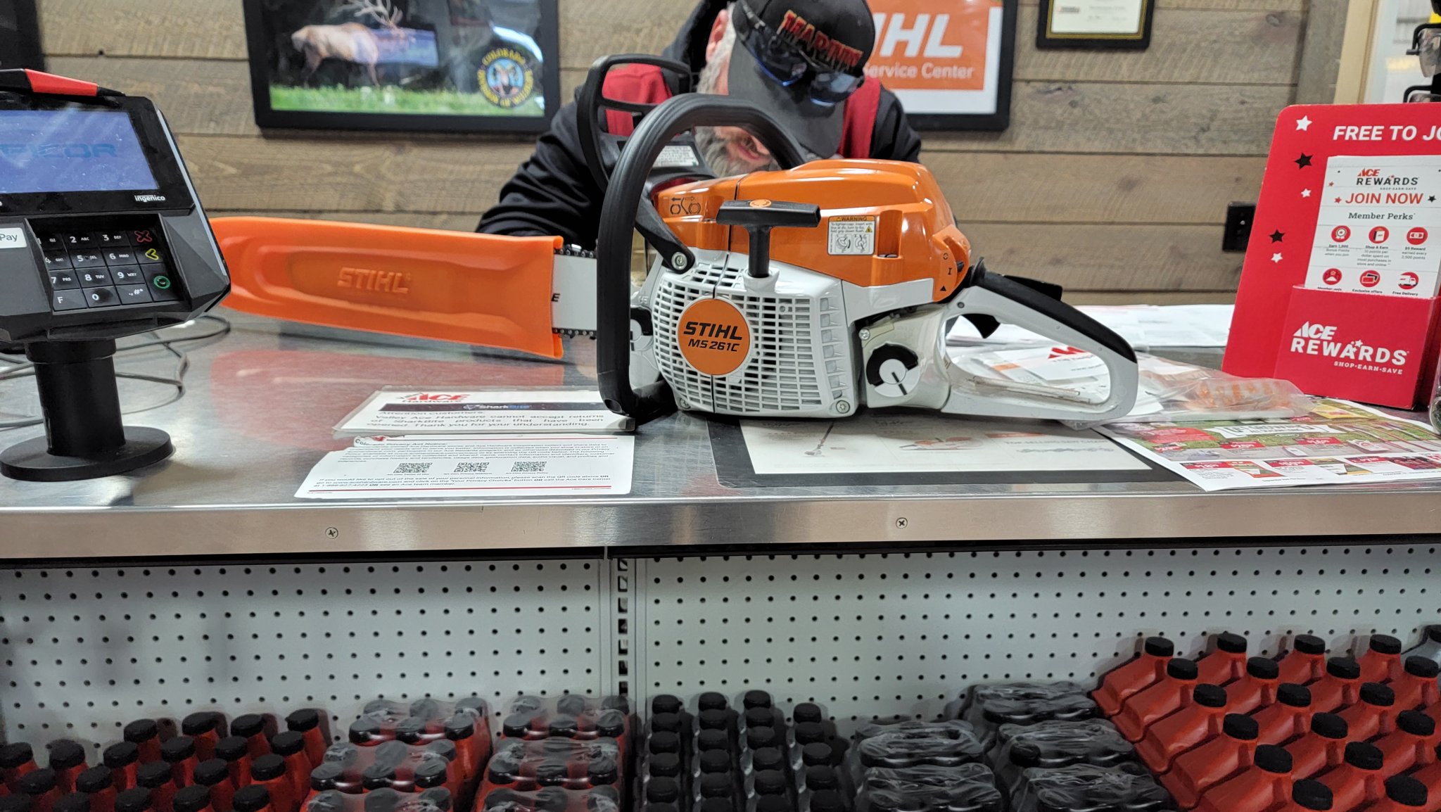

It is always the recommended procedure to let a Mtronic saw idle for about 10-15 seconds before shutting them down. This lets the carb sort of set itself back away from WOT. Doing this helps to not have restarting issues.
My own 261C has had no issues restarting hot (I let it idle before shutting it down) but I’m only at 1500’.

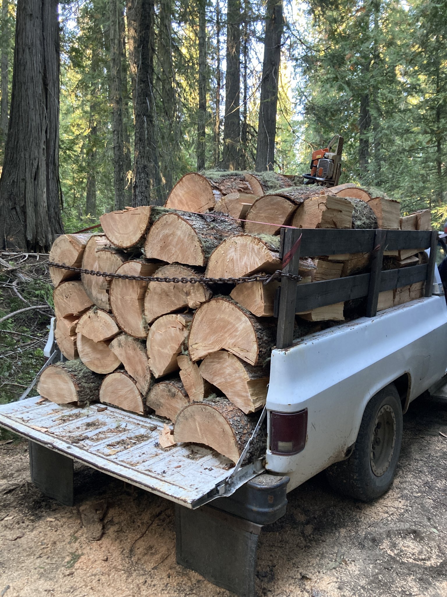

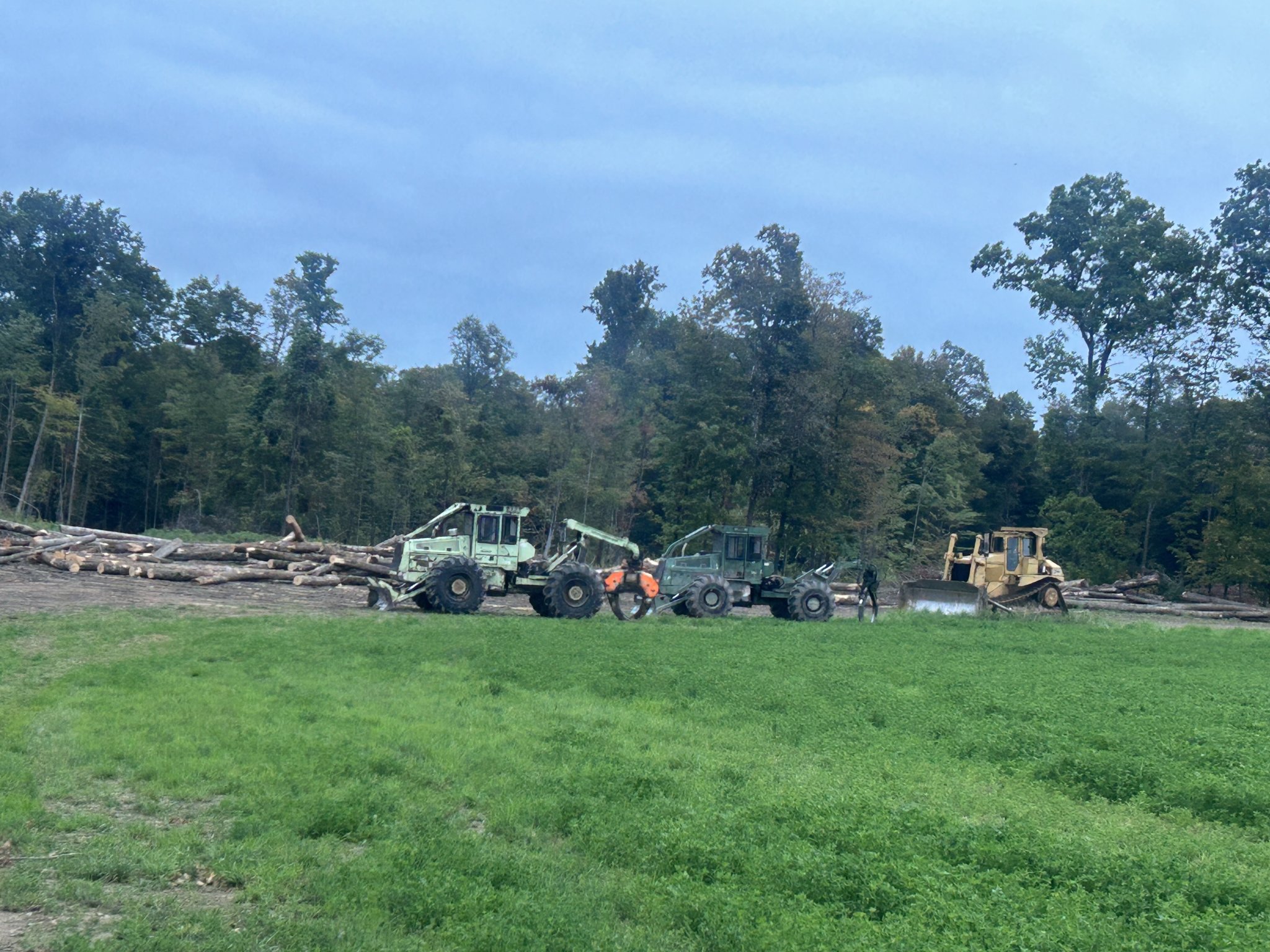

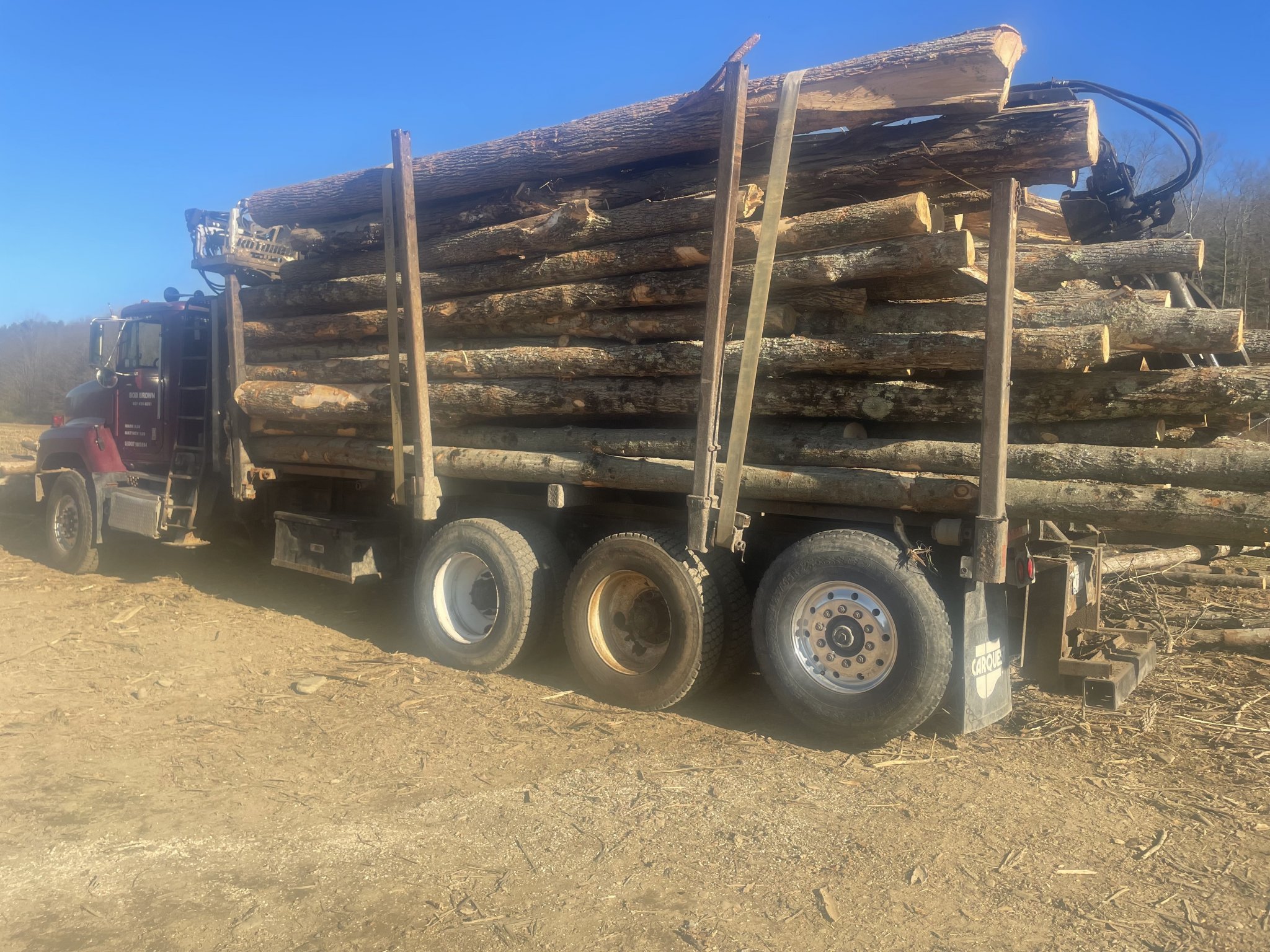

I clear land for a living, clear cuts for farming, about 60 acres a year. I run six saws 2 Husky 395 Husky 365 3 Sthils 261 241 242 I have been doing this for 46 years. I run about 6 gallons week through them, I normally use one of the bigger saws to buck up, and cut down and the smaller saws to limb out. I cut down a days worth of trees, about 60 to 75, pull them out into the field to be limbed out, then skidded over and bucked up into logs, pallet wood and firewood. I cut about 2 tri-axle loads of wood a day. I mention this to give my statement some credibility. I use cheap 87 octane with alcohol, I use Prestone two cycle out board oil mix bought at Walmart. If you read any of the the oil mixes sold by the saw manufactures the all say their oil is made by others. As best as I can tell Husky oil is made by Prestone and just re bottled. I figure as a rule of thumb to put a little over a 1000 gallons of gas through a saw before it is worn out. I have over the years tried different mixes, high test and different grades and different mixing oils. This combination of oil, I would guess I am probably about a 45 to one mix on the oil and have been using the last 12 years to work the best. Most of the time when I lose a saw, I have run it over, crunched it with a tree in the woods or landing when a log rolls over on it, every mistake you can make I have managed more than once. I have only had motors go in two saws out of the last 20 or so saws. When they are worn out by me, they are pretty much whipped all around and not worth rebuilding. I rotate saws, making sure none of them sits too long, as a rule I go to work with 4 saws every day, one is always in the log truck.

Because my Stihl saw and weed whacker are my “Precious” I only use the Stihl ready mix gas in them. Probably $30/gallon if I did the math. Certainly not for commercial ops just hobbyist homeowners like me.
What’s the word on the Stihl fuel.
It’s an Alkylate fuel, I know that and that part is good if you can afford it. Most folks cutting at least firewood can’t afford it so not a lot of empirical data.
