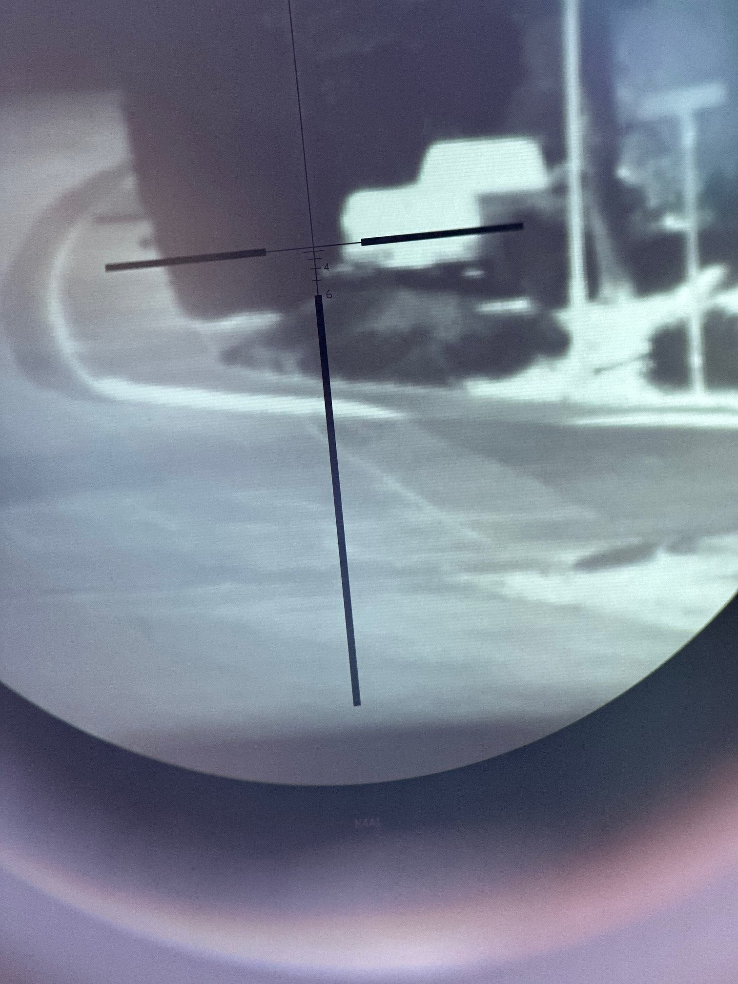

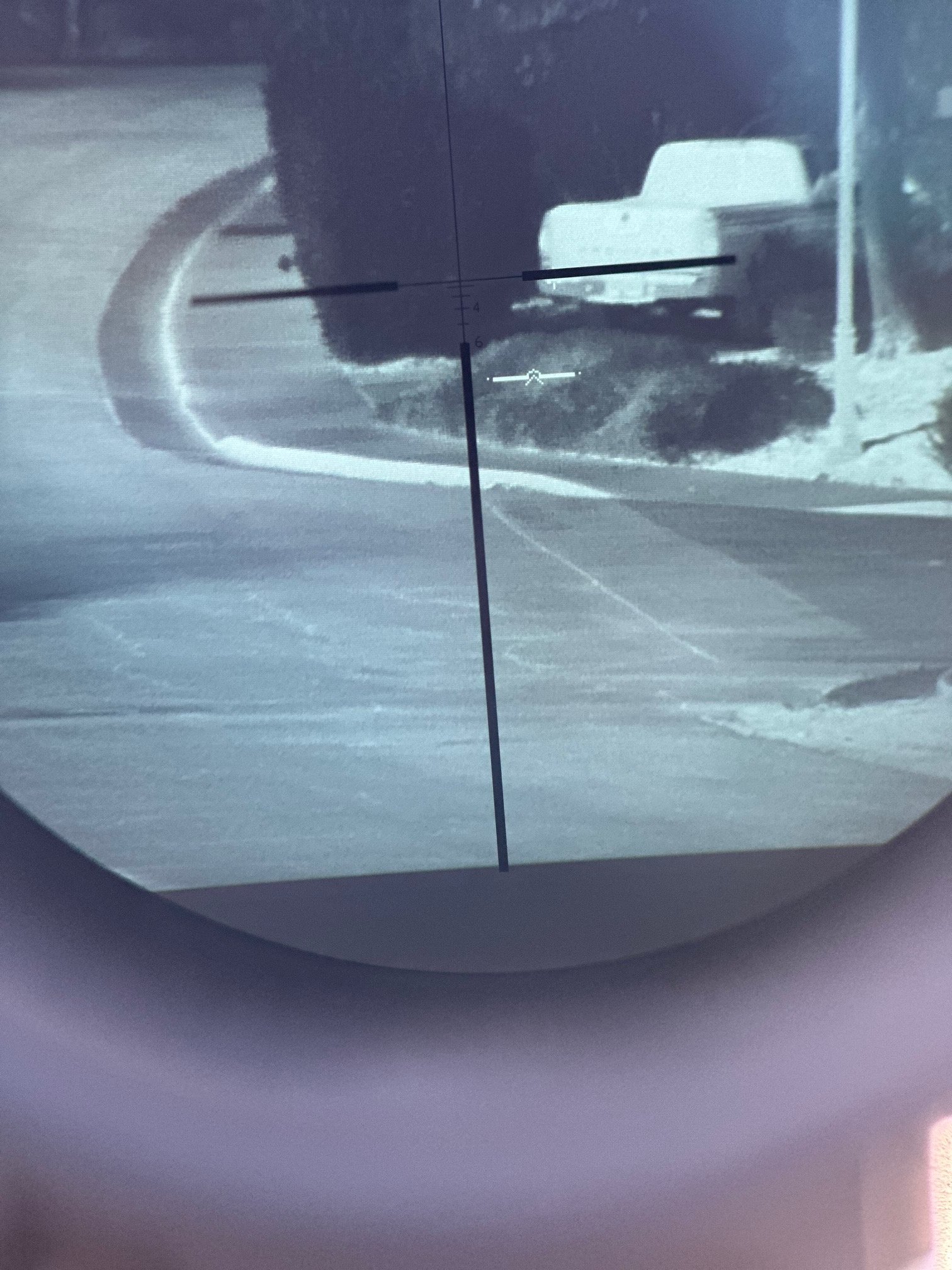

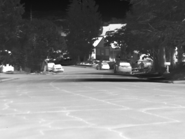

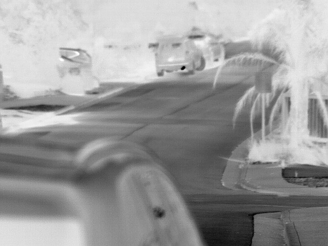

Ok, so the old SF model ACOG isn't ideal for taking pics behind because my phone adapter won't fit it, but here's just a quick couple of examples of the image between the two devices at 4x, truck is 100 yards.
NOTE: Image I am seeing is cleaner than these two but it should help show the difference from the demag
Voodoo-S
Voodoo-M
So yeah, at 4x there's a little pixelation on the Voodoo-S while the M has none. However, there's a huge difference in size between these two devices and I wouldn't want to try to stuff the M on an SBR. On top of that, the FTS-style mount is 100% the way to go with these and that's also where the S jumps ahead. It's so fast and easy to flip the S away and back vs the M.

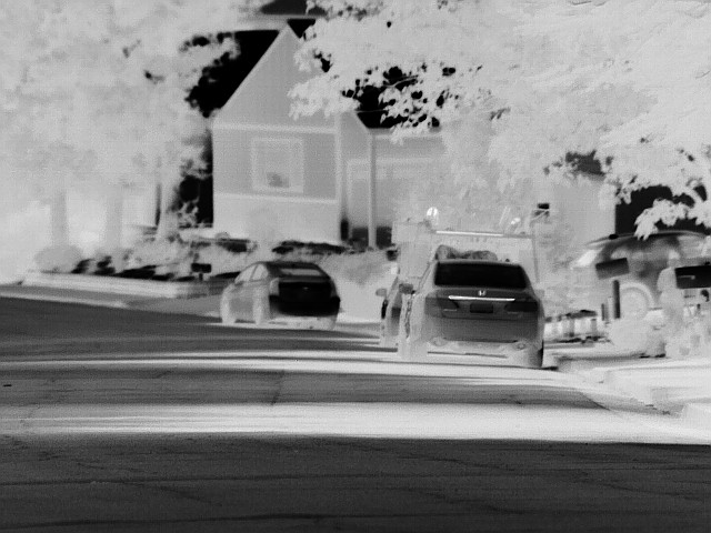

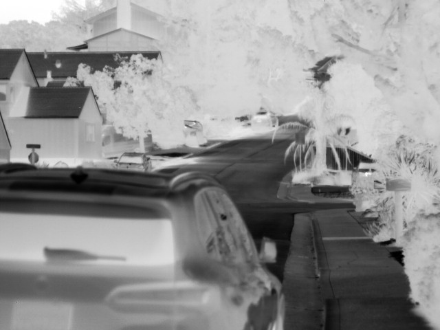

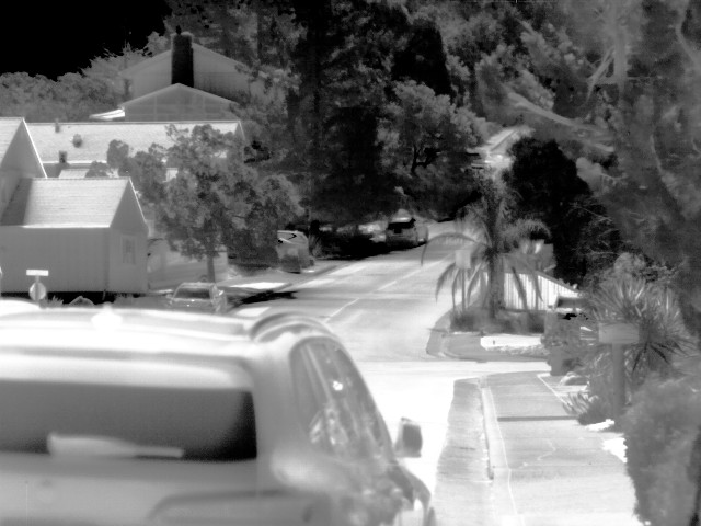

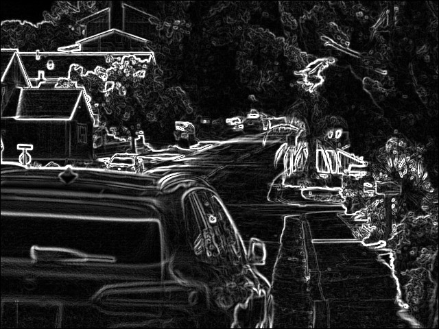

Also, the white outline mode is REALLY damned good for detection.

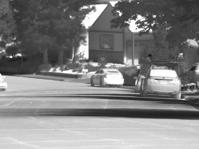

This is busy AF because it's a hot day in the neighborhood, but I often take the Voodoo-S when I do early morning hikes with the dogs in the woods and this White Outline mode is superior to any COTI outline mode I've used. Early in the morning when the environment is pretty neutral, it REALLY makes critters pop in the distance - much better than White/Black hot modes.

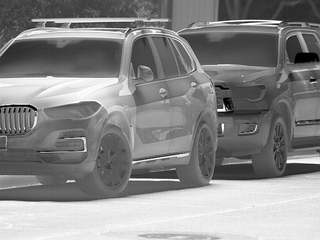

Gratuitous BAE core shot...
Voodoo-S
Voodoo-M
