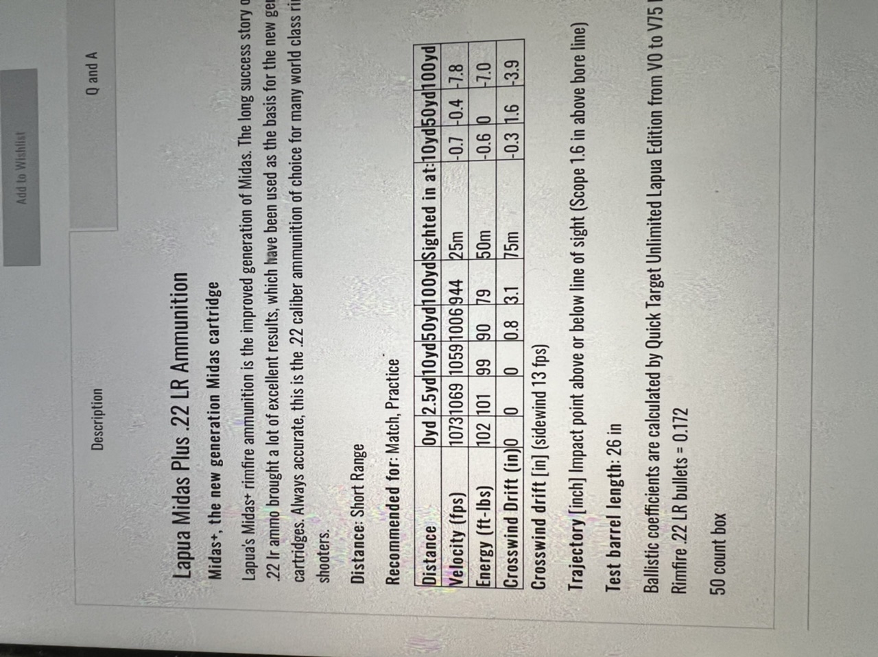

Dang, that's kind of slow. I'm getting ~1083fps with SKPM out of my 20" MTU. I would expect SKLRM to be closer (or above) 1100.

If velocity is important I'd go 18-20. If precision and accuracy go longer.
A 22rf burns all of it's powder by 16" or so of barrel length.
Longer barrel doesn't guarantee better accuracy. If your running iron sights on a position rifle...then the longer sight radius will/can help you. If your running a scoped rifle...in my opinion shorter is better. Get the bullet out of the barrel the sooner the better.
My scoped guns I'm running 18" mostly like on the 10/22's etc...my position gun built on a 52D that is primarily scoped barrel length is 21". Off the bench at a 114 yards that gun will print consistent groups in the .6xx's.

Bore and groove size and chamber or a combination of those will effect pressures and velocities.
Most of your match rimfire ammo is subsonic ammo velocity wise to begin with. You don't want it breaking the speed of sound.
