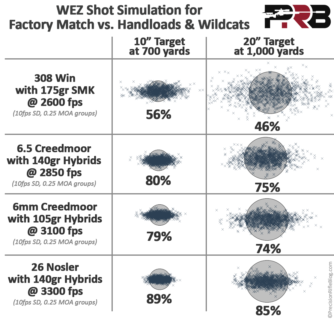

.308 has the advantages of good barrel life, and good recoil feedback so that you don’t cheat the fundamentals. It will make you a good wind reader. It also is an effective round for killing things. These are all good things.
If we are shooting at 2 MOA steel which is ~0.6 mils and we want to talk about a 2 mph wind calling error then traditional 308 bullets (175 SMK and 178 AMAX) start to fall out of the error envelope around 650 yards. Aiming at the middle of the target and that 2 mph missed call pushes the bullet 0.3 mils and you miss. The new 178 ELDX breathes some life into the round and makes it more competitive, but it is the older rounds that are typically compared to the 6.5 bullets in statistical models that simply can’t be argued with. Run the math on your target size and how much wind blows it off target. A hit is a hit with a 6.5 on steel even if it caught the edge while a .308 sails 3” to the left is still a miss. This logic can be applied to other occupations too.
Reactions: camocorvette
Yeah what Conrad said. Windage "delta" is the cause for misses most of the time. Error in your guess on wind vs. the real down-range conditions.
The .308 can come close, but is never better than the 6.5 in that regard unless you take the best or better end of the .308 vs. the vanilla or mediocre 6.5's. If you apply the same technology, rifle parameters, etc. to both calibers, the 6.5 creedmoor gives better performance in pretty much every regard other than barrel life.
It does have an effect on hit percentage because I've watched several acquaintances and friends swap to .308 for a year of PRS/NRL shooting and they fall several positions on average from where they usually place in those matches. Do they out-shoot a lot of people with 6mm's and 6.5mm's? Of course. But the same guys come back next year with their 6's or 6.5's and place back where they "should" be, several places higher on average.
I don't think anyone ever said it will mean you don't hit "anything". You will miss more, though, statistically speaking. Just the way it is. .308 is capable, it's not like you're better off having nothing if you can't have a 6.5... but given the choice, and the only thing holding you down is some dies and brass, I'd swap. I do almost every barrel anyway.
ETA:
To speak back to the OP's original question. You can sell projectiles, and if you have new brass (or even 1-2x fired) you can recoup some cost on that. Varget is a common powder and can be used in other calibers... or save all you have and go back to .308 if you don't like 6.5 down the road.......
Whatever performance you want with 155 ELD's in whatever barrel length .308, play with a real 6.5 bullet (140 ELDM or 147 ELDM, for example, not 120's) and adjust velocity accordingly to get the same super-sonic range, or whatever... You'll notice you don't need such a long barrel, or on the flip side the same long barrel will make it that much easier for you.
Brass costs pretty much the same and there are several brands of high quality stuff for both calibers. Bullet cost is pretty much identical, powder cost is pretty much identical (tiny edge to the 6.5), primers are identical.
Again, the only downer is you'll get 2500-3500 rounds instead of 3500-5000. And that depends a LOT on the loads you shoot. Run a 26-28" barrel with moderate 6.5 loads and you can get ballistic performance will still be better than a screaming .308.. in which case barrel life might be more similar than you'd think...
http://precisionrifleblog.com/2015/04/25/how-much-does-cartridge-matter/

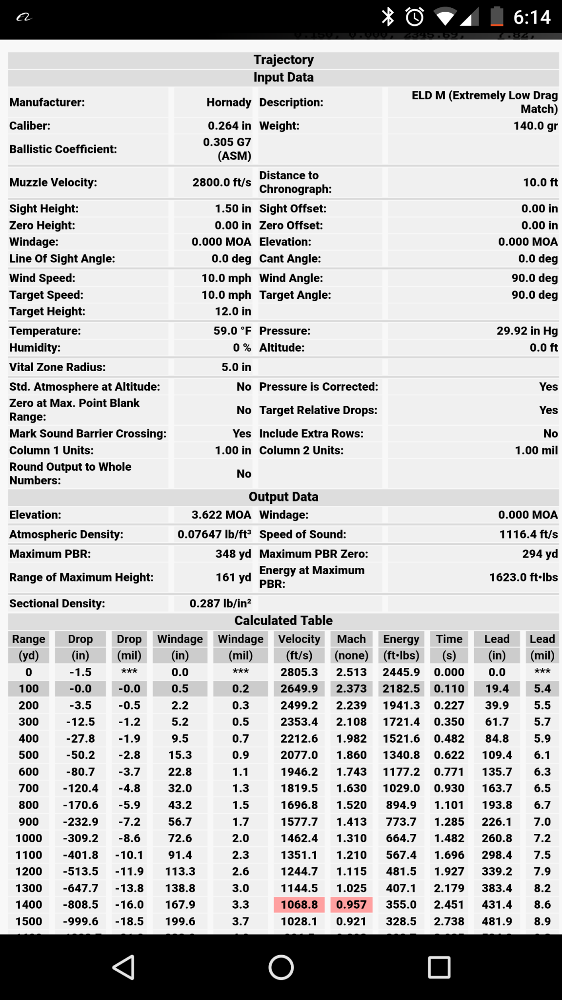

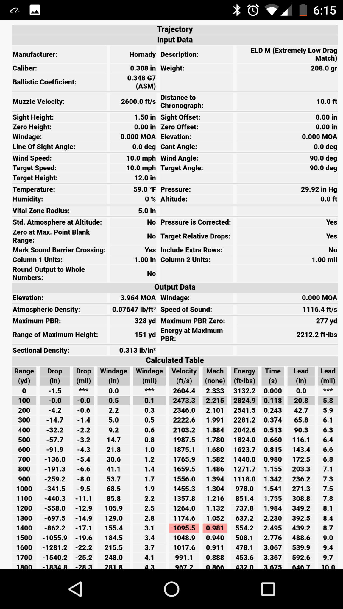

You’re not going to get anywhere near 3000fps with a .308 155 in a 24” barrel. You would need at least a 28” but more realistically you would want the full 30”, which is standard in FTR, to see 3000fps with the 155.
I run a 22 inch plus brake w a 308 and i have ran 155 Scenars @ 3000 and 185 Juggernauts to 2735 average verified w a Magnetospeed. Yes they are hot loads in Lapua LR brass but no signs of pressure.
I'd be sending that Magneto in for repair.
In my 22" .260 my hot loads were 140 ELDM @ 2837fps avg. on a magnetospeed. Run that next to your .308 loads. Not picking fight, just giving up relevant data points.
People shoot 6.5 because of recoil not ballistics. You can get a high BC bullet in 30 Cal. but it will weigh 200+ grains. If you just need to make a mark on steel during a competition then 6mm 6.5mm are always going to be an advantage because of recoil and following your shot.
If you compare apples to apples such as a 24" - 26" 308 WIN shooting a 208 ELDM to a 24" - 26" 6.5 CM shooting a 140 ELDM then the actual differences are zero on the wind correction and marginal on the elevation. I have several of both and the only major difference is recoil. (See JBM Attachments)
If you are going to shoot 155s from a .308 then a 6.5 will always have better ballistics and less recoil.

I agree w a FAST 6.5 at extended 1k plus is superior but out to 1k in my experience w fast 155 or 185 jugger making first round hits or shooting tight groups is very doable.. go out and shoot. If you truly believe it is not feel free to meet me at Sheepdog warriors in Catskill NY on a weekend and you can run my GA Precision w my handholds. This started w the 6.5 CM and the 308 win not the fast 6.5/7 w bullets in .700 plus
Bullet mass is a component of BC just FYI. So it's factored in.
I should have explained little more in depth. A high bc 6.5 bullet/lighter mass will not rock a steel plate like a lower bc/heavier mass will at long range. I have shot deer at 500-590 yards w the 6.5 and 308. The reaction and terminal damage is always higher w the heavier mass. Sorry I'm going from my life experiences not from a program or a internet warrior LMFAO. You may have experienced diferently

With that said, anyone arguing that 308 can compete with a 6.5 is out of their mind. The only way they compete is when you compare one of the worst 6.5 projectiles to one of the best .308's.
You guys can argue back and forth all you want, but you can't argue with results.
Yep. On the absolute scale the .308 is capable. Nobody (that knows anything) is going to argue there. However, the 6.5 out-performs on every apples to apples (or as close as you can get) comparison. Less recoil, less elevation, less wind, less wind/range delta, higher hit probability, longer supersonic range...... Again, only at the cost of barrel life.
I've experienced no noticeable difference in the two honestly. Other than more hits with a 6.5. We all have opinions and that's fine. You don't need to justify anything to me. You just stated you weren't sure if the ballistics programs took mass into consideration and I was just informing you that they do.
I agree with you. I like to shoot the 2156 and have no issues with it to 1000. My 308 serves its purpose perfectly.
