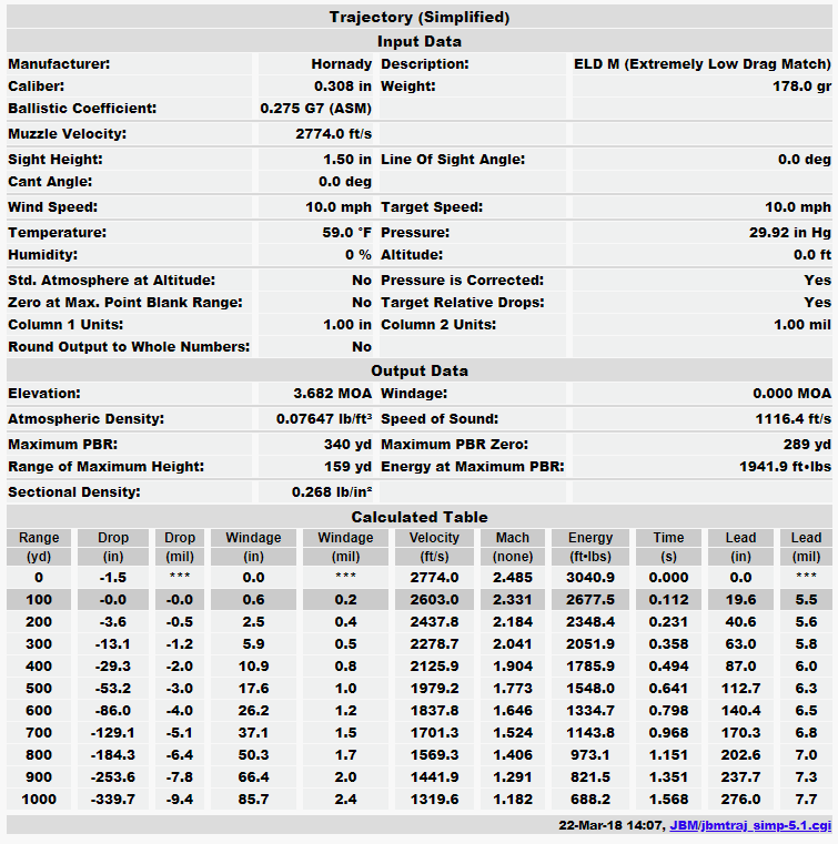

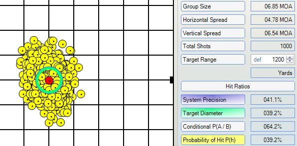

Something to consider Spife.. and I edited this into my earlier post...
The 178 eld vs. the 140 eld comes with the 6.5 having a pretty good performance increase.
If you put them closer in performance, using the 185 juggernaut for example, the .308 costs more. The margins are very close and are very variable depending on how you treat your brass etc.

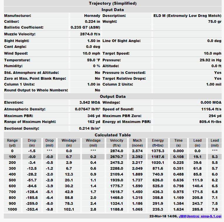

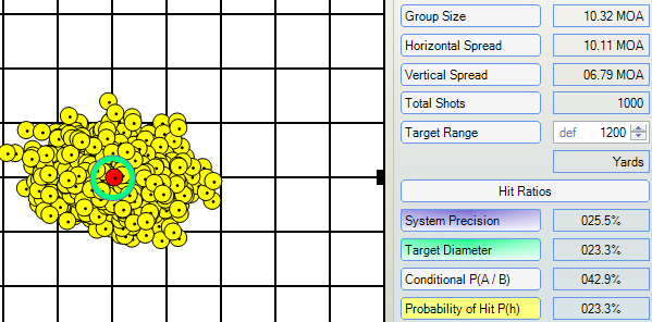

75 ELD
21.49/100=21.49 cents per
8208 XBR
189.99/8/7000=.00339 dollars per grain
22gr*.00339=7.5 cents per round in powder
21.49+7.5=29 cents per shot
Lapua 223 brass
63.99/100=64 cents per
300 pieces*.64=192 bucks
192/4000 shots=4.8 cents per shot
CCI 200
34.99/1000=3.5 cents per
29 from above+4.8+3.5= 37.3 cents per round
600 per barrel/4000=1.5 cents per round in barrel life
38.8 cents per round in 223 barrel life. 38.8*4000= 1552 over all cost to shoot out a 223 barrel.
6.5=2824
308=2452
223=1552
2452-1552=900 more too shoot a 308. Thats a 57% increase to shoot 308 over 223. The following charts show that @1000 yards the 223 will drop 9.8 mils and drift 2.8. The 308 will drop 9.4 and drift 2.4.

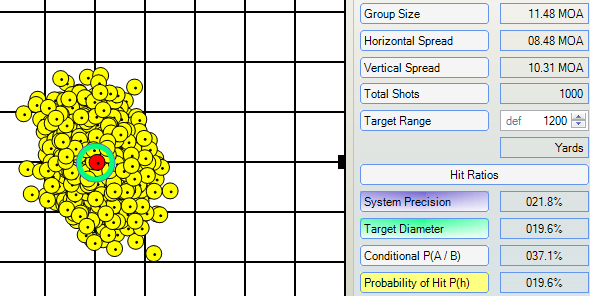

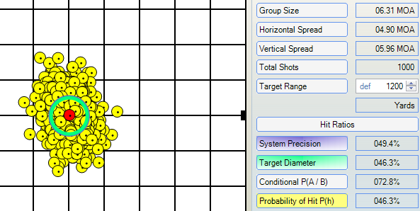

So based on some of these arguments that a 308 works well enough and is cheaper too boot than a 6.5 (again, we're not discussing the OPs sunken costs at this point in the thread)... wouldnt the 223 be even more desirable as it both drops and drifts only .4 mils more and is 63% of the price. So if you can live with giving up the performance of the 6.5 over 308 because the cost benefit isnt there is with a 6.5 how can anyone honestly argue for staying with a 308 over 223? And dont tell me because the target will swing ever so slightly more. Just a point to ponder if we are thinking that an increase in performance in inconsequential.
If we take the cost of a Juggernaut bullet so that there is no trajectory benefit to a 6.5
185 Jugg
58.99/100=59 cents per
That calculated in ends up giving us a price of 3412 to shoot out a 308 barrel.
Thats an increase in cost over a 6.5 of 588 dollars, a 20% upcharge.
So you can spend even more on shooting a 308 to equal the 6.5 or you can save money and be nerfed. Personally I would go for the 6.5 and its litany of benefits at the middle ground in cost. As most would from the get go as has been addressed. We are in this game to hit things after all, not to just pull the trigger. (Sorry I forgot you mentioned that on your earlier posts mcameron, recency bias in the chronological post order lead me to jump in without realizing you had said fresh from the get go you would lean 6.5)

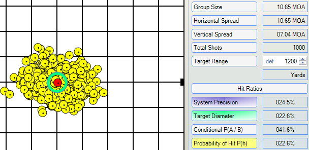

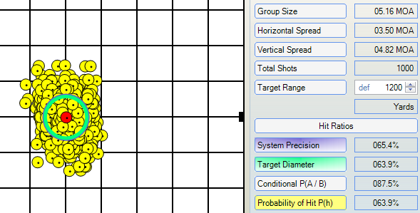

Ranging a target is typically not the issue it is wind so the BC numbers of the larger calibers typically make up for the lack of velocity and the smaller calibers make up for lower BC with velocity.
I dunno, lots of the matches I've been to have had incorrect ranges in the course of fire match book. Two weeks ago at a PRS ELR match our entire squad spent 15 minutes debating whether a target was at 840 or 940 yards because of the way it was placed on a knoll with a ridge behind it. And this was with a $10k vectronix on a tripod and some of the best shooters in the country in our squad. There were steak dinner bets made and it wasn't until the second day that we had the correct range nailed down. And a little over a month ago we had a match where weather conditions made ranging targets extremely difficult. Everything was unknown distance, we shot the match anyway, we ranged targets when there were breaks in the rain, and we shared dope on what we were getting hits with. Huge disadvantage to be shooting a 308 in that situation, even though most everything was inside of 700 yards.
Other issue to consider with range is that the slow 308 is going to have roughly double the vertical dispersion of the faster 6mm out at the farther distances, assuming equal SD/ES. That makes it more vulnerable to missing because of ranging errors, updrafts/downdrafts on a hillside, etc. We see a fair number of targets that are animal shapes, maybe 2.5-3MOA wide but only 1 MOA tall. You've got to have your range and vertical dialed in solid when shooting those targets even though you've got a cushion on the wind due to target width.
I am just quoting general velocities that I typically see and have personally used. I get over 2600 from my 24" 308 with 208s and I get a little over 2800 with 140s in my 6.5 CM and over 3000 with 105s in my 243.
Not saying that your 308 vs 243 velocities aren't possible, just that they aren't equivalent. You can also make a 243 with a 105 go 3200 fps if you want. If you run heavies in a 308 it can get much closer to a 6 or 6.5, but it's not quite a level playing field ballistically. And the 308 is going to be harder to shoot well.
Not hating on 308, I spent the whole 2016/17 match season competing with one including using heavier bullets. Just being realistic about what you give up when you choose to shoot it.
You can get 308 to match wind and elevation goes through the roof. Or you can get it to be comparable in elevation and windage falls to pot (relatively). You can't match both without fancy solids.
A 147 or 155 6.5 beats a 208 .308....
You can't get around it. For the same BC, the 6.5 is faster. You can get higher BC 308, but you have to go 215-240gr where I'm pretty sure muzzle velocity holds you back on supersonic range, elevation, etc.
Reactions: steve123

Yes. If you want to increase your overall possible precision by about 8% from 900 to 1500 yards then the 6.5 CM is the gun for you. If you already have a 308 and are not shooting in rifle competitions that require a low recoil rifle or you need energy on a target for hunting etc. then I would just stick with 308 and maximize it and shoot it well.
6.5 CM - 147 ELDM - 2800 FPS - 1 MOA Target @ 1200 Yards
308 WIN - 208 ELDM - 2600 FPS - 1 MOA Target @ 1200 Yards
Reactions: StraitR
I believe your numbers show a 25% improvement, not an 8% improvement. 25% more hits is not what I would call being anywhere near equivalent.
They show an 8% increase in hit probability but you can market it however you wish. Like if your gun only hit the target 1% of the time and I had a gun that hit it 2% of the time then my gun 100% better than yours at shooting yet both of us are actually awful. I like to stick to actual numbers and not make relative statements of improvement.
The difference between the two is only 3% at 700 yards and 0% under 700 yards so it really is a situation where you need to consider the cost of changing cartridges and also the pros and cons. I am just trying to help with data and analysis so don't shoot the messenger. Obviously, there are many short action cartridges that smoke the 6.5 CM too.
Also, most people shoot factory 140 ammo at 2715 so I was just trying to make a fair analysis of maximizing each cartridge.
26" - 7mm SAUM - 180 ELDM - 2900 - 1 MOA Target @ 1200
In my opinion this is the best cartridge/caliber combo out there that you would actually want to shoot on a regular basis. It will be my next build. The shooter that can learn to manage the recoil of this round would have a huge advantage over the field and also have a great hunting round as well with great energy at range.

It's probably going to be a 6.5-4s. People load it down to 55,000 psi to promote barrel life but it can be cranked up. A 7.5 twist and 147's at 3200 fps???should be a killer combo.
In my long action, throated slightly longer with a 29", but still loaded with a medium load, 140 hybrids were going 3275 fps. I had to slow the load down to 3175 because the hybrids were blowing up at the higher velocity.
26" - 7mm SAUM - 180 ELDM - 2900 - 1 MOA Target @ 1200 ]In my opinion this is the best cartridge/caliber combo out there that you would actually want to shoot on a regular basis. It will be my next build. The shooter that can learn to manage the recoil of this round would have a huge advantage over the field

I agree that the difference between 1 and 40 is very important but not for the OP so veiw the data in context of his situation. He does not compete at that level and is simply asking what he should do regarding his investment in 308 or start over in 6.5. Unless you are going to max out a 6.5 147 at 2800 and shoot competitive all season then the much simpler and less expensive option is to max the 308 out with a 208 at 2600. Switching bullets is about as easy as it gets.
308 WIN - 208 ELDM - 2600 - 23% Hit
6.5 CM - 140 ELDM - 2700 Factory Load - 23% Hit
