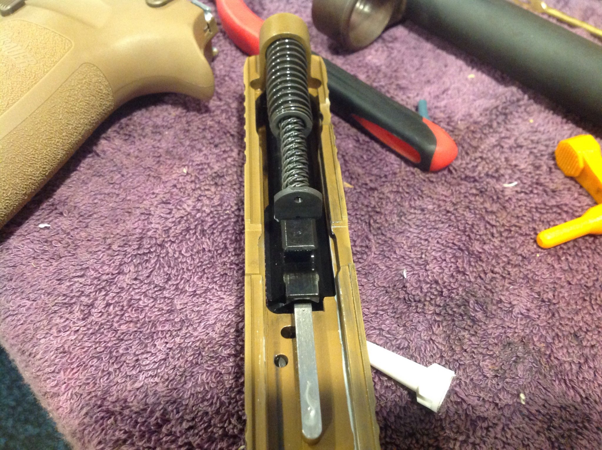

    What am I missing?

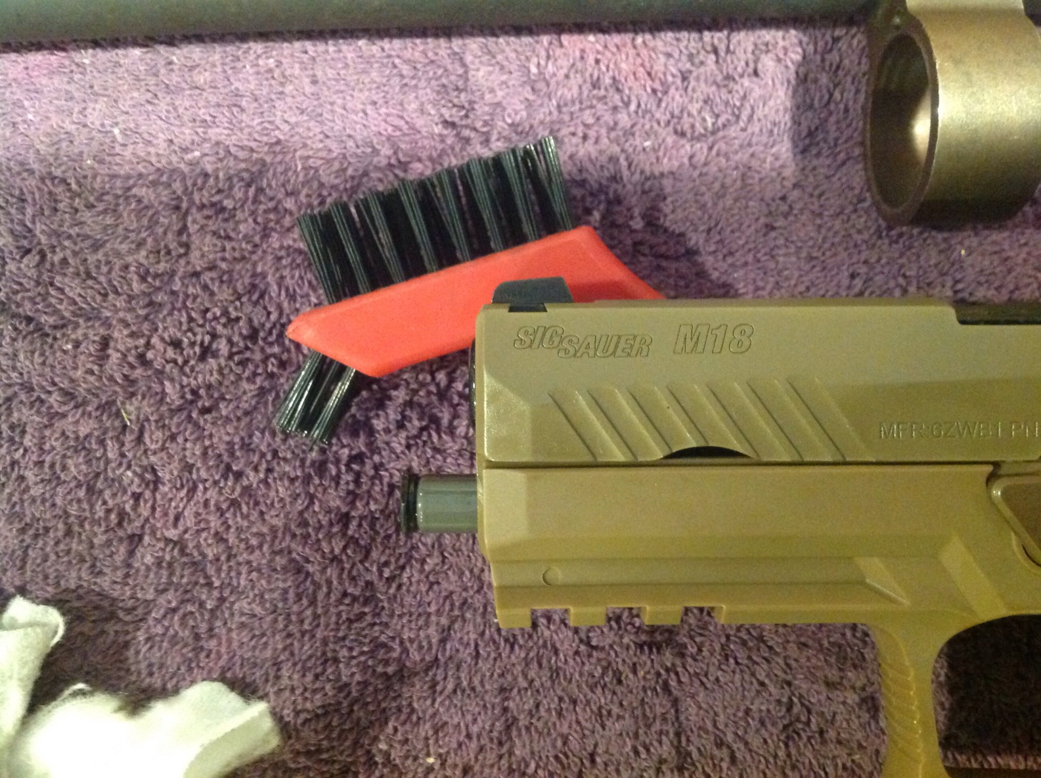

    Took the slide off my new to me M18 to lube it up.
    Pull slide back
    Rotate take down lever
    Let slide ride forward to remove
    Push recoil spring assembly forward to remove
    Remove barrel
    Oil
    Reverse assembly.

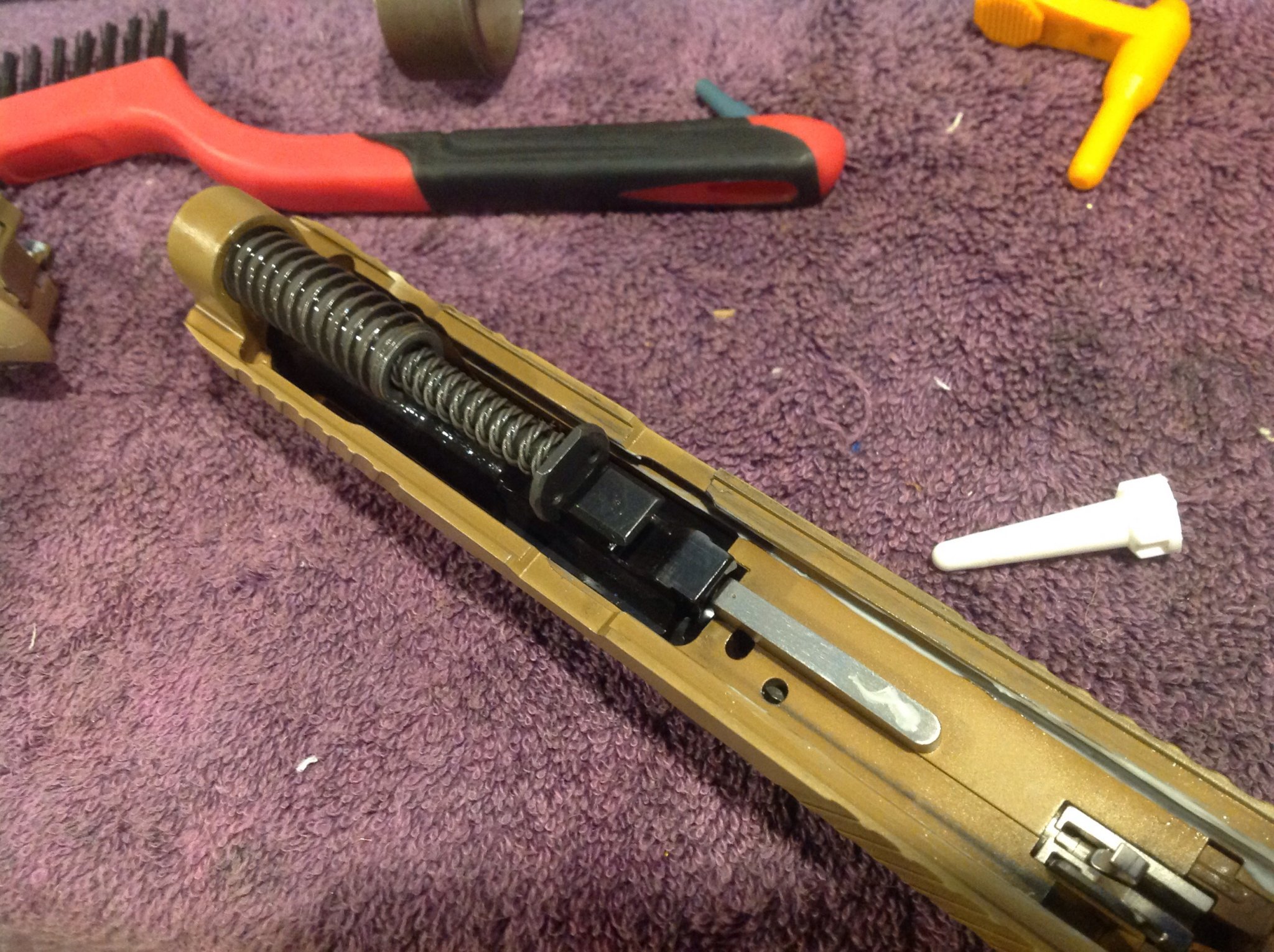

    Now I have this....
    Figured it out....

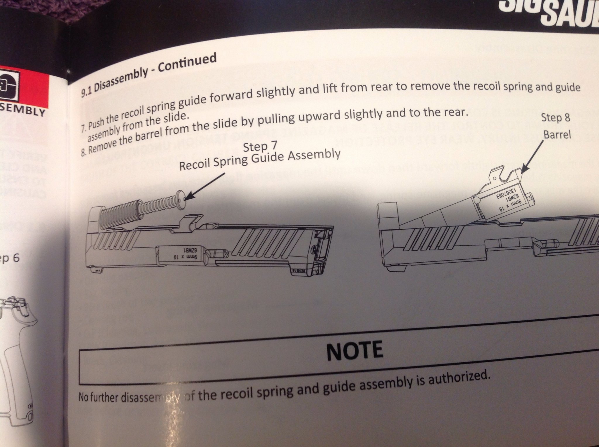

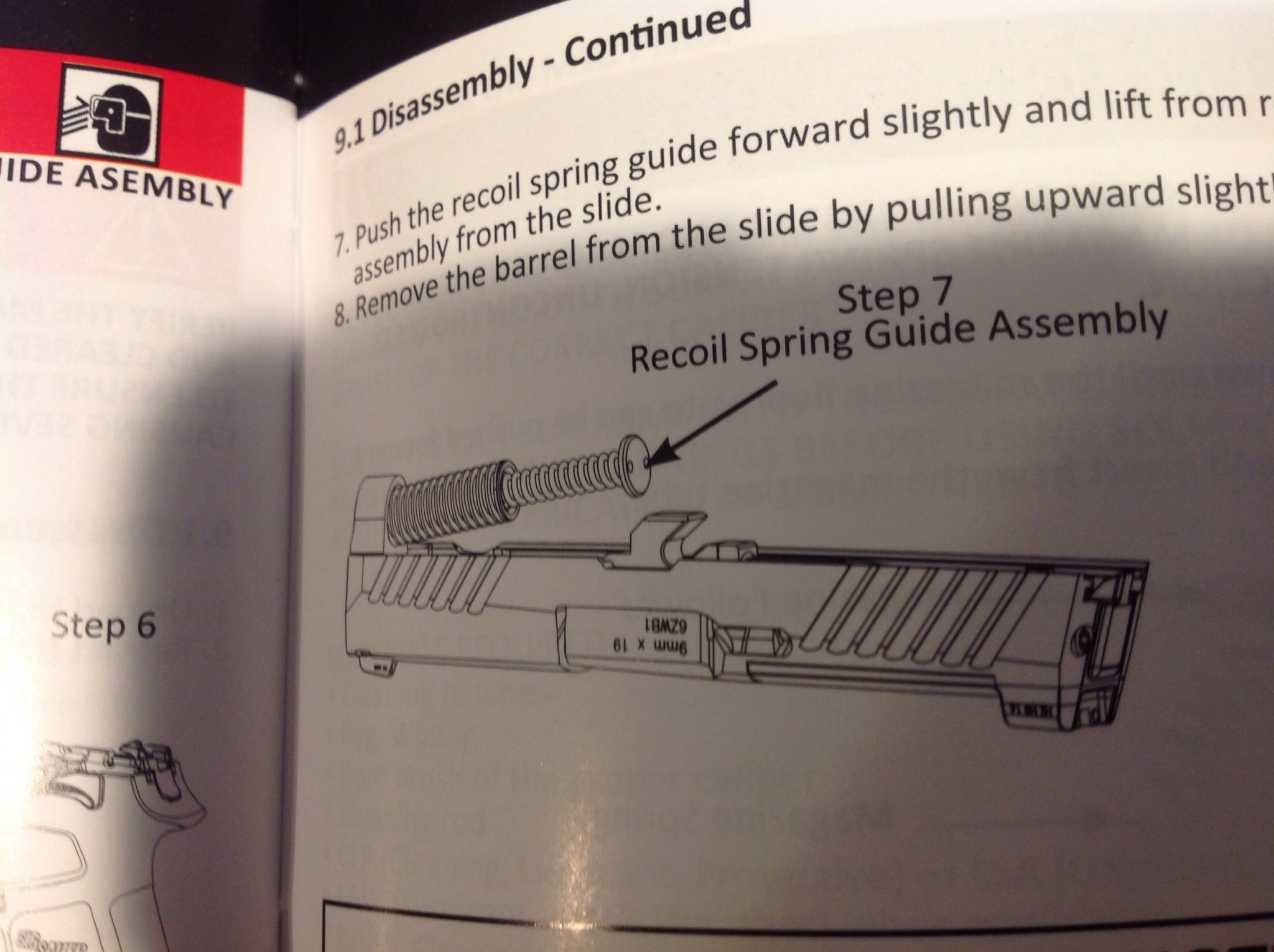

    Directions show this...
    But it needs to be this...
    Hey Sig! Don't even include directions for fuck sake and don't make stupid shit like a recoil spring/guide Rod position dependent!
    Interesting, the drawing doesn't even show the flats on the sides.

    Figured it out....
    So, you are saying you had to rotate the guide rod 180 degrees for it to go in and close? Not change the position, but rotate the rod so those indentations are vertical and not horizontal???
    Just turned the whole assembly 180 degrees.
    I first installed it as the directions show with the pin holes horizontal but in order for it to work they must be vertical with the flats on the outboards.
    It kind of appears logical the flats would mate to the lip of the barrel but that is not the way on this one.
    Worse yet is probably only 20% or so of 320 guide rods are made with the flats.

    What I could never figure out was whether there was any reason to face them in a certain direction with the ones without flats. I suppose probably not, but I have reverted to shooting 1911s so I don't really care at this point. The Sigs are super good shooters, though.

    Don't feel so bad.....I do it nearly every dang time I reassemble mine...
    Wait!!
    Mine is backwards from yours. My flats have to go up/down. Now I'm really confused! Lol. I just triple checked. Mine works with the flats up/down but not to the sides.

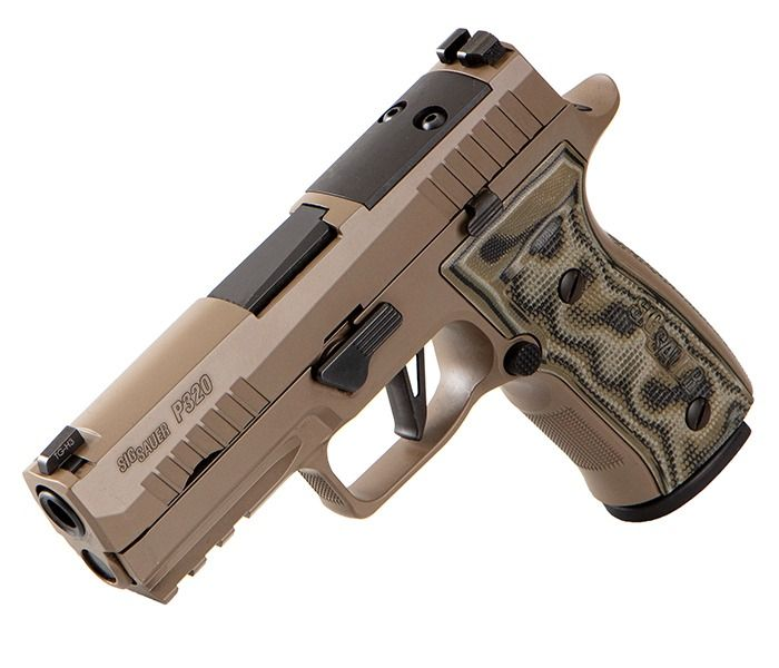

    Checked out the Scorpion...that looks fantastic. Compact size and you get grip options.
    Appears it does away with one of the few complaints I have heard about the M18....
    Only review on the M18 I saw was a Garandthumb thing and he griped about the big rear sight.
    I noticed this yesterday shooting at a 7 inch target at 12 yards. The rear sight blocked my view of the entire target.
    The width of the rear sight on the M18 is necessitated by the screws for the RMR plate coming from the bottom into the ears of the rear sight. Covers the whole top of the slide....
    I see the Scorpion screws the plate in from the top and the rear sight is minimal in size.......much better.

    I have 4 320s and an assortment of slides in 9 and 40. Some have the round end in the guide rod and some the end with the flats. I’d have to go check but I think the difference was caliber specific on mine.
    I just checked. I was wrong. I have one compact/carry 9mm RX slide that has the flats on the guide rod. All my other slides compact/carry and full have the round ends on the guide rod regardless of caliber.
