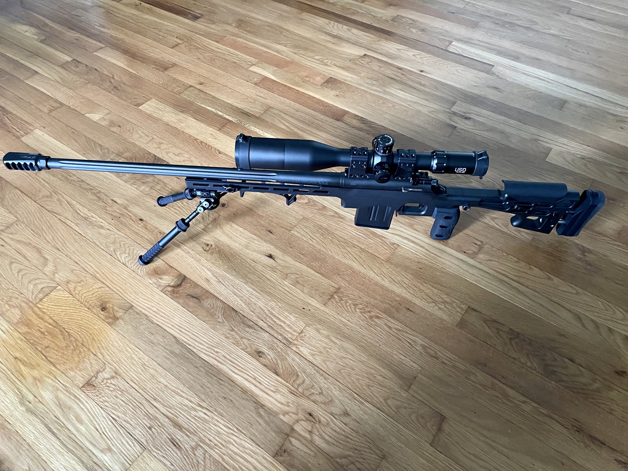

Well I tried the Trigger tech Diamond and it sits slightly too high in the action so there goes that idea. I see how it jams tho, if you bump just the trigger backwards a little bit something shifts and locks it up unless the trigger safety is depressed all the way. I managed to get the trigger pull under a pound tho. I was thinking about pulling it apart but not sure I want that headache.
Reactions: Sleddog30
