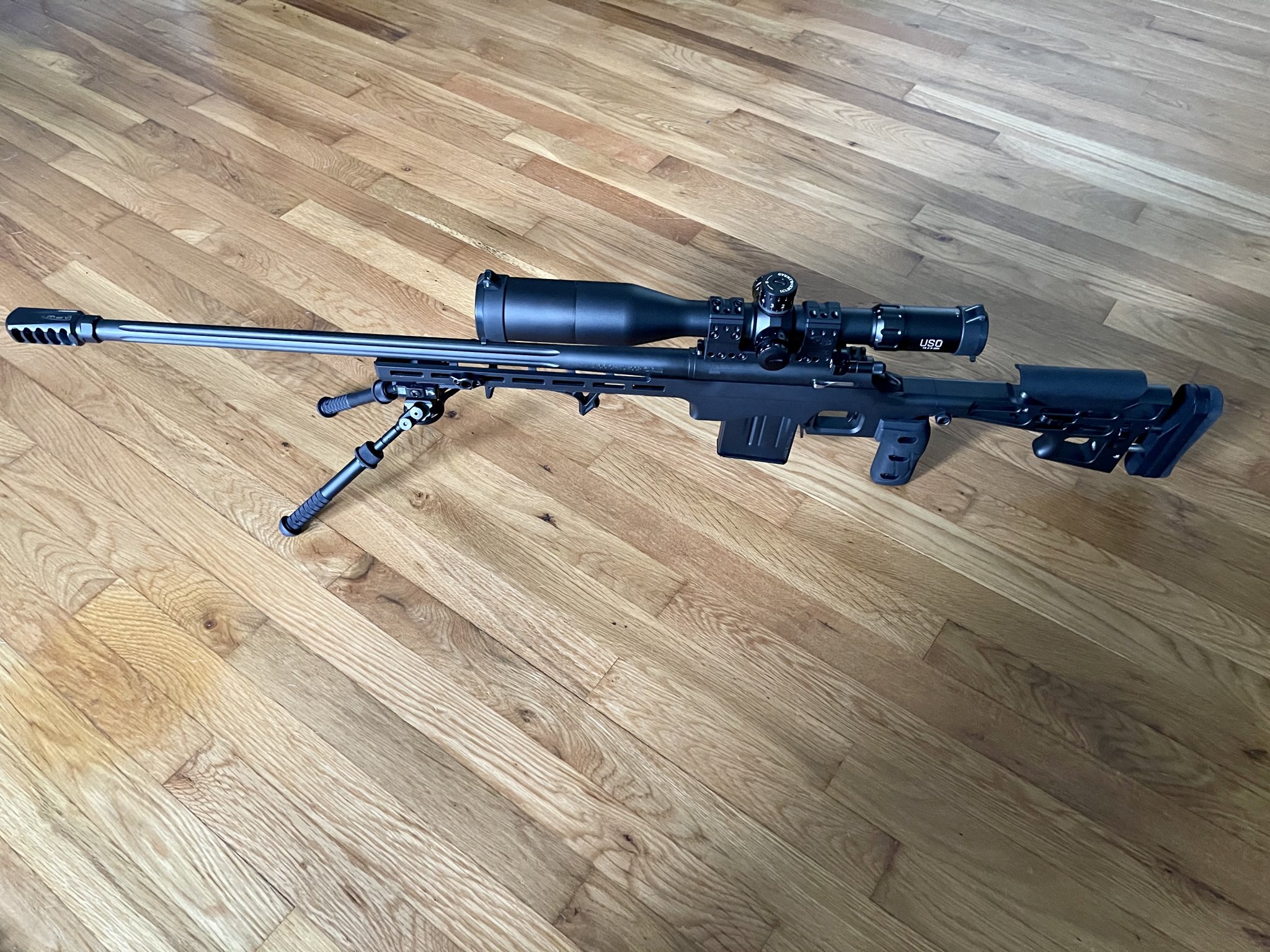

I picked the LRR up to get started in precision shooting and loaded up on the accessories for when I build one.View attachment 7609547
