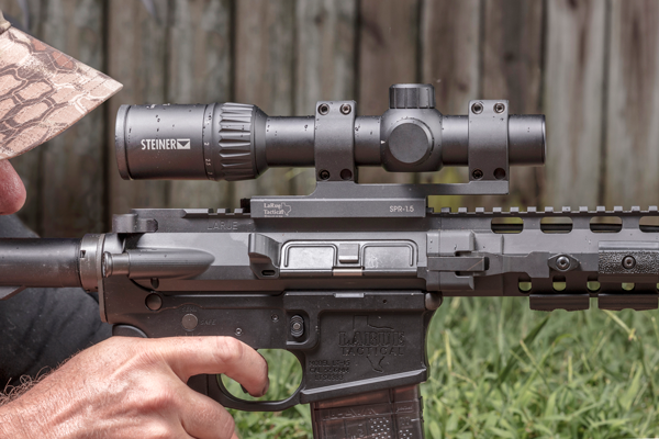

Interesting. I use SWFAs on both my precision rifles so I haven't needed that gizmo. My dry fire area is about 11 yards long across my basement and both my SWFAs will focus that close in.
But since I replaced my Aimpoint with a Steiner 1-4X on my AR, I could use that thing.

Aaaaaand they don't make one small enough for scopes with 30 mm objective outer diameter.
I guess I'll buy a cheap Butler Creek cap, learn the optical equations needed to figure out the aperture size, and get to drilling.

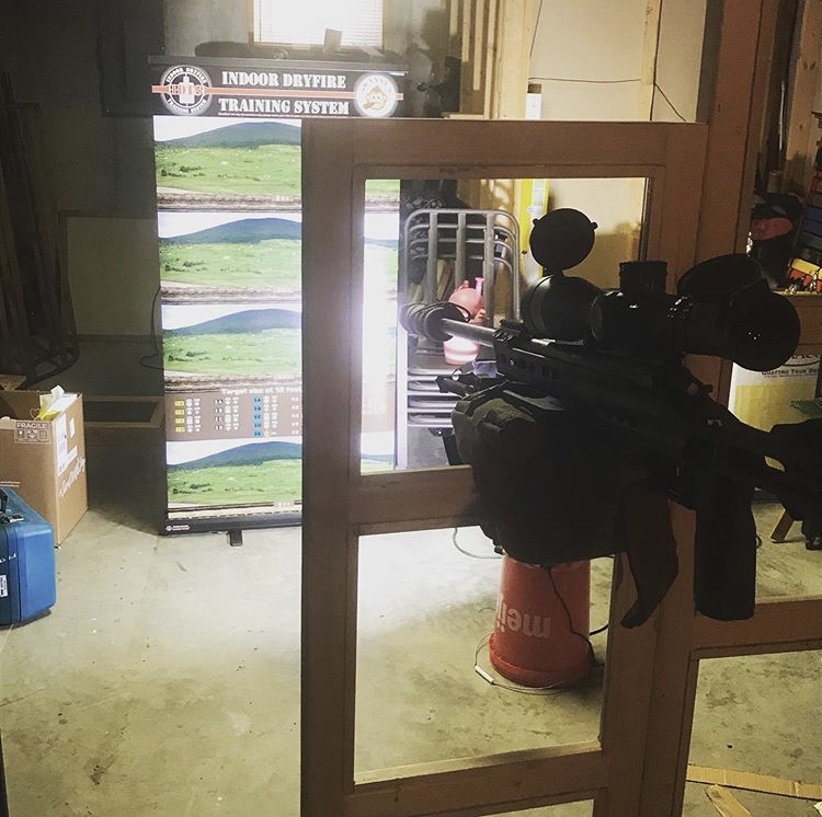

I use it. Really helps with my trigger control. I ended up building my own barricade and get to practice getting in and out of position on the clock. To honestly do this you need to be able to get behind your rifle, acquire your target and break a shot... The DFAT lets you run stages, in you home or garage at you leasure... how could this not be worth it?! Haha

i try to use household objects that mimic getting into the positions i struggle most with, low kneeling and tall kneeling. i've used rubbermaid totes, a folding chair, a sawhorse from my garage, a 10 gallon paint bucket and a step ladder. most are also props that i've seen or actually had to shoot off of in matches.
do you have a tripod? this thread has a good deal of info on building a practice barricade using your tripod
http://www.snipershide.com/shooting/threads/updated-rrs-tripod-barricade-practice-device.6841189/

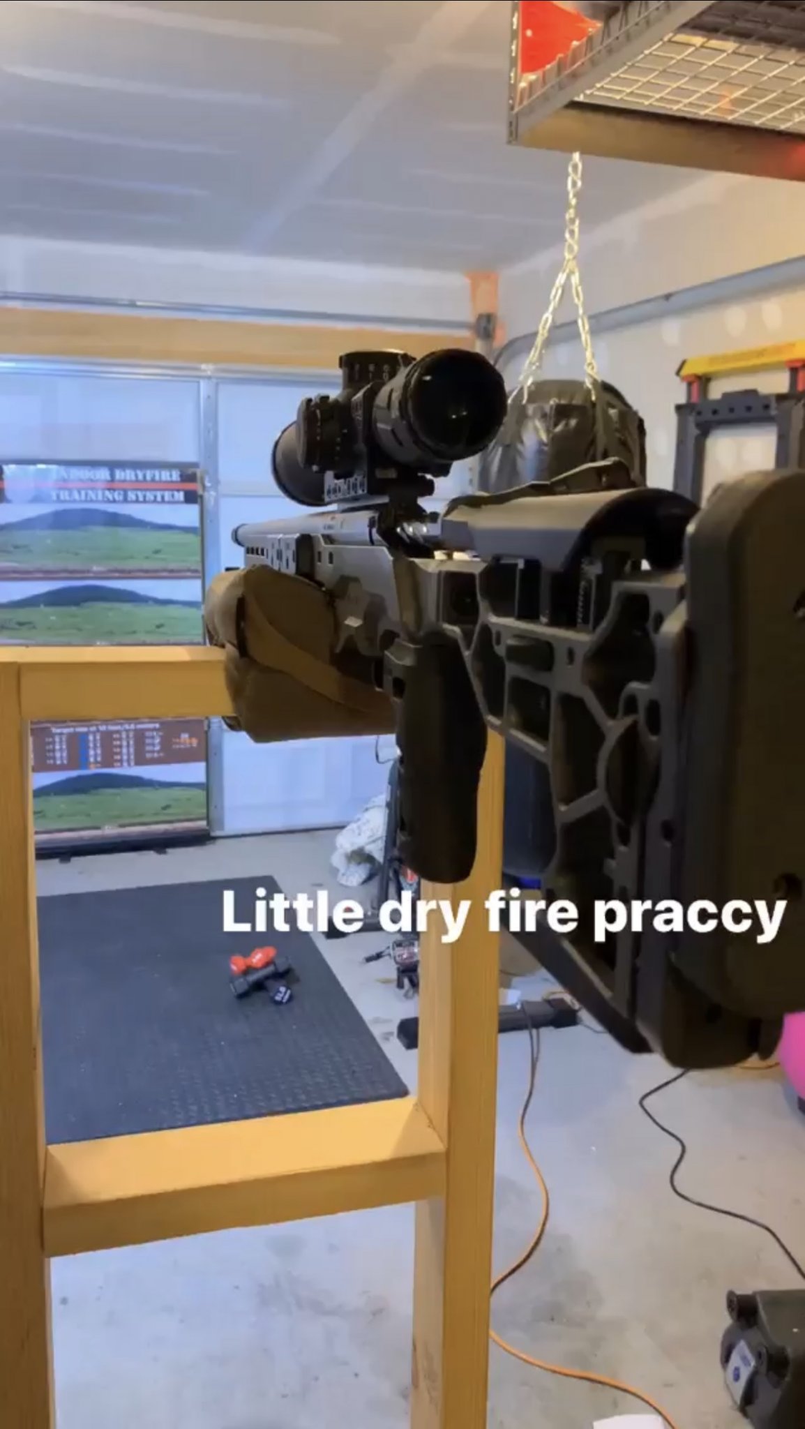

I use a 6’ ladder and 4’ ladder with the DFAT
This DFAT is a solid training tool
Helps keep the dry firing realistic with the variety of targets that come with the DFAT

I use mine almost every night now the last month and a half or so. Seems like it’s helped me a lot on the barricade. I haven’t done and positional shooting since I started to see actual improvement. But I use a shot timer and if your honest with yourself you can get better with it. Plus it’s good trigger time anytime you want to do it and right at home
