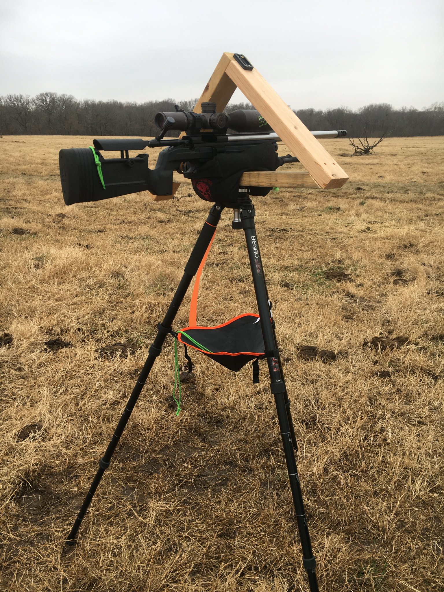

    It approximately resembles the more rickety wood barricades. Of course, it does not let you work on rapid elevation changes like the classic steps, but does give near unlimited elevation choices.

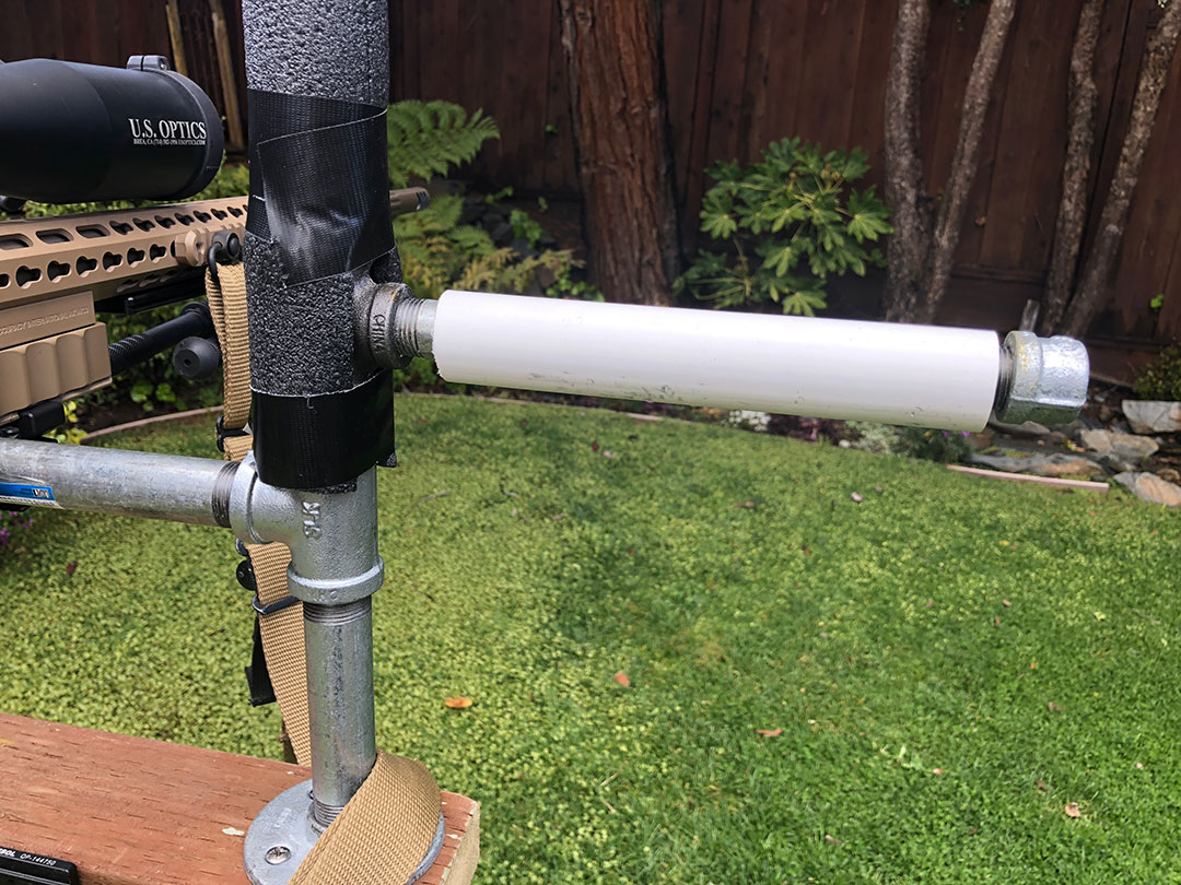

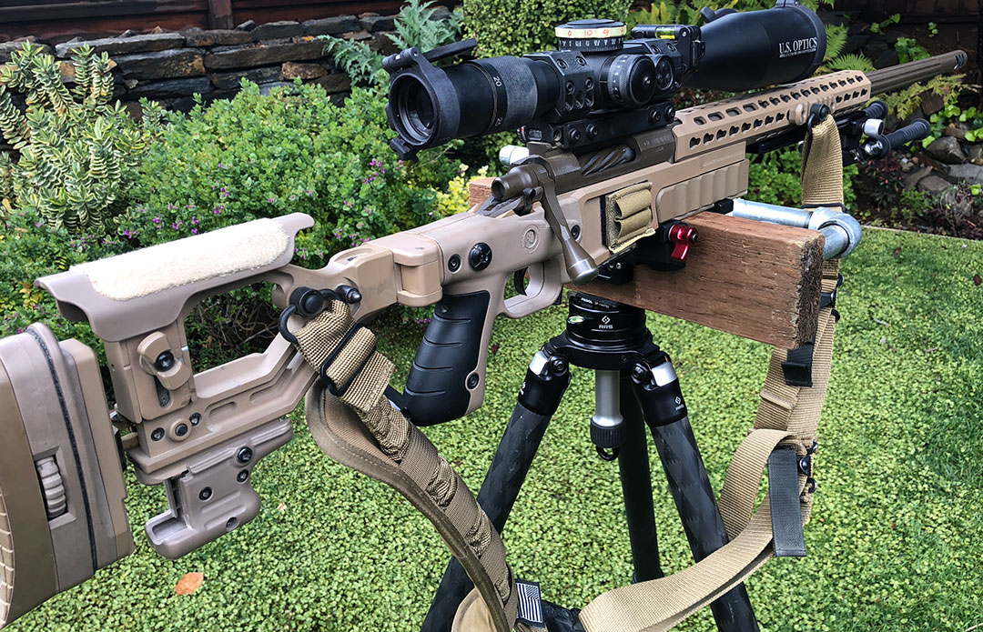

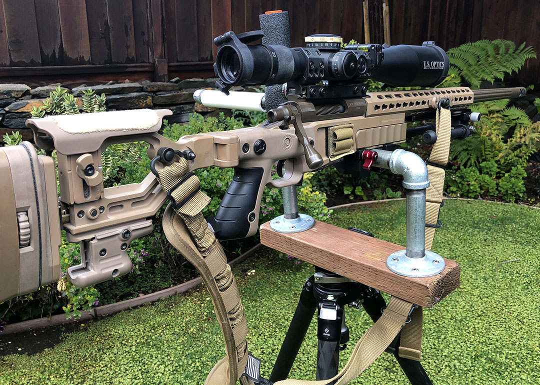

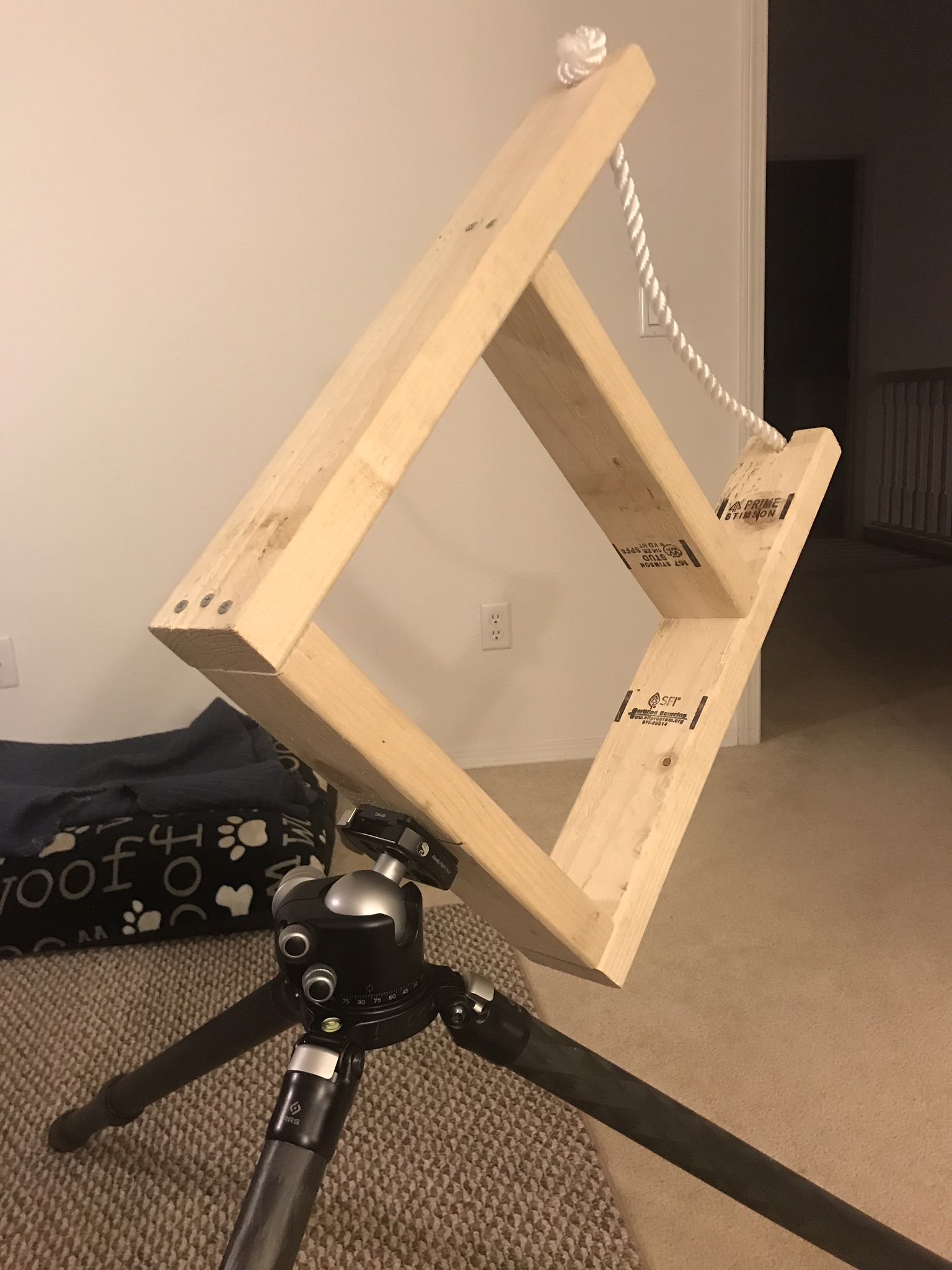

    Anyway, here is what I started playing with. It is not perfect, but works well enough with a repurposed 2x4.

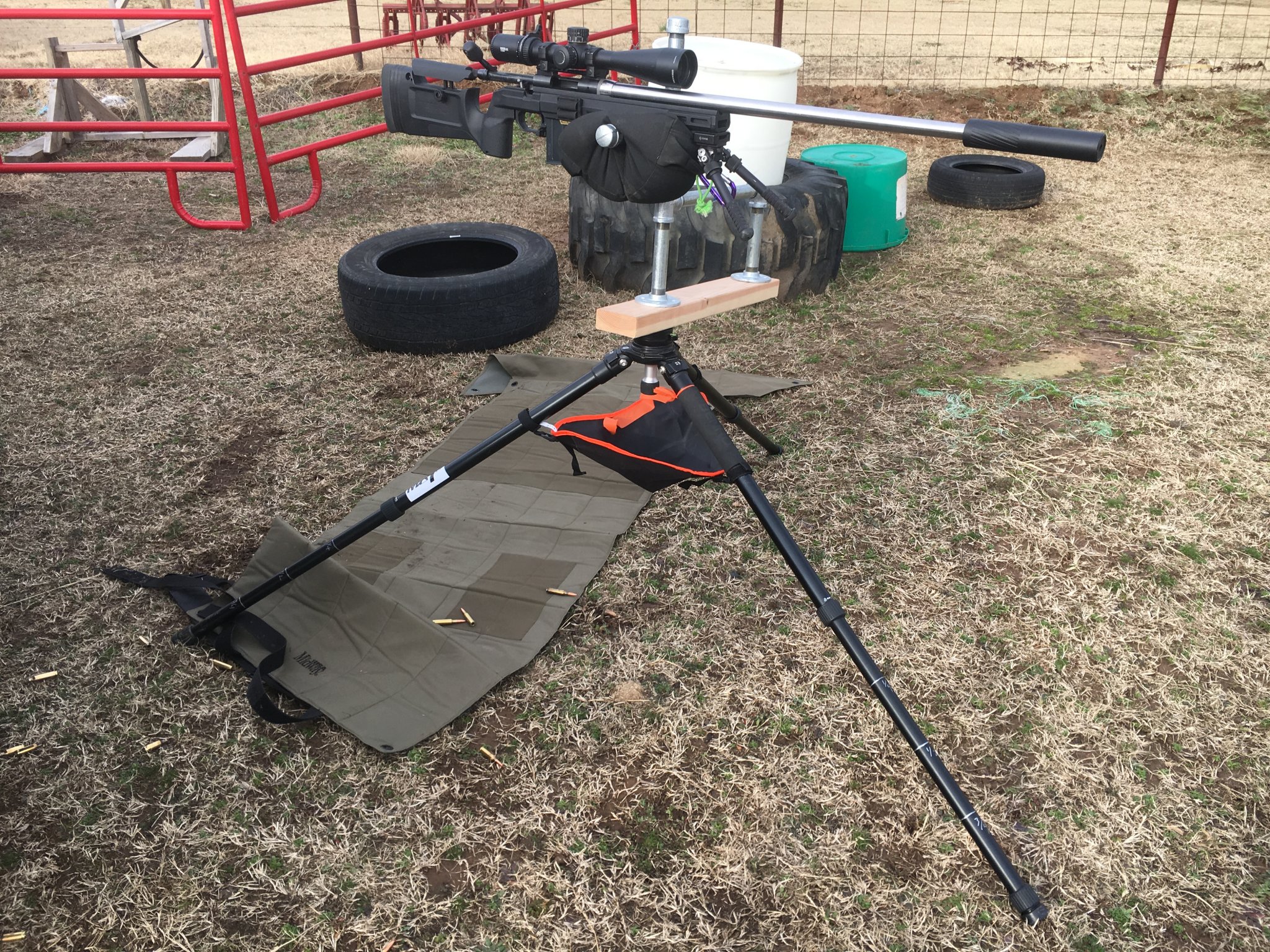

    The one (below) I have been using before the triangle option. It is a simple 2x4 with a dovetail plate in the 2 inch side and still my go to ....vvv

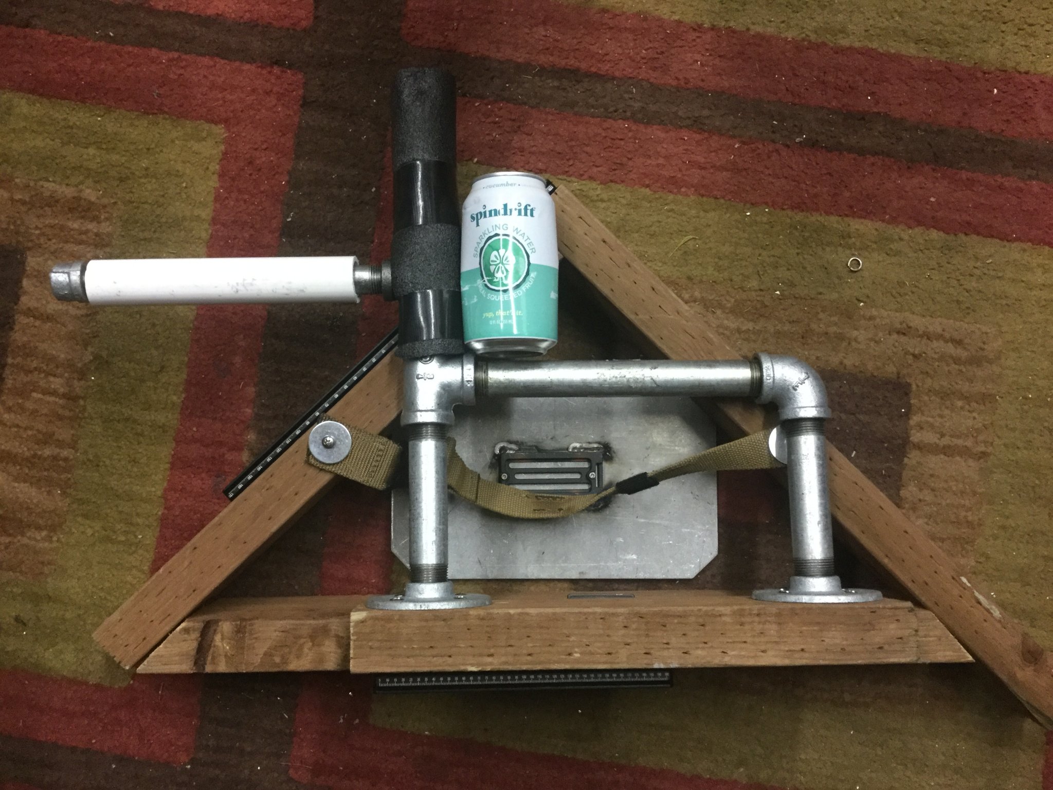

    Per request: Add the the dims - Notice I cut off one redundant leg. Spinning on the tripod 180 allows for off-hand or strong side already.

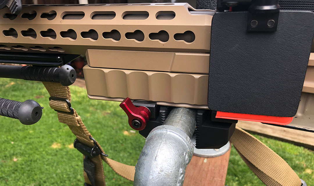

    Using the plate nearest the vertical allows for less leverage on the TA-3 when using it as a fence post.
    Edited to add inspiration- actually I flat out copied, Natestreo. His post is near end of thread.

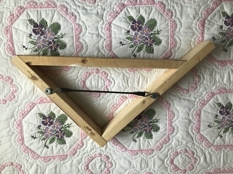

    Chain/Swinger- below: Uses a metal AI latch with long SS wood screws semi-tight, to allow swiveling out of position.
    Removable

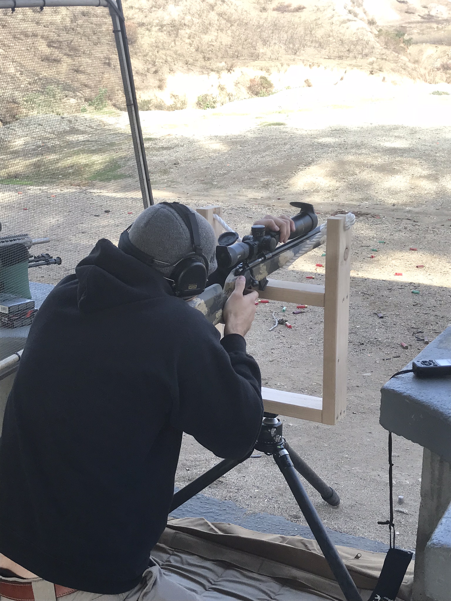

    I thought the easiest way to show the stability was with a quick cell phone video. The videos are meant to show how much the RRS tripod legs, head and barricade, move or don’t. That’s the point of the focus, not my ugly butt..
    I used a height in the first two examples, that didn’t let me brace elbow to knee, or kneel. The iPhone is at a weird angle so that you can see the device..It makes the other stuff look a bit off-axis.

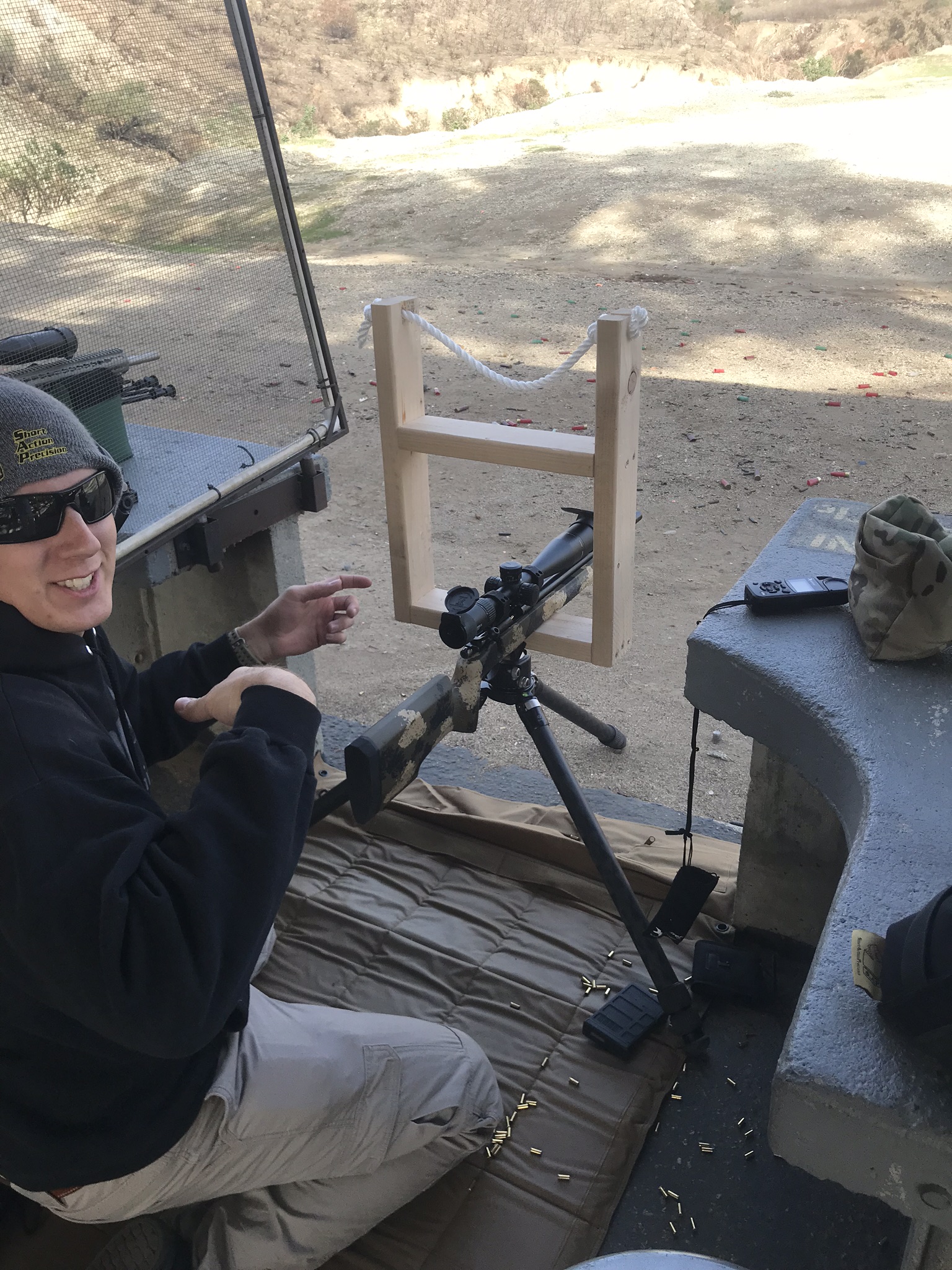

    Swing rope or chain.. you can remove and shoot off the much more stable 2x4

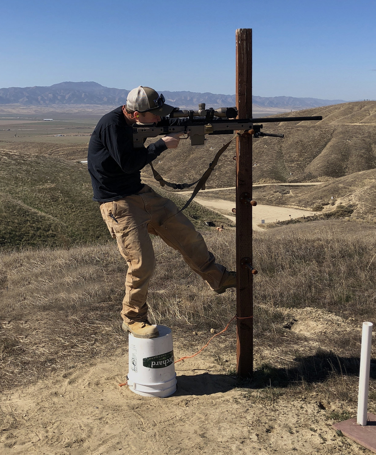

    Made to simulate stages like the one below. (18yr old son)
    6884939
    Notice you can slide in mount to best center were needed

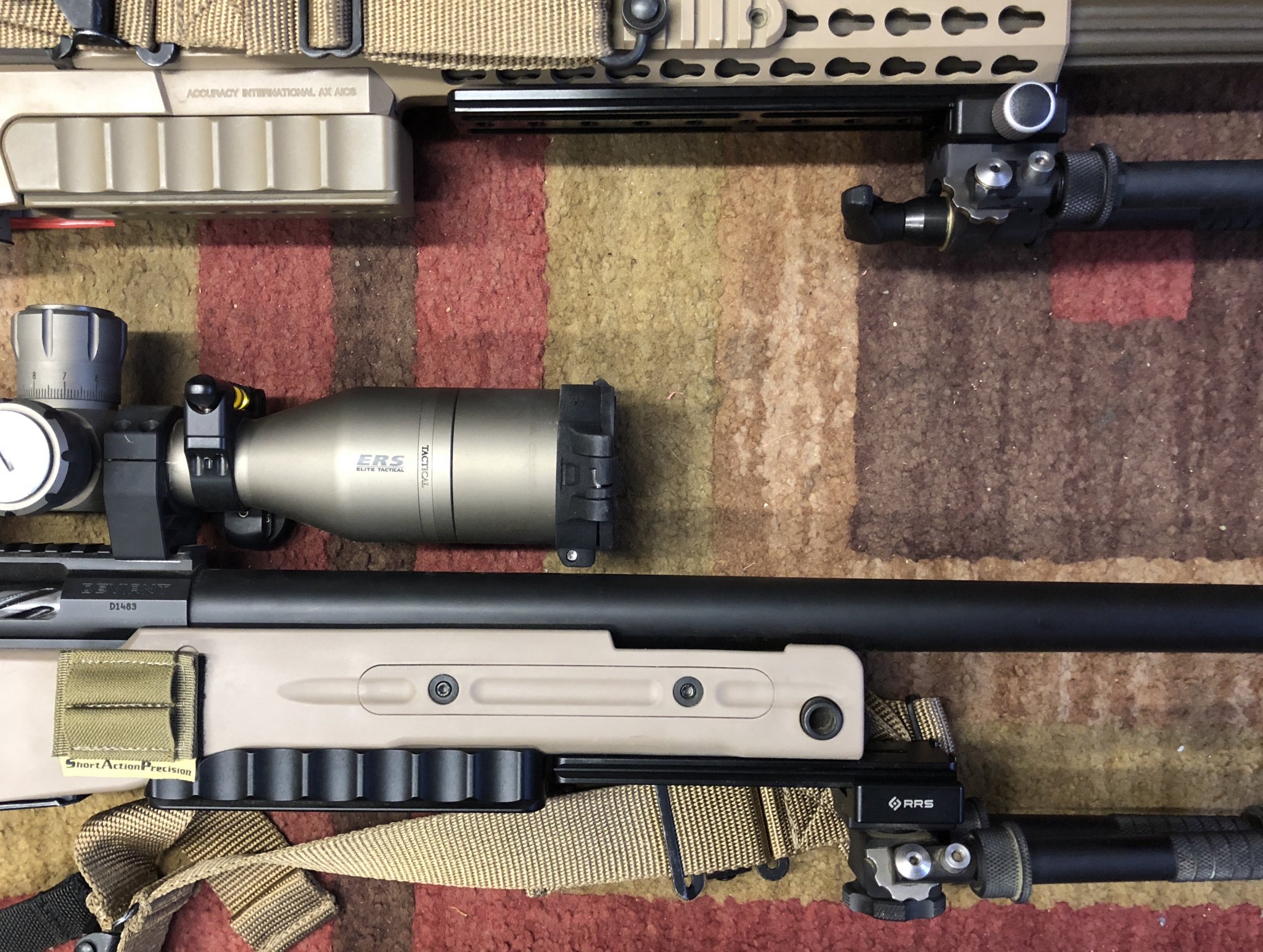

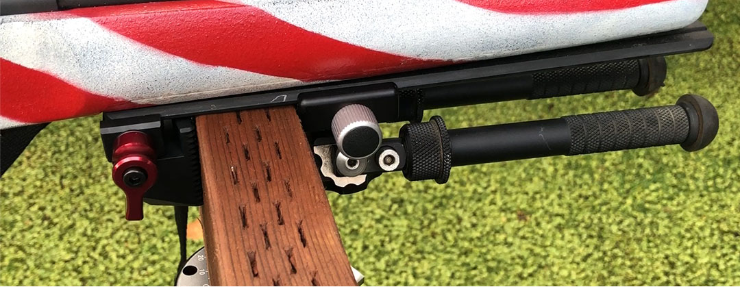

    I have been using full length ARCA Rails cobbled onto the forearms sense RRS came out with the conversions for Atlas and Harris bipods.
    Not only does a device like this allow you to quickly slide the bipod to shoot off a barrel or other small foot print, it can work like an MPA front barricade stop. Maybe more on this later. But these are a game changer :)
    Anyway, HRD-Gear is making a few very cool offerings. Here is one (top in the image) for a SA AX.. keymod at Mile High.
    https://www.milehighshooting.com/hrd-gear-afax-09-full-length-arca-rail-for-ax-sa-forend/
    The gun at the bottom shows a 6” standard ARCA rail (not RRS dovetail) on the AT chasis. It extends to the same distance the spigot mount would.This was done BEFORE a full length HRD-Gear AT option was available. If I was going to do it today, I would forgo the RRS handgaurd /dove tail and go the 11" HRD-Gear.. You will need the SLOTTED version for the AT to clear the spigot release on the bottom of the chasis.https://www.milehighshooting.com/hrd-gear-uaf-11-full-length-arca-rail-for-la-forend-11/

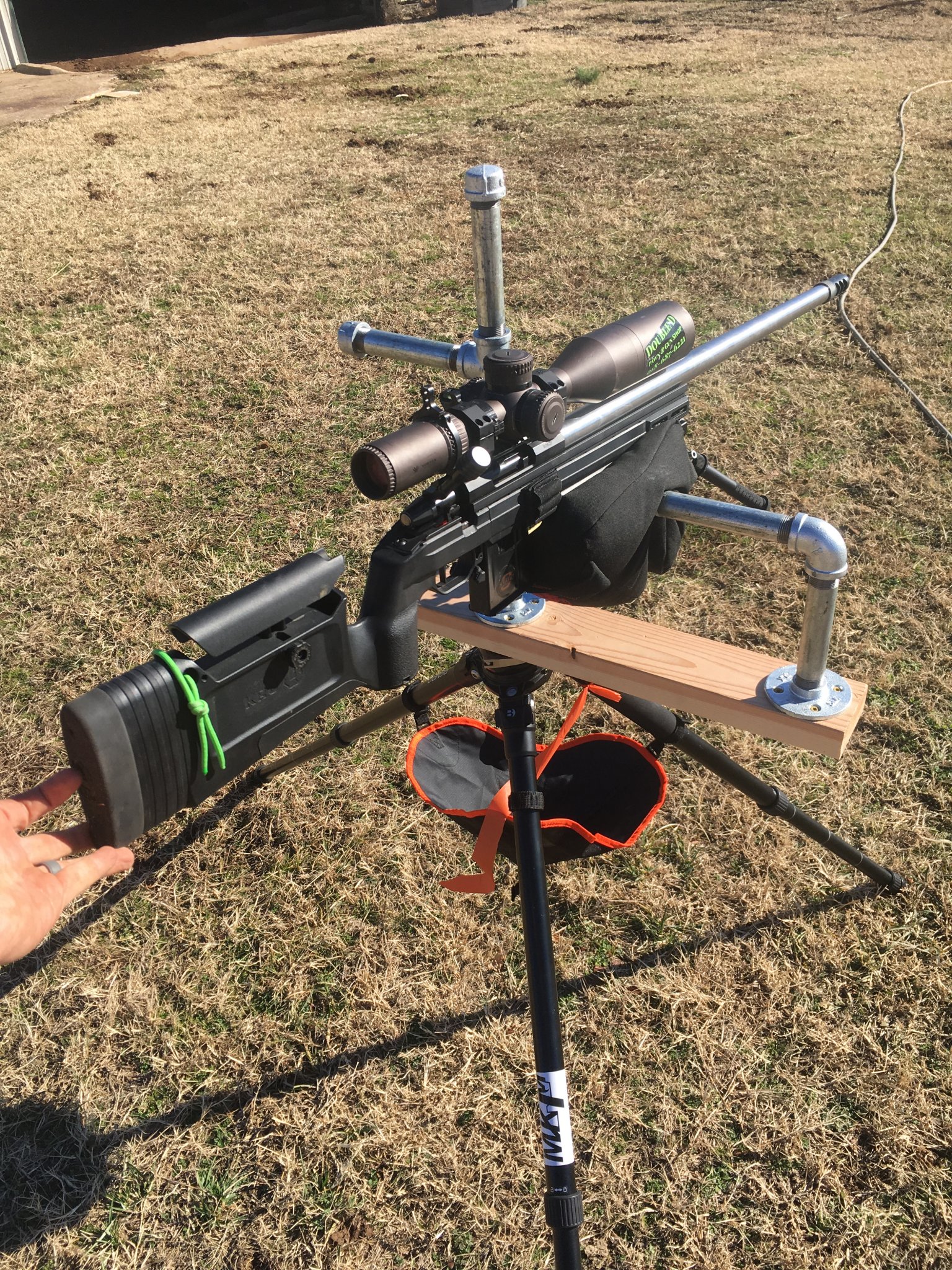

    Thanks for sharing the dimensions! I threw a “chain” simulator in there for some extra practice. Just need some arca mounts now!
    Took your idea (credited you above the images) and used some extra webbing I had.. thanks!
    Sent from my iPhone using Tapatalk Pro
    That is indeed a rubber bungie! I'm glad that helped you. I was also concerned with scratching my rifle on a chain unnecessarily.

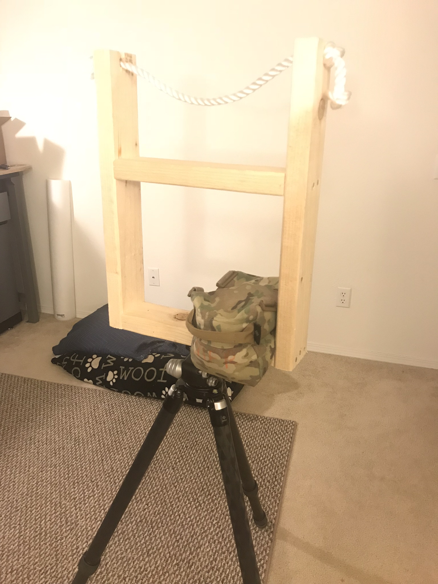

    Got bored and used your idea to make this. Thanks for posting. It’s solid as hell.

    This thread talked me into buying a tripod as I don't have the ability to carry around barricades regularly.
    Looking to build a single side of the barricade to put on top.

    Thanks for the designs they work great! Built myself a couple of them! The pipe one sure does make you focus on getting a good stable position.

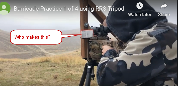

    Diver, I also have a question on the range card and holder you are using in the video (see below screenshot), who makes that, I was thinking of getting a quarterback wrist holder but that's really cool on the rifle
    Resurrecting this thread because I think this is a really cool idea and am going to build one myself. I just got the PVA CF tripod and while it's not a RRS it's a beast and should do the same thing. I have yet to do any tripod shooting, but hope to begin practicing as I want to be more familiar for field use and advancing my own skills.
    Thats a Hawk Hill.
    It is super robust and flexible. I use business card clear vinyl holders, with Velcro to the Hawk Hill and drop in stage cards. It is easier than erasing the white board that comes with them.
    That said I use it mostly when I need a thick jacket and the wrist coach does not work. During the summer / better weather, I use the wrist coach as my main go to because I can also have a standard drop sheet on one of the pages.. super helpful for field style matches.
