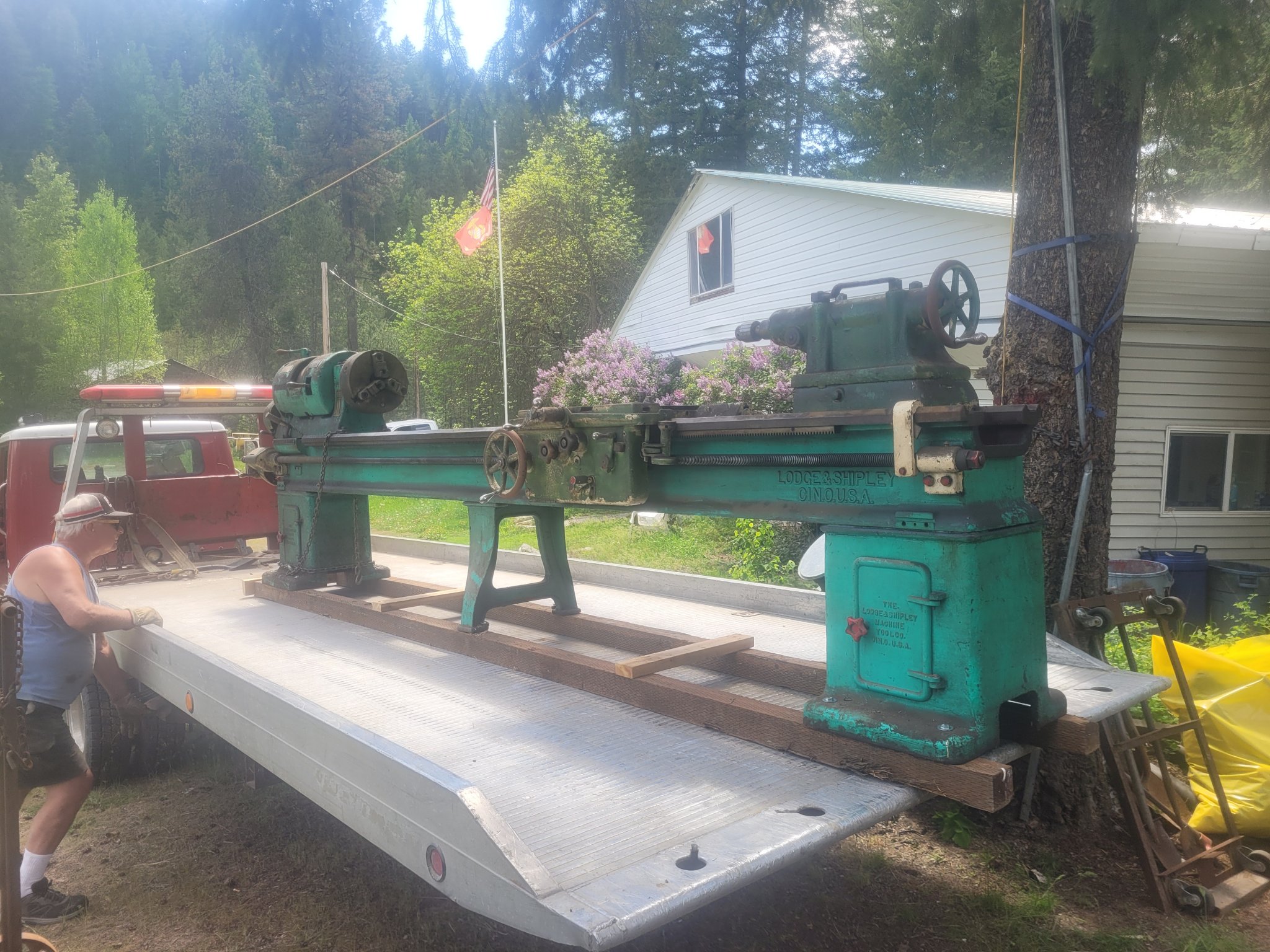

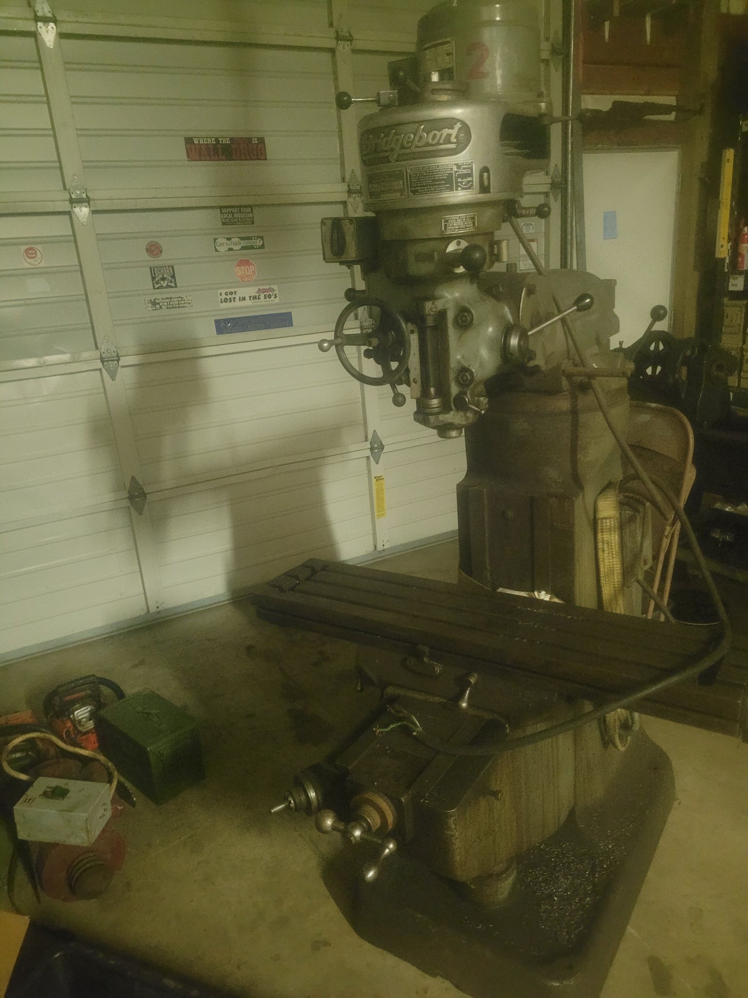

I am just learning myself but the above advice about finding an old machinist who wants to pass his machines on is often good.
I just got this 20x168 Lodge and Shipley and this J head Bridgeport from an old gentleman with all the tooling and accessories you could ever want for $4800 for the pair.

View attachment 8178187View attachment 8178188
That lathe is awesome!!!
Yes it is. It came with a taper attachment and has a quick change gear box too. Made in 1914 in Cincinatti Ohio.
