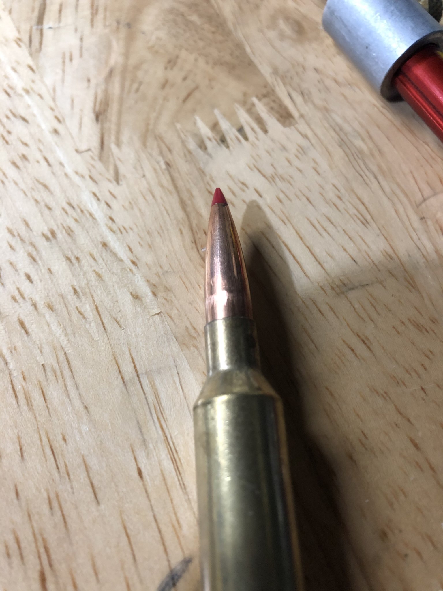

I believe I have a Creedmoor with a throat dia that is on the small side. If any Bullet measures over .264 it’s very tight and you can see drag marks on the bullet all the way around. This goes for factory and handloads. Most everything besides my Berger’s are about .2643 ish and are scary tight and have gotten stuck. What are my options to fix this?
tight throat or a crazy short freebore?
post a pic of the bullet after you chamber then eject a loaded factory round and give us its COAL measurement

Factory 143eldx chambered and ejected
