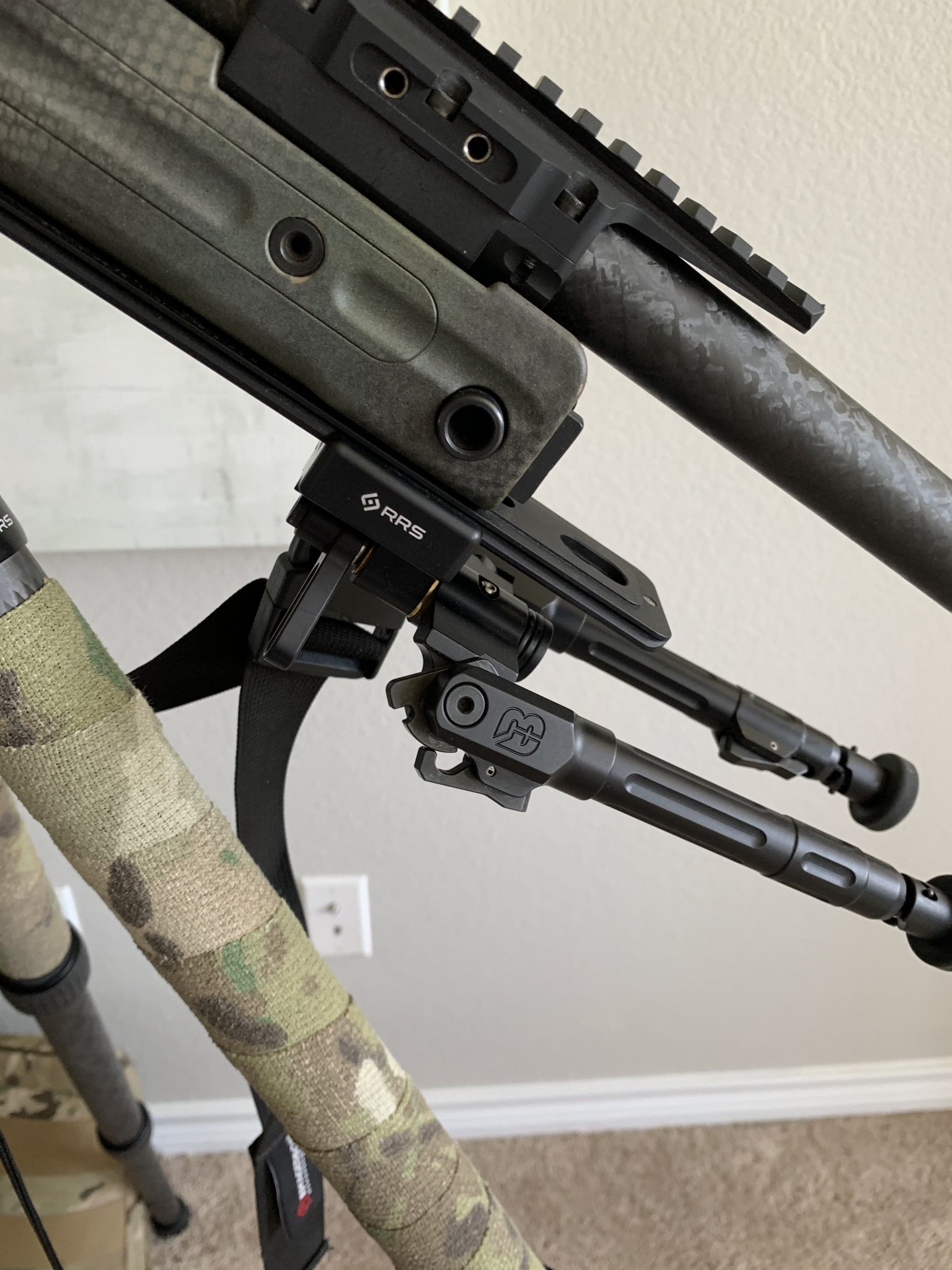

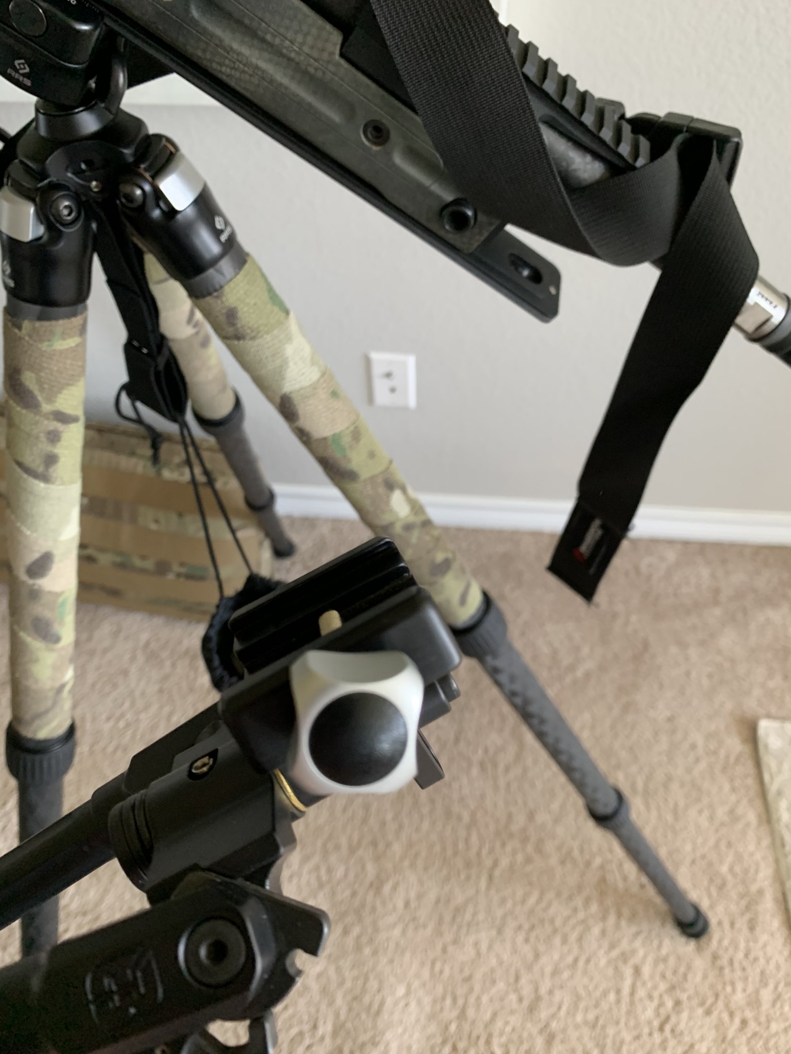

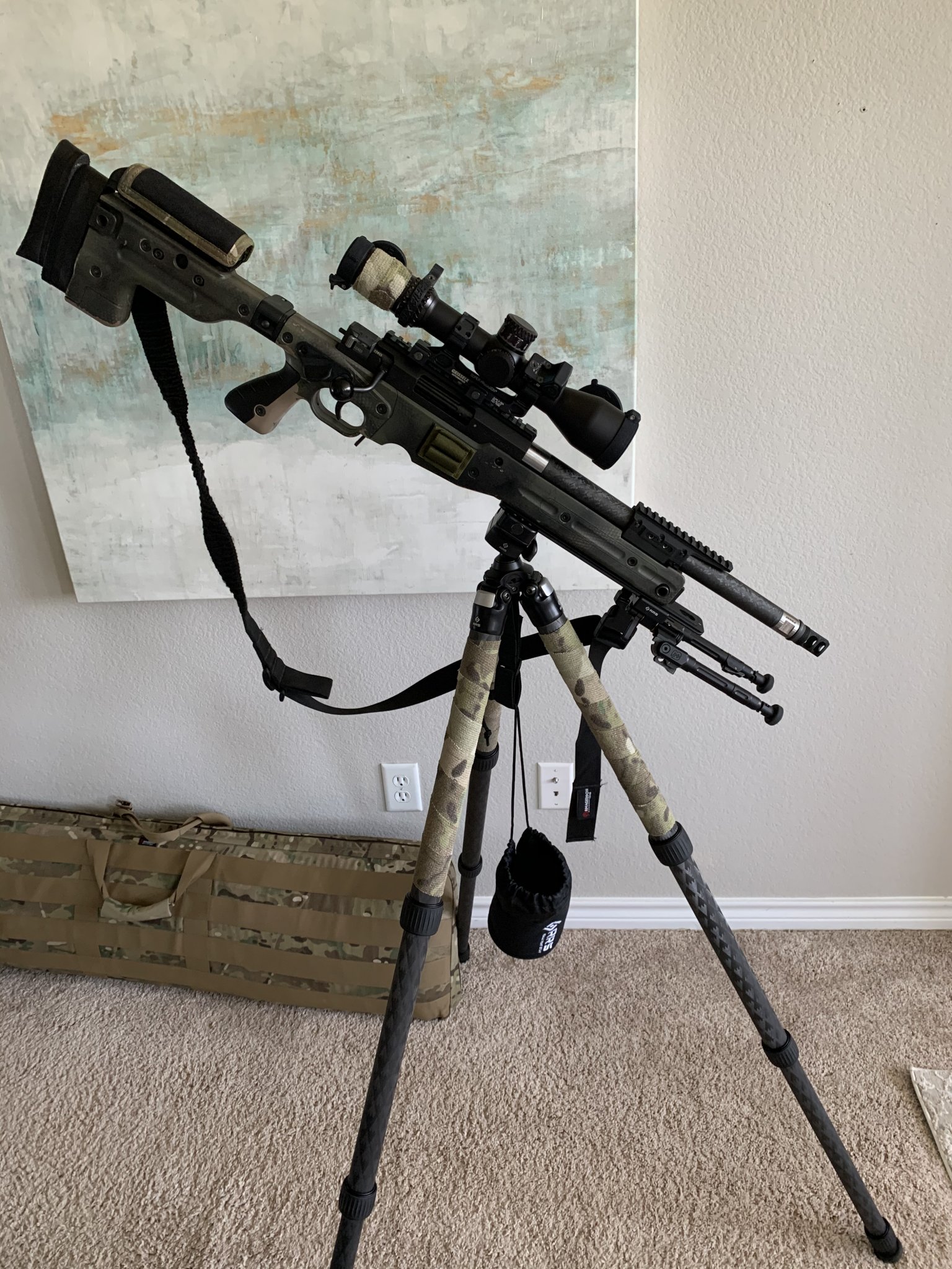

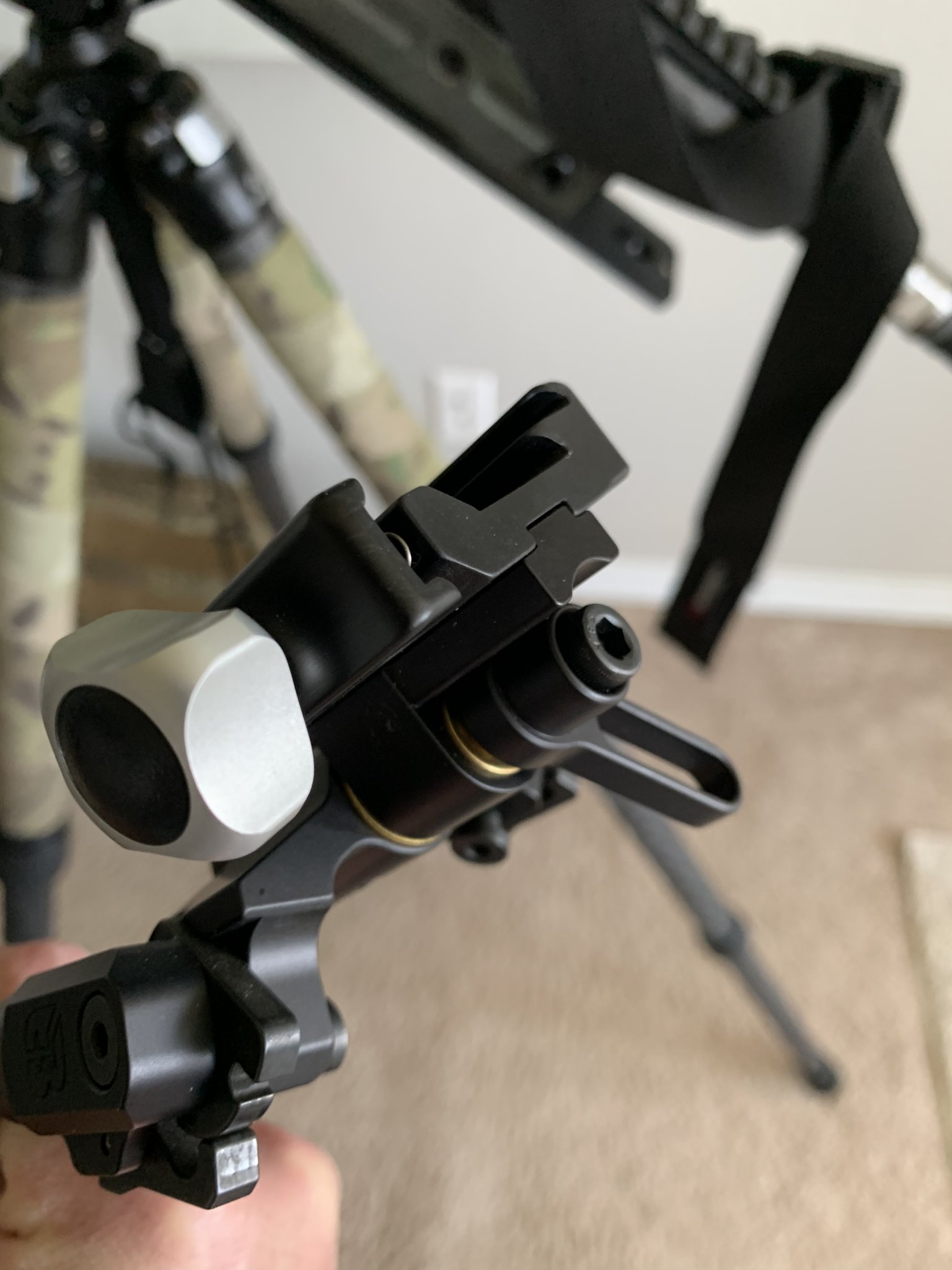

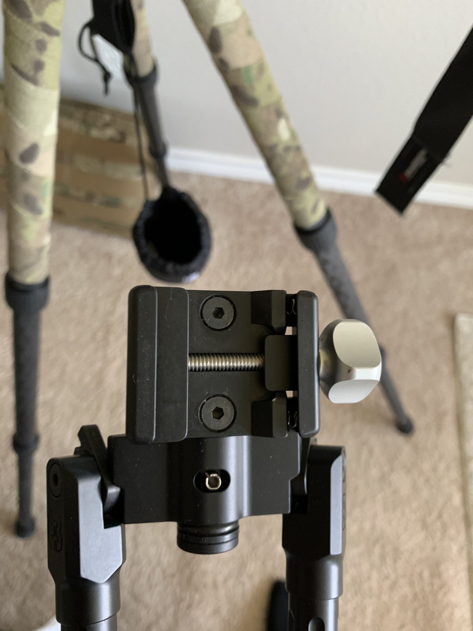

RRS is very nice and versatile for pic or arca rail. Here’s some pic of mine to give you a reference how low profile it is when mounted to tripod. Tension has been great for me, I haven’t notice the mount ever loosen when shooting.

Youll need what i wrote, if you want to attach the SC clamp as you requested in your OP. If your fine with a screw knob clamp the RRS BTC-Pro will direct mount and it has both picatinny and dovetail just like the SC-LR lever release version.
