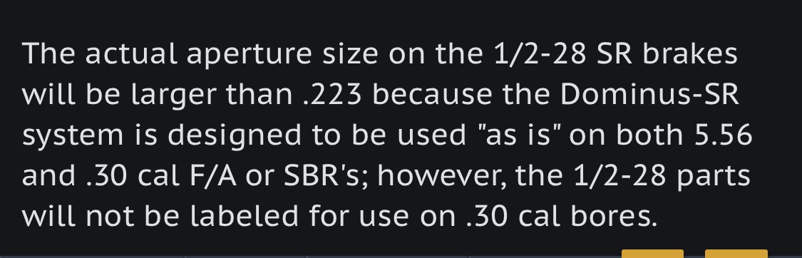

See if you can pick up what I’m laying down
I asked about the CB mount....
And they said they don't recommend 1/2x28 for 30 cal. Too thin. You don't want to break off your threads.
