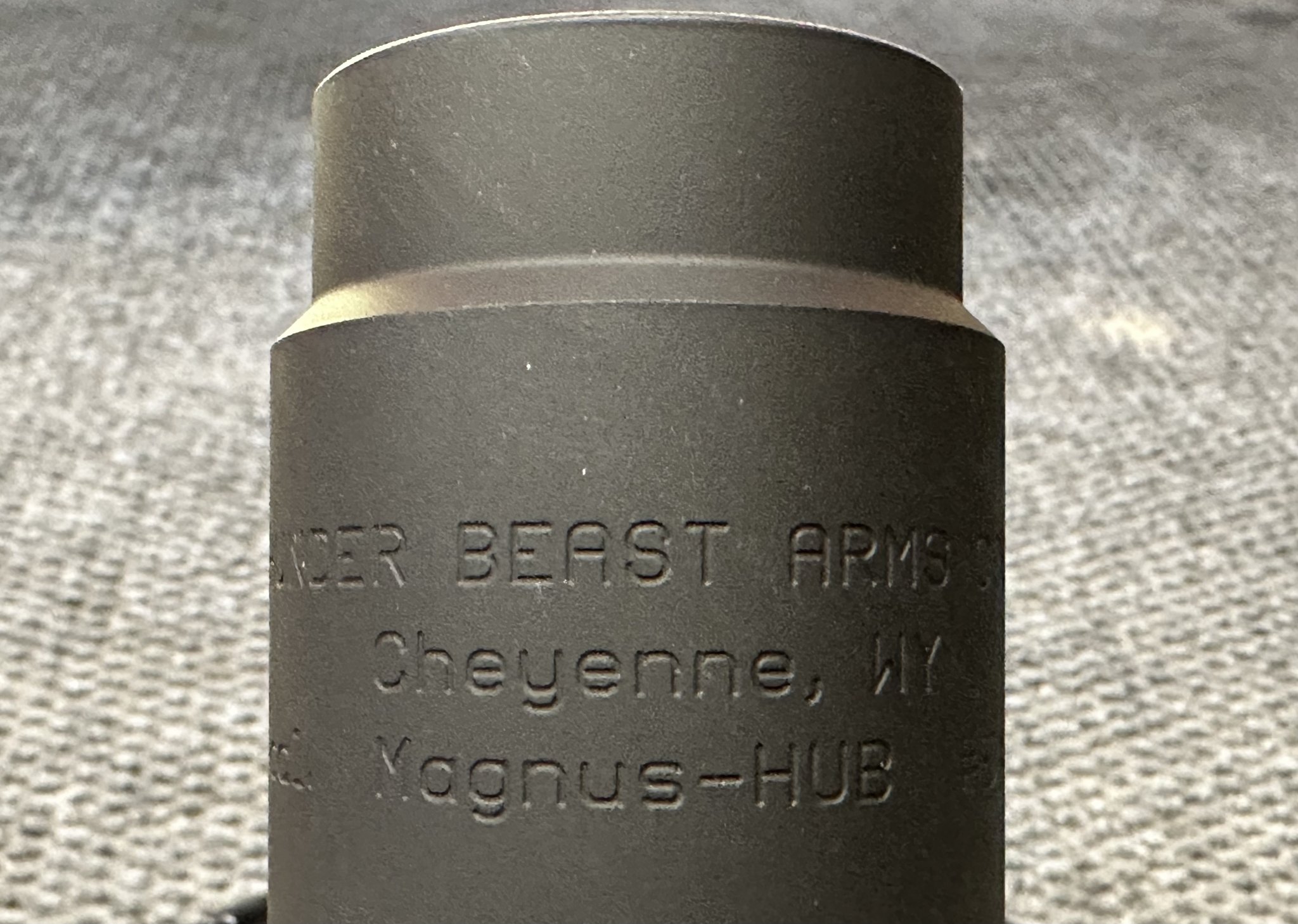

    Which Magus would you recommend they seem to have a couple variations on it

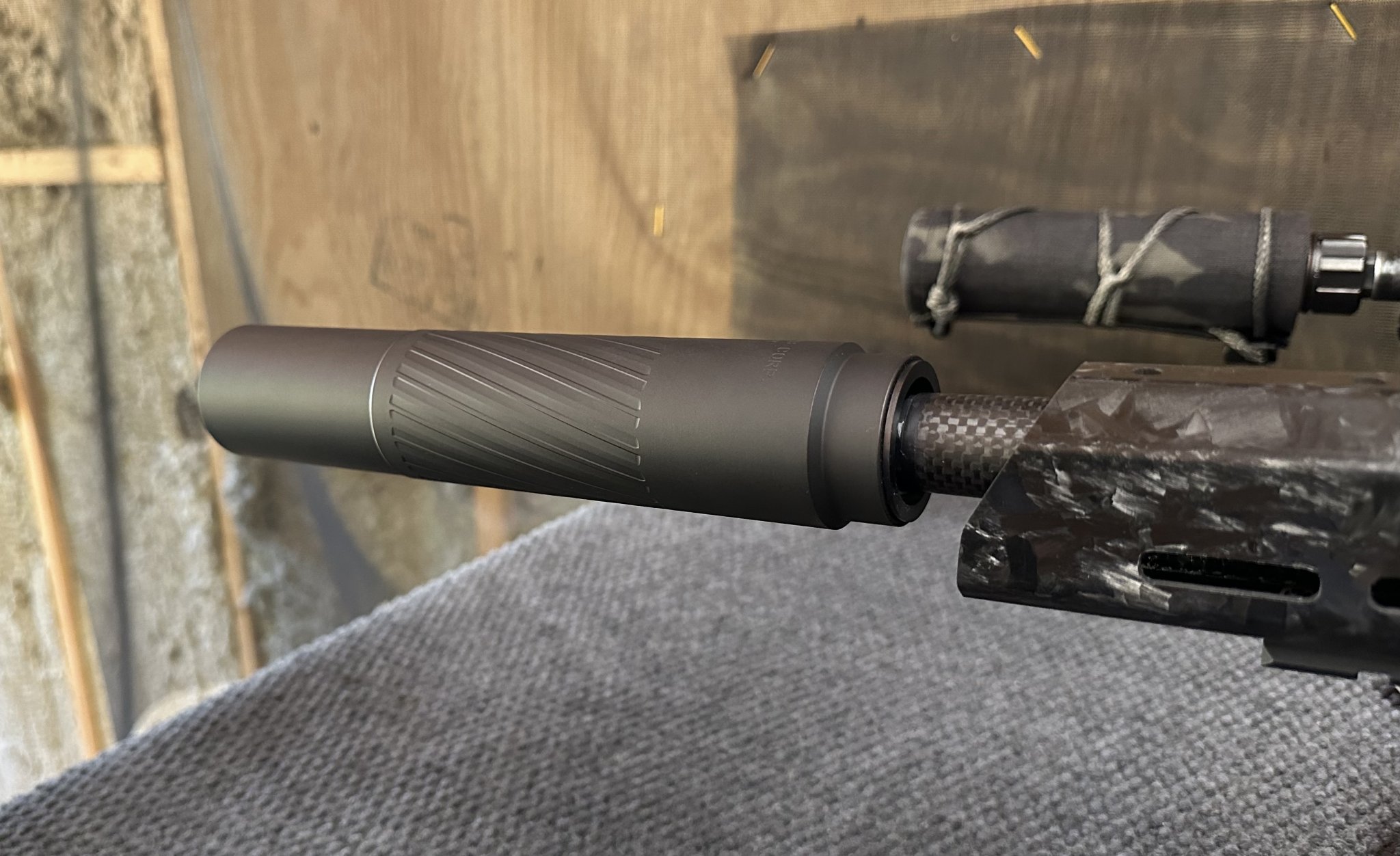

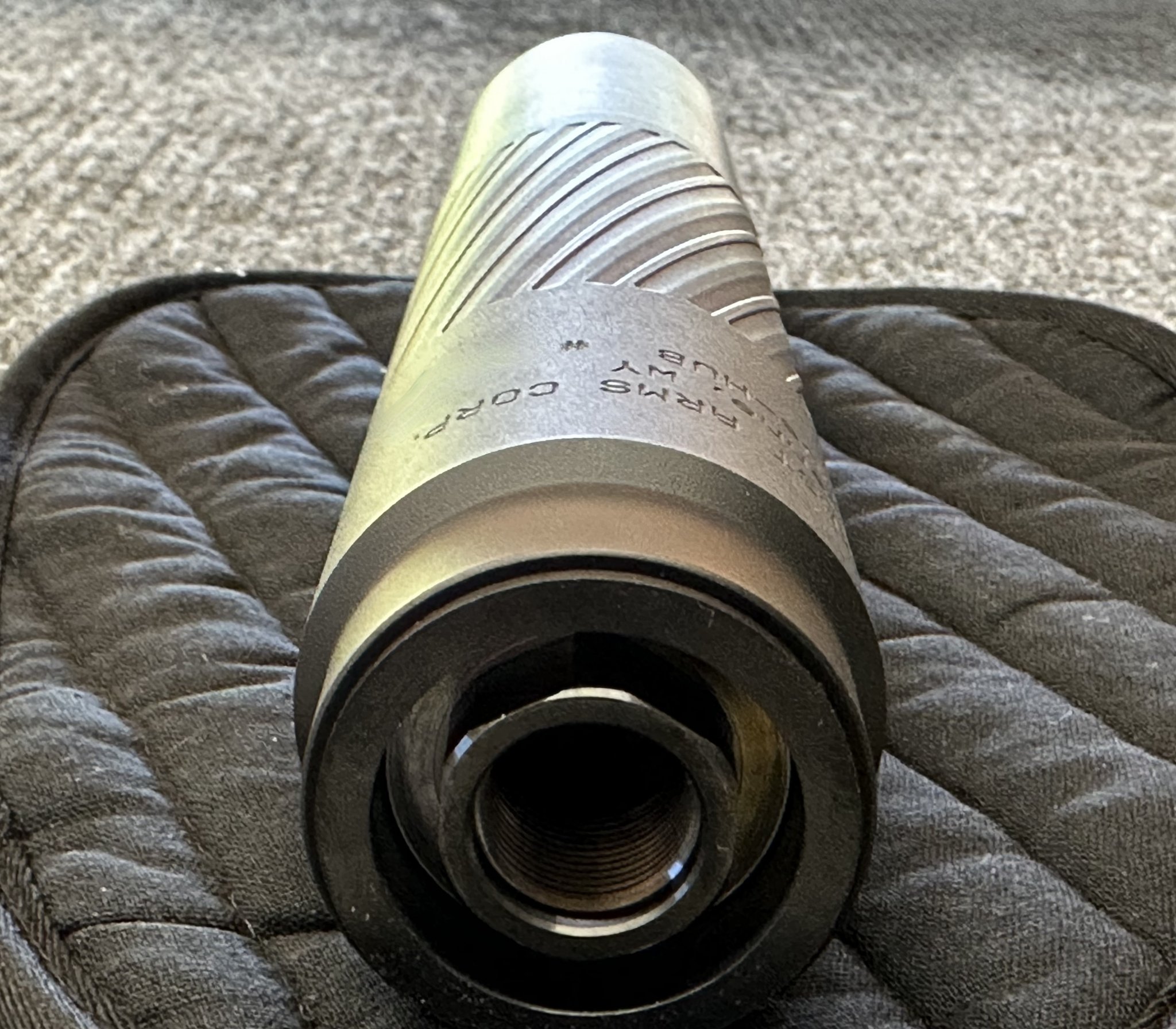

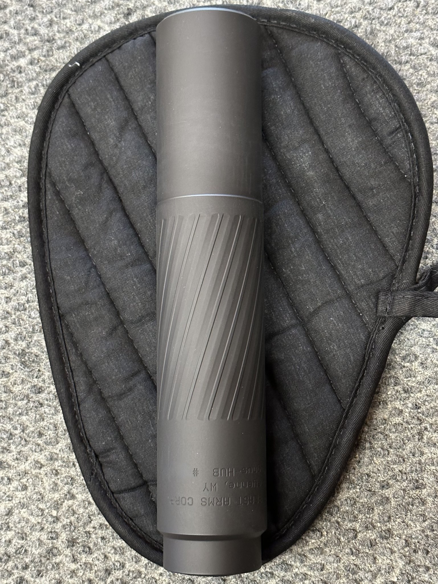

    I have the HUB version, and run HUB on all my rifle cans, because it allows me to run whatever mounts I want. HUB is the new universal standard suppressor mount thread, which is 1.375x24 threads.
    I run an Otter Creek Labs ZER0-DTA 5/8-24 direct-thread mount in mine. It's solid titanium, and only weighs 1.1oz, and only adds 1/16" to the length of the can. It's the best lightweight HUB direct-thread mount on the market, IMO.
    Yep, looking to get one of the new Magnus RR in a 30 cal. 2 shoulder surgerys and a double disk replacement I need to take some bark out of that 300 RUM. Still want the bite at the working end of it though.
