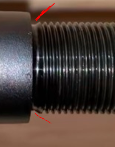

Just spin the brake off and take a picture. It might be within savages spec, but that doesn't mean it's proper for mounting a suppressor. No reason to send it off, if they won't fix it.

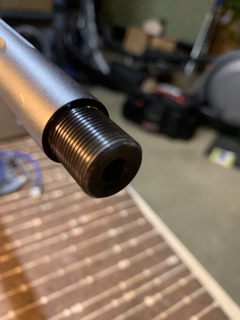

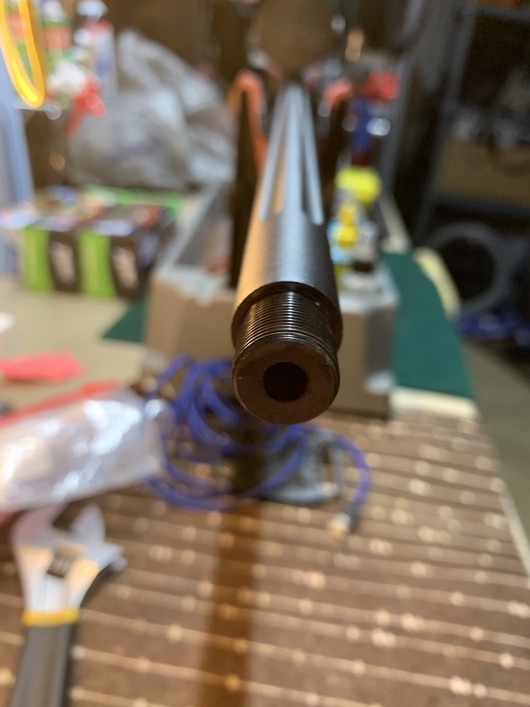

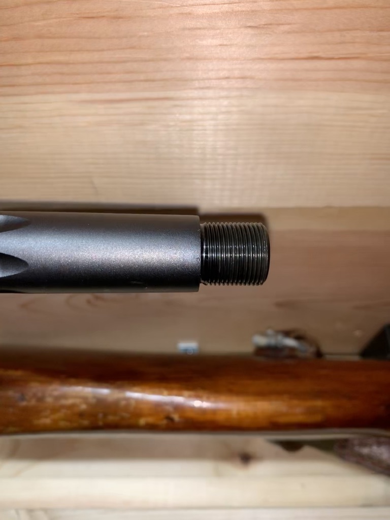

I seen a statement above, wasn't aware that was a question from you. Seems more like you were saying what a picture would show. I also answered Huskydriver as well. I didn't take a picture at the time. I could take a picture of the muzzle and threads *without* the supressor but would that really show enough detail? I don't want to take my brake off but can if it would really help.

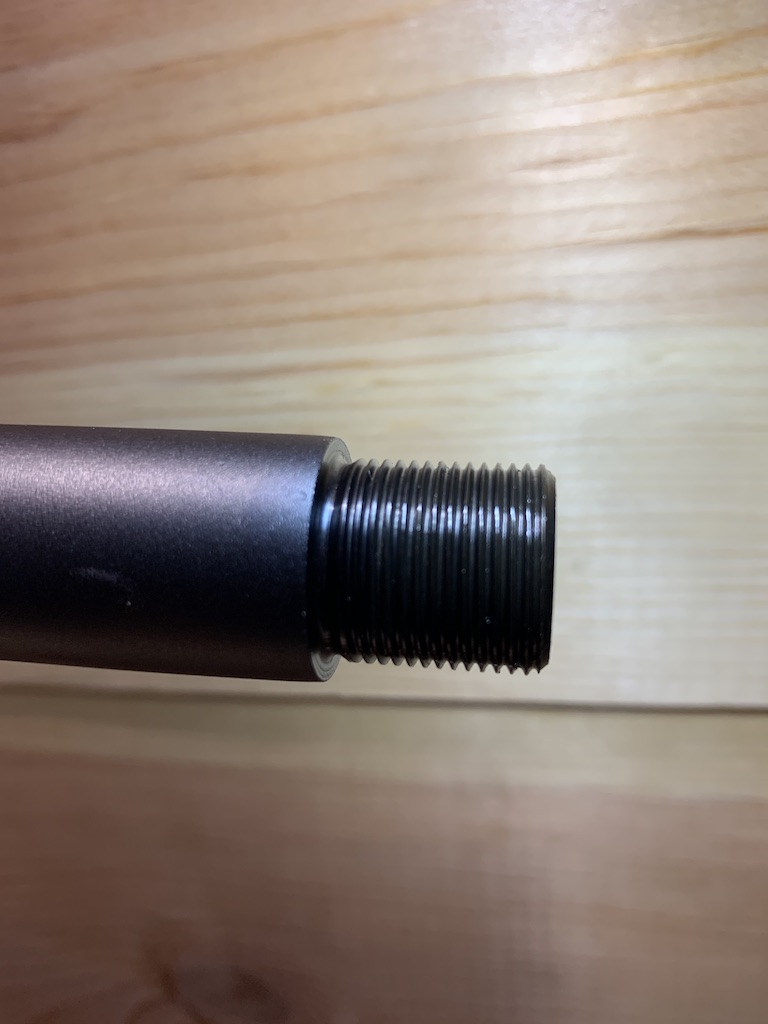

Let's see if these can help. I tried to get a few different angles.
(And a pro tip, dont put what you are trying to show a picture of in the shadows)
Wasn't sure what I was supposed to be showing I guess. Here are some side views.
Short video trying to show the threads
Regardless I would think the rifle lacking the relief cut would have the opposite impact in that the barrel threads would be too short. So the supressor could go all the way on. On the other hand if the supressor didn't have the relief cut it would be too short and that's why there was a slight gap between the supressor and the shoulder. So maybe it's the supressor that's the problem?
Note I never seen the supressor in question actually run on a gun. Perhaps it was damaged in some way?

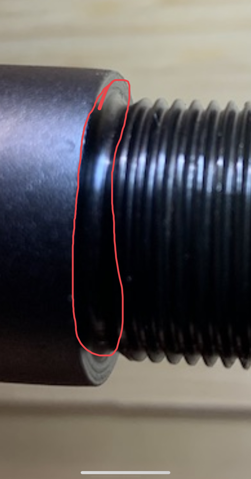

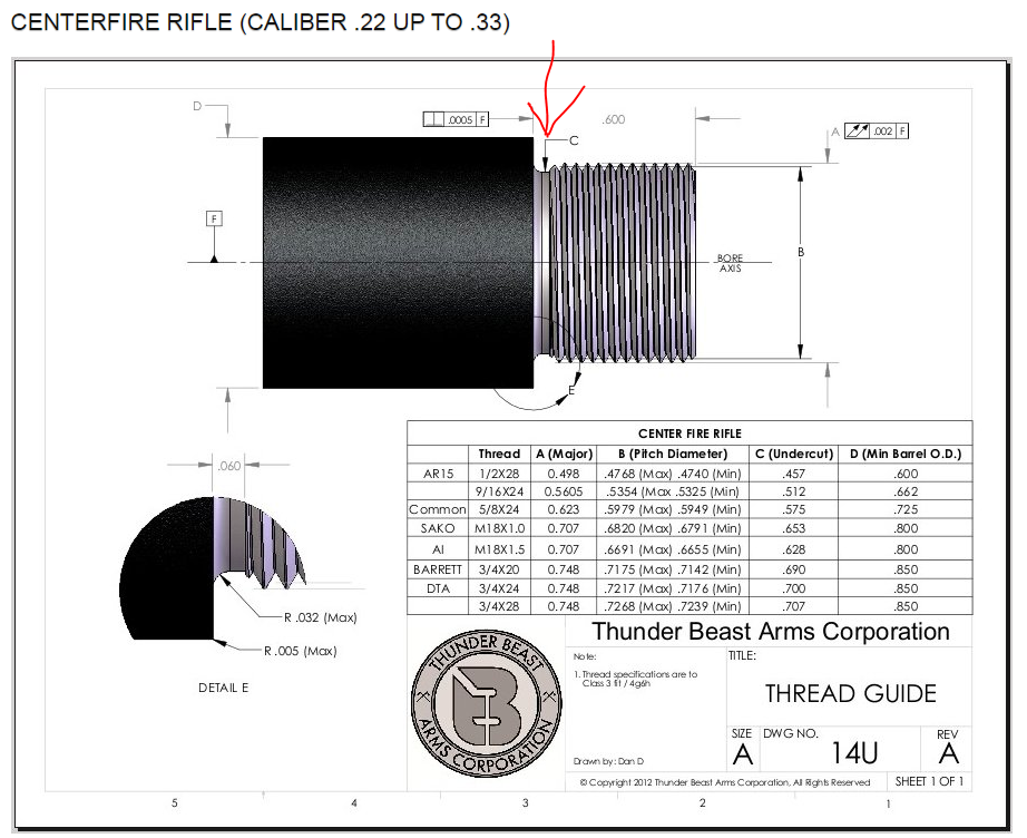

The threads on the suppressor are hitting the metal of the barrel that is in the way. The relief cut is there for a reason. When single point threading, it give you a place to stop the top without hitting the shoulder. It’s really a good thing. However, threading with a die, you don’t get that . The threading inside the suppressor go all the way to the end of the can.
This is where your problem is
So I don't really have that "flat" sort of area there? It should look like \__/ but instead looks like \/ ? So does this mean this is a mistake on Savage's part and if I do send it in they can fix it. Or is this likely just a design and TBAC supressors can't go on Savage rifles like this one? If it were the later I would think it would be a well known issue at this point.
When you say single point threading you mean like something cutting it while the barrel spins, like a lathe vs the barrel staying put and something turning around it (die)? I wonder if I could find a machinist locally who could cut a relief for me, now that I can at least explain what the problem is.
