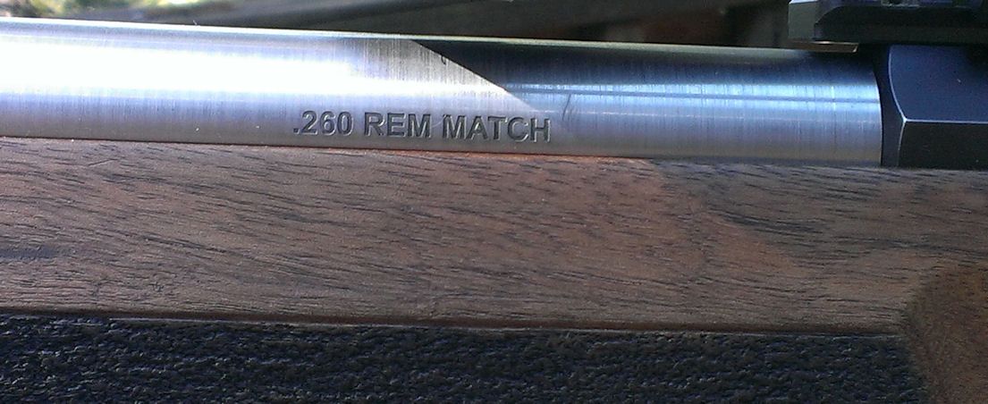

The rifle came from Tikka chambered in 7-08 with a varmint contour barrel. And while I came to love shooting 7-08, now that the barrel was shot out, economics dictated that I chamber it in something that would use the same bullets as my other Tikka in 6.5x55. So thanks to Vu providing me with a barrel until the group buy comes in, a couple weeks ago I went to the Spartan Rifle shop and Marc chambered and installed the barrel using one of his reamers for Lapua brass while I waited (one of the perks of being a NCPPRC member). After that I gave it Joe Ducos to open the barrel channel for the larger barrel and re-bed the action.

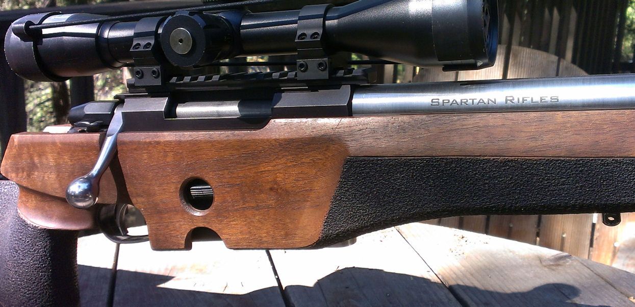

Barrel is Bartlein M24/M40 contour at 26"
RAD muzzle brake opened up for .30 cal (came off another rifle)
Tikka 595 action with factory trigger
Tikka Master Sporter stock
NEAR Manufacturing 20moa scope base
Shooting 139 Scenars in Lapua brass with Federal 210 primers

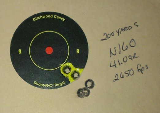

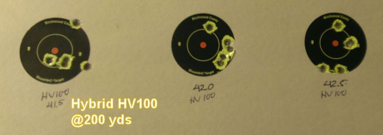

Then I moved to the 200 yard line to check more loads, and get some chronograph data.

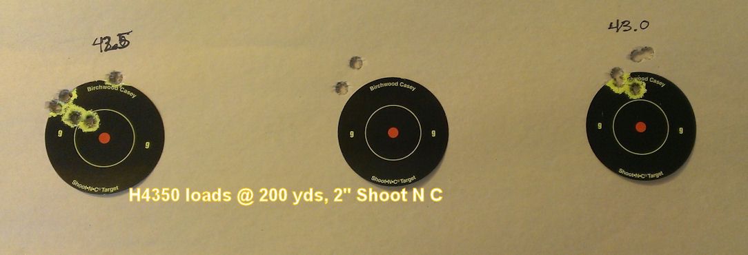

I had just enough H4350 remaining to load 17 rounds. These were the 2 best groups.
