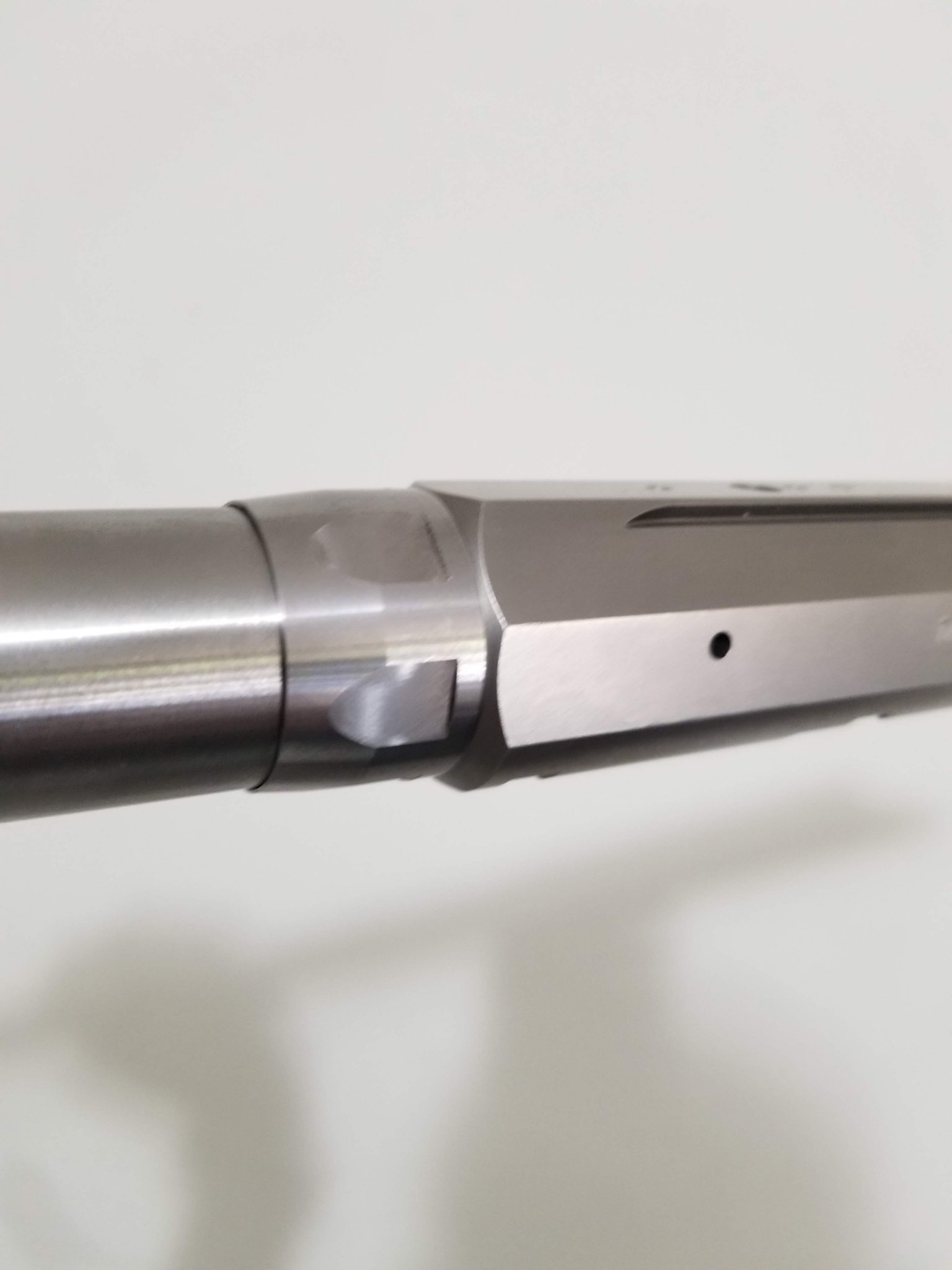

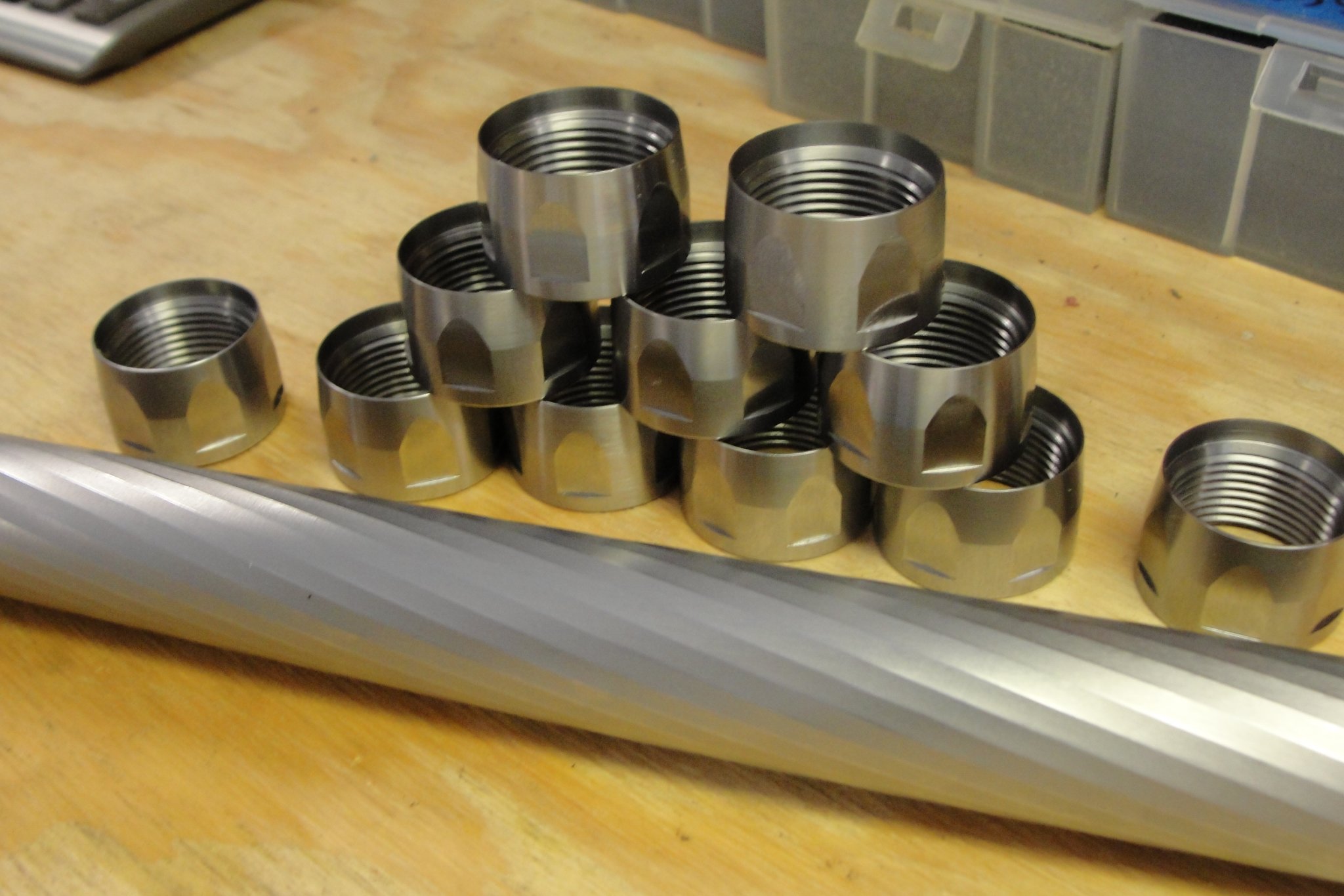

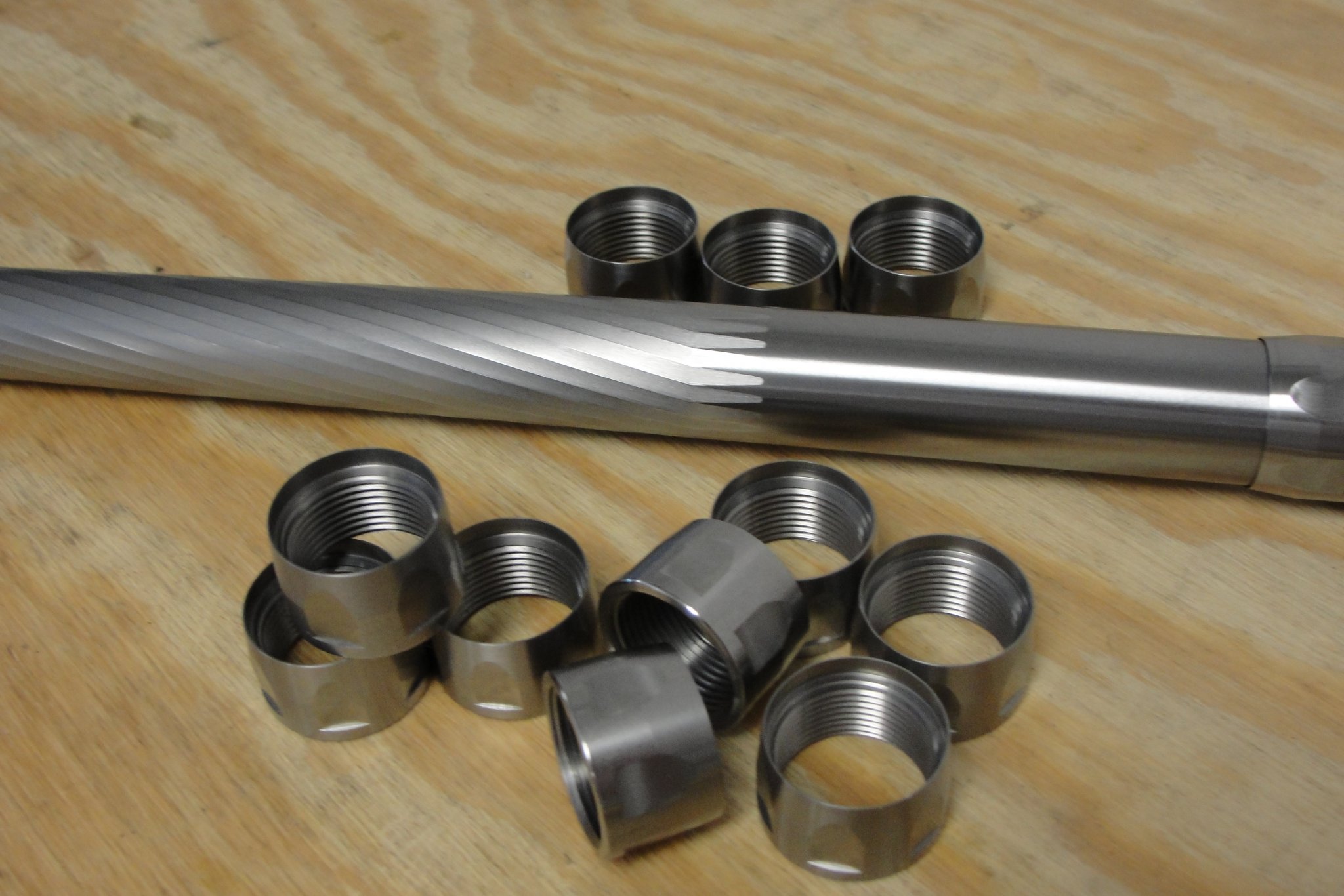

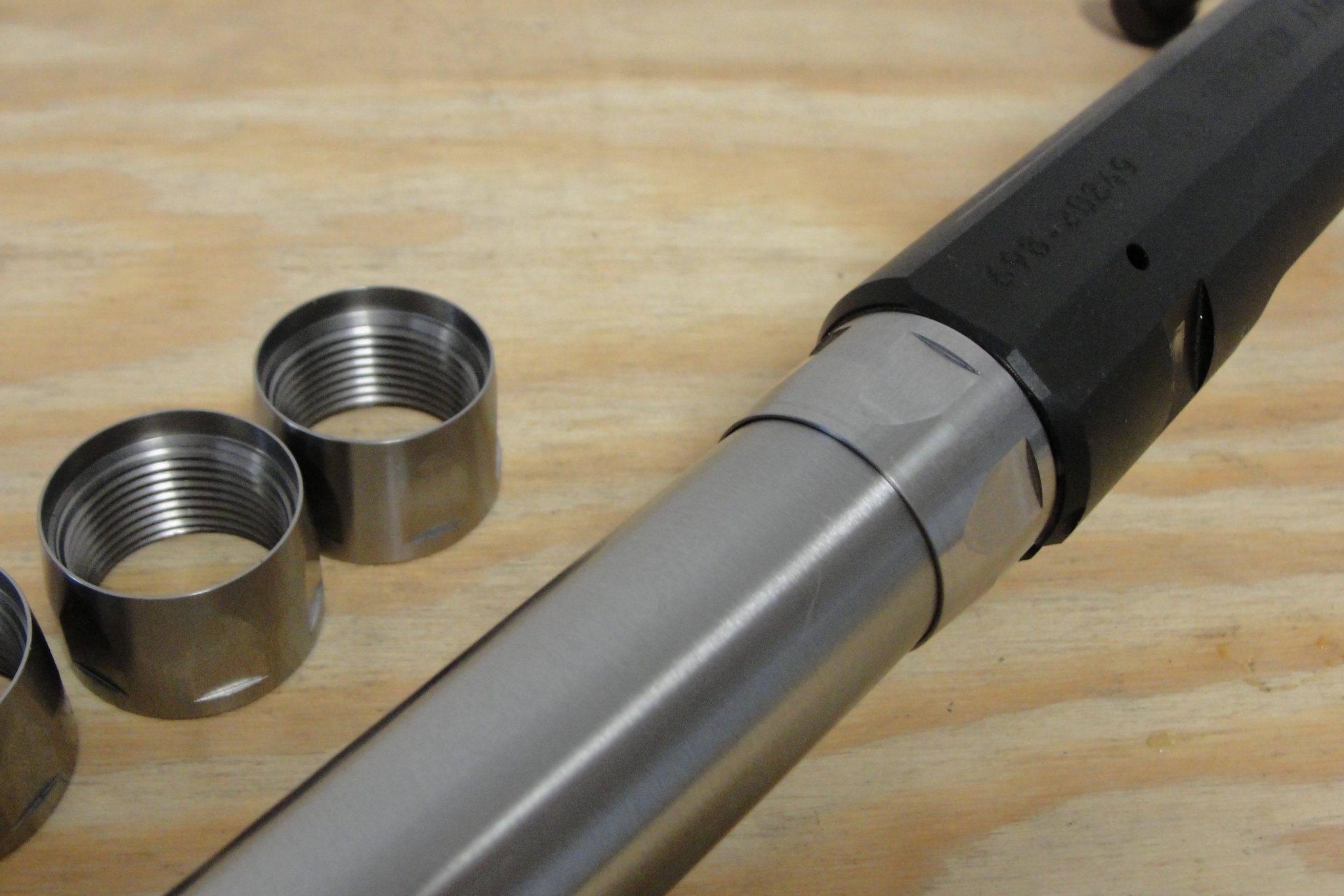

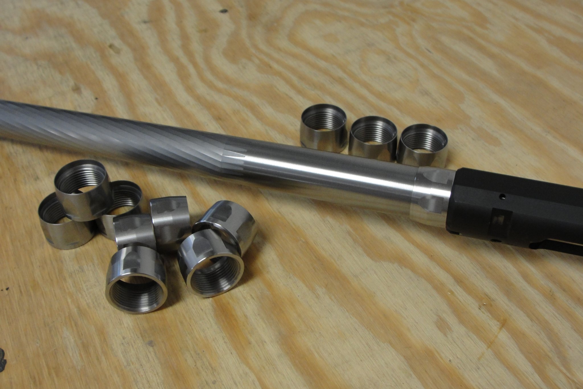

The BugNut barrel nut system was announced and released for sale in January of 2017, and has been successfully delivering impressive accuracy from barrel nut style pre-fit barrels since early in its testing phase. The response and acceptance of the system has been excellent, and I’d like to thank everyone who has tried it for your confidence in Southern Precision Rifles.

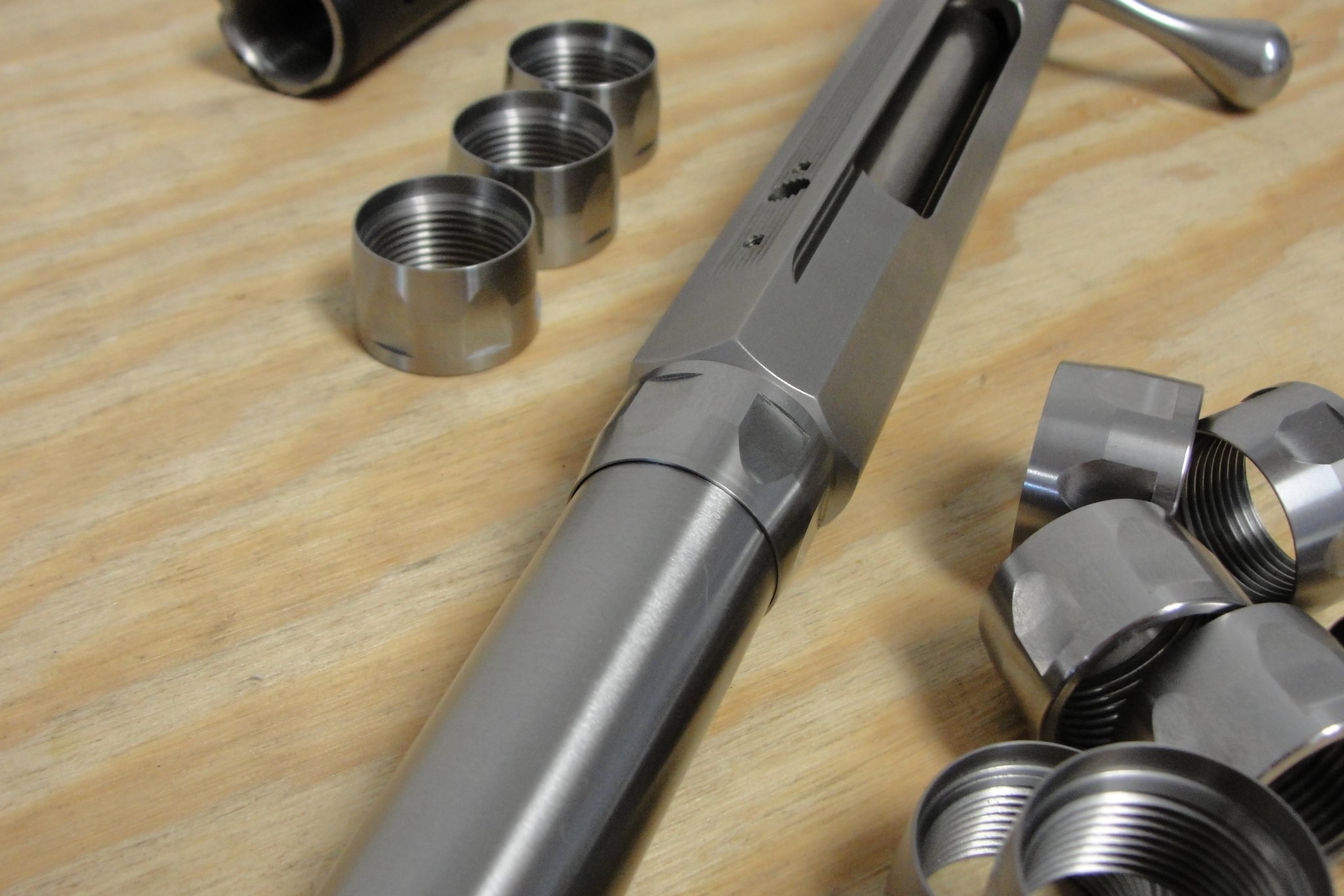

Today I can proudly announce the introduction of both the Tikka and Howa BugNut. The Howa nut looks exactly like the current production nuts, but with an internal M26x1.5mm thread pattern. These nuts are available now for 1.20” and 1.25” breech barrels and use the same original BugNut wrench. These pre-fits will be available very soon.

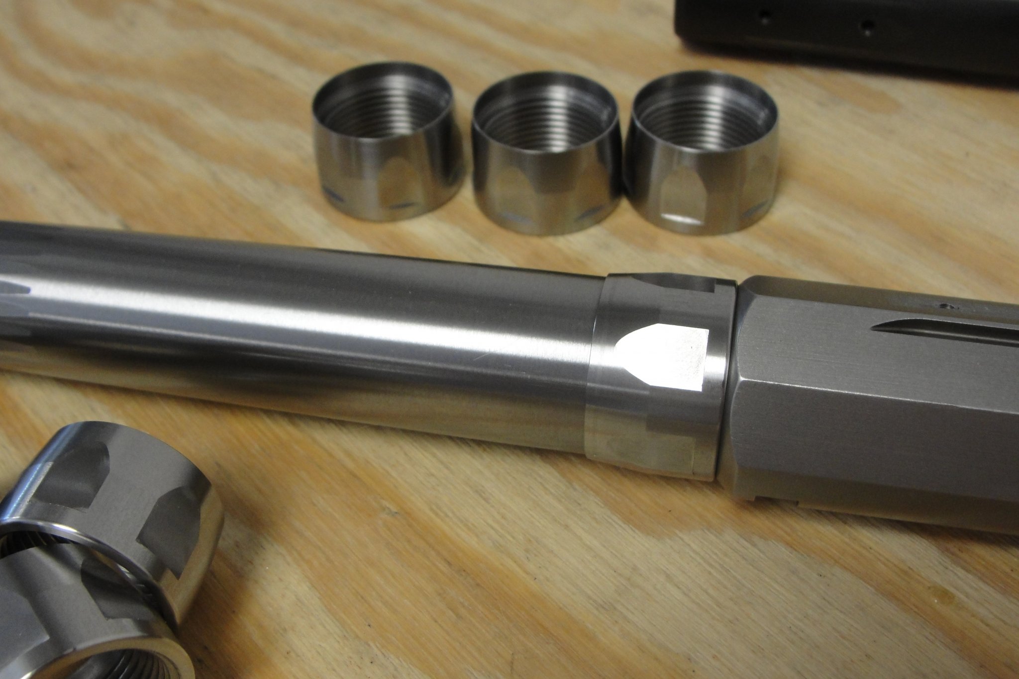

The Tikka nut is a 1.0” x 16TPI thread and will work for the Ruger American rifle as well. This nut does not work with the standard 1.20” or 1.25” breech barrels like the original BugNut, but rather I’ve elected to utilize the Savage small shank Varmint and Target contours for this application. Bartlein Varmint and Target blanks are a standard inventory item at Bugholes.com, and Bartlein barrels have a long track record of being consistently outstanding barrels. The cost of the Tikka and Ruger pre-fit will remain the same as the Savage pre-fit at $160 plus the cost of the barrel blank. I have NO intentions of offering anything other than the highest quality barrel that a manufacturer will produce. There are cheaper barrels, cheaper labor, and cheaper parts, but I refuse to stock anything less than the best
The wrench for the Tikka nut is smaller in size than the standard BugNut wrench, and they are not compatible with one another. The distance across the flats had to be made smaller to achieve a clean look, but it still maintains a robust engagement surface. The nuts are also smaller in diameter in order to look nice against the action face chamfer of the Tikka and Ruger actions. The driving flats and full diameter band engaging the action face maintain a similar appearance to the original BugNut, but the Tikka nut tapers down to a smaller size in the front in order to blend with the smaller barrel. All BugNuts are driven by all 6 flats when used with the BugNut wrench, essentially eliminating deformation and damage to the nut or wrench.
Both the Howa and Tikka BugNuts are available now and cost $40ea, the same as the std nut pricing. The wrenches are being run now and should be available before the first run of pre-fits are able to be shipped. Current lead time on pre-fit barrels is about 4 weeks. As an introductory offer, Im going to offer the first 10 Tikka nuts and wrenches for free when ordering a Tikka or Ruger American pre-fit barrel. The nuts will then become available for purchase on the website if you wish to “roll your own”. I have no doubt that you will find this system to be outstanding in form and function, and to exceed your expectations.
I do want to sincerely apologize to all the Tikka pre-fit customers I've turned away over the last 16 months. We’ve had requests for a Tikka BugNut from the very beginning, but I've been honoring my end of a gentleman’s agreement to not produce Tikka/Ruger American barrel nuts, which has recently and abruptly come to an apparent end
SPR has been an industry leader for over 10 years now and genuinely appreciates your patronage and feedback. Its very important to me to carry premium products at reasonable prices, and to produce extreme accuracy rifles on time and on budget. We won’t quote falsely short lead times or sell items we can’t deliver, but we will be worth the wait. I guarantee it...
Tikka BugNuts and our new spiral flat "fluting"

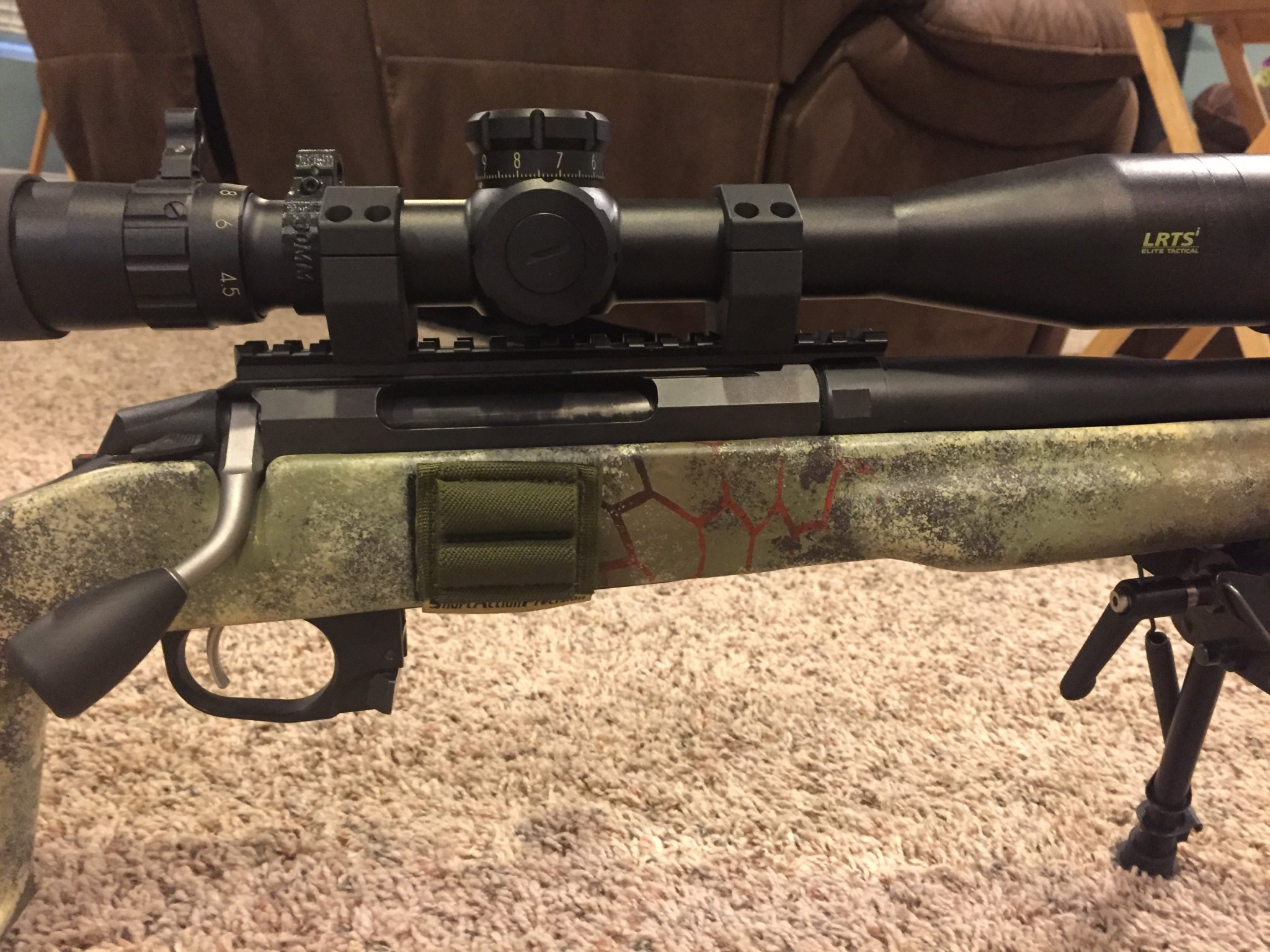

My Tikka was Greg's prototype and it has been plenty accurate. I shot the attached 5 shot group last night with some 140 ELDM. I had been using the 140 RDF for matches and the 143 ELDX for hunting. This was with Peterson brass, 41.4 gr Re16, and CCI 450's. 2858 fps, 6 SD. I will definately use the BugNut system on my T3 Varmint when it needs a new barrel.
I can swap barrels in 10-15 minutes with an inside wrench and a PMA barrel vise.
Greg has a great system and Bartlein makes great barrels.

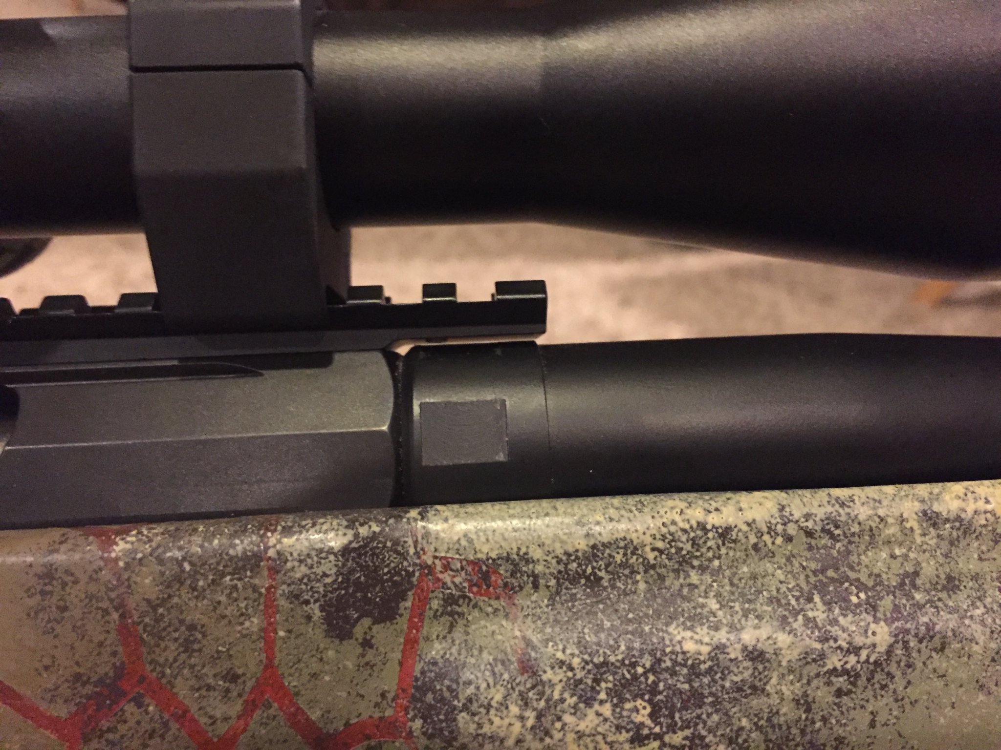

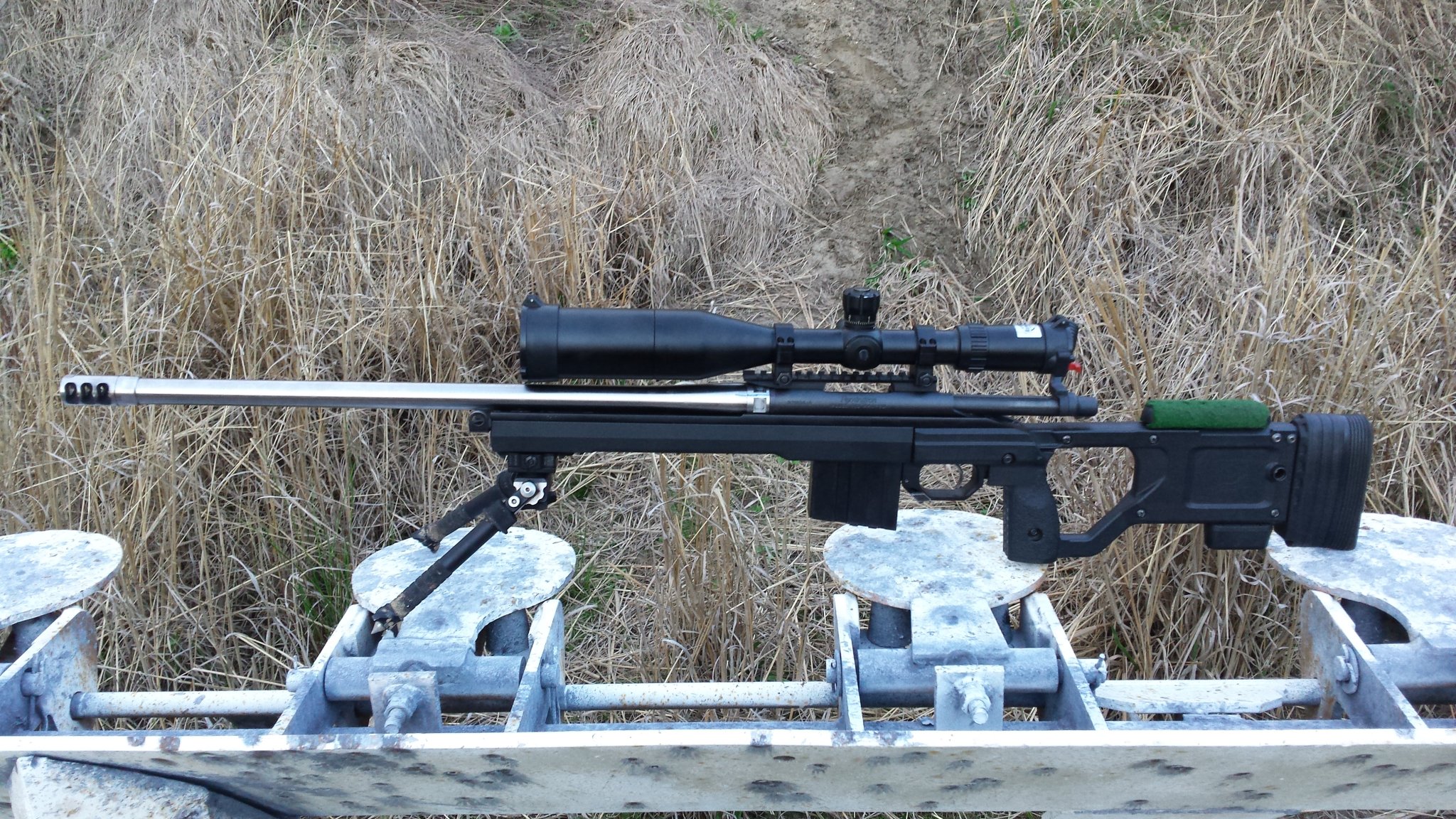

I won a bugnut Bartlein 20 inch threaded .308 barrel at the March 2017 North American Sniper Championship. First, I'm not a benchrest shooter, I usually hit the 1.5 - 2 moa targets at our local rifle matches. To address the accuracy question my bugnut shoots as accurate, for me, as my custom gunsmithed .308 Krieger barrel. I installed this barrel on a factory Remington 700 AAC-SD. That rifle never held zero or shot predictably. The bugnut from day one has held zero for over a year. The velocity is 2630 from the 20 inch barrel with factory 168 Federal Gold Medal match. I've used this rifle in Law Enforcement style matches were the focus is hitting a small dot at one to two hundred yards, this barrel will shoot with a shouldered barrel anyday. This accuracy from a non-true modern Remington action. The factory action and bolt could be the reason others are seeing less accuracy than a shouldered barrel. The attached pics are of my rifle and two 5-shot groups. As you can see the rifle will shoot, I need to work on driving it consistently.
