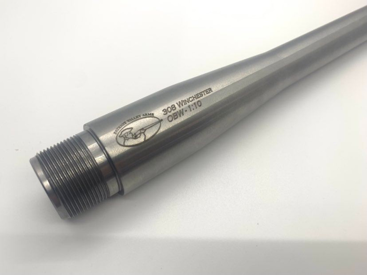

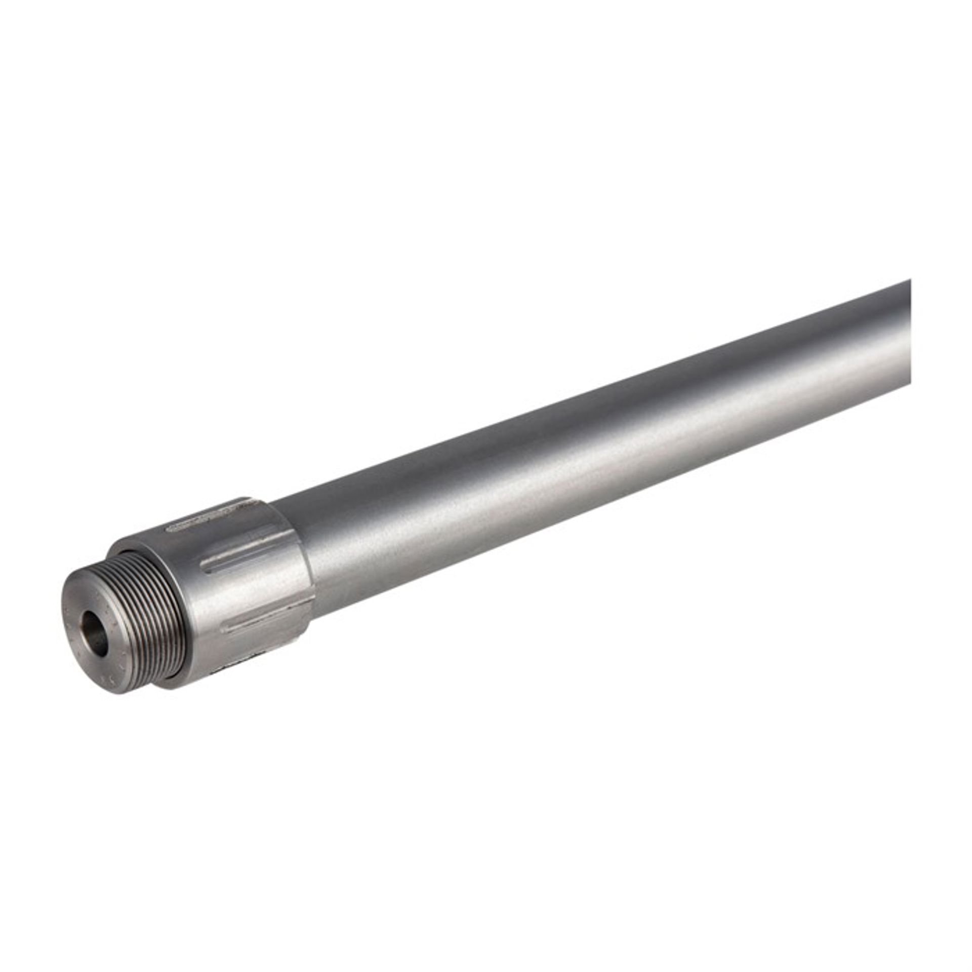

Pictures probably not Tikka barrels.
Shouldered barrel. All one piece.
Savage barrel nut style. Nut spins in the threads of the barrel. Torque it up against face of action after setting headspace by varying depth of barrel in action. Requires go gauge.

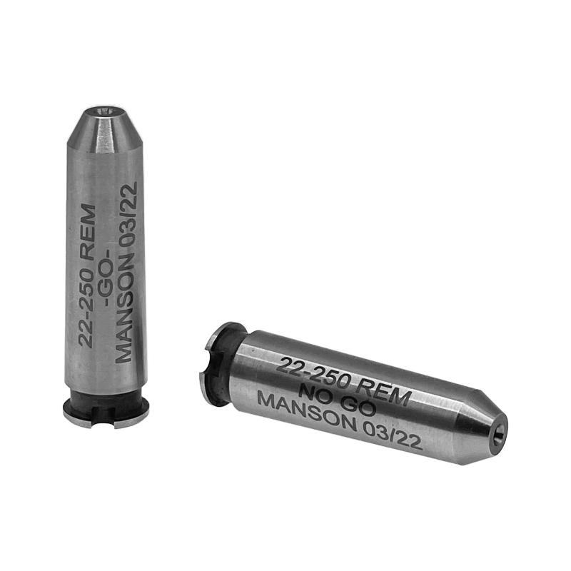

Probably worth pointing out to the OP that you also need a gauge that goes into the chamber to set headspace with the barrel nut.

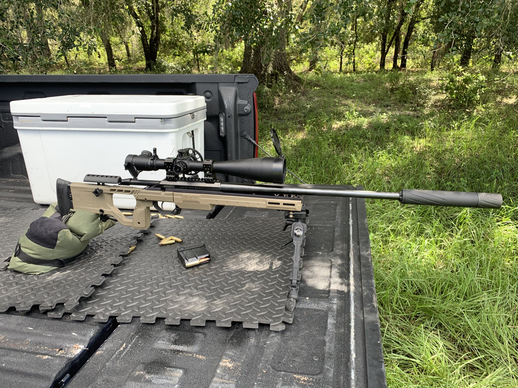

Here’s my t3x ctr in 6.5. Love it!
But, this build is definitely way more than your project budget. Remington 700 may be more feasible..
