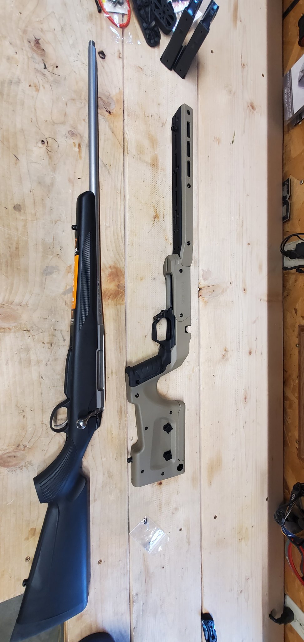

Well I bought the tikka. Left hand in 22-250. Also got a MDT XRS chassis in FDE. Gonna let Sonny boy pick out a tacticool bolt knob and we are gonna burn up that factory barrel on some P dogs. And he will burn it up. Last time out he started my suppressor cover on fire shooting his 243 AR10. This after many requests to slow down the rate of fire.

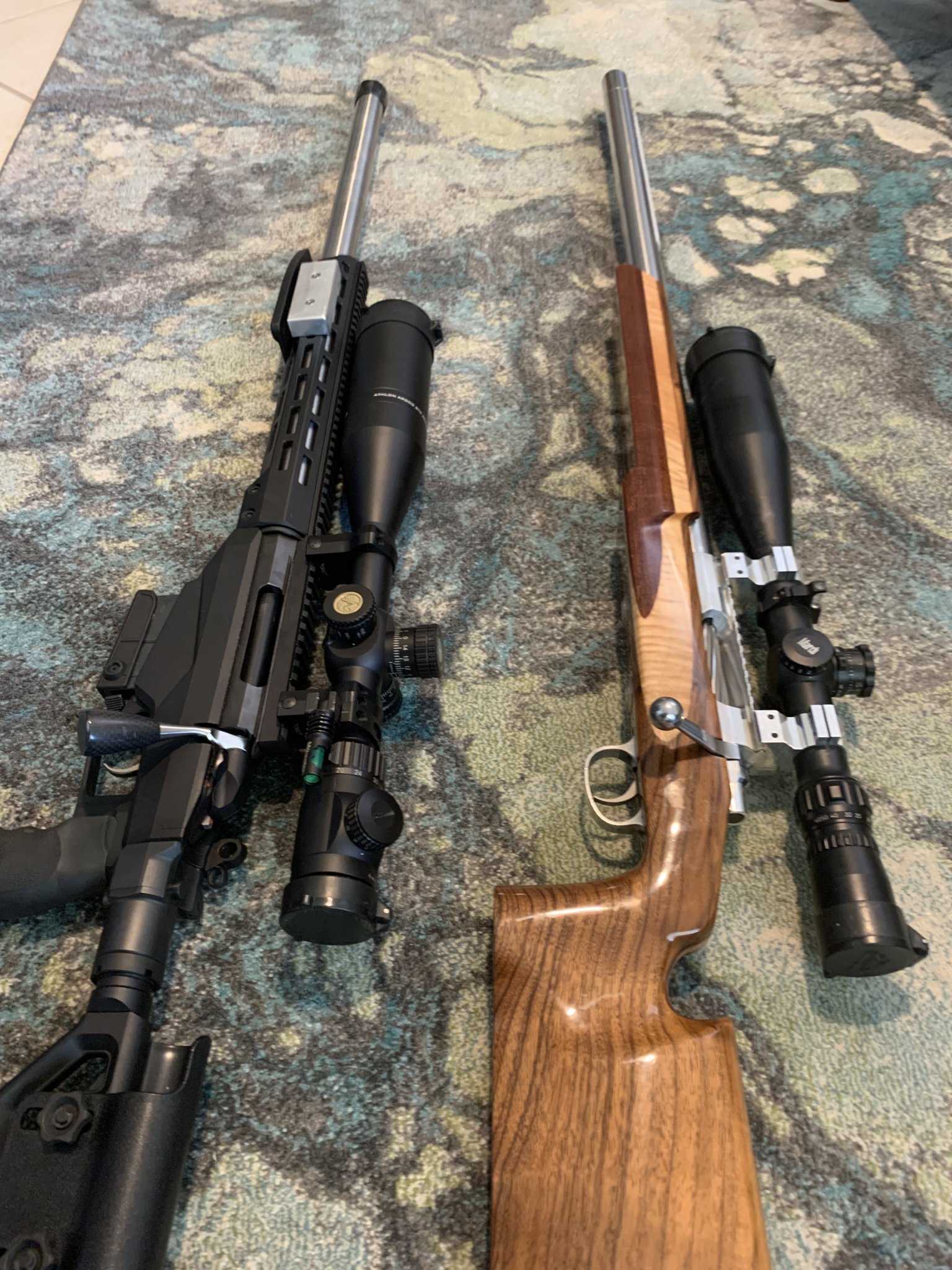

I'm a lefty. I bought a tikka to drop in an expensive chassis (cadex) and it is definitely a very good shooting rifle. It's every bit as capable as a full custom setup (with the right ammo of course).
If the cost of a tikka is not far from some of the more budget friendly custom options (zermatt origin as an example), maybe the PX is your best bet. Might be able to find a left handed action or rifle if you're patient enough. And a custom action with an R700 footprint could end up staying with him for a lot longer as he gets older because there are more options for upgrades (triggers, stocks). My tikka is nice and a good shooter, but I have no need for it anymore once I went custom. I wanted my competition rifle to match my trainer rifle, and the tikka feels different, so I decided to just buy a new bolt and barrel for my comp rifle to keep operation the exact same. I have no need for two .223's, so the tikka will be moving on. In these cases, a custom with an R700 footprint is cheaper.

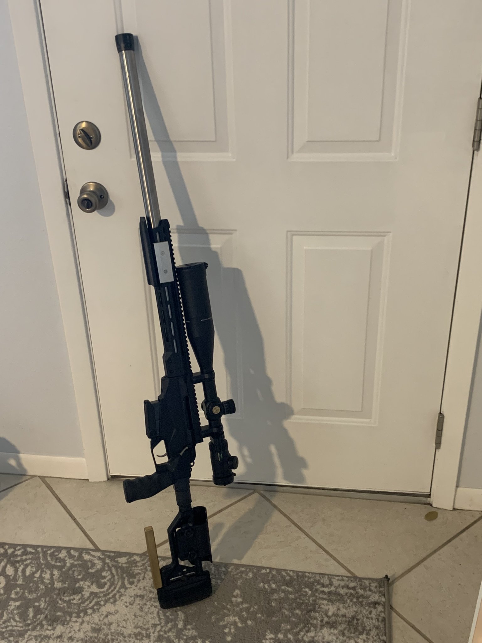

This is good advice! I am left handed I have the tikka T3X Tac came in 6.5 I now have a Bartline Barrel in 6 Dasher it is a Tack driver I shoot f-class 300,600,&1000 yards I have done a lot of upgrades to get it competitive. But as mentioned by many it still falls short in sone areas!! I just purchased a full blown custom.

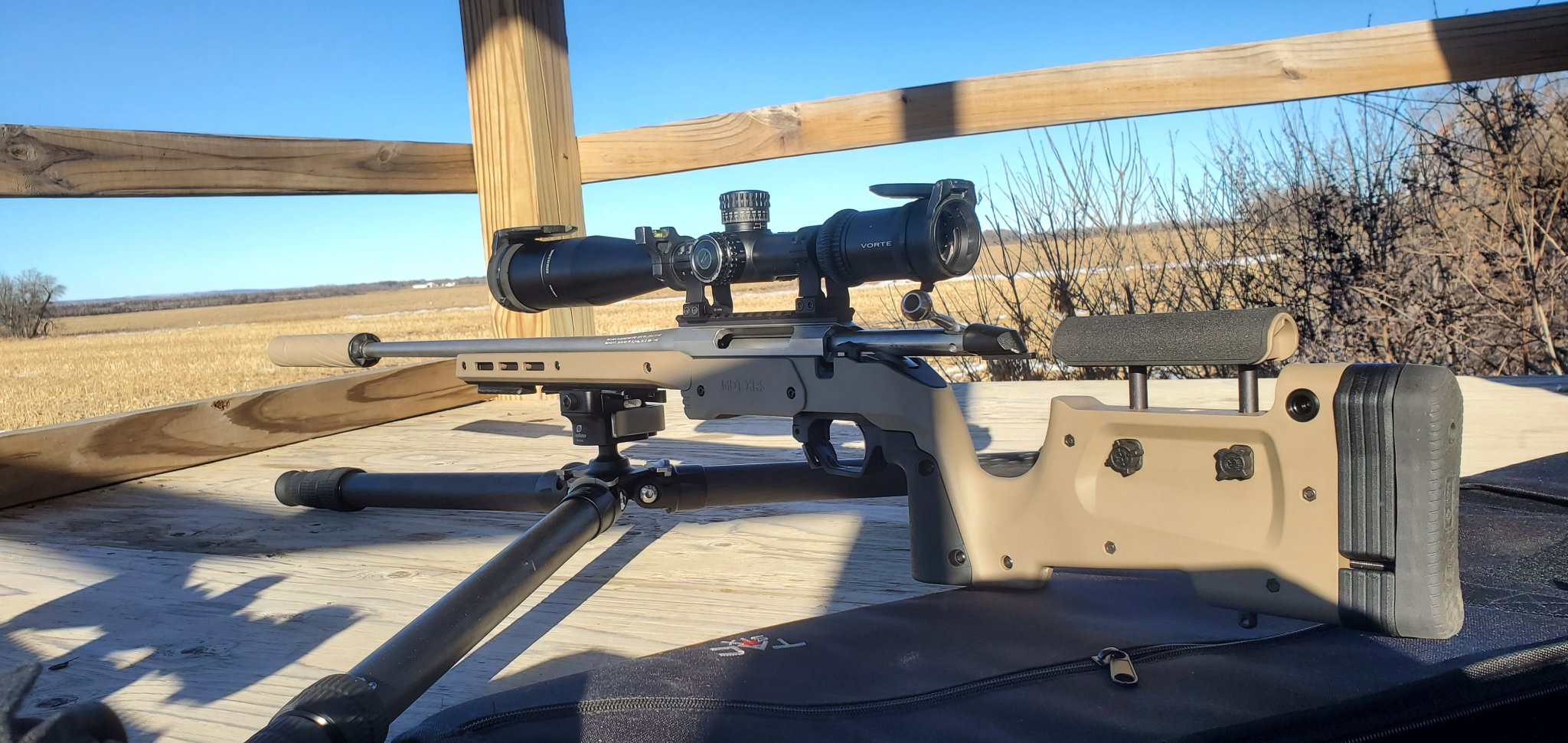

Dropped a plain Jane tikka t3 in a MDT XRS chassis. Makes for a fantastic rig. Grabbed some of my handloads from another rifle to break it in and it shot fantastic. 10 rounds on the magneto, cook up some range dope and sonny boy was taking head shots on coyote steel at 425 and smoking the 600 yard IPSC plate. I think I need to dump my salvage and build one for myself.
That's about as far back as you can get the tripod with that particular arca rail. It's much much more stable than a bipod. They are vortex rings. I think high. They are much too high but it's what I had on hand and my son liked how they look so we kept them.
I am looking for a set of high rings. I thought they only made low rings, though.
