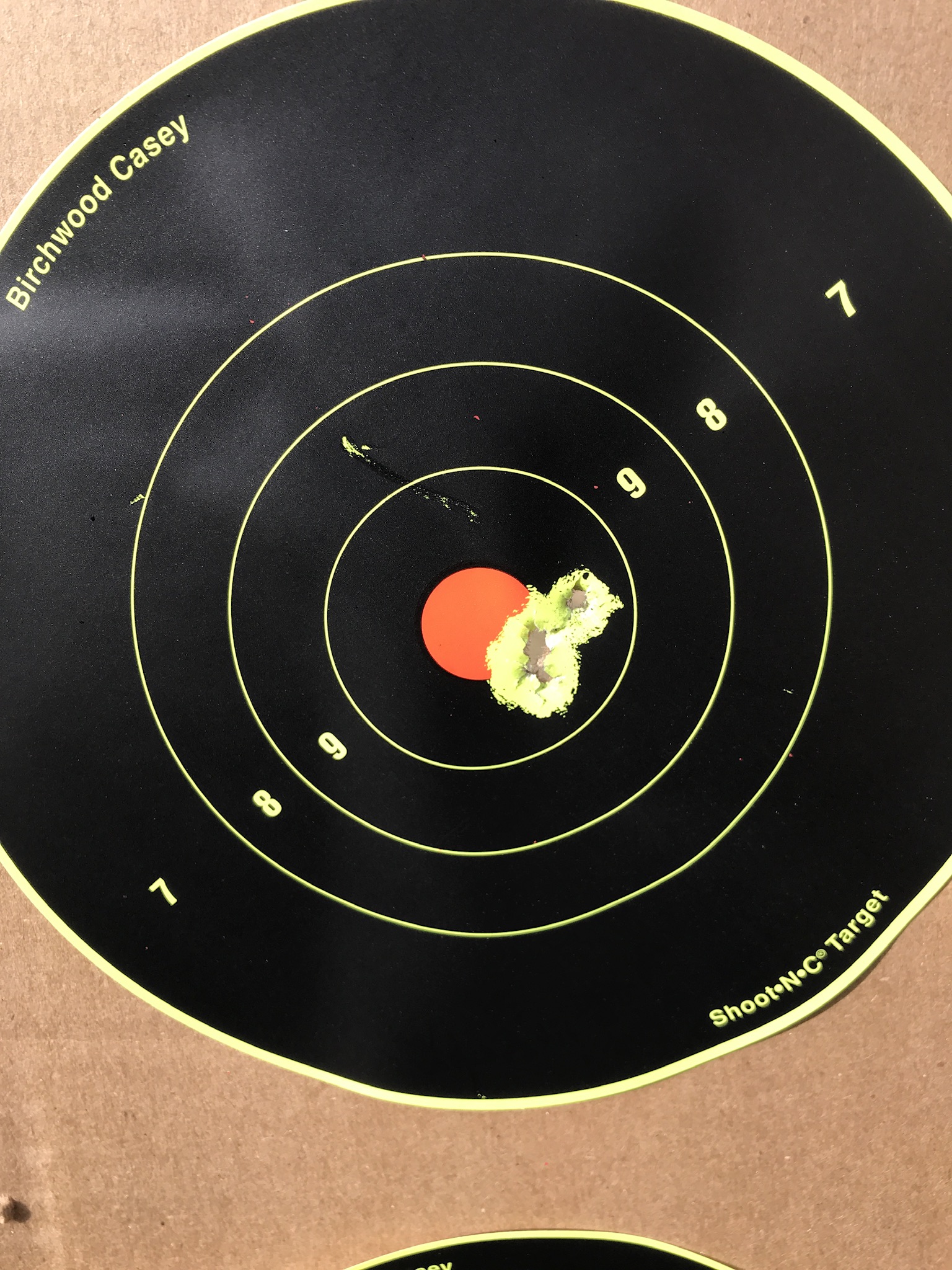

Interesting. I've never shot 50 yards before until today. I've shot in the .75's and .9's pretty consistently with match ammo on the Factory Barrel. This is with Lapua and Eley Match/Tenex. When I switched to the IBI barrel, it didn't like Eley, but it shoots SK/Lapua in the .6-.7's. So I guess 20% better.
I was able to try out 50yds today with the new barrel, it shot okay, but not as amazing as I wanted. I was hoping to avg 1/2 moa with it since I'm shooting 2/3 moa at 100. I was averaging slightly less than 3/8" groups.

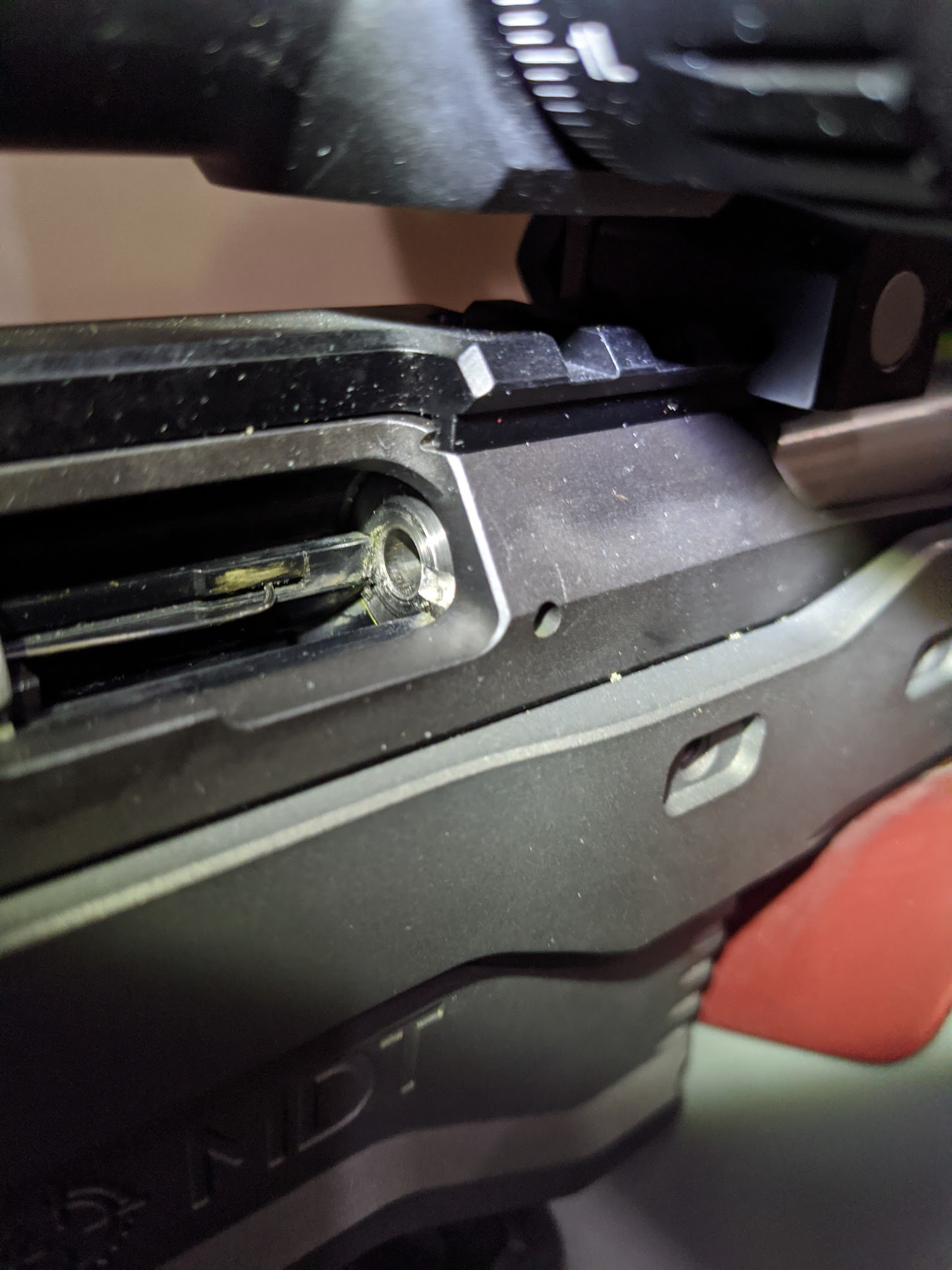

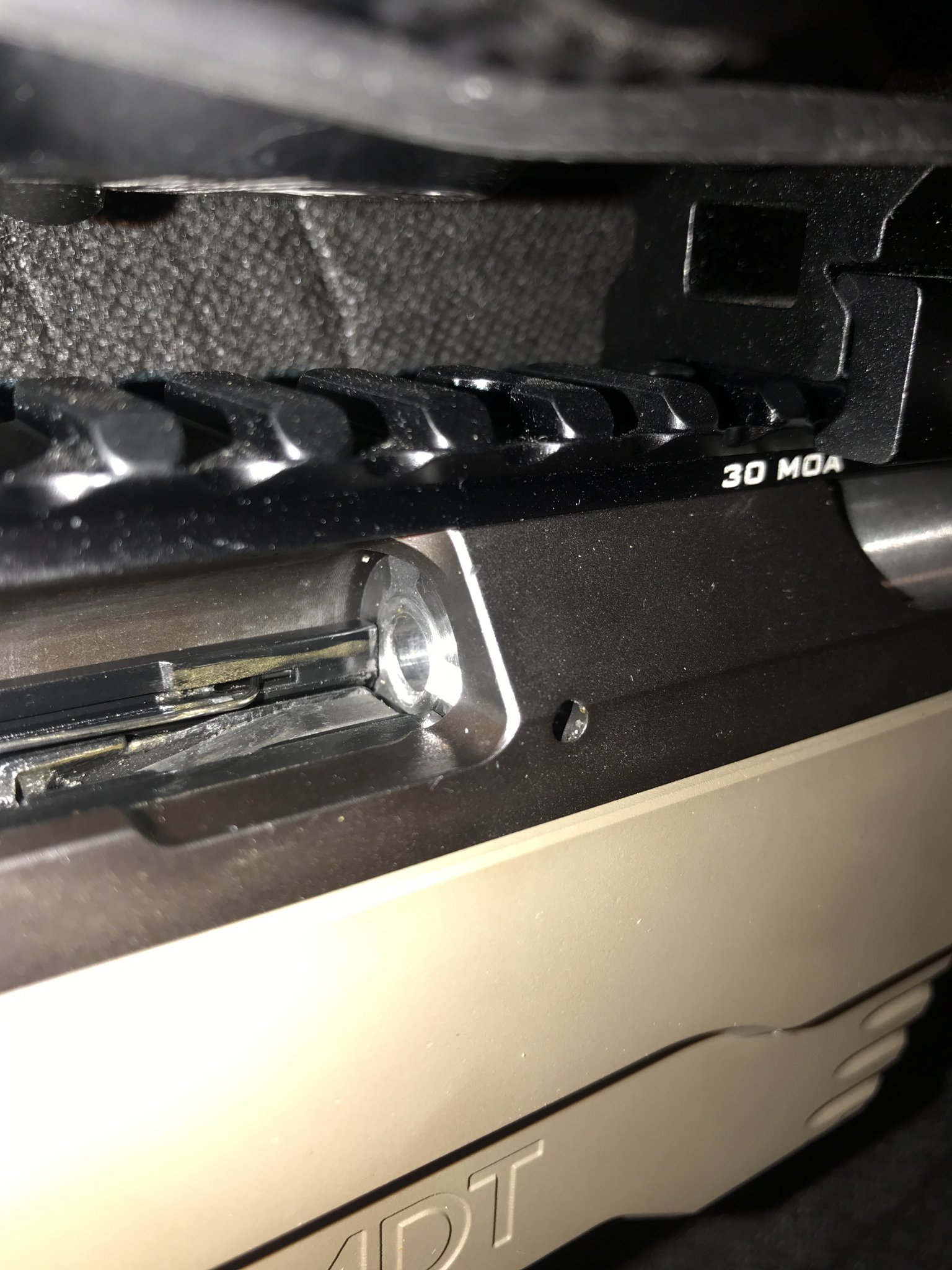

If I smoothed out / jeweler's file at the bottom of the barrel right there, is that really going to affect precision? The other option is that maybe my headspace is still too tight and I need to loosen it up a teensy bit more.
Oh crap... I went to check my old barrel, and I guess my negligence broke it when I was removing it. I didn't have a wooden dowel rod, so I wrapped the head of screw driver with some cardboard and stuck it through the chamber to hammer out the old barrel. Well... it looks like the old barrel did have a feed ramp -- but I also noticed I basically broke my old barrel too... I guess the only place for this to go now is the garbage :(
I pressed it out with a 3/8 socket and a 1/4 extension. I scored it pretty bad. But the IBI barrel as a little bit of a ramp on it. Not as much as the factory barrel. I have 3 days of snow/ice so I’m not going to the range this week.

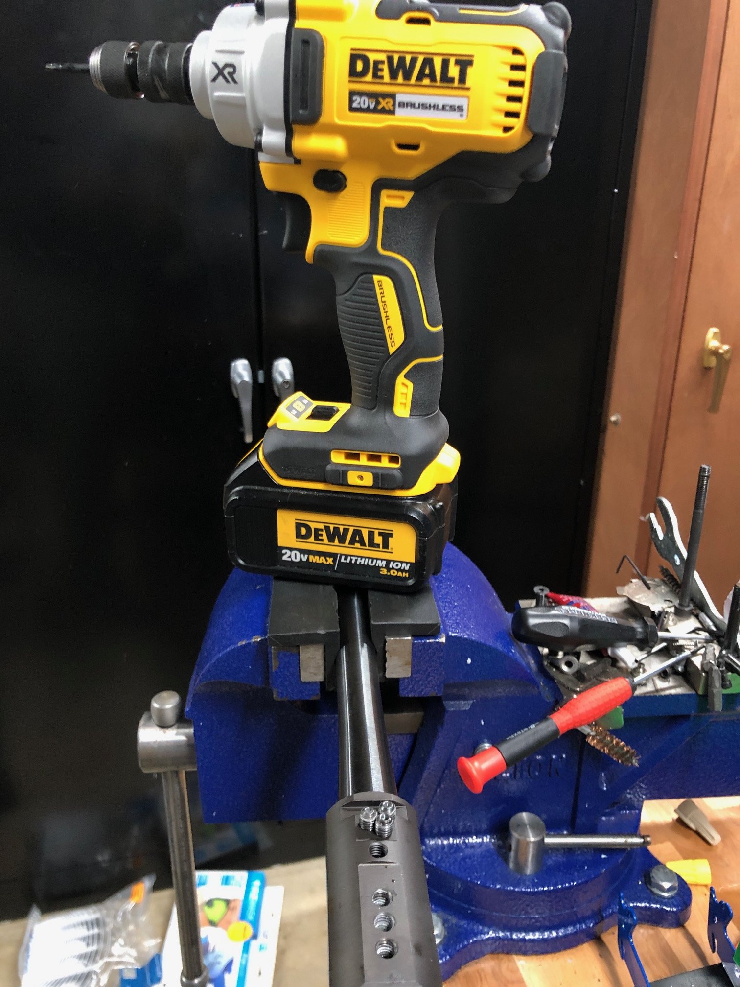

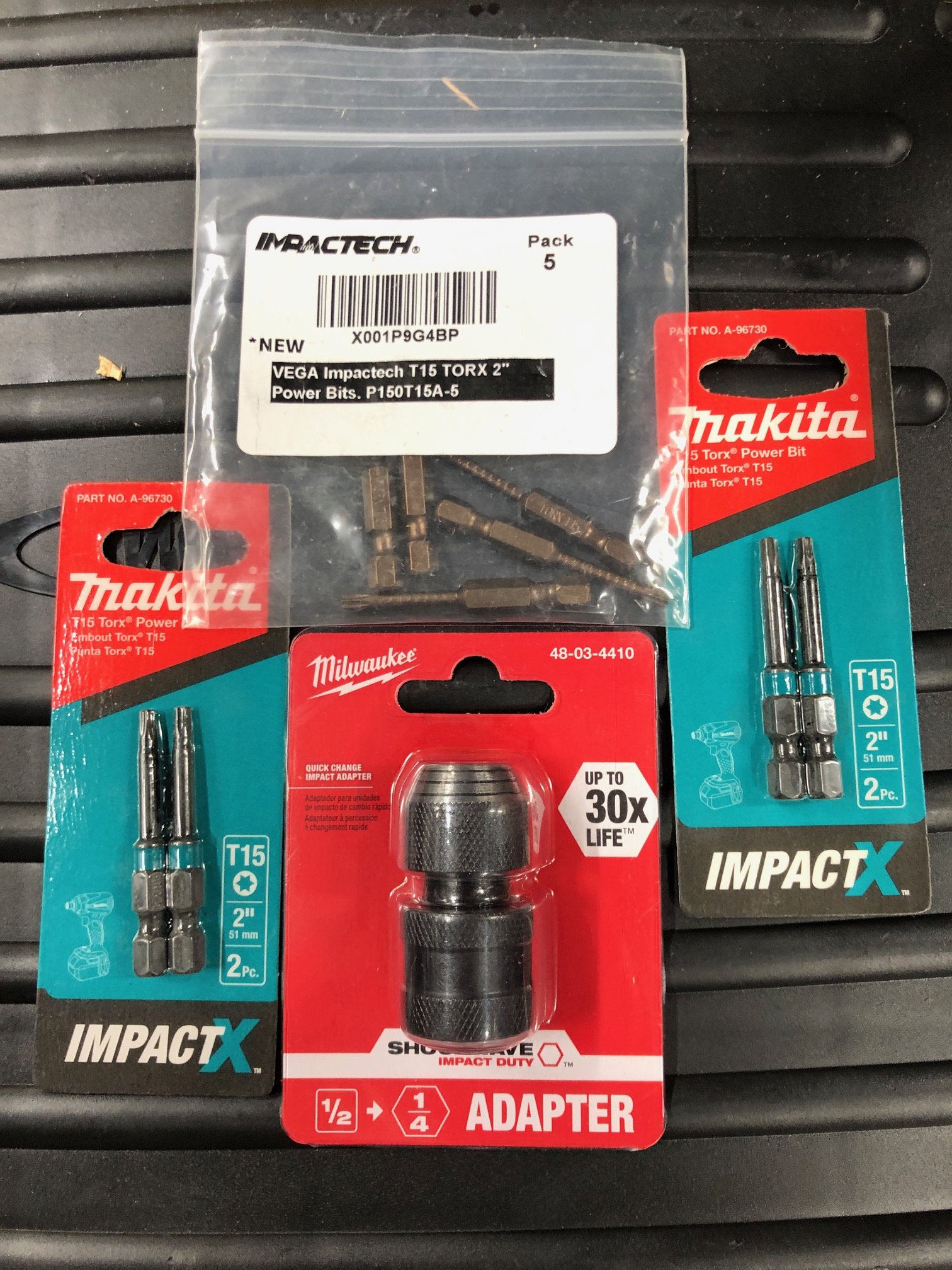

Removing the bolts is easy with an impact gun and some bits:
The only thing you need to do is use it on a very low setting. Don’t depress the trigger all the way...

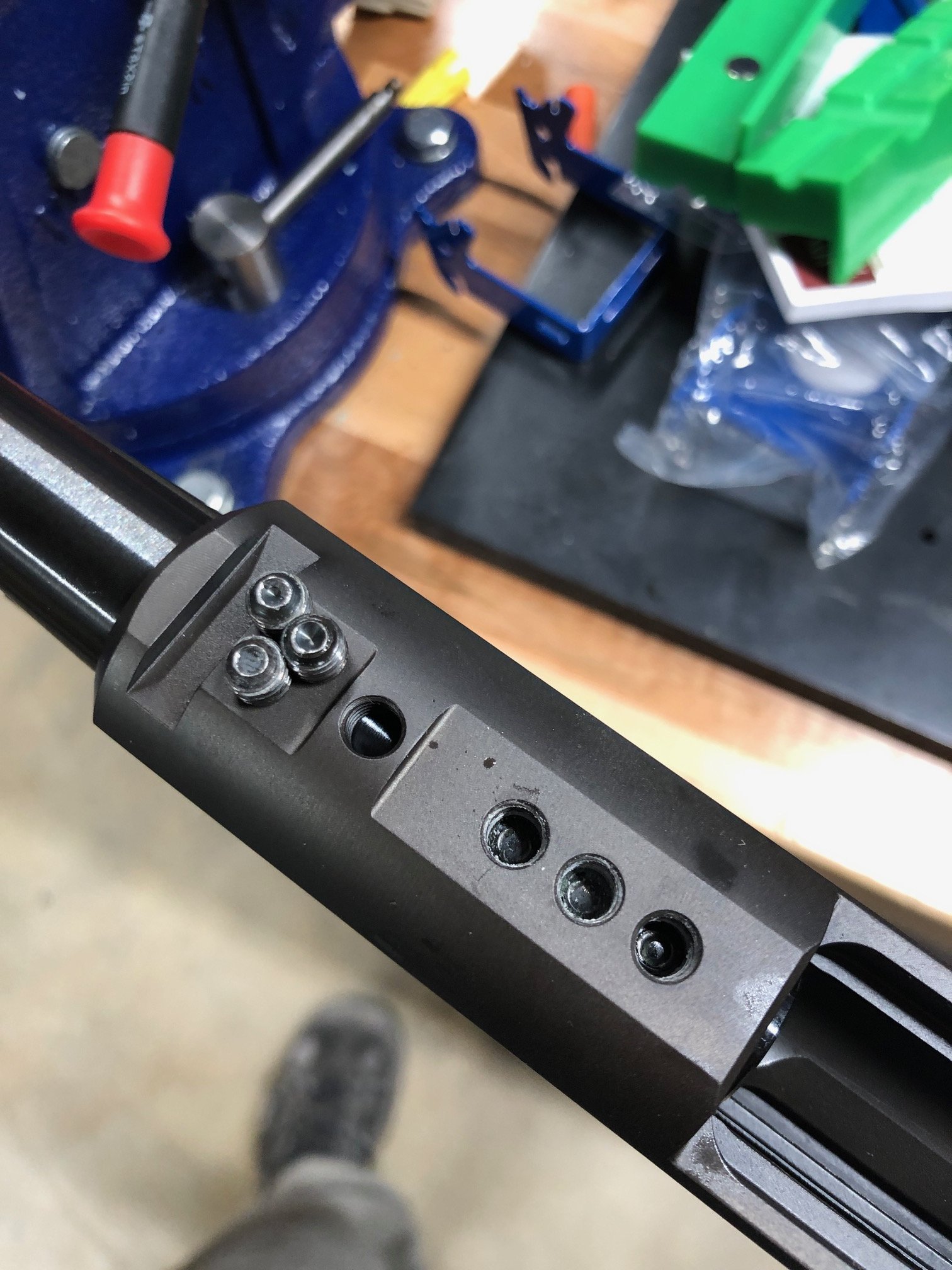

Got the Lothar Walther barrel today and installed it.
It is a perfect fit and requires you to freeze the barrel and heat the receiver To install it.
They send you a slightly longer pointed setscrew, and you simply install the bolt.
I did use go-no go gauges to double check, then set the new pointed screw. Then Torqued them all to the same 62 in/lbs with some blue loctite.

So...ahhhhh.....
1) Put the barrel in the freezer
2) Put the receiver, and only the receiver (no trigger, no magazine well, no bolt) in the over at 250F
3) Come back in an hour
4) Put on your nomex flight gloves and grab the receiver / get the barrel out of the freezer
5) Put antiseize on the mating surface of the barrel (lightly)
6) Insert the barrel into the receiver so that the V groove on the bottom of the barrel lines up with the middle set screw hole in the bottom of the receive.
7) Install the trigger group
8) Insert the bolt until it almost touches the cut out in the barrel face for the extractor
9) Using a large nylon coated wrench, turn the action until the extractor is centered into the cut out for the extractor (extractor relief) on the barrel.
10) Torque the first and third set screws 20in/lbs (use blue loctite)
11) Verify that the bolt opens and closes with a GO Guage (PTG 22LR Rifle works with the extractor), and that the extractor is centered in the extractor relief cut in the barrel face without binding
12) Torque the middle replacement set screw from Lothar Walther to 20in/lbs
13) Re-Torque the set screws to 40in/lbs

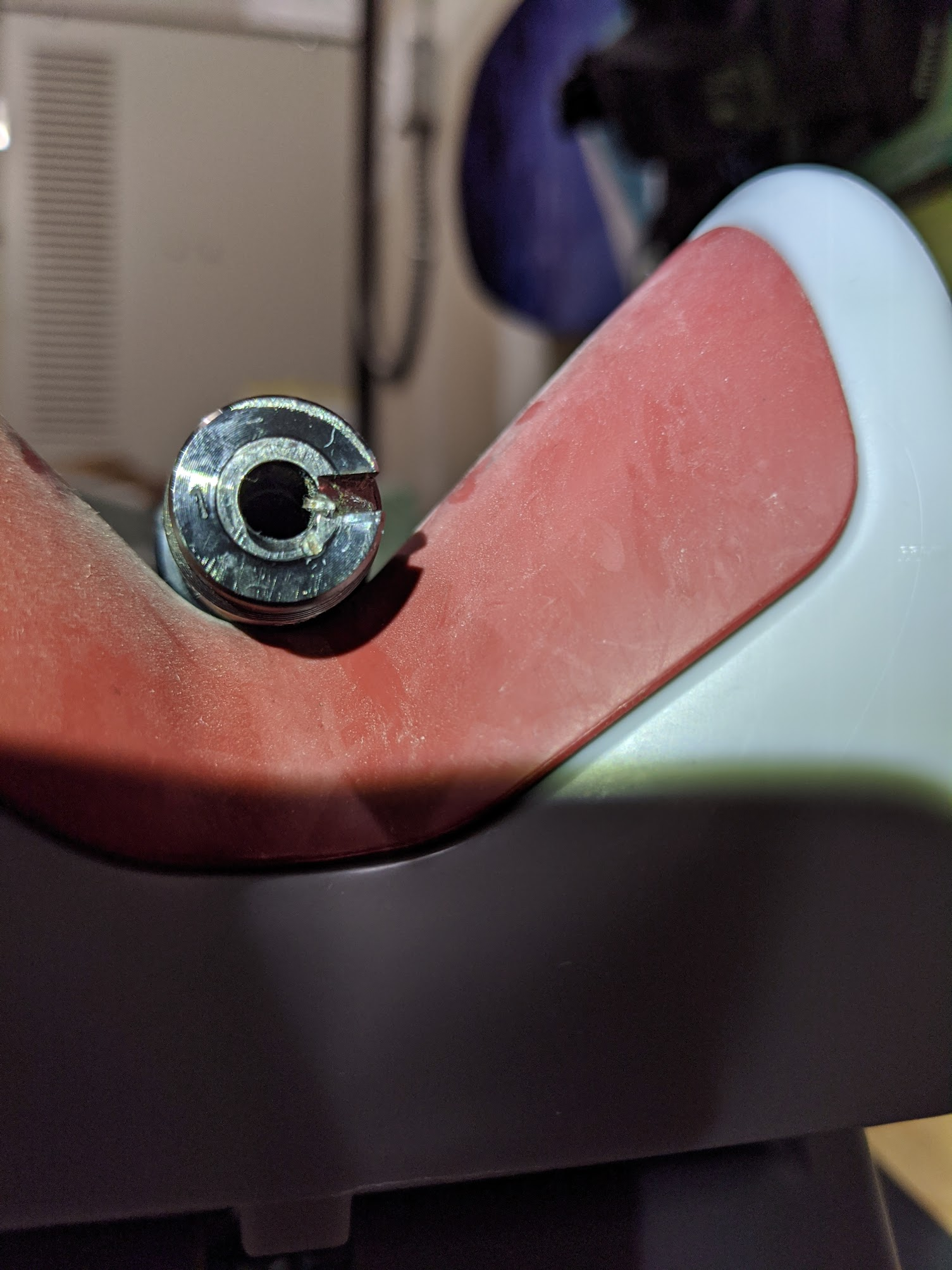

Old thread, but just went through the trauma of tikka t1x barrel removal. Got 2 screws out with pb blaster and an impact drill, 3rd one stuck hard. Broke a hardened steel bit off in it, and the bit wouldn't budge. Used a carbide bit to drill it out, then a cobalt bit to drill the grub screw. Saved the threads, and ordered replacement grub screws (had to get 100 at granger).
If anyone needs replacement grub screws, send me $1 and I'll put 3 in the mail for you.
