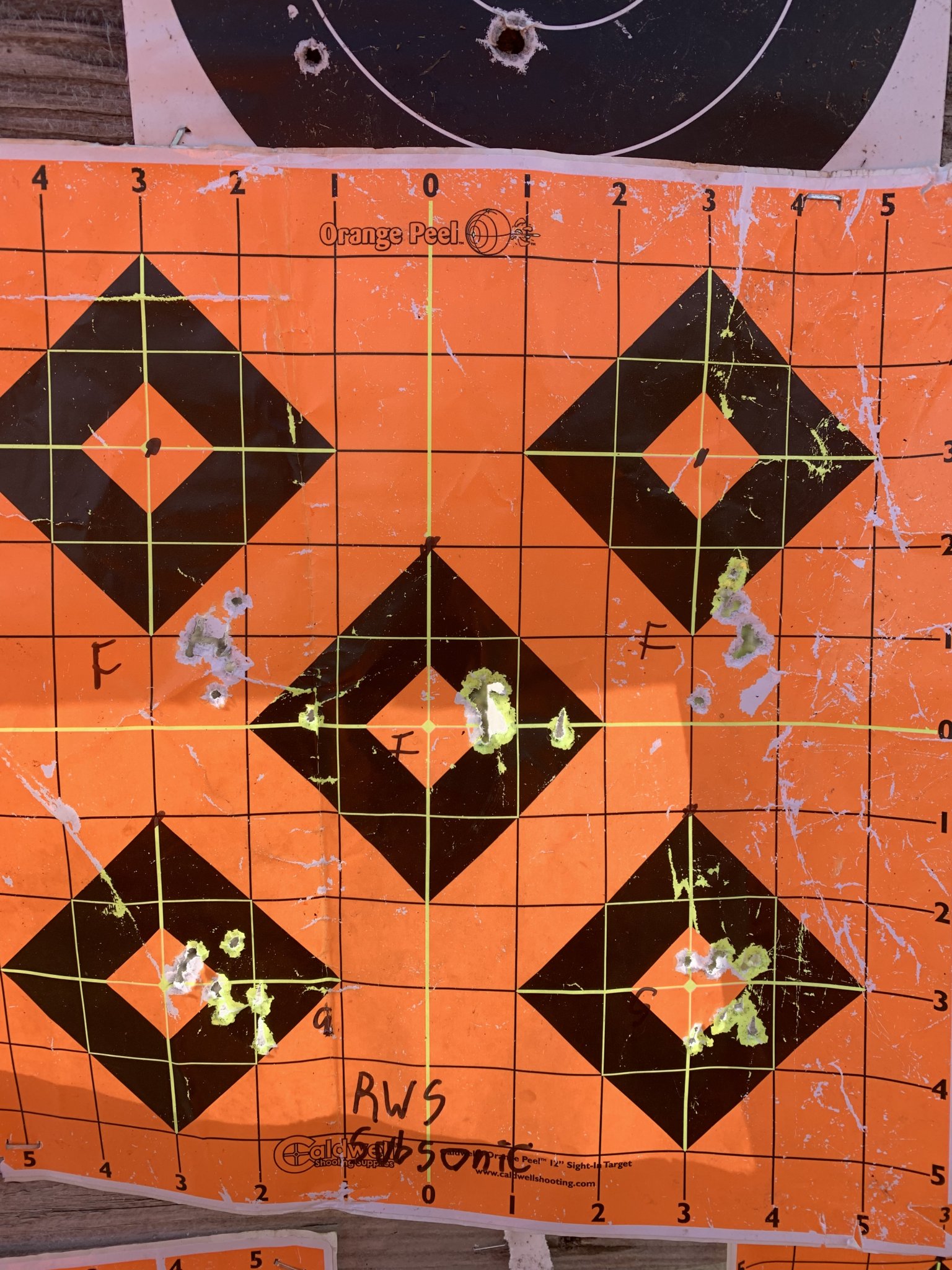

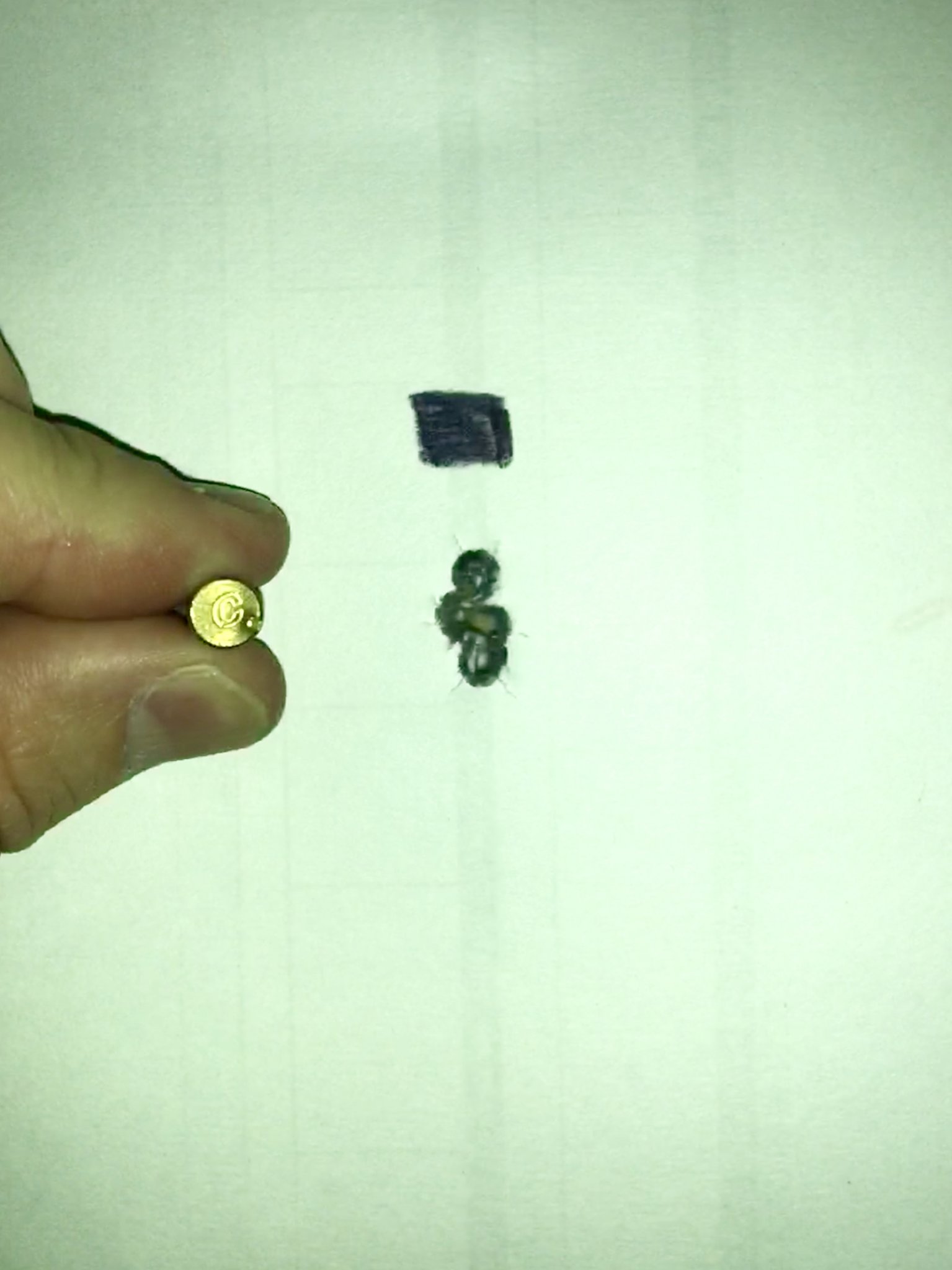

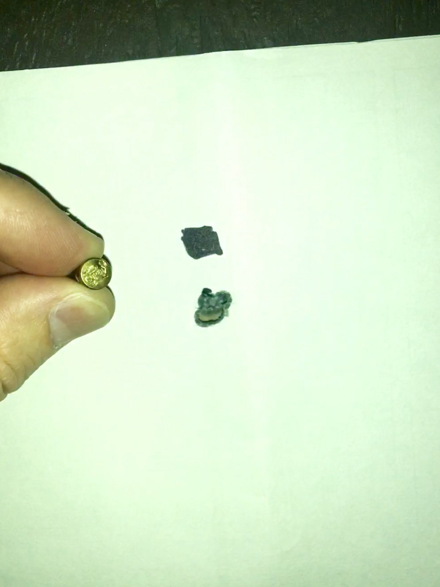

Best group of the day top right with CCI SV on 75m.
RWS target and SUBs were horrible, almost 2 inch 10 shot groups with the SUBs
Geco ~1060fps were also fine
Keep in mind the setup is very basic, decent stable table, DIY bags, picatinny rail on the rear stock (waiting for monopod) and on the front end the same (waiting for bipod) with a rubber grip behind it, ergo the rifle doesn’t recoil nice and smoothly straight back.

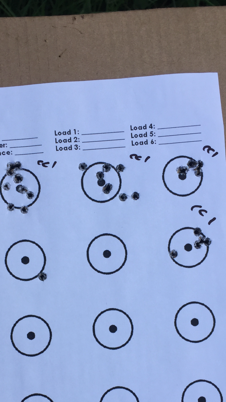

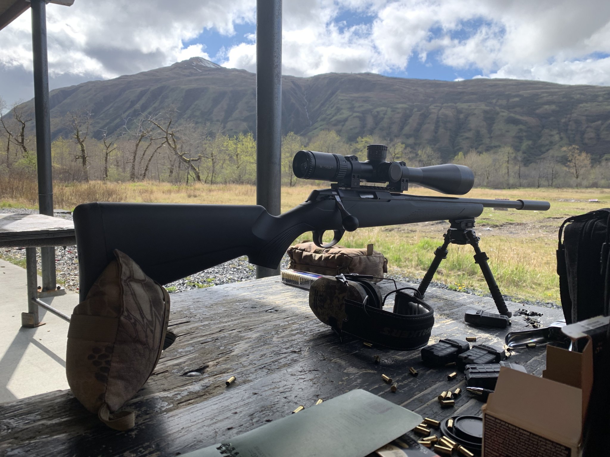

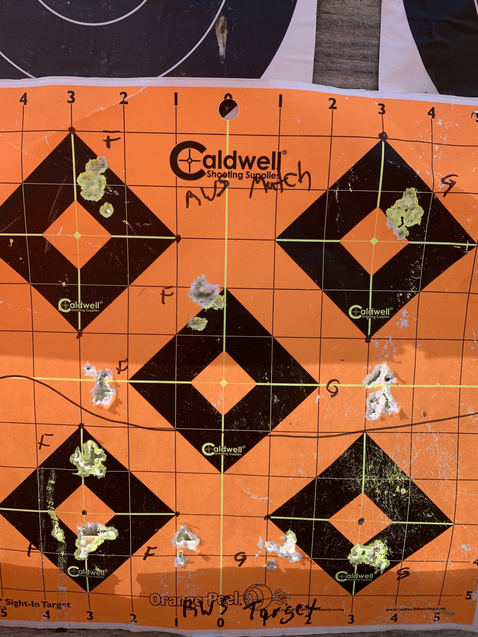

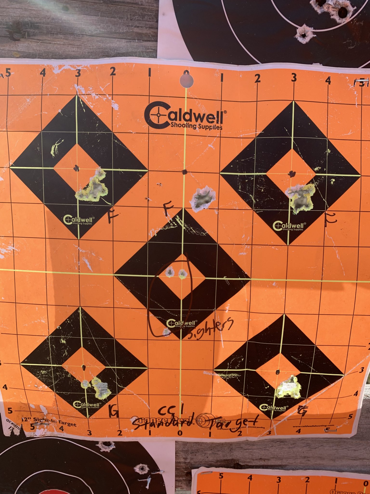

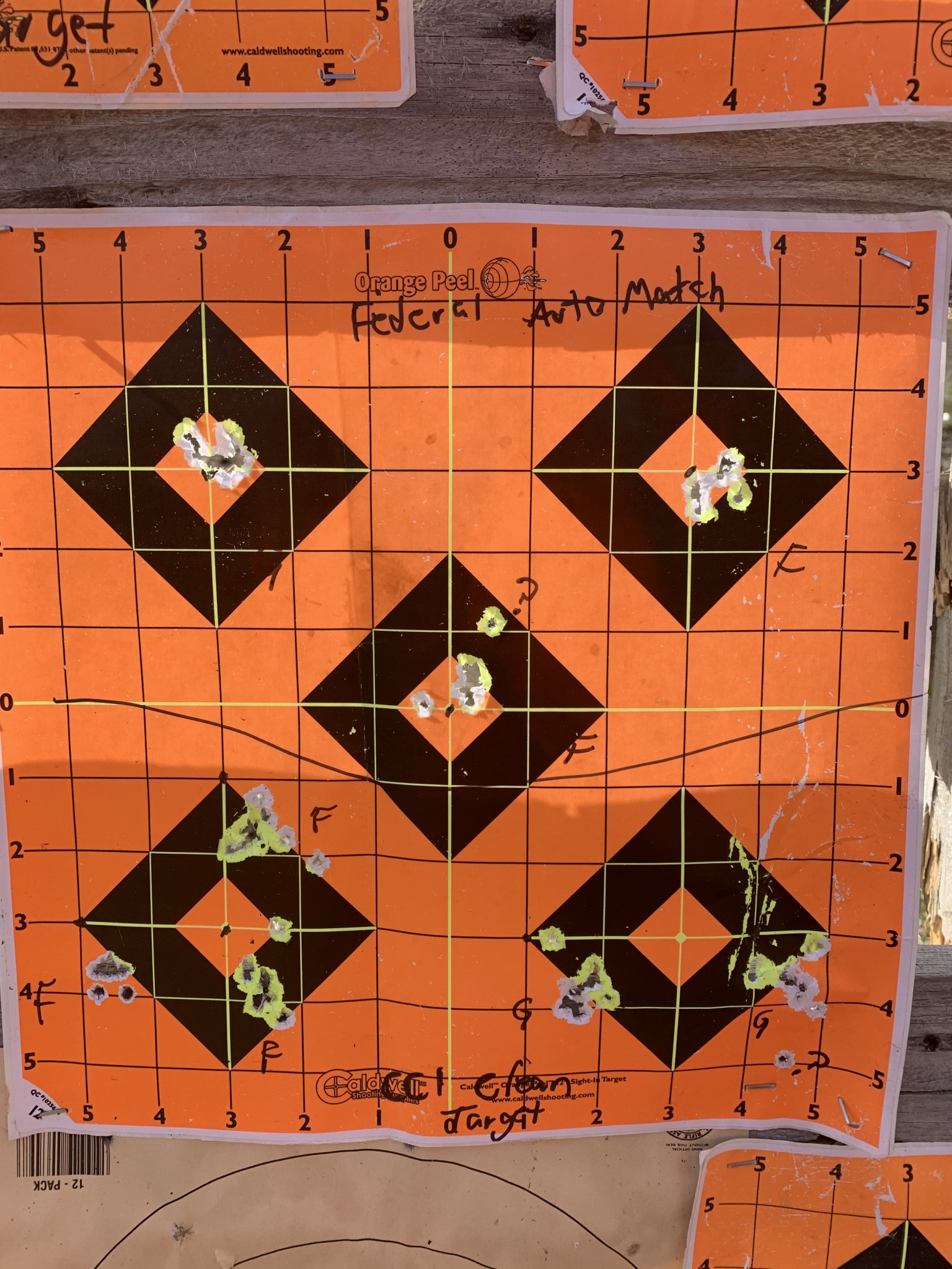

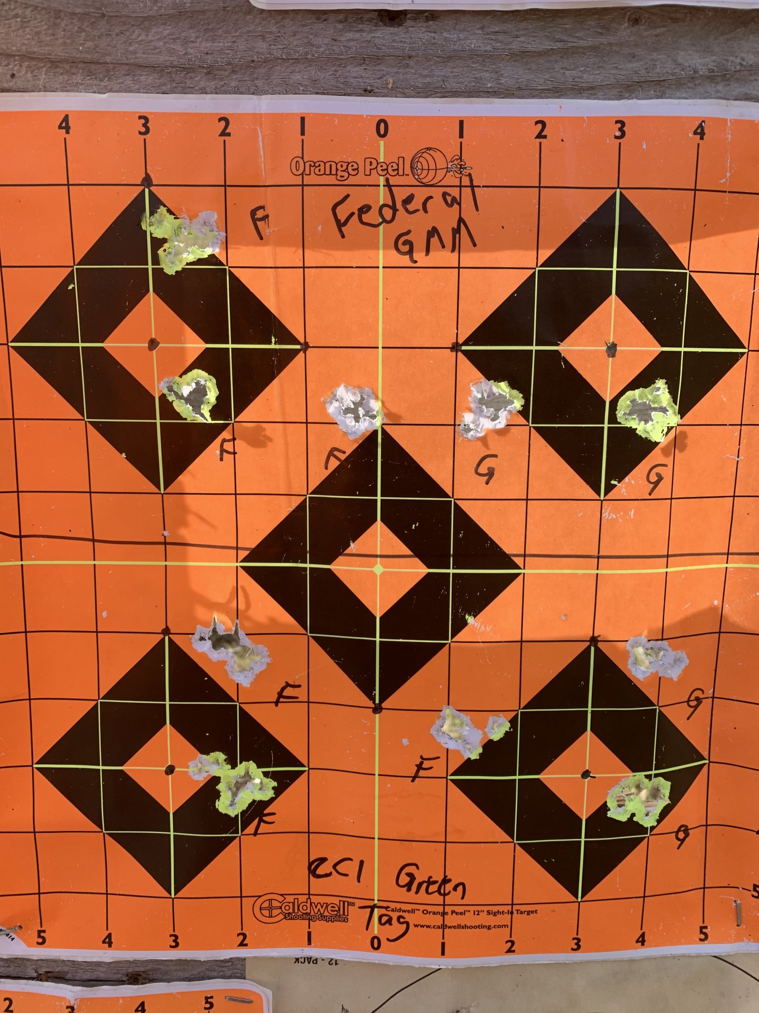

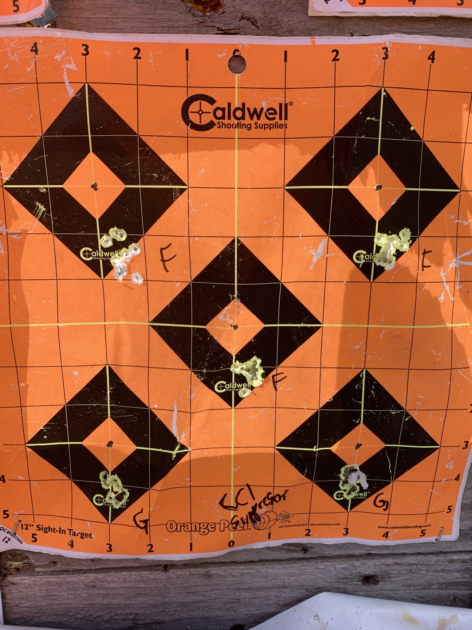

The weather cooperated today and I was able to make it out to the range to finally shoot my T1X and get the scope sighted in.
I absolutely love how the rifle handles and shoots. I put 400 rounds through it to try and see what grouped the best. Out of the 400 rounds I shot, I did have about 15-20 rounds not fully eject, most spun 180 while only a couple just stuck out. I did find that getting the tenth round in the mags was much harder sometimes, but not always.
The two best shooting ammos were the Federal Gold Medal Match in first and the CCI standard target right behind it. CCI green tag was pretty close to the standard target, but produced just a couple extra fliers. Both the RWS target and match performed about the same, but didn’t seem to be as consistent as the Federal GMM. I sighted the rifle in using Federal Auto Match, which grouped better than expected for a box bulk ammo. I shot 50 rounds of each type in 5 ten round groups at 50 yards. I figured the first three groups would be considered fowlers, and the last two the best, which was mostly true.
I’m going to pick up some more Federal GMM, CCI green tag and standard target and take them out to 100yds to see which holds up at a little more distance.
Overall I am very pleased with the rifle and am excited to use it for shooting my local rimfire benchrest matches.

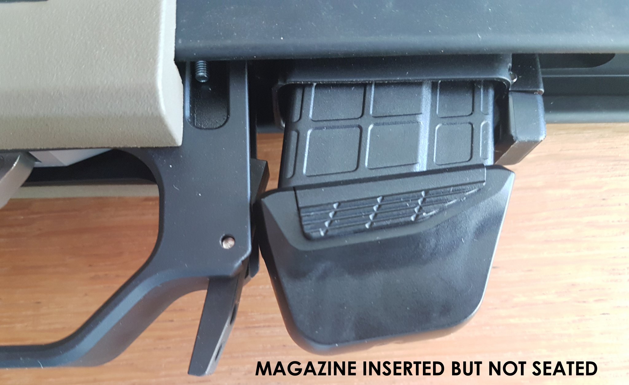

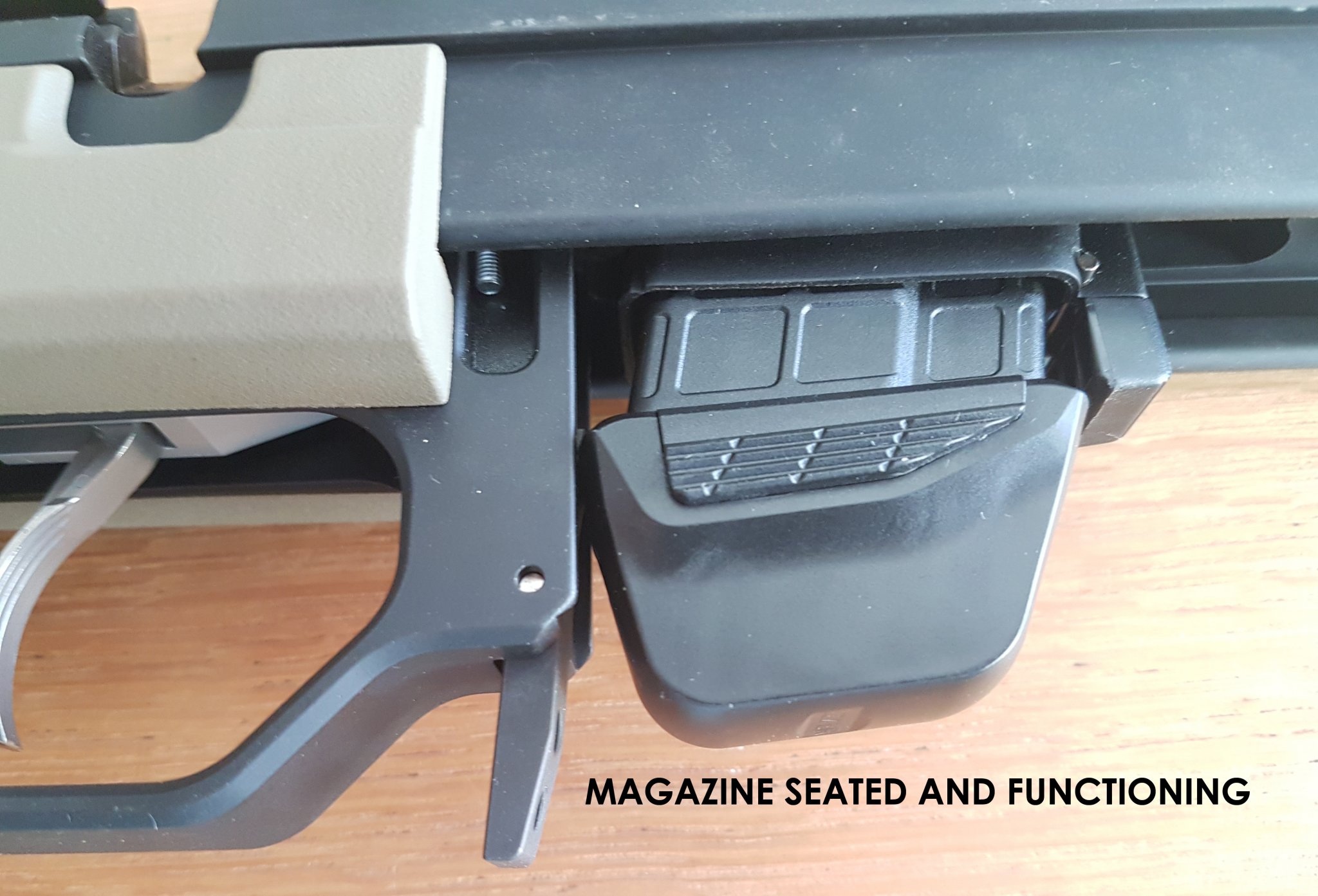

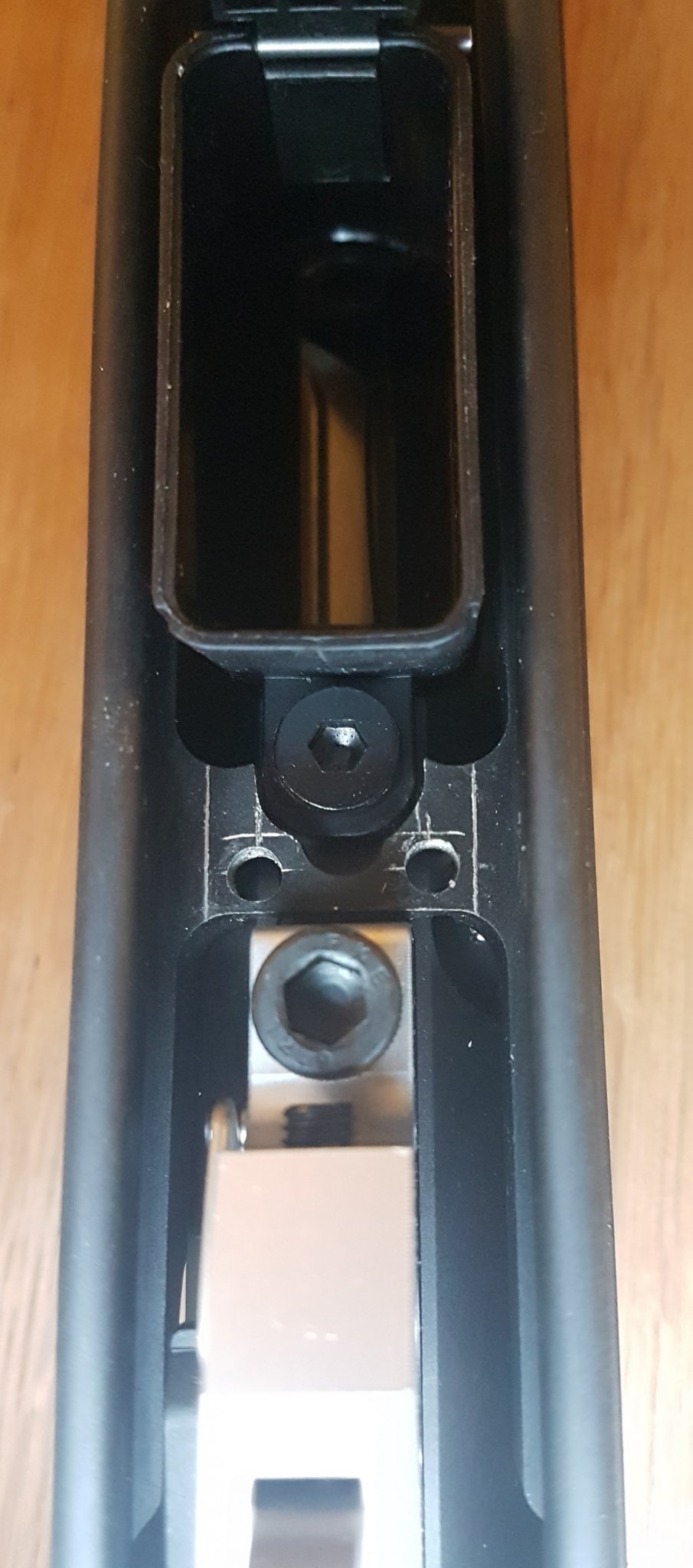

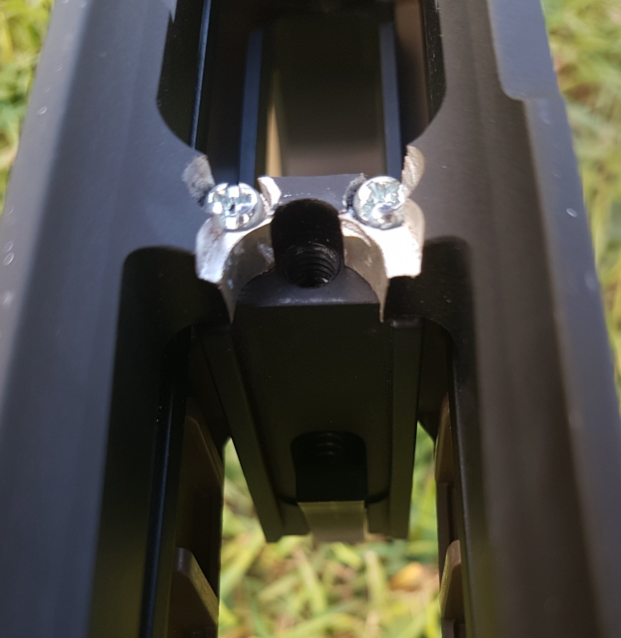

I finally got around to modifying my T3 KRG Bravo to suit the T1x.
Pictures should explain it, but it involved a short head cap screw for the magazine well, drilling/counterboring 2x holes in the top of the Chassis to suit M3 screws (will probably change them to hex drive pan head - zinc philips were all I had on hand).
Drill and Tap M3 into the trigger guard due to the existing screw no longer being used.
Remove/Drill/Mill/File material to allow for Plastic Tab on Magazine and Cap screw.
I've checked it all assembled and can still use the T1x magazine with the AICS mag lever in place. The bottom rear of the magazine presses against it, but it means I can swap a T3/T3x and T1x in the one stock. I did make the Thru-holes a little bigger so the 2x M3 screws can slide a little back and forth to get the right tension when using AICS magazines still (original screw did the same).
Next up will be a Sterk handle and shroud ;)

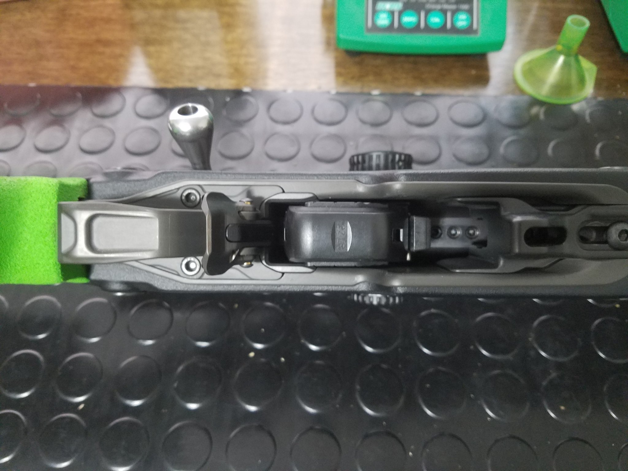

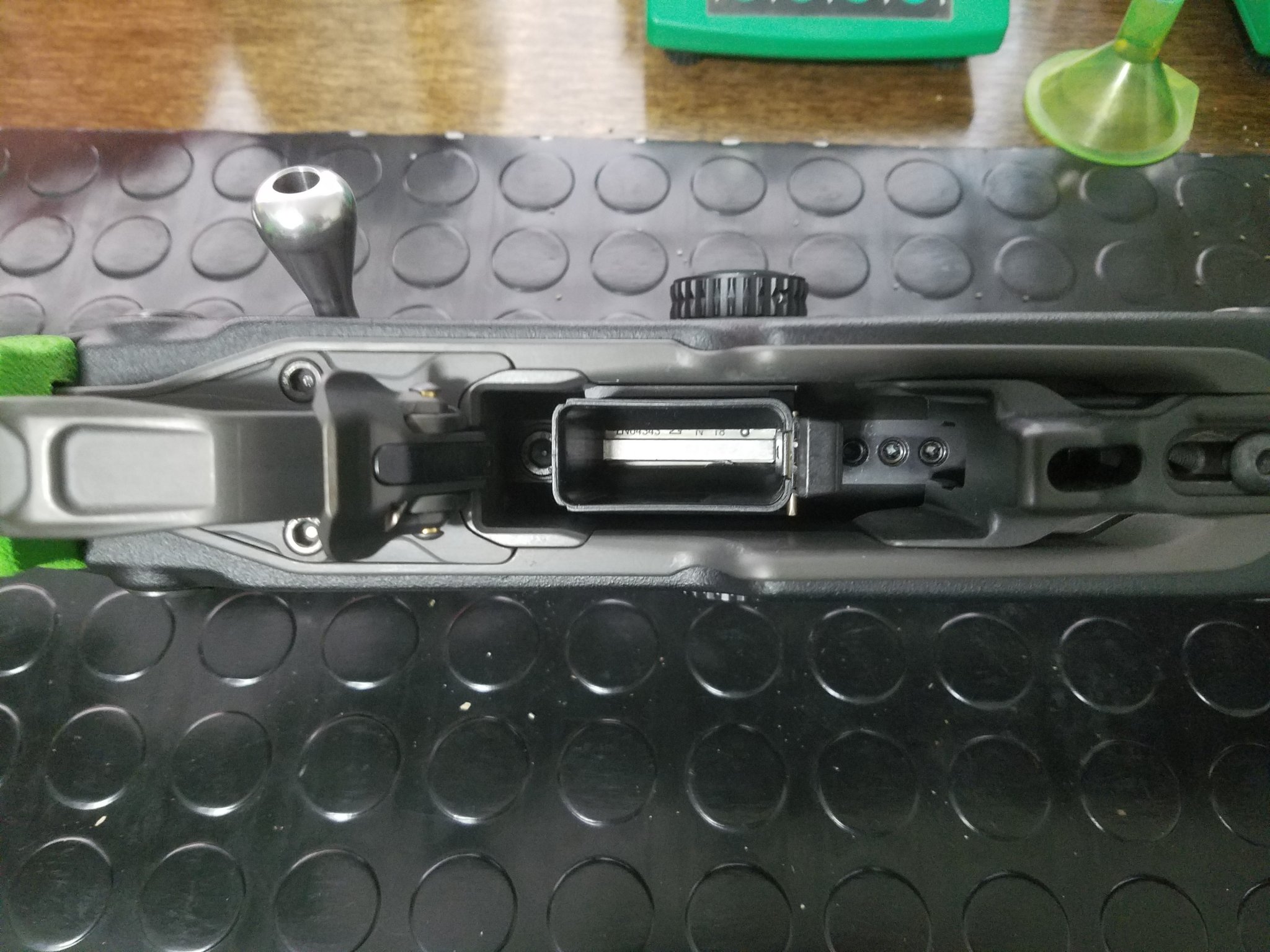

Yes it will. I just pushed the front collet as far forward as it would go so it wouldn't be a problem. The T1X mag and release can be accessed with no problems at all. However, the pin that holds the bolt stop/release is unsupported in the chassis because it sits further forward in the T1X action so the set screw that supports the T3X action doesn't help. I had to loctite the pin in so we will see how many cycles it will handle before it comes out again.
Any chance you could take a pic with the mag in from the bottom so we can see how much room there is?
