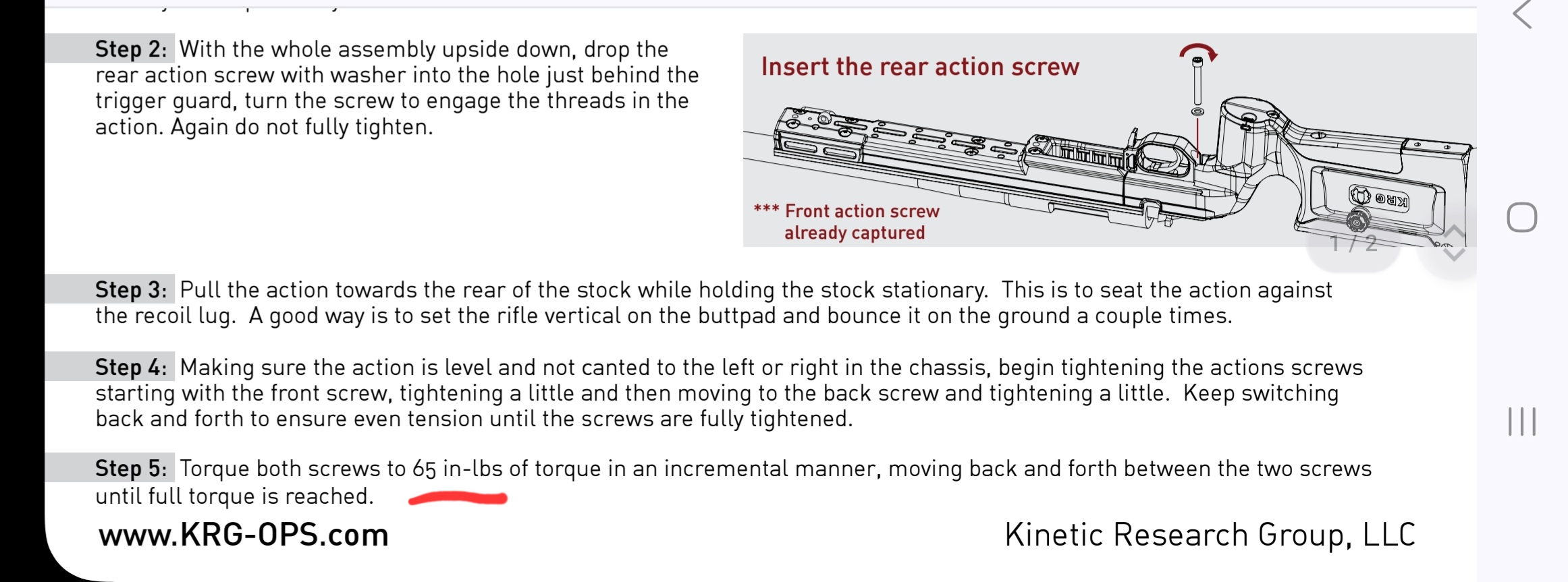

I want to say Beretta told me 65 inch pounds as well but I can’t find any email from them. But I have the email from KRG. I know CZ recommends less but tikka t1 and T3 call for similar. Tikka does have something in their manual about lower torque for some plastic part.I had my T1x ACE torqued at 35inlb and felt I was constantly get a slight horizontal zero shift.
Have gone up to 55inlb recently and it seems to be better amd the groups have tightens up a bit. Should probably try going to 65 and see what happens to group sizes.
I appreciate the info. I did read the Bravo installation instructions but was a little shy about torquing rimfire action screws that much.I want to say Beretta told me 65 inch pounds as well but I can’t find any email from them. But I have the email from KRG. I know CZ recommends less but tikka t1 and T3 call for similar. Tikka does have something in their manual about lower torque for some plastic part.
I was too but like a buddy pointed out it’s a metal receiver. I technically only did 55-60 inch pounds at one time because that’s all my wheeler wrench would doI appreciate the info. I did read the Bravo installation instructions but was a little shy about torquing rimfire action screws that much.

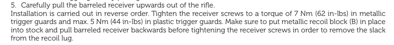

Read the blessed manual.
I wouldn’t exceed
62 in/lbs
I am sure it will be 100% as accurate as 65lbin but that probably has more to do with the stock than the action. 3lbin is within the tolerance of most torque wrenches.I believe the 62 in-lbs is from the T1X manual and not the KRG manual.
