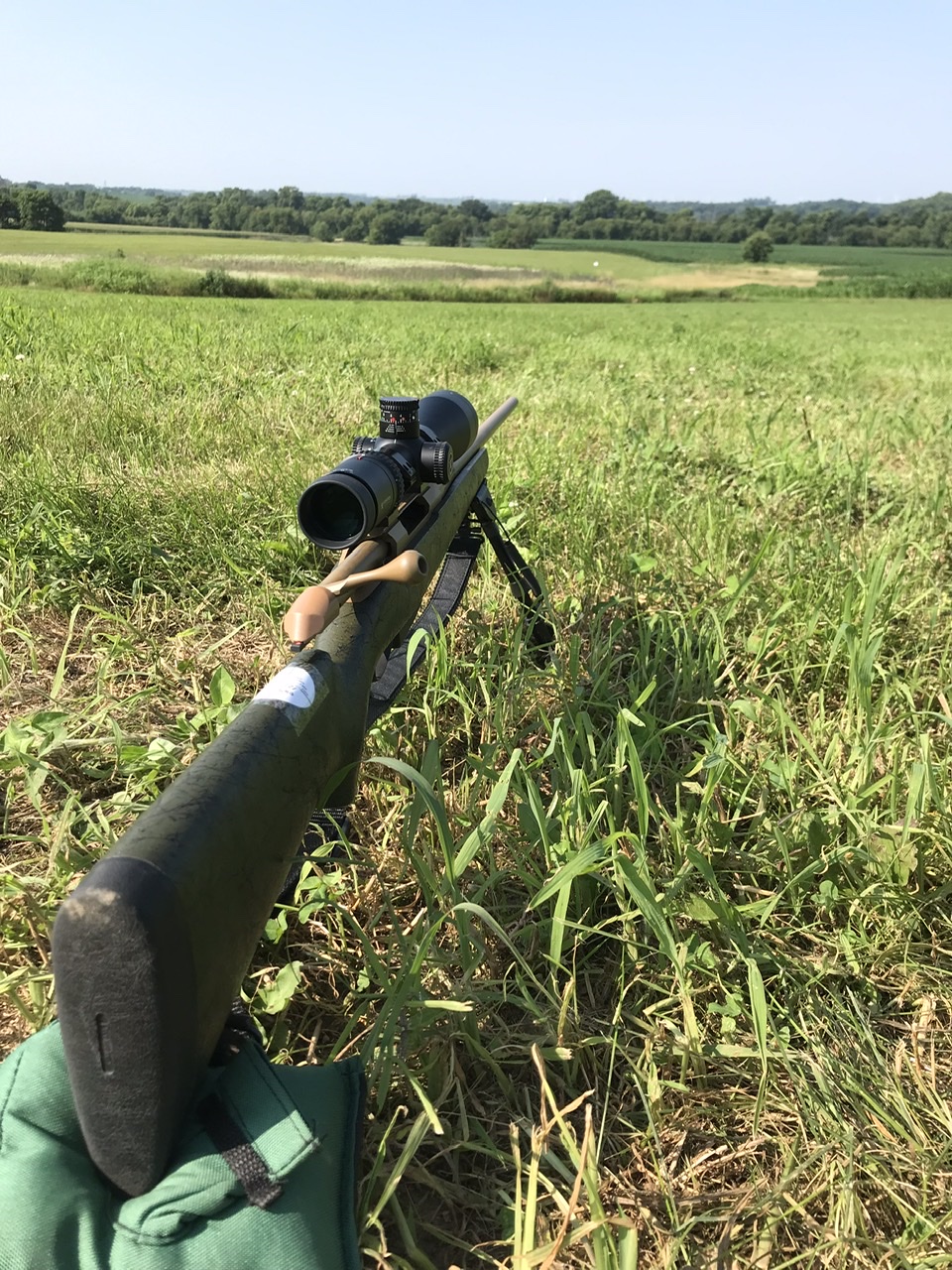

Finally got the McMillan installed on my hunting rifle. Loving the balance and the Thunderbeast suppressor (when it comes) will finish it out nicely. It has been a multi year project to get it here. Started off as a stainless CTR in 6.5 CM but since then I had the barrel cut to 19 inches and fluted. Had it Cerakoted, added a Area 419 20 moa rail, aftermarket bottom metal to accept the factory mags. Finally I added the Carbon McMillian stock, Nightforce scope, Seekins low rings and Sterk handle. I think I'm done now but who knows :)
Wow that looks great! I would like to do the same for a T3x stainless in 3006. Dumb question maybe, but why a 20 moa rail on a hunting rifle? What will your maximum ranges be? Is that to get the scope higher to match the stock? Are there any disadvantages to using the dovetail mount? What bottom metal did you go with?

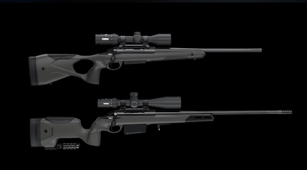

Looks like a Sako hunting rifle with integral picatinny rail and Blaser style thumbhole stock
Oh. It is a chassis. With a bit of adjustability.
and a different version with a more target/precision style chassis/stock
Regarding the 20 moa rail: I have 20 moa because that's what all of the cool kids have.... In all seriousness, no, it isn't needed for hunting (my kind of hunting anyway) but my brother has a range set up that we can shoot 1200 yards on steel so it's nice for that, especially with the velocity that the shorter barrel is producing. A zero moa rail would be just about perfect for cheek weld with the Seekins Low rings that I have but I also really like the Area 419 rails and they are 20 moa. The 20 moa with low rings does gives a nice cheek weld. Not perfect, but acceptable for hunting purposes. I just don't know if that setup would work with a 50mm scope....it would be really close.
Dovetail mounts: I haven't used them so I can't say for sure. I used the Sako dovetail mounts (on a Sako) once and hated them. I'm sure they function as they should but I just thought that they were engineered to fix a problem that doesn't exist. They are dang expensive too. My main concern with the Tikka dovetail rings is that if you want to take advantage of the recoil pin (which is nice) that the better rings have, it means mounting one of the rings in a specific spot (to match the hole on the rifle). Depending on the scope you have, this could mean mounting the scope to position the tube on the ring NOT for the best eye relief. IMHO, it's just hard to beat the good ol' tried and true Picatinny Rail base and ring system. So many more options for perfect alignment and ring options as well as being battle proved to be very rugged.
I went with the UK Gunworks bottom metal. I had never heard of it but a member here gave me a good deal on it and I really like it. It is made of 7075 aluminum alloy- most domestic bottom metals are 6000 series which is softer. Wish I could find another used one for my other Tikka as they are about $275 new.
