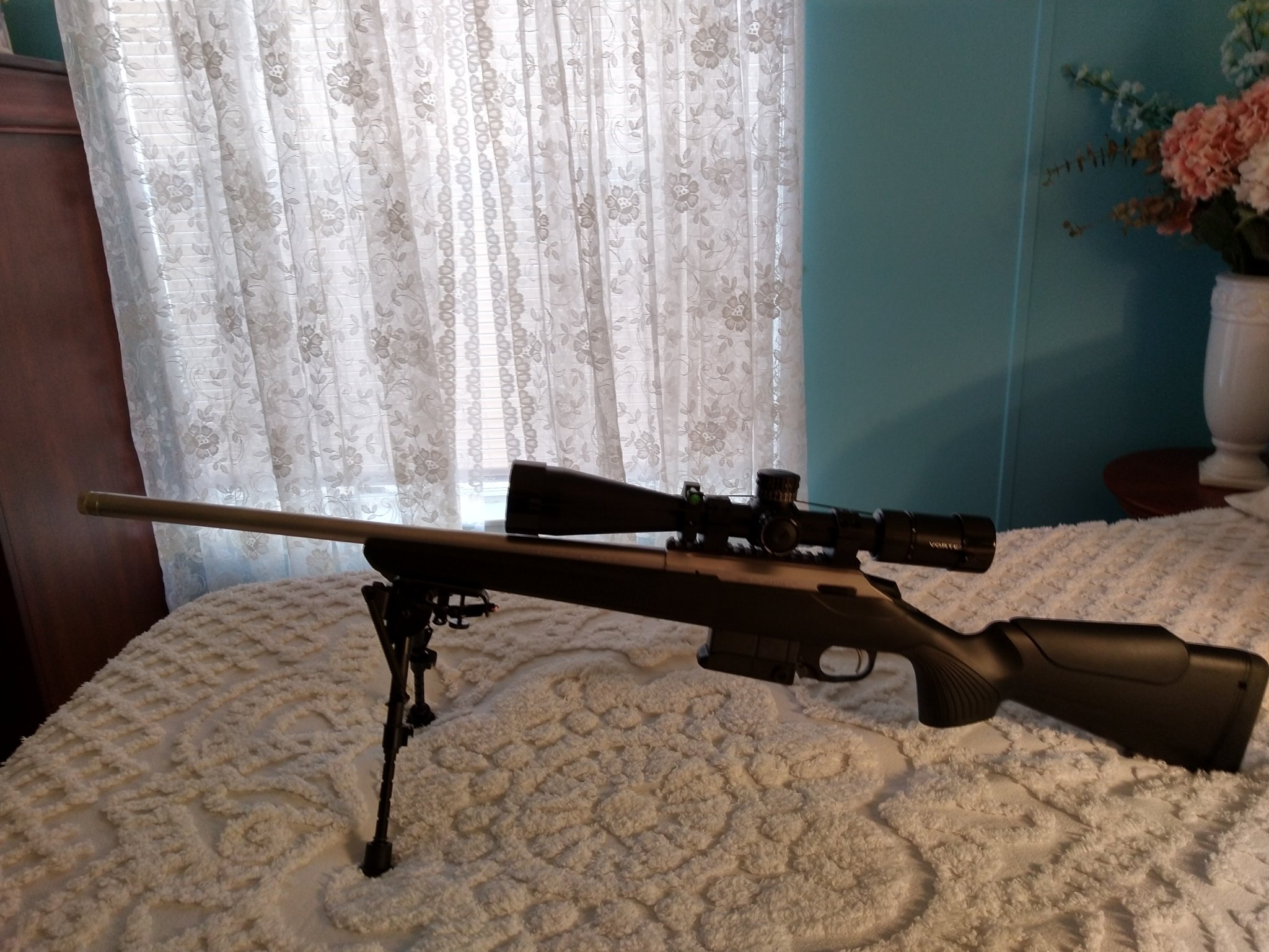

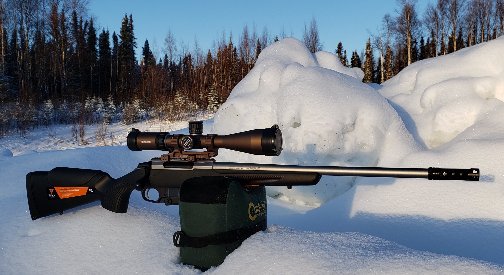

Finally got my CTR 6.5 Creedmoor with 20"barrel set up for now. Good enough to take to the range for the first time tomorrow hopefully .
Finally got my CTR 6.5 Creedmoor with 20"barrel set up for now. Good enough to take to the range for the first time tomorrow hopefully .View attachment 7256536
I've got a 20" 6.5 CM CTR and it shoots incredibly well. I broke it in with a box of american whitetail (which it shot really well), and then shot for zero with some FGMM 130 Bergers, which it shot INCREDIBLY well. Five shot groups under a 1/2". It really likes those 130's. Haven't shot anything heavier yet since those did so well, but I guess I should probably try some 143's and 147's.
it’s really hard to beat the CTR. It feels like cheating. Factory Gun and Factory Ammo shooting consistently .3-.5 MOA. Mine prefers the 140 eldm. But it still shoots .6-.75 with 140 american gunner. Here was yesterday’s best group for eldm. 3 shots @ 100

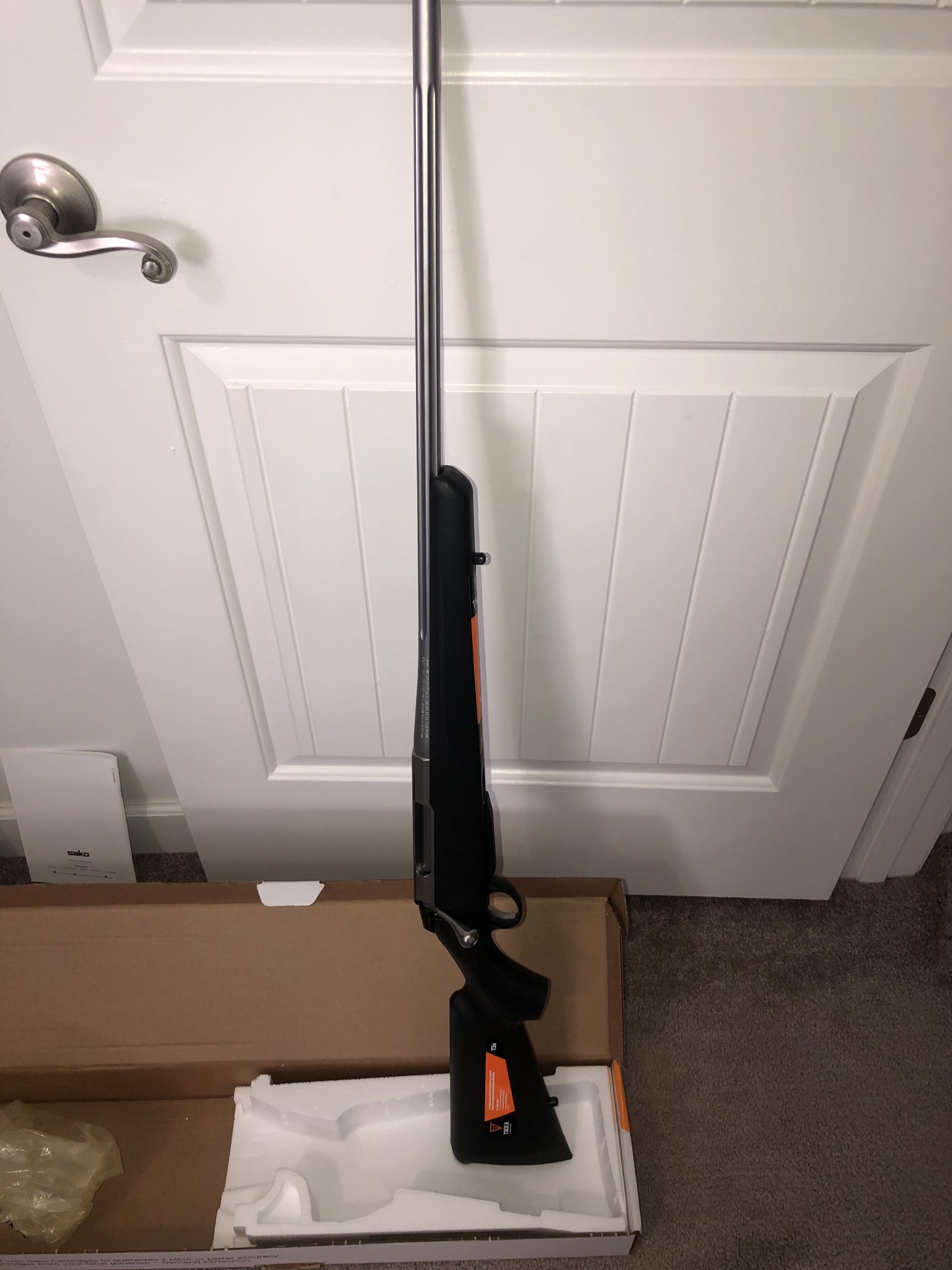

So my CTR got a big brother for hunting purposes today.
superlite in 7mm mag

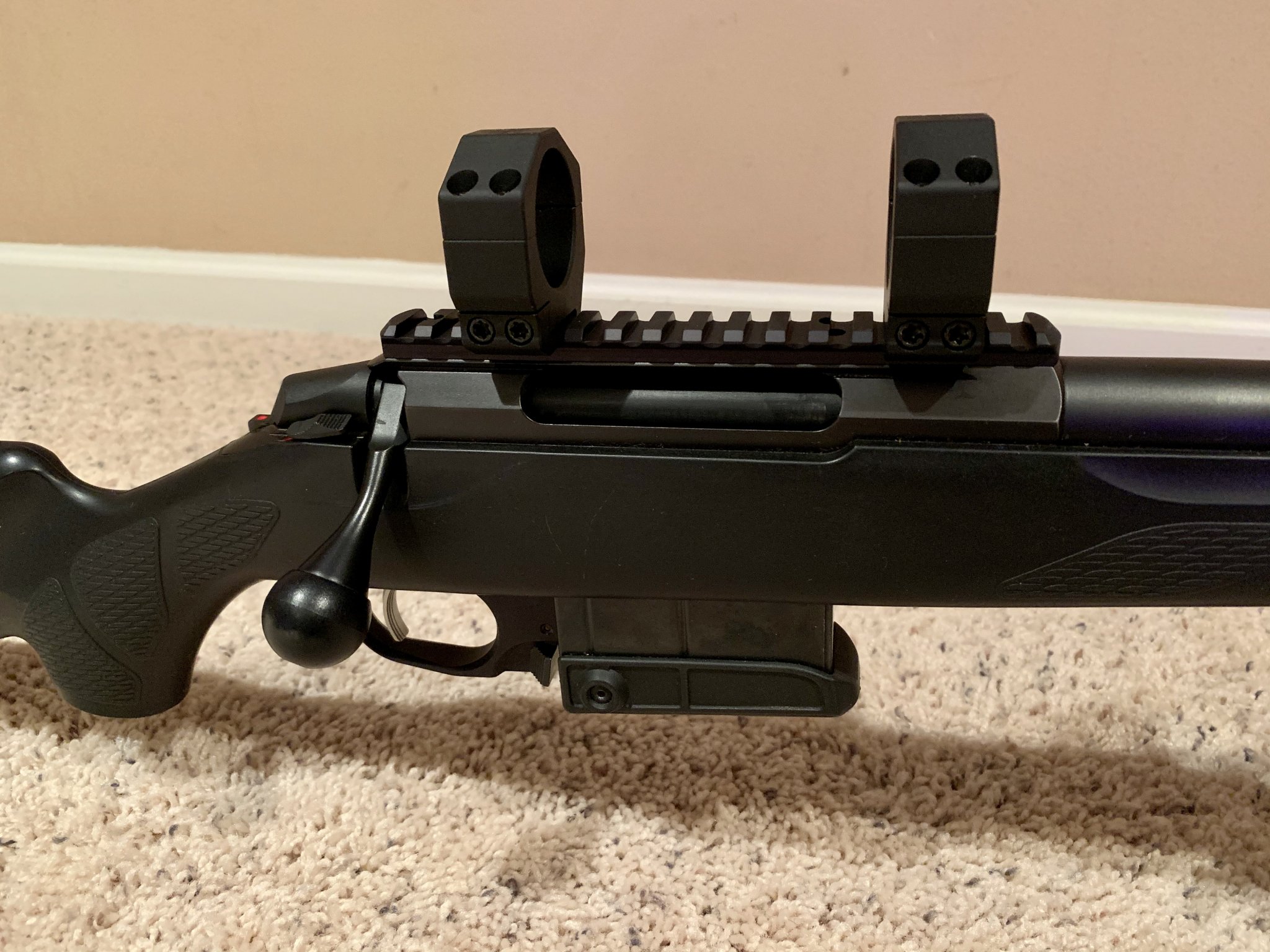

Looking for recommendations for a solid ring/scope combo. Want to be able to dial out to distance and am thinking of an SWFA 3-9x42 hd in some zee rings.
I am open to suggestions but would like to keep gun relatively light weight and in ffp for the scope.
I'm a big fan of Area 419 rails. Have them on all of my Tikkas now. I really like TPS rings but have Seekins on one of my rifles as they are a smidge lower than the TPS .
i ended up buying the SWFA 3-9HD for the gun. I’m thinking i may go Warne rings which integrate directly into the dovetail mount on the tikka with no extra rail. They come with a recoil lug on the bottom. If i do decide to do a rail, i’ll probably do area 419 or mountain tactical 20 moa and then a set of burris xtr sigs where you can add moa as well. But for hunting 300-600 and in, i should have plenty of adjustment in the dials/reticle.

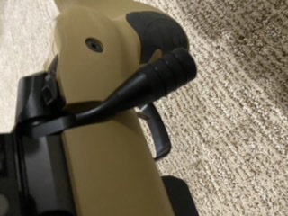

Ran into a problem yesterday ,need some ideas on what it could be, my t3x is chambered in 6dasher in a mpa chassis. I was trying out some of my buddies copper creek ammo loaded in alpha brass I was mainly check to see how smooth it was chambering in my rifle so I was running the bolt pretty slow , chambered the first round and fired it ,worked the bolt slow and ejected the brass , chambered the next round slow and the firing pin was not cocked i ejected that live round and chambered the 3rd when i closed the bolt the round fired ( luckily I dont close the bolt till I'm on target, and I actually hit the target). After that I worked the bolt slowly with no ammo and every time I closed the bolt the firing pin fired I did that probably 5 or 6 times and it fired every time then I ran the bolt hard and it wouldn't do it . After I ran it hard one time it was fine even if i went back to cycling the bolt slow. I do have a aftermarket trigger spring in it( cant remember which brand) and it's set pretty light and I have the firing pin bushed but I would have figured running the bolt hard would have set it off but it doesn't I tried pushing down on the safety to try to get it to malfunction but nothing happens. Has anyone ever had this happen
That´s the sping error you have there.
Tighten that tension back of the trigger pull of weight, you have it too loose.
I would even toss it and go back to factory sping, since it does that now, it is not safety.
Also check the bolt that hold the trigger, is it tight?
First check after unloading / chamber check, remove action from stock / chassis, etc. is the Allen bolt that fastens the trigger to the action. If it’s loose, tighten it &retest. If it’s tight, move on to the trigger spring and increase tension on the set screw then retest.
Is your trigger set extremely low? I found that with an aftermarket mountain tactical trigger spring it wouldn't hold it unless I had the screw really cranked down. It did it about 80% of the time until I tightened it down til the screw was almost bottomed out. Then it did great. I ended up installing a Timney trigger though and it's amazing. I can now cycle the bolt with the safety on, which in my opinion is a big improvement.

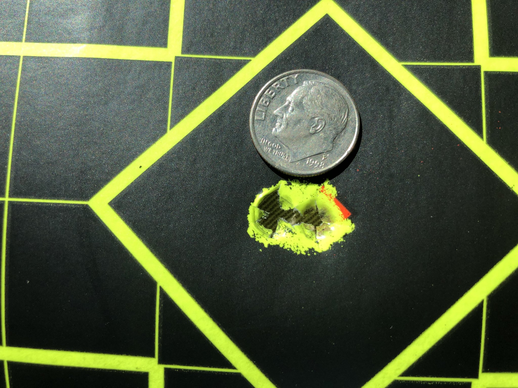

Ctr in 6.5cm

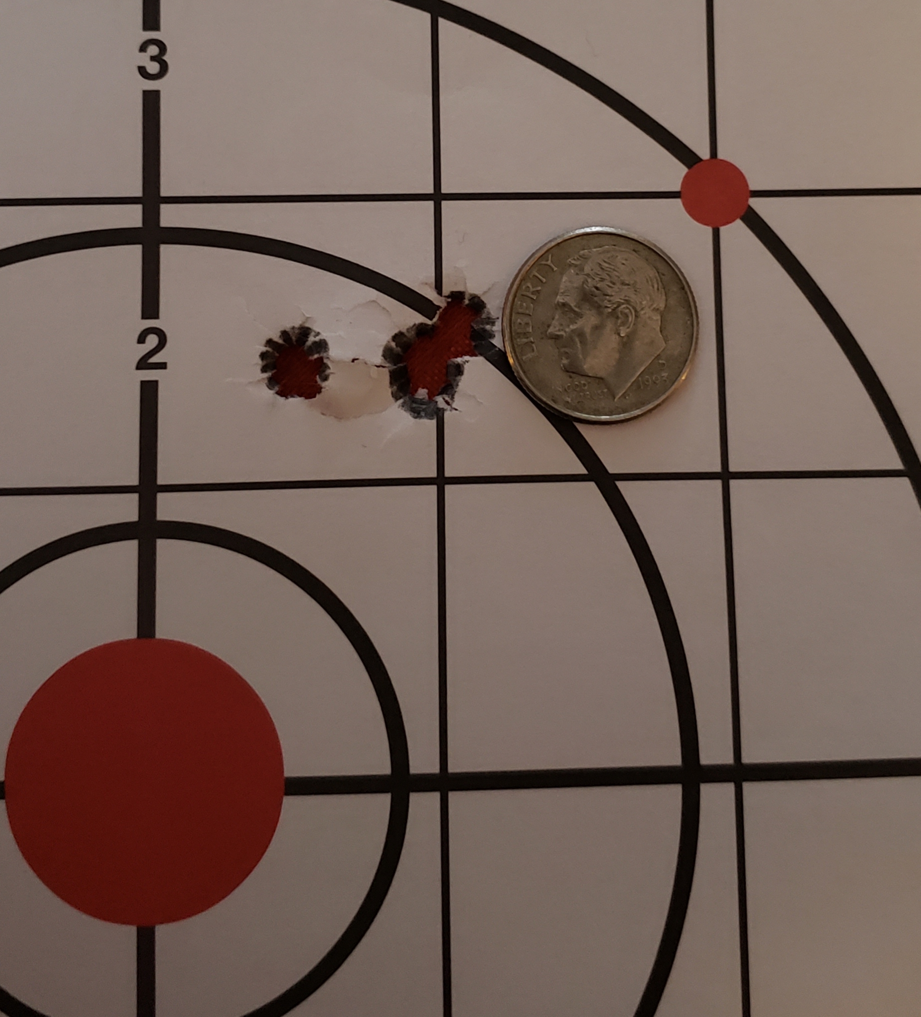

Best group with the 6.5 to date at least....
Every time I go out I always get one flyer ....
I guess I cant complain ...last time I shot rifles for groups Bush may have been president! Hahahah
Mine really likes the 140grain berger hunting rounds loaded by Hsm.....
Shoots barnes precision match just about as well.....
I only assume my groups will get better only around 190 rounds down the pipe!
I consistently get this same group lol
5 shots. 103 yards.
Normally cold as f outside hahaha(Alaska)

I need to try those 140's. Both my 6.5's are very partial to Berger rounds. 130's and 135's do very well. I've been pretty impressed with other HSM ammo I've shot.
You can cycle the bolt with the safety on with the factory trigger. Just take the trigger off and file or grind the top of the bolt lock pin off. Just have to take it down a smidge lower than the lip on it. Just make sure that the shavings don't get into your trigger. To prevent this, I poke a small hole in a ziplock bag and seal the trigger in that with only the pin sticking out of the hole. I then wrap it all in masking tape for good measure. Of course this voids the warrantee so don't do it without careful consideration and at your own risk.
Yea it's set as light as it will go and still function, I wish I could get a aftermarket trigger but no one makes a left one other than bix'n andy
Too light trigger I think! After adjusting trigger you should always cycle the bolt and drop the rear of the cocked rifle to the floor few times and see that rifle does not fire.
Reactions: PR3AK

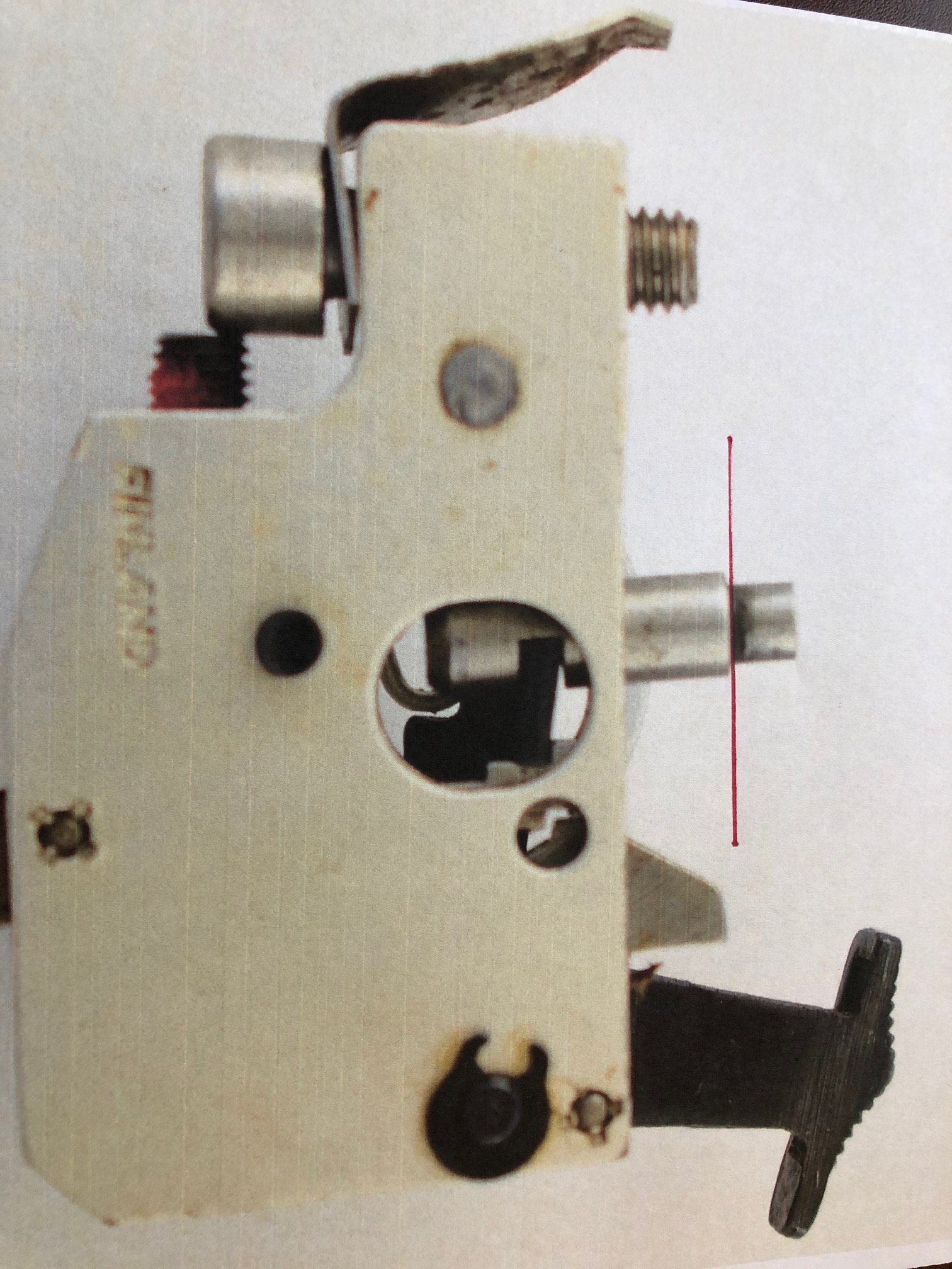

Picture?

I'm not going to take my rifle apart to get pictures but attached is a stock photo with a red line showing the area that I removed. There is a step in the pin at this position and I have always needed to go .010-.020 below that step to keep the bolt from dragging on the pin when the safety was 'on'. I have always clamped the narrow part in a vice and cut with a hack saw at the step. From there I file or grind it down a bit more. As stated earlier, make sure the trigger is wrapped so no metal gets into the trigger. Again, this will void the warranty and do it at your own risk.
Can't you just remove the pin. I have only removed pin and safety lever when fitting the 3 position safety from ASH. It should work without the pin but safety catch put back.
edi
edi
I suspect that you are correct. I looked at it the the last time that I shortened a pin and I concluded that would likely work. I just didn't want to dive into the trigger and loose a pin or spring and be screwed.

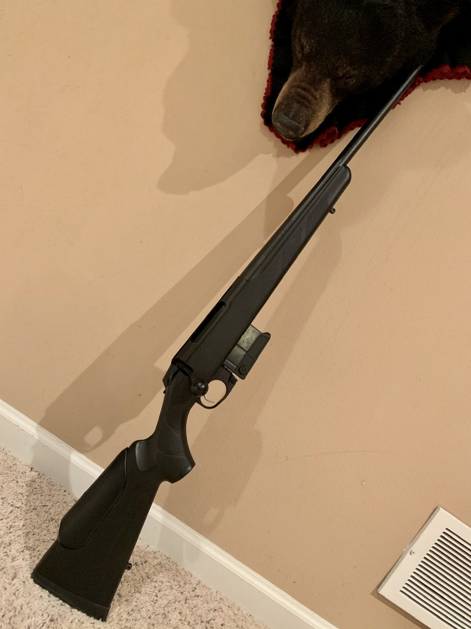

Start of a new project: bought a used but supposedly unfired CTR 260 for a good price.
This is going to be something I can practice with to stay sharp for hunting and maybe dip my toes into PRS competition this summer.(fingers crossed)
Rail, rings, break, and chassis in route. All in this should stay a fairly value mined build.
