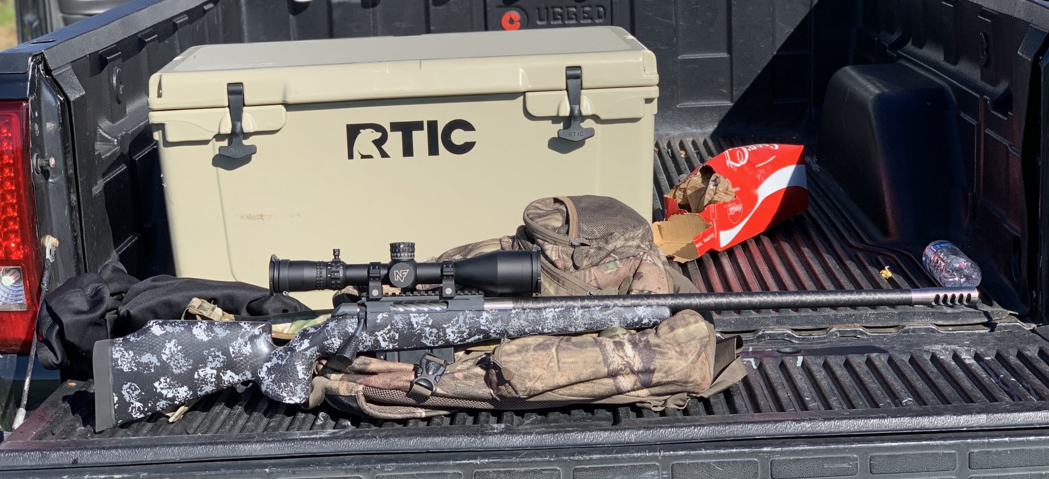

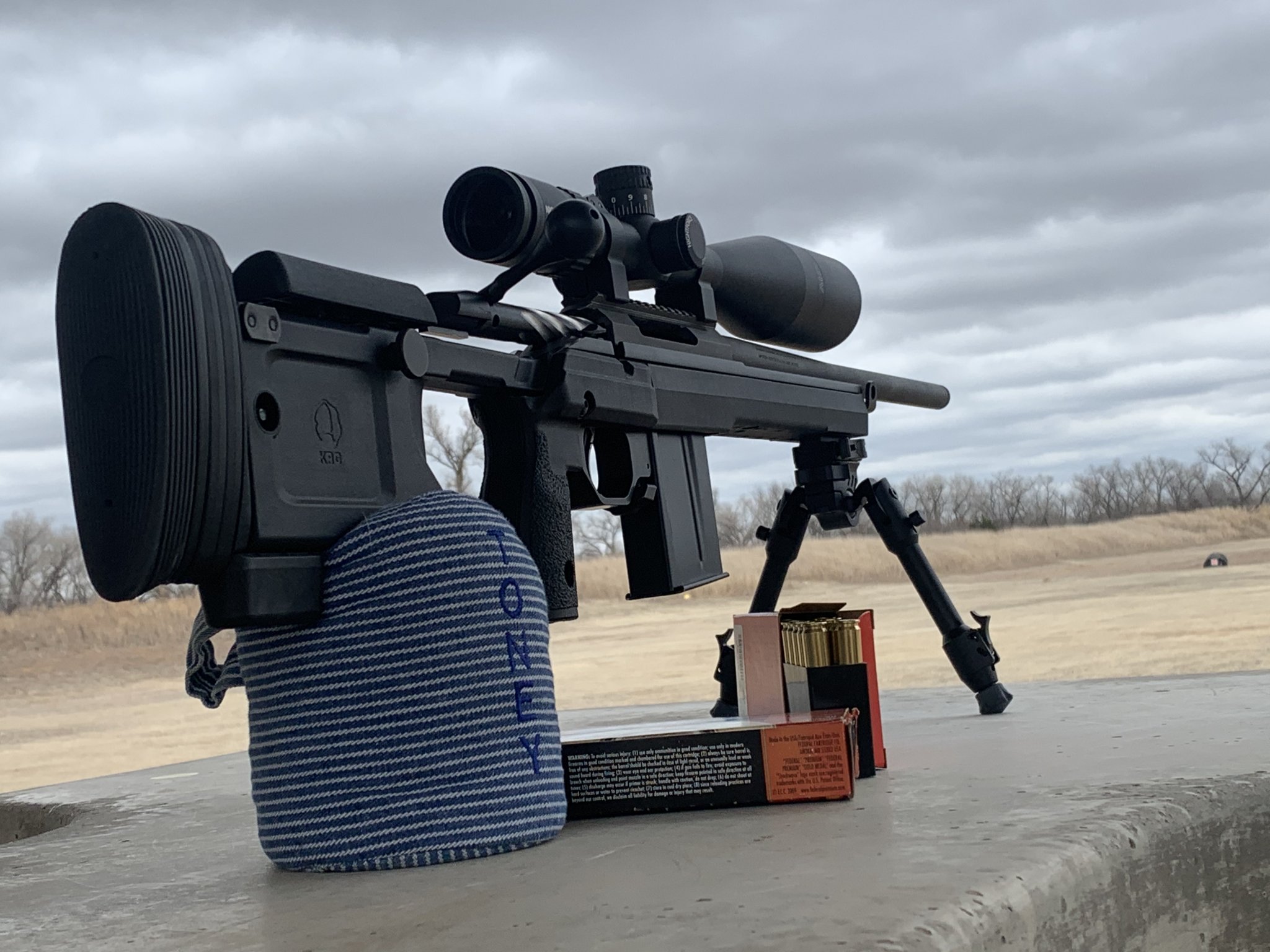

Tikka Action Carbon six carbon barrel chambered in 300win mag 5port beast brake Mcmillian game hunter edge Timney two stage trigger and nightforce NX8 4-30x50mm scope my favorite hunting rig.
Does it shoot any better than the original barrel
I'll try to keep you posted, just got it 2 days ago; but so far so good.

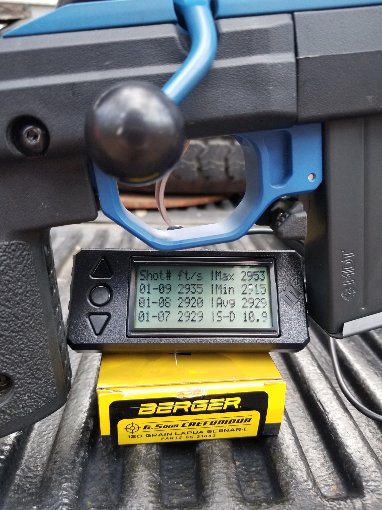

Was gonna run 130Bergers in it, but tried 120Scenar-Ls and kinda like how they shoot, groups are all sub-.75 moa.
The original barrel was actually 2 barrels ago, in 260Rem, and it was a good barrel as well.
If i had to guess, I'd say this action has around 5k+ live rounds and probably over double that in dry-fires.

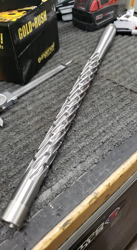

Spiral fluted barrel is not accurate.
Tikka barrels are.
If you send them in to a professional gunsmith, they will be and you get the lighter gun, but still the accuracy pin point!!!
My CTR has not lost the accuracy, so dont be affraid to do fluting in to your barrel.

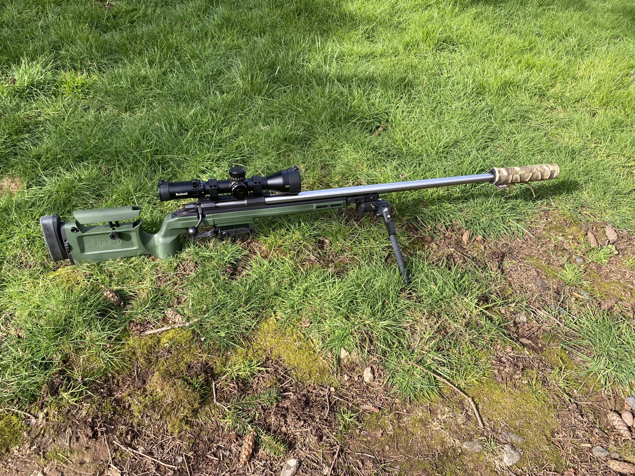

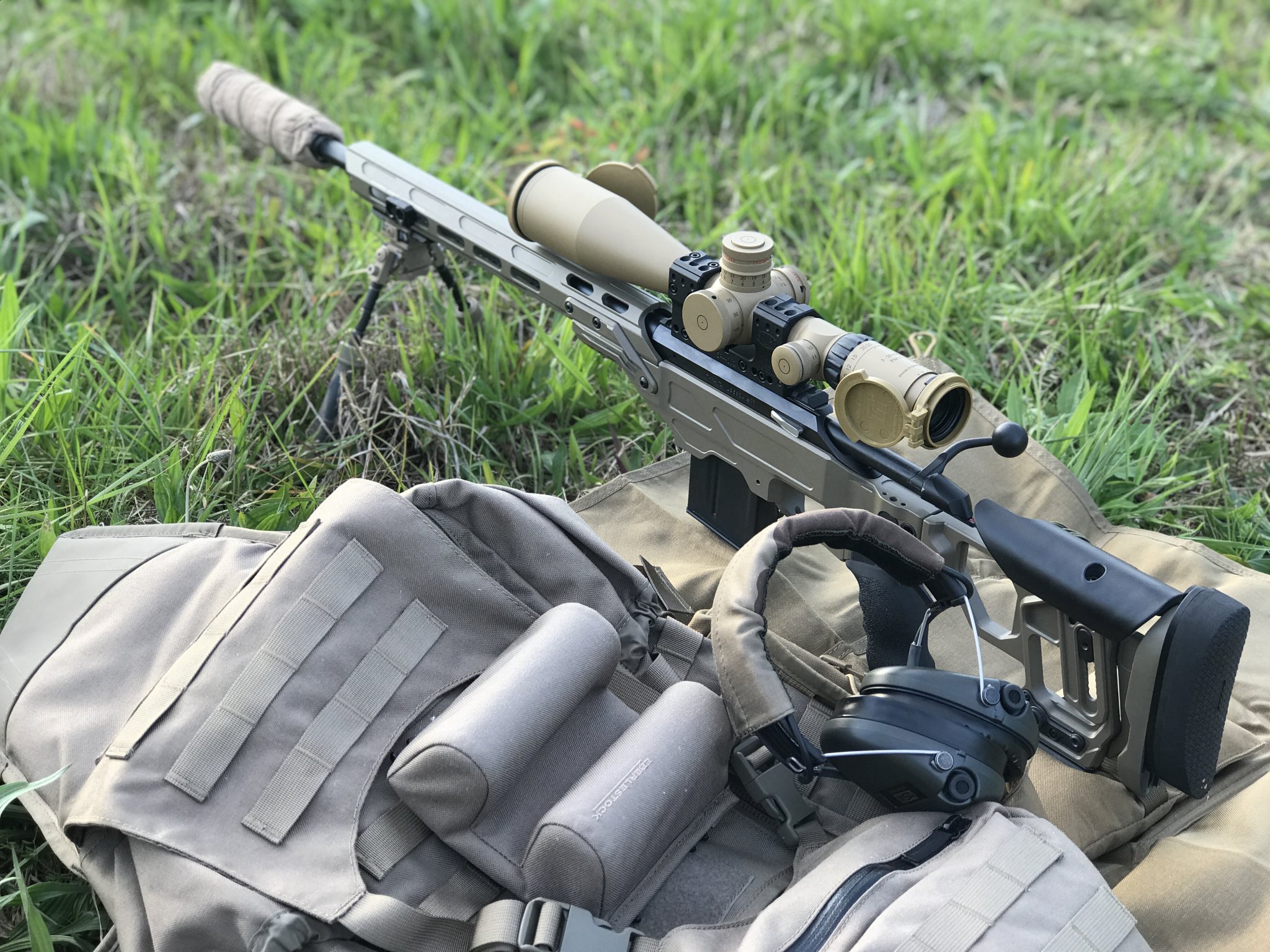

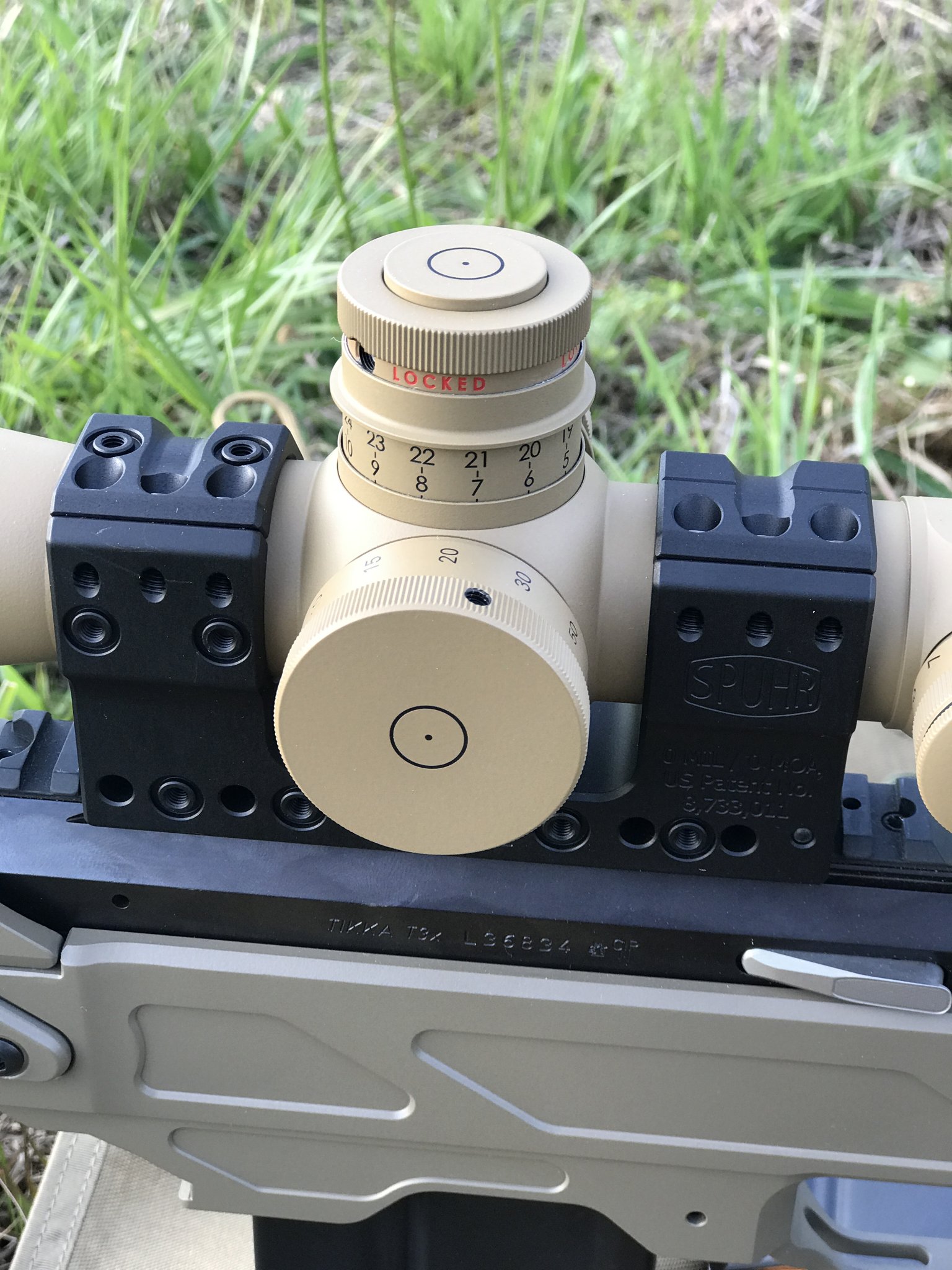

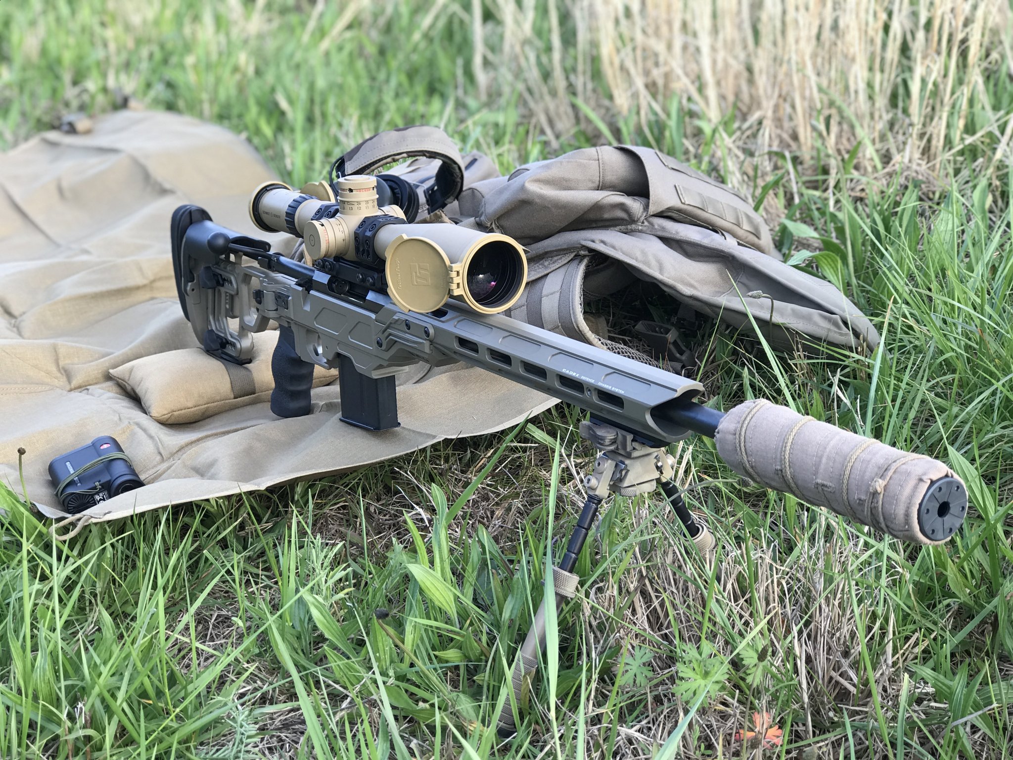

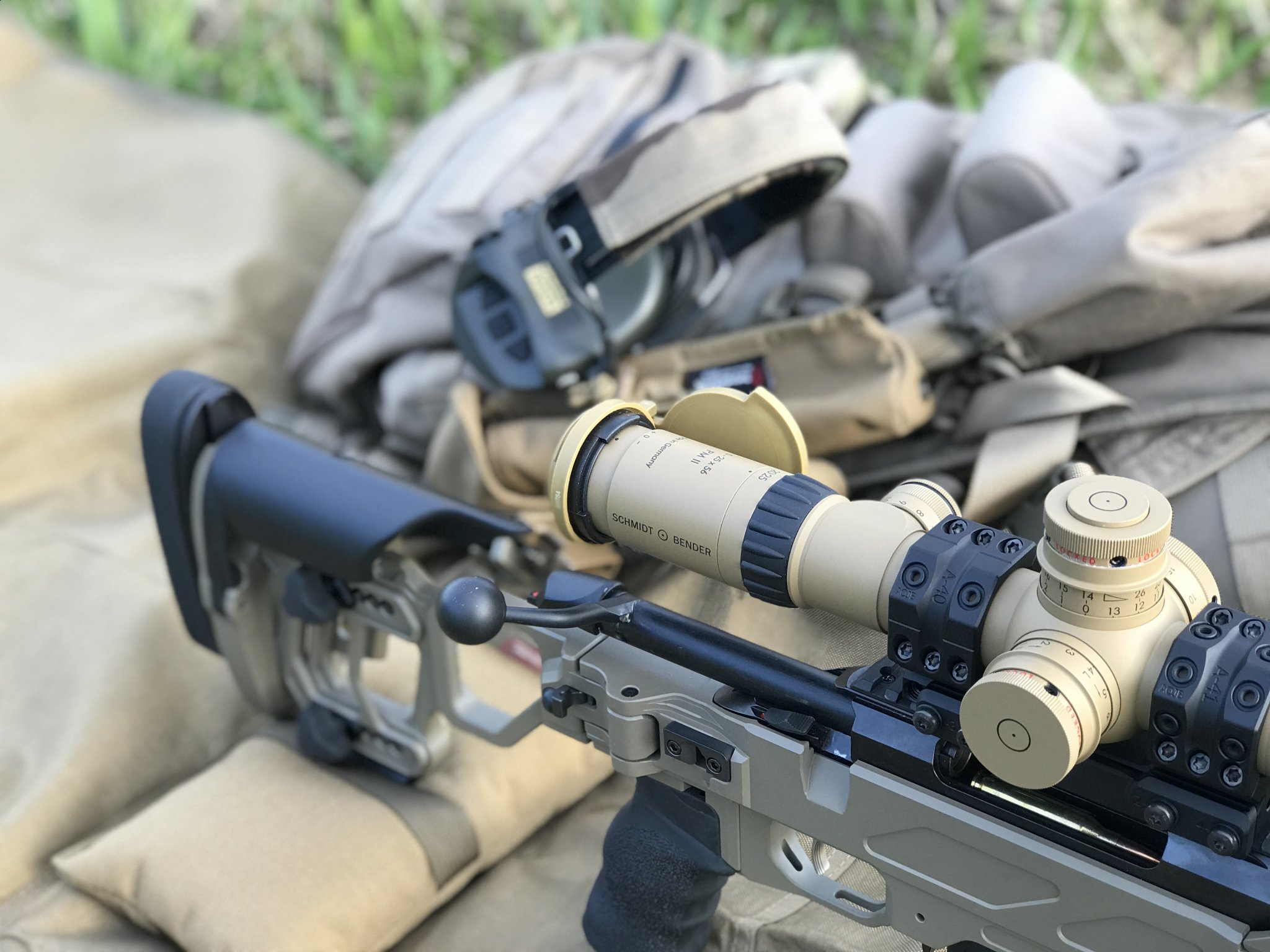

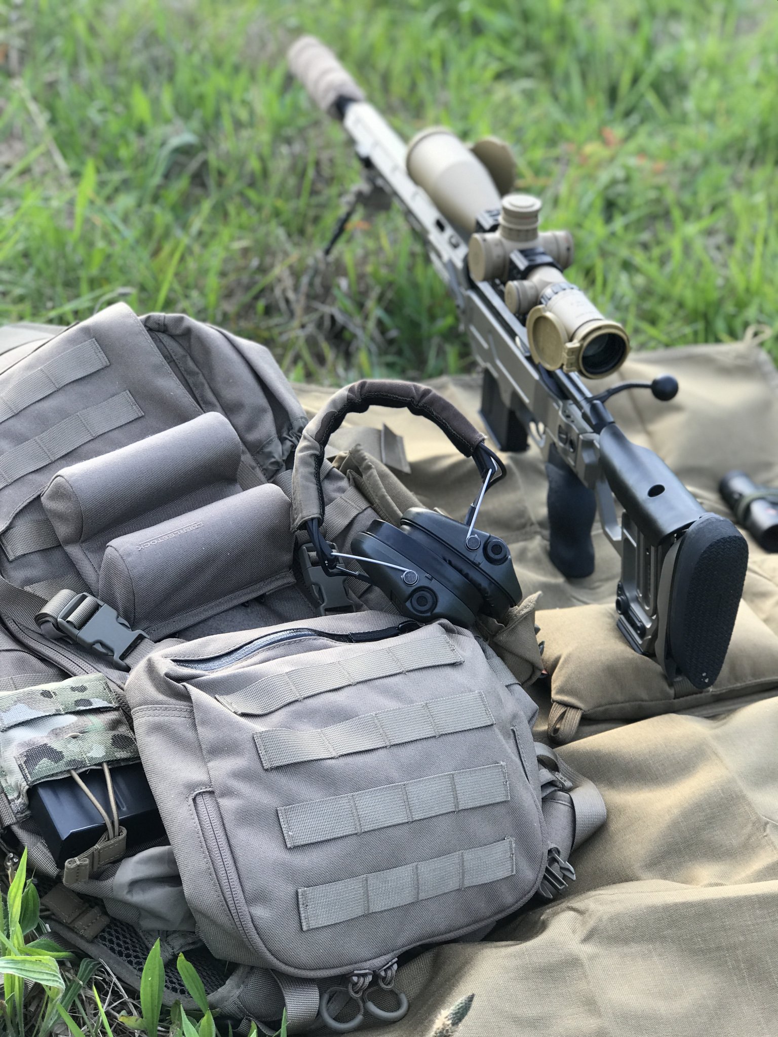

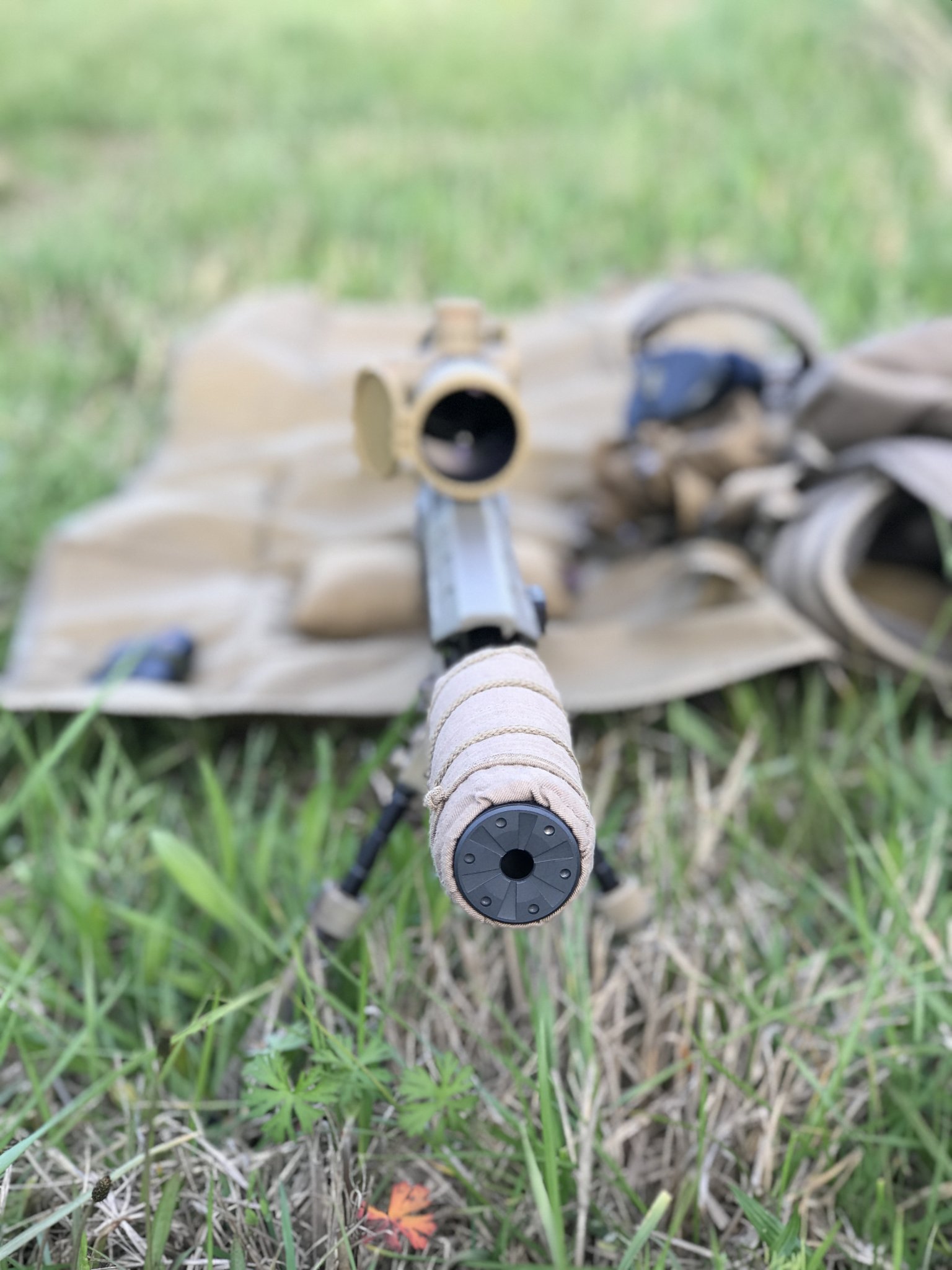

Here’s mine. It’s shooting pretty good too.
Tikka T3x in a Cadex Comp Lite chassis.
S&B PMII
Spuhr IDSM
Murphy Precision 20 MOA Titanium Base
Dead Air Brake
SilencerCo Omega w/ Dead Air Kymo
Atlas Bipod
Sterk Swept Ball bolt handle

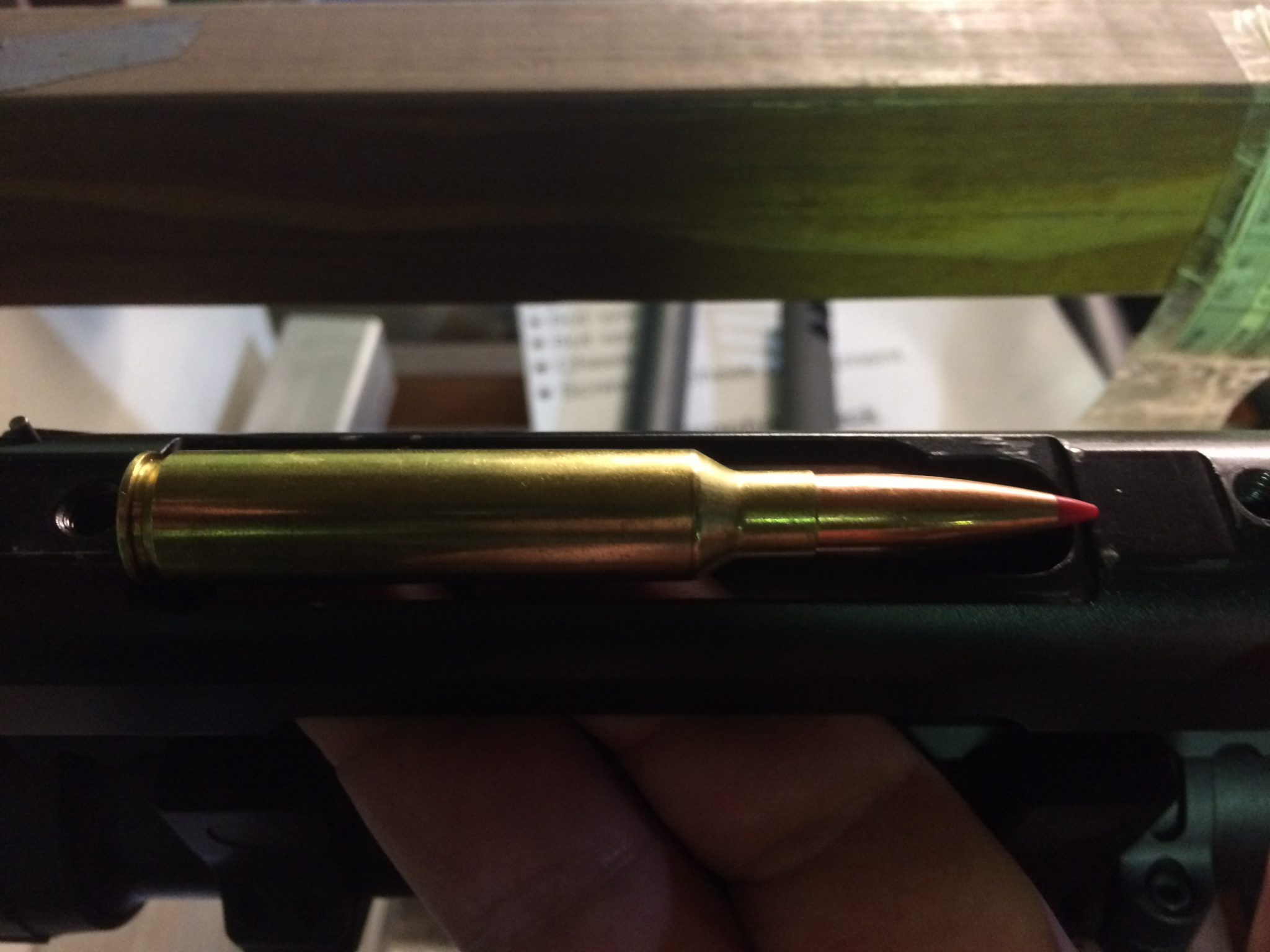

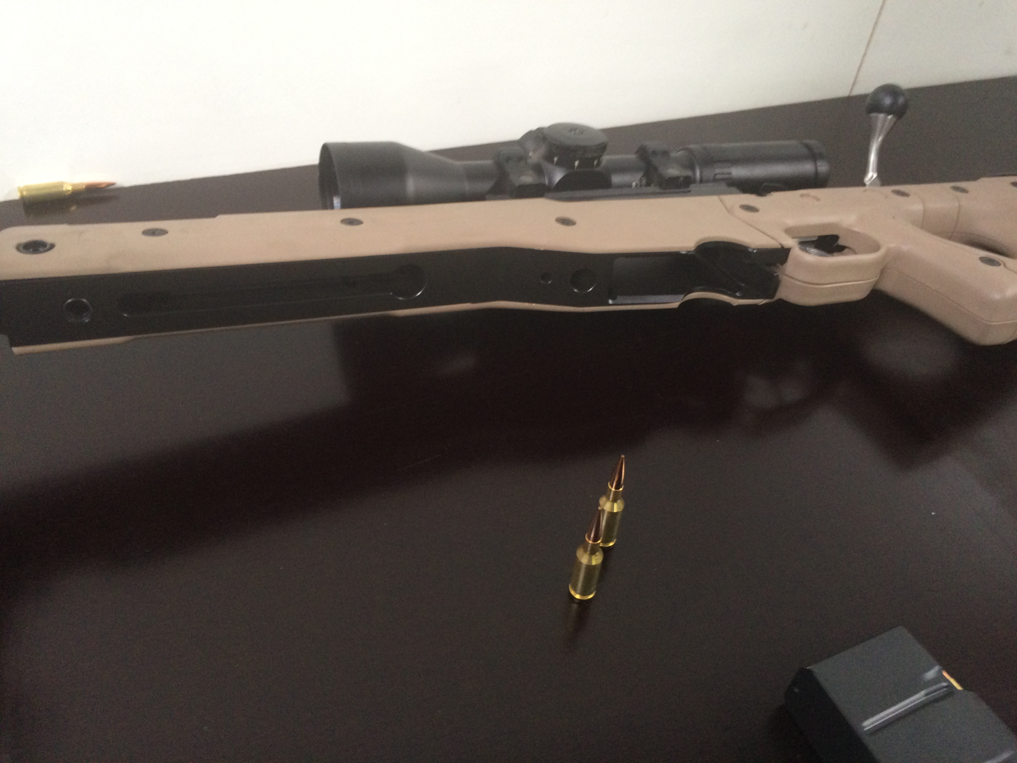

You could most likely do a little milling to fit 300 PRC in, the photo below is a factory 225 ELD-M. With a notch in the feed ramp, a bit of a trim at the rear of the port and a skim off the front of the trigger you'd get pretty close to feeding it from a CIP mag. You would most likely have to remove the bolt to extract a loaded round though. I'm just waiting for a used LH action/rifle to turn up to have a play. I don't know what's available for a DBM to run the CIP mags though, I was just going to make a chassis to suit.

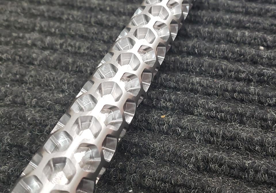

Has anyone had a 18" 223rem Tikka CTR?
I went loco and cut the barrel to 18", it as 24".
Because it is my son gun, and hi is only 11 years old, try to make it lighter.
Next step is to do straight fluting to the barrel and new 5/8x24 threading to the barrel.
It looks quite cool in 18":p.'
LOL!
I´m sure cutting off 6" from the barrel made it lighter though!
(y)
I have shot 18" AR-15 on to a 600-meters, so i dont think that barrel on bolt action is ruin, or do you
No, not at all.
As the standard barrel is not the thickest one, I guess accuracy would either get better than worse.
I´ve shot the StGw90 out to 600 meters as well, prone unsuported with iron sights.
Worked pretty well also.
