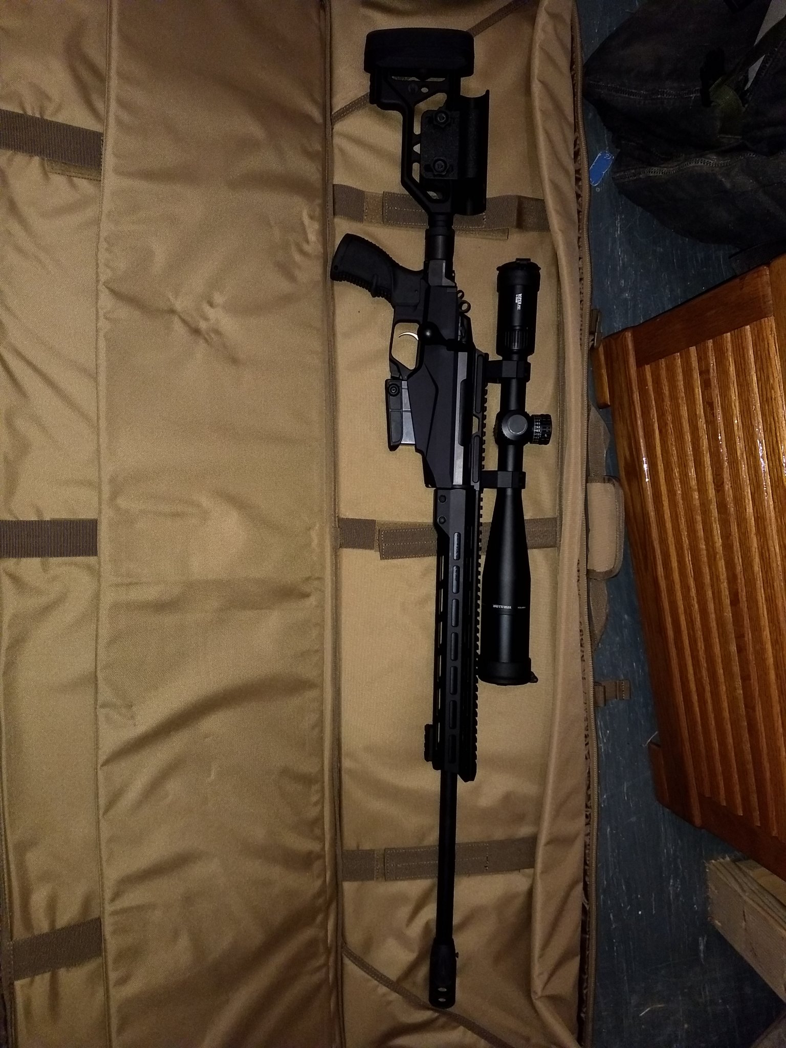

This is my new Tikka I

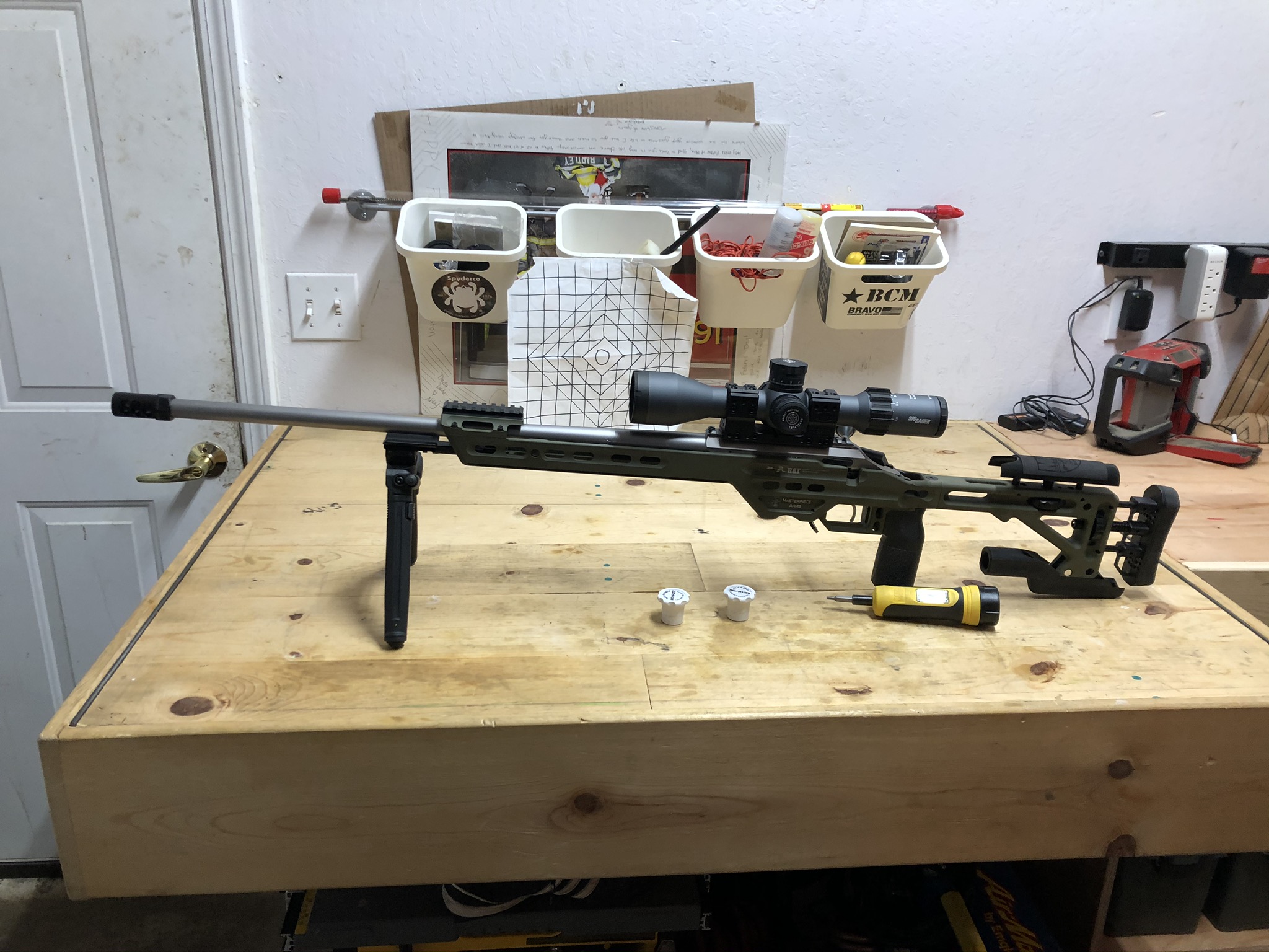

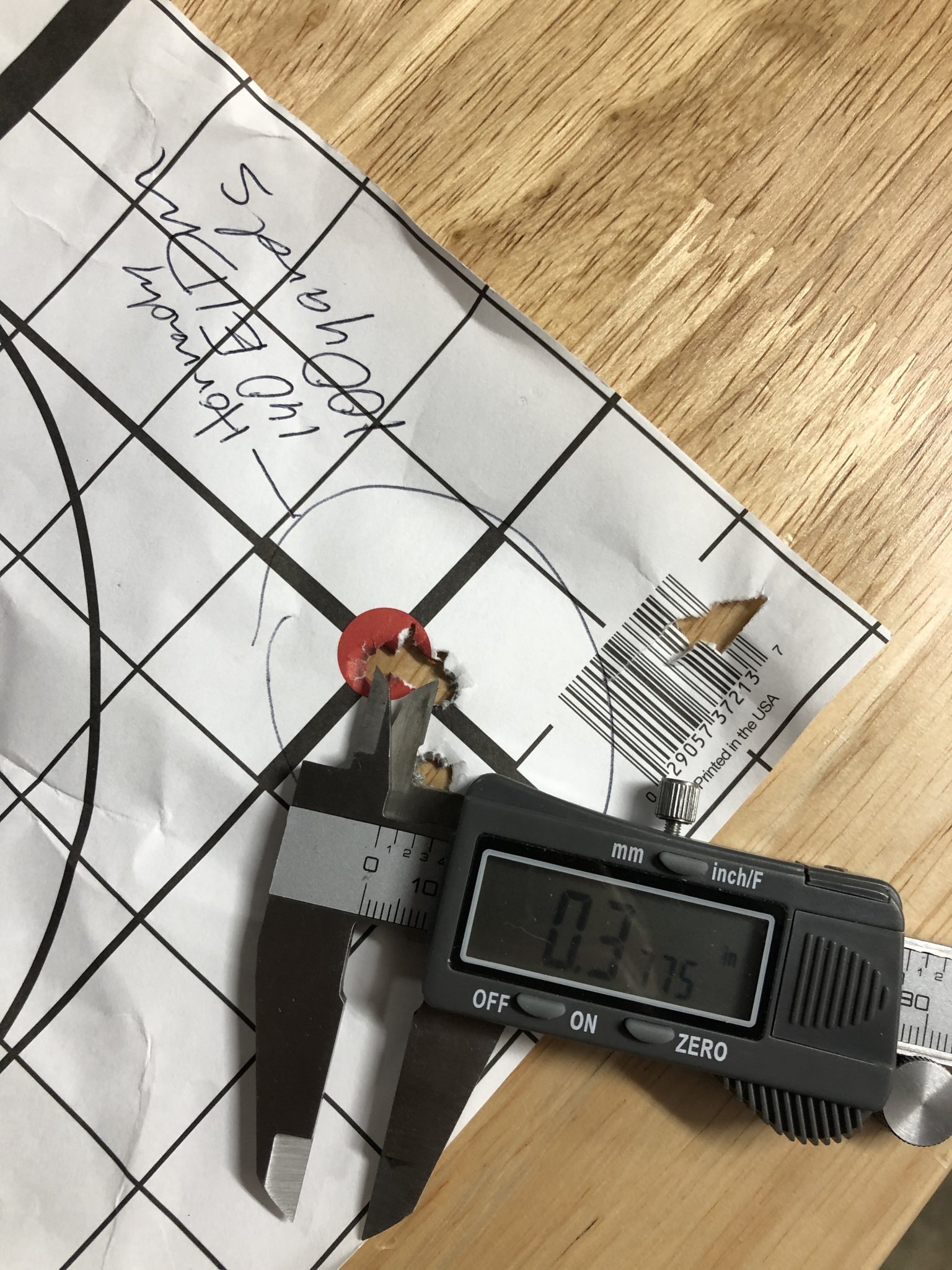

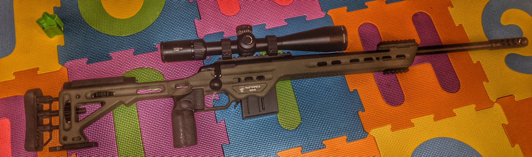

Took my new CTR in MPA chassis to the range today. Worked on zeroing. Used up some ammo I had to get close then tried some Hornady 140g ELDM which my other tikka loved and no surprise another very accurate rifle. Very happy. Reinforces my desire to build a Tikka .224 Valkyrie out of a .223.
Had the zero very close. The hole just above calipers was my zero being slightly off. Adjusted then finished the last three rounds with this result.

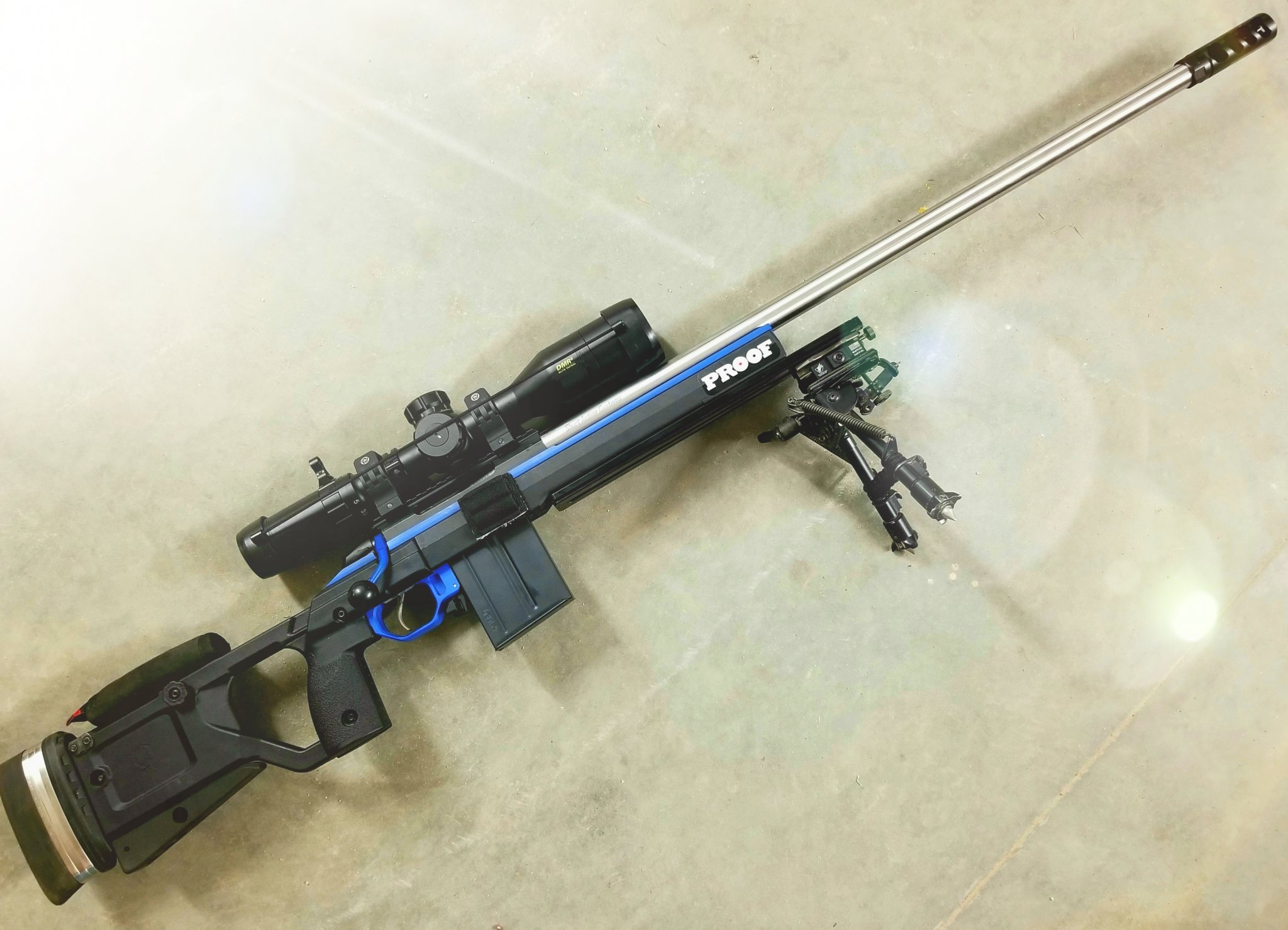

Looking to build up a Tikka 300wm I have that isnt getting shot anymore. Want to rebarrel it to 6.5 PRC in the Tikka LongISH action. I think this would be a good combo. Seems only chassis for it is the MDT ESS.
Who should I look for to get a prefit shouldered barrel? Talked to Chad at LRI and he can do it. PVA, and Stock Stocks has a Proof Carbon in 22" but thinking the carbon might get too light for a PRS style rig?

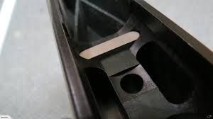

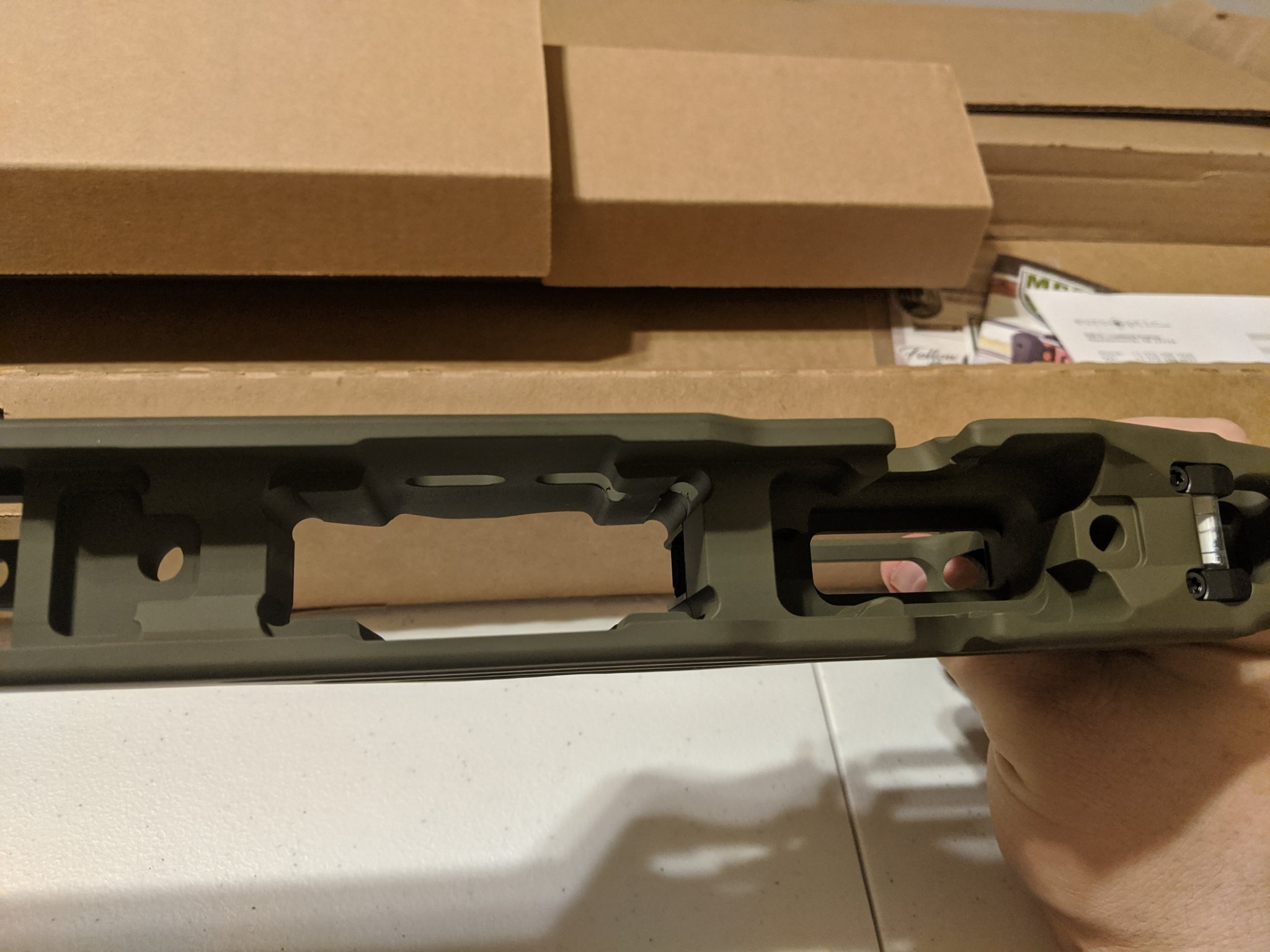

The photo above this reply isn’t of a Tikka inlet chassis. This looks like a Remington or Savage inlet with a recoil lug between the barrel shoulder and the front of the receiver.
a Tikka inlet will have a recoil lug that stays with the chassis / stock.

I called them and sent pictures. They said that was the correct one for Tikka. The recoil lug is actually the machined chassis. When I sat the chassis right next to the t3x stock everything lined up exact. Everything bolted perfect. I spoke with Al at mpa.
On the picture you showed, there is no recoil lug on the picture.
Was it a separate part in the box where the chassis came with the action screws?
Every chassis for Tikka i know, and i have 3 Tikka rifles, you can see that recoil lug.

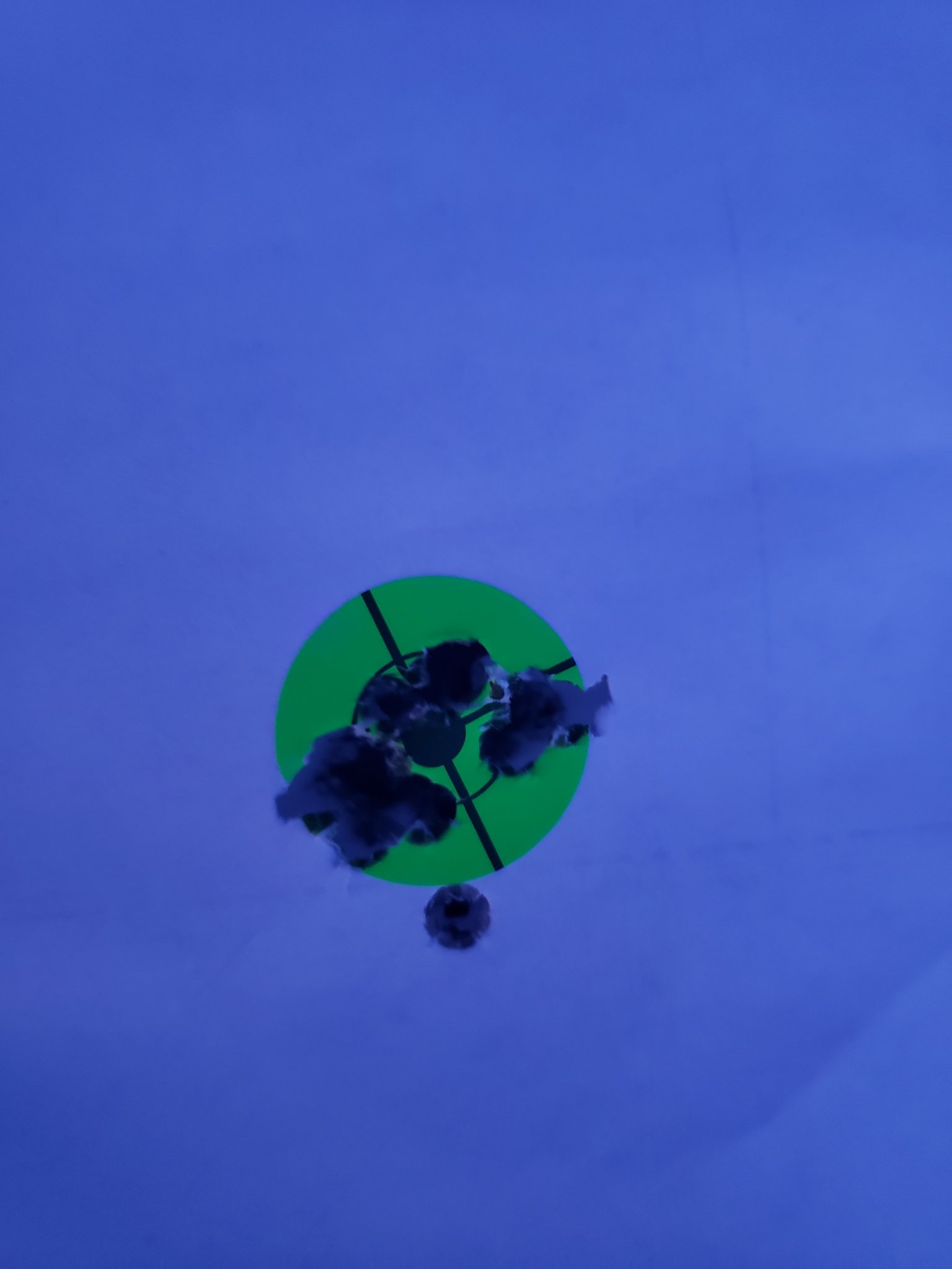

Finally started to get my new Bartlein 22BR barrel broke in. Loaded a ladder in new brass with 27, 27.2, 27.4, 27.6, and 27.8 of 4166 and then loaded 50 in 4x fired brass with 28 gr of 4166. Also had some 53gr VMax over 32gr of Varget that I loaded as an experiment for a friend.
The dots are 1", first picture is the 28gr load, shots 26-30, second is the same load shots 31-50, 3rd is 5 shots of the 53gr VMax at 3590fps.
All of the ladder with new brass shot 1 moa or larger. Will definately work above 28gr in the future.
28gr IMR4166, CCI450, new Lapua brass, .010" off the lands 2985 av, 8 sd over 15 shots.
Surprised the 53gr Vmax shot that well out of a 1-7" barrel. 1.2 mils to my 416 yard plate. Thinking about setting my barrel from last year back and cutting it down for a coyote rifle.

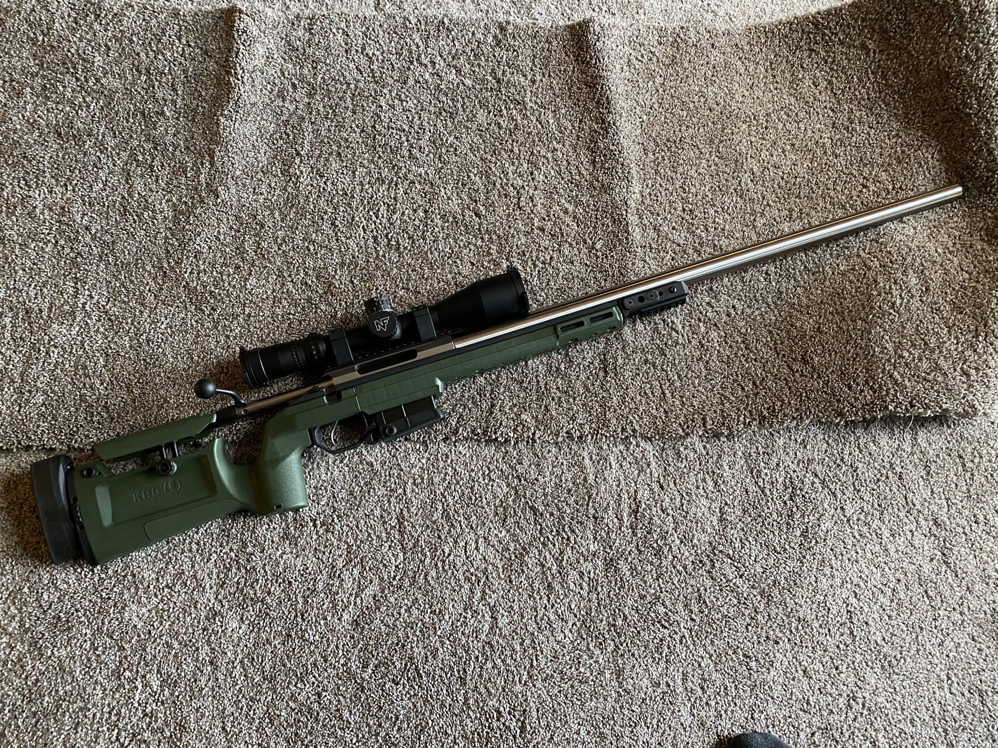

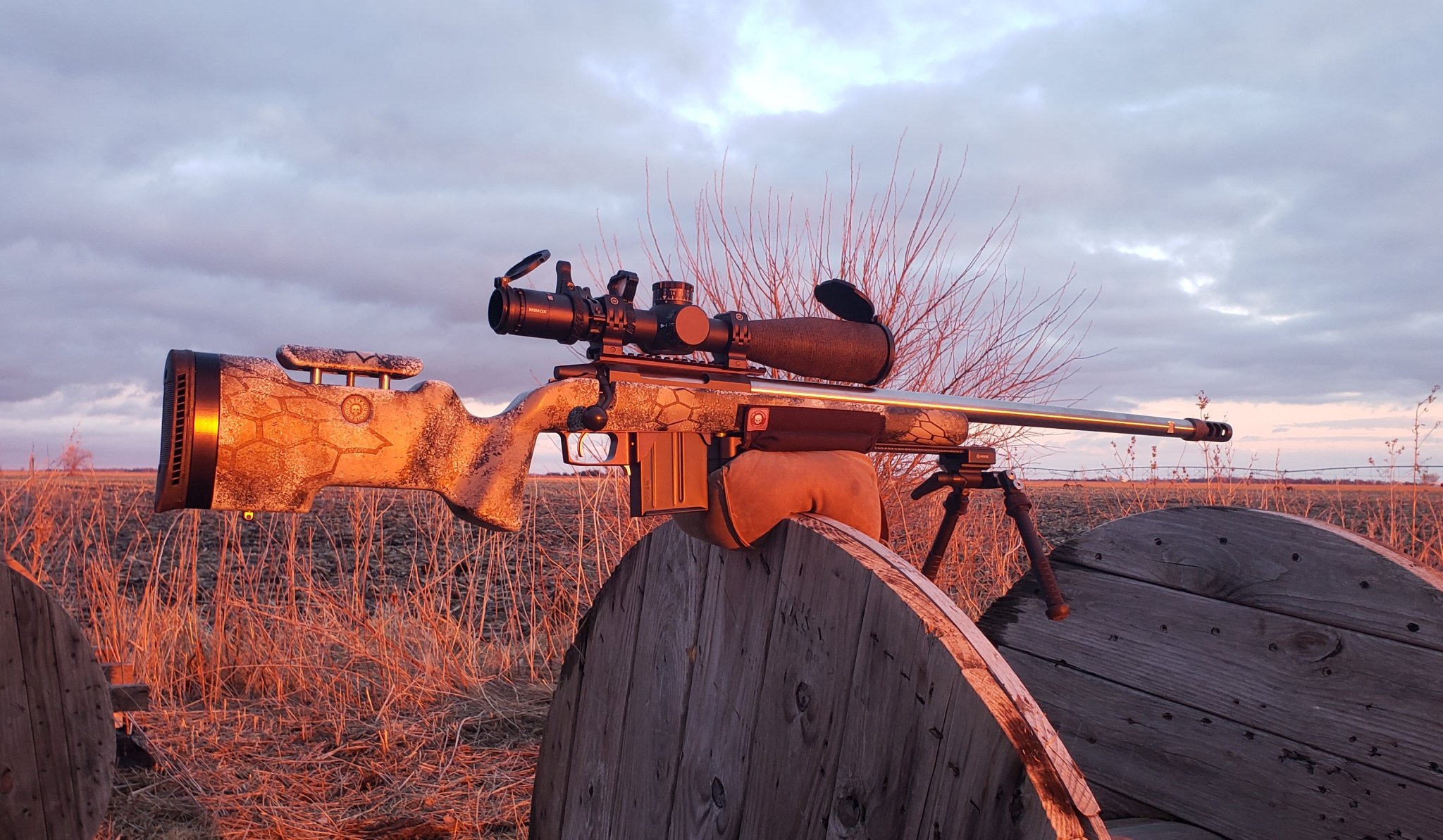

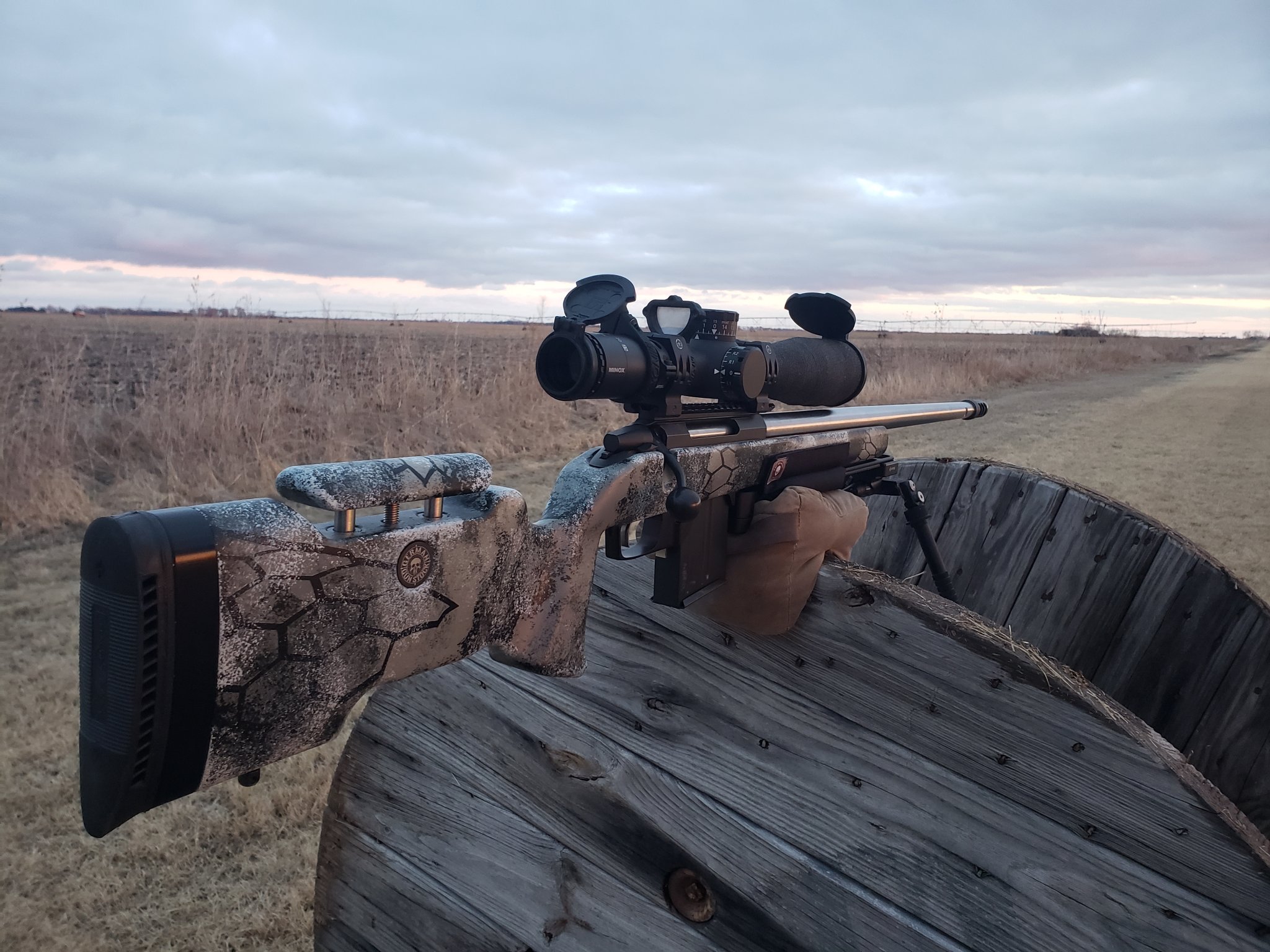

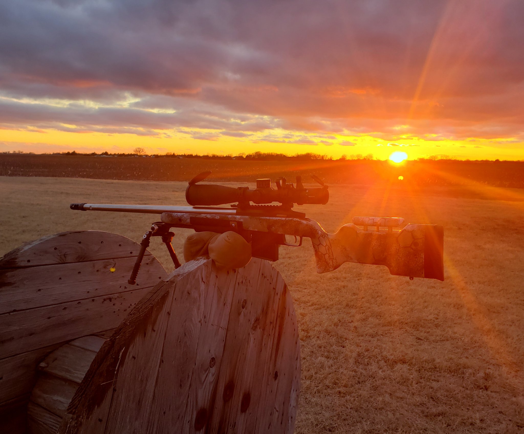

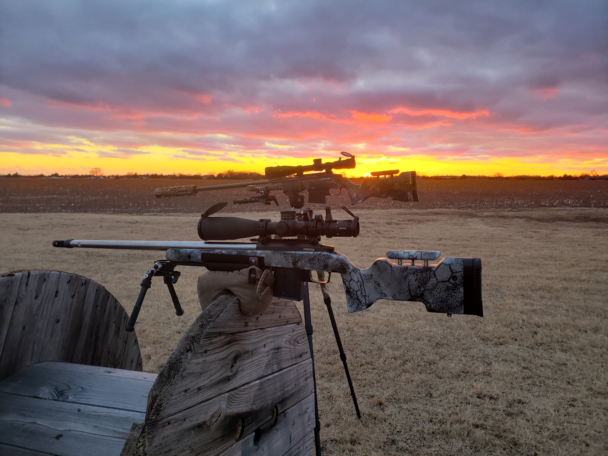

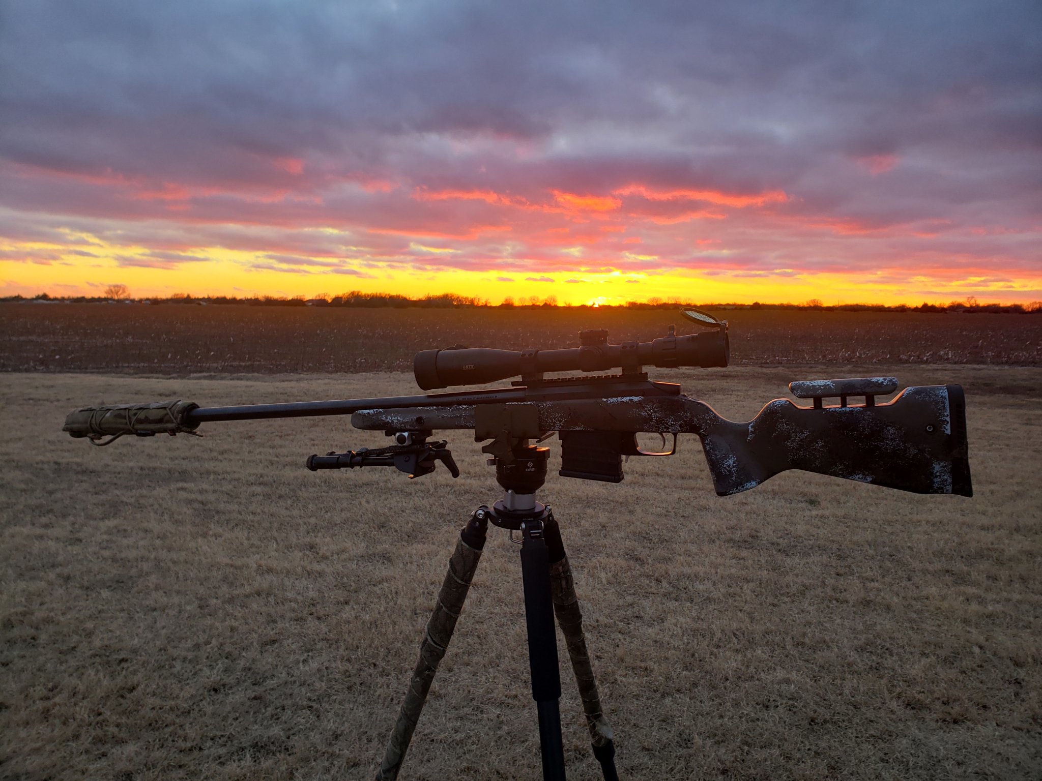

Looking forward to shooting some local matches with the German Gun Stock Raptor. Need to get the 28" 6.5 Creedmoor barrel broke in now.View attachment 7260487View attachment 7260488View attachment 7260489View attachment 7260490View attachment 7260491View attachment 7260492View attachment 7260493View attachment 7260494View attachment 7260495View attachment 7260496
Did you just drop in the action or did you bed it as well?

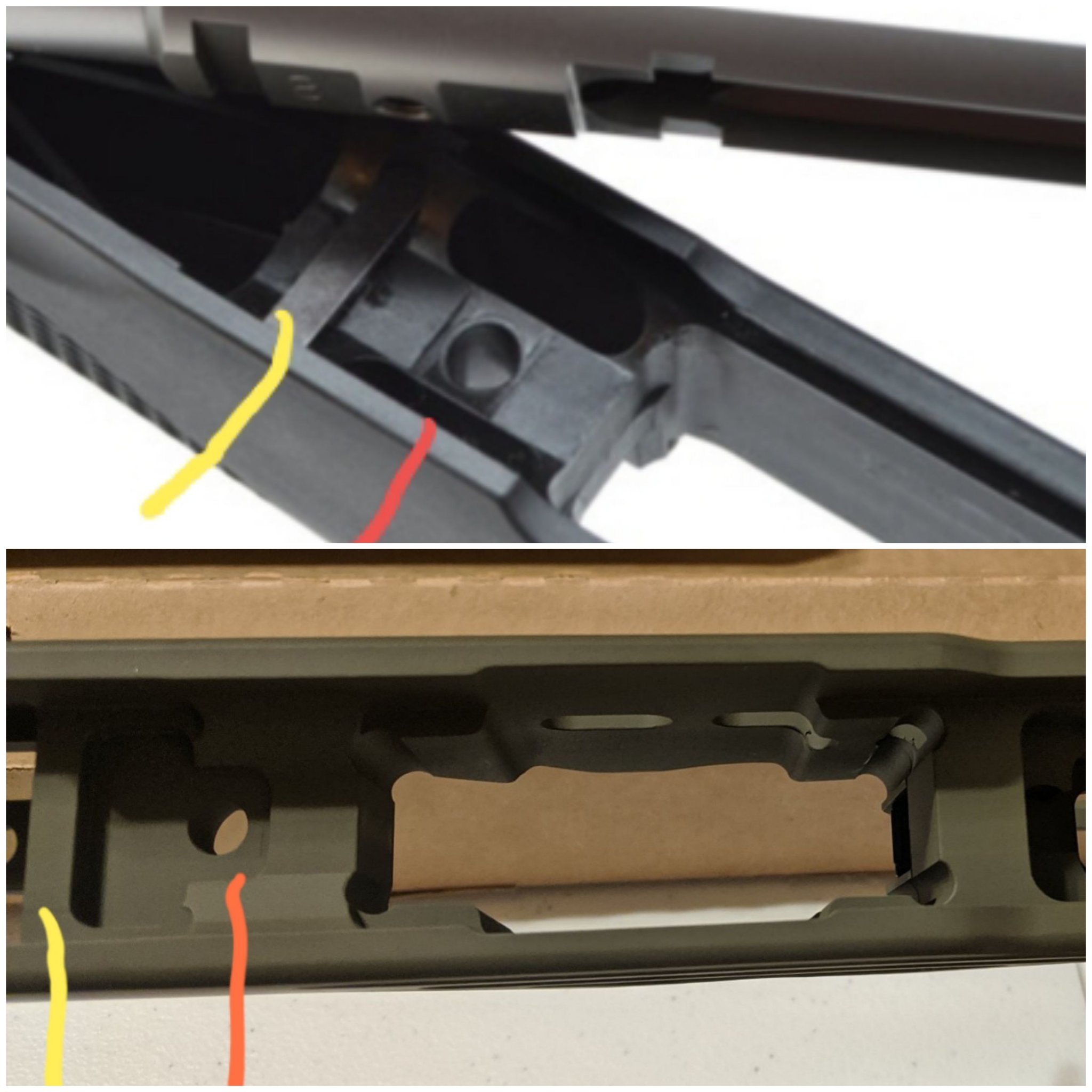

Have you checked that the chassis is actually missing anything when you assemble it to the rifle action? It looks to me that the rib (marked yellow) is the recoil lug. View attachment 7265993
Yes that's correct sorry I posted I had spoken to Al at mpa and he verified what you were saying. I attached the chassis to the action and man was it perfect. I am extremely happy with it and how it fit. Thanks for your help.
No need to bed a German Gun Stock. They have an aluminum mini chassis with a stainless steel recoil lug that the action sits in. I torque mine to 45 ft/lbs. You can take it apart between shots and it will not affect group size.

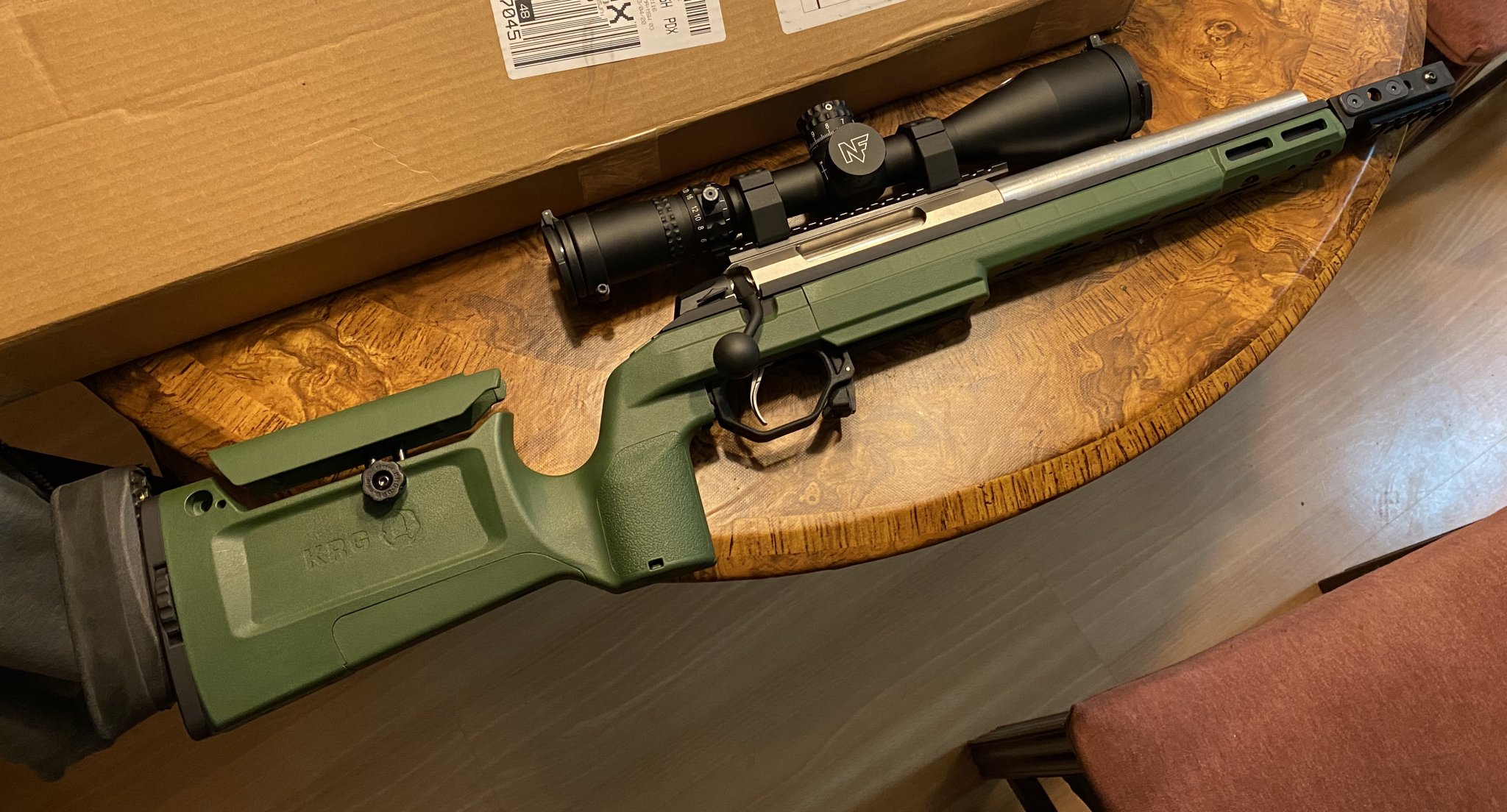

Got my old beast a new barrel for this year.
SAC 6.5 Creed
Bartlein 28" 1:8
PVA Shockwave brake
KRG X Ray w/Ingenuity rail + arca
Sterk bolt handle (still my favorite handle of all time, thanks @cannoncrossfire !)
Bushnell DMR2
ARC M10 rings
Heavy KRG bag rider
Scott Whitehead's weight kit
Does it shoot any better than the original barrel
