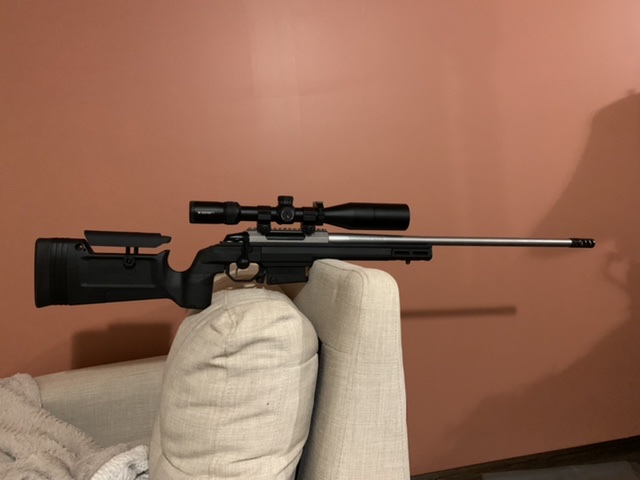

after much debating and searching. I found a deal today I couldn’t pass up a 24” T3X CTR stainless for $952.00 out the door...bought it on the spot... I am a huge fan of my T1x and I figured now I’d have a full size to match my .22... I see that brownells have KRG stocks and KRG as well but I’m trying to buy a pair of bravos one for each... does anyone know if they ever go on sale (I know they’re a good deal, but I like to try to make my money stretch as far as possible)?

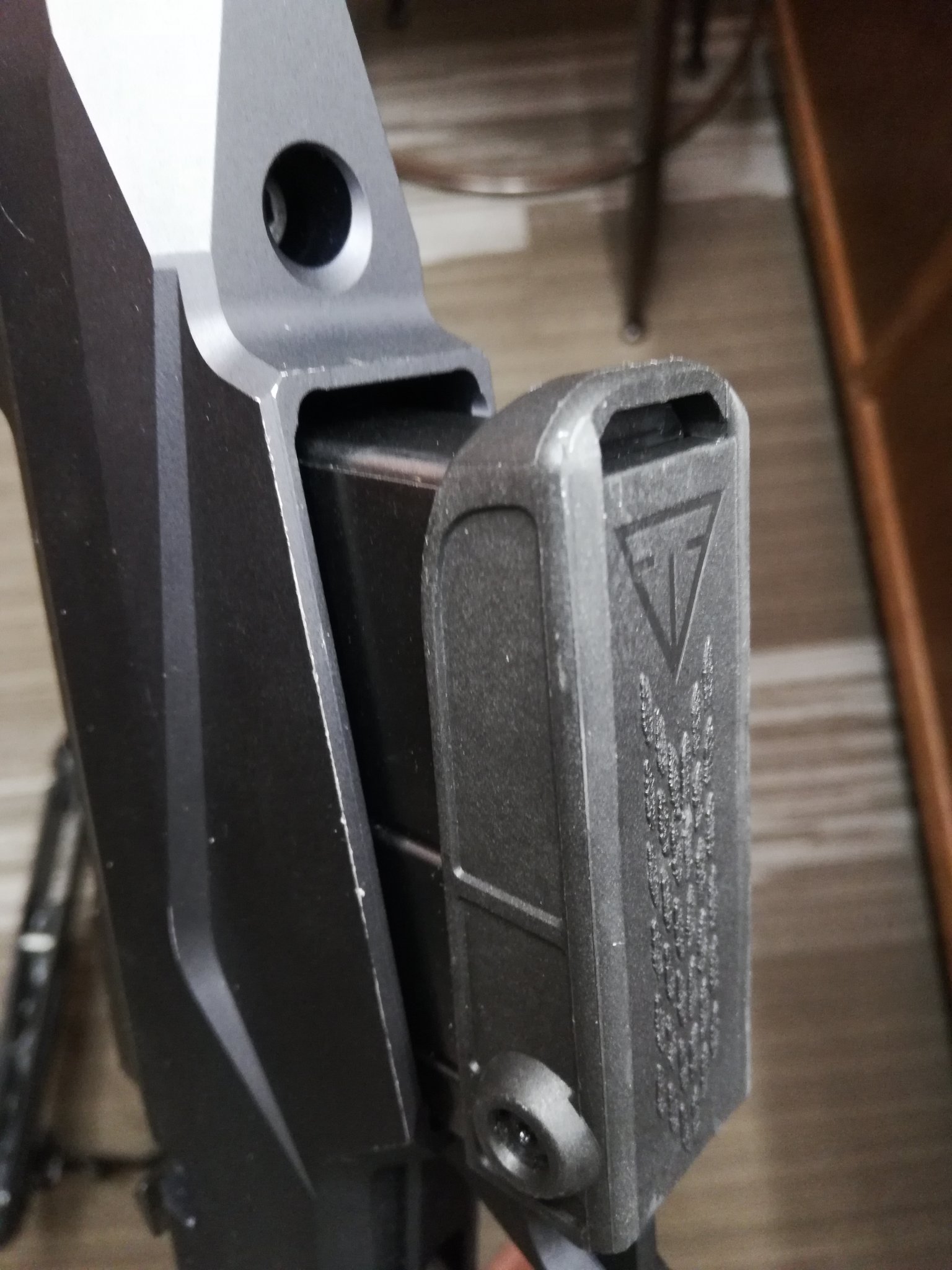

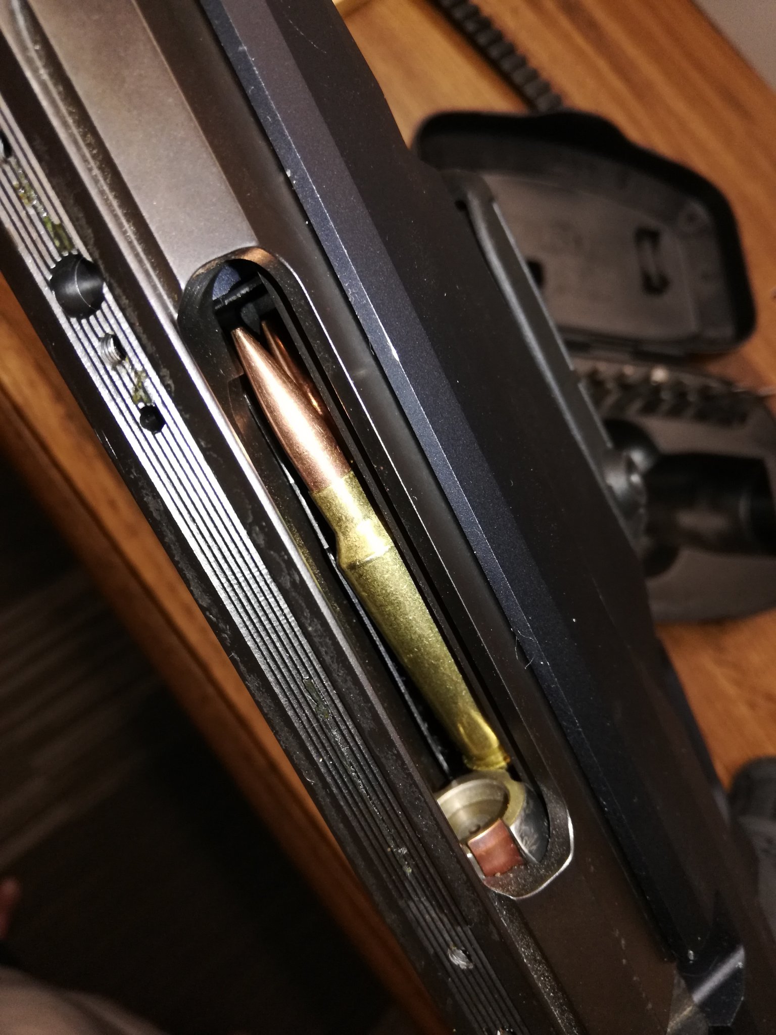

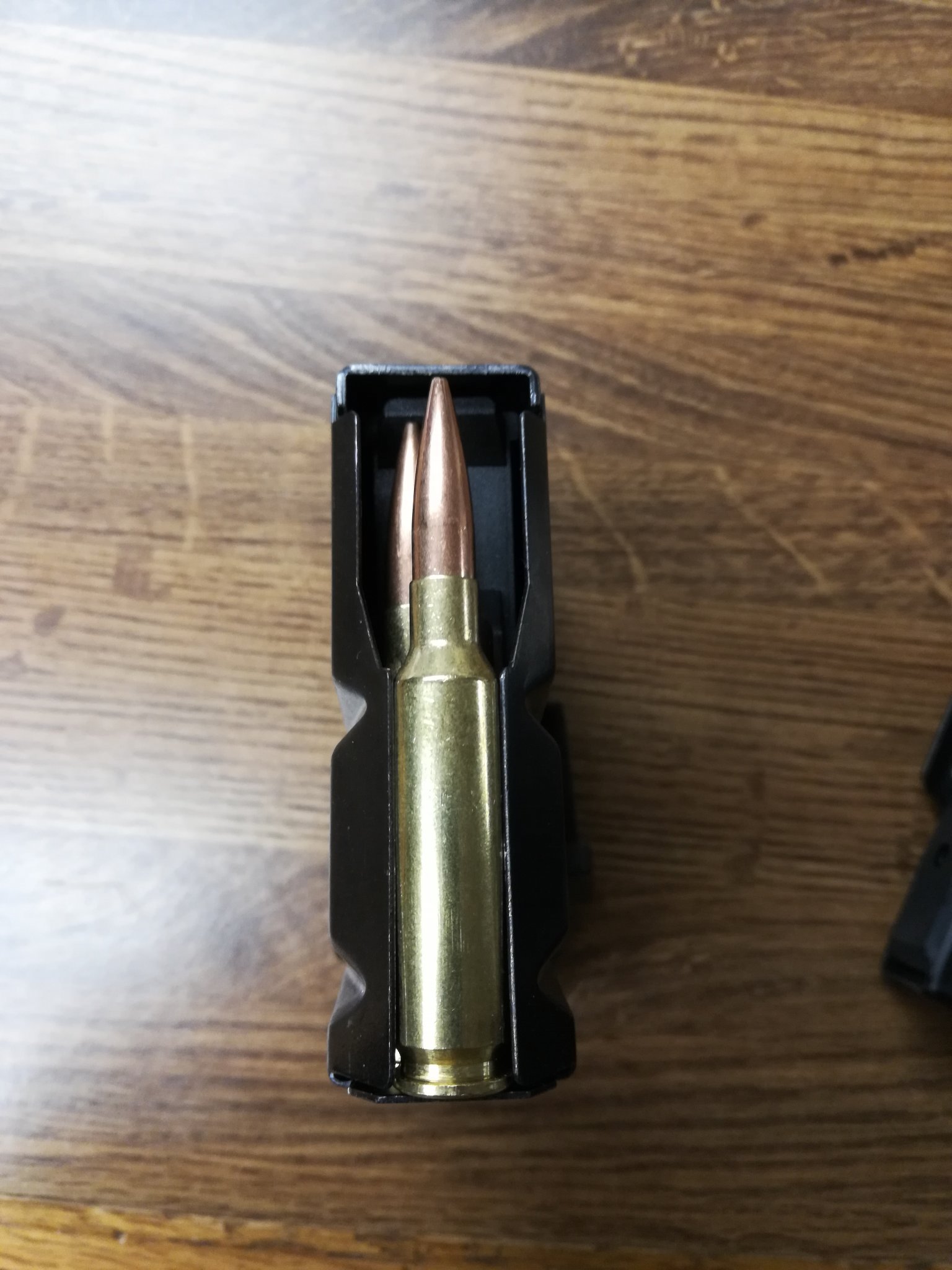

I put my 6.5CM T3 action into a T3X Tac A1 chassis. Loading 140Gr American Gunner into the CTR mags, the rim sits too far back for the bolt to consistently grab. Anyone else gone through this? Ideas? Dremel a notch in the front lip on the follower to keep the rounds from being pushed back in the mag?
Take out your bolt stop and file the bolt stop a little bit more so the bolt can come back further which would allow it to pick up the cartridges. The ctr bolt stops allow the bolt to travel rear words a little more than the T3 lites. It would take only a couple minutes.
I'll look into this. Thanks!
