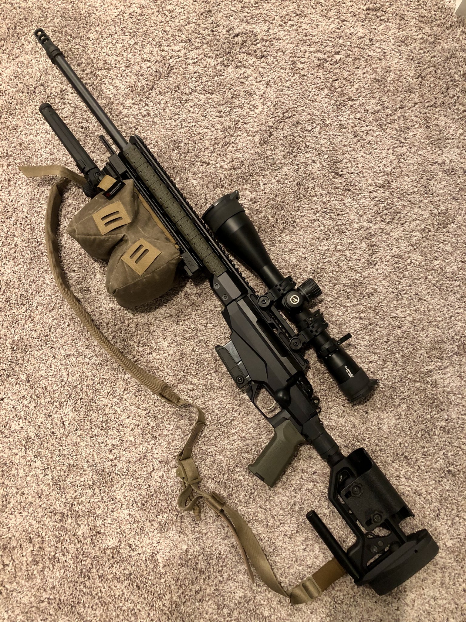

Made a little update on my Tac A1 6.5CM this weekend. Previously I had a small pic rail mounted on the handguard, and my bipod mounted to that. On more than one occasion, I wished I had the ability to move the bipod closer in to be able to better position for up/down angles.
On went a 12” Area 419 Arcalock rail, and one of their clamps for my bipod. I really dig the ability to quickly adjust bipod position now! Mount up and locking seems darn solid to me.
I also picked up one of the Area 419 rail mounted pint size Game Changer bags (aka Railchanger). The rail changer bag is nice, it’s easy to mount and dismount, and provides a hell of a stable shooting platform. It’s damn heavy though. It will be useful for situational and positional shooting I think.
