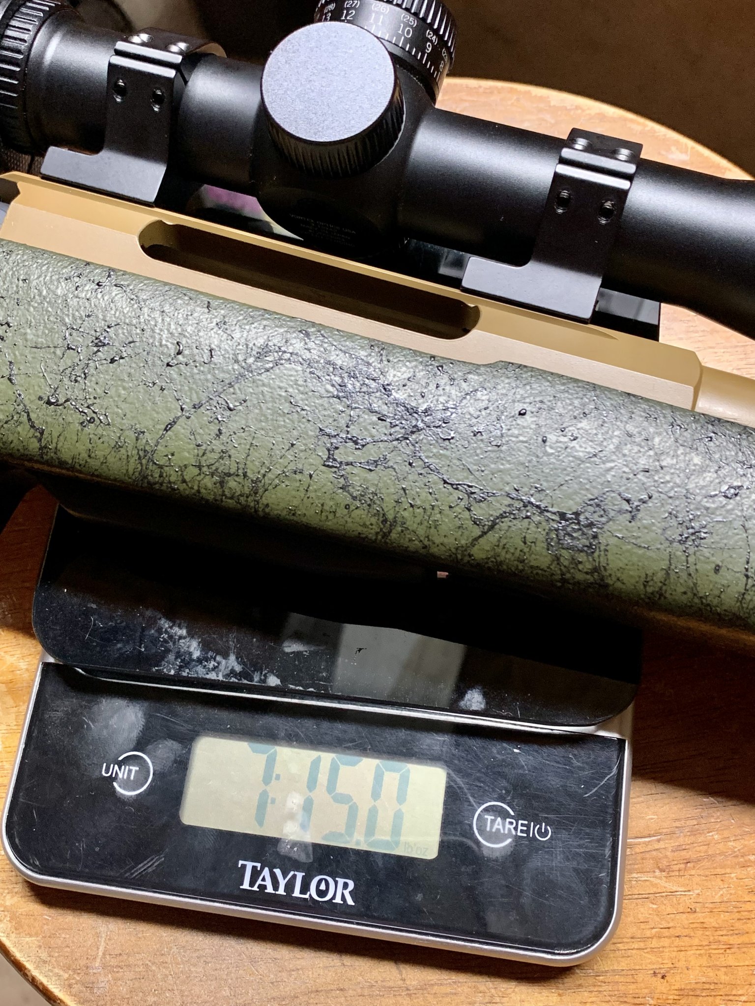

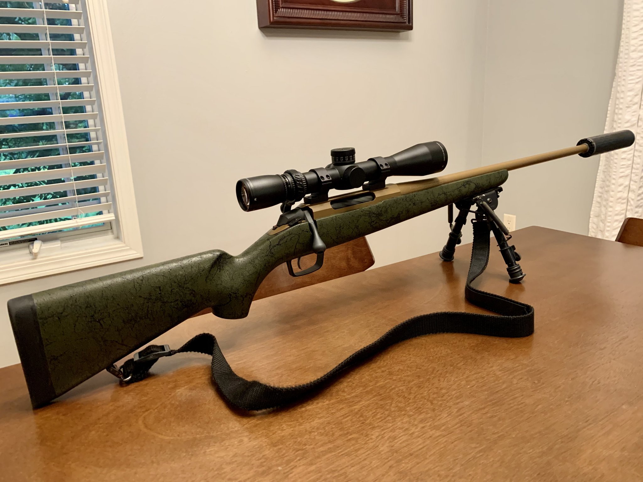

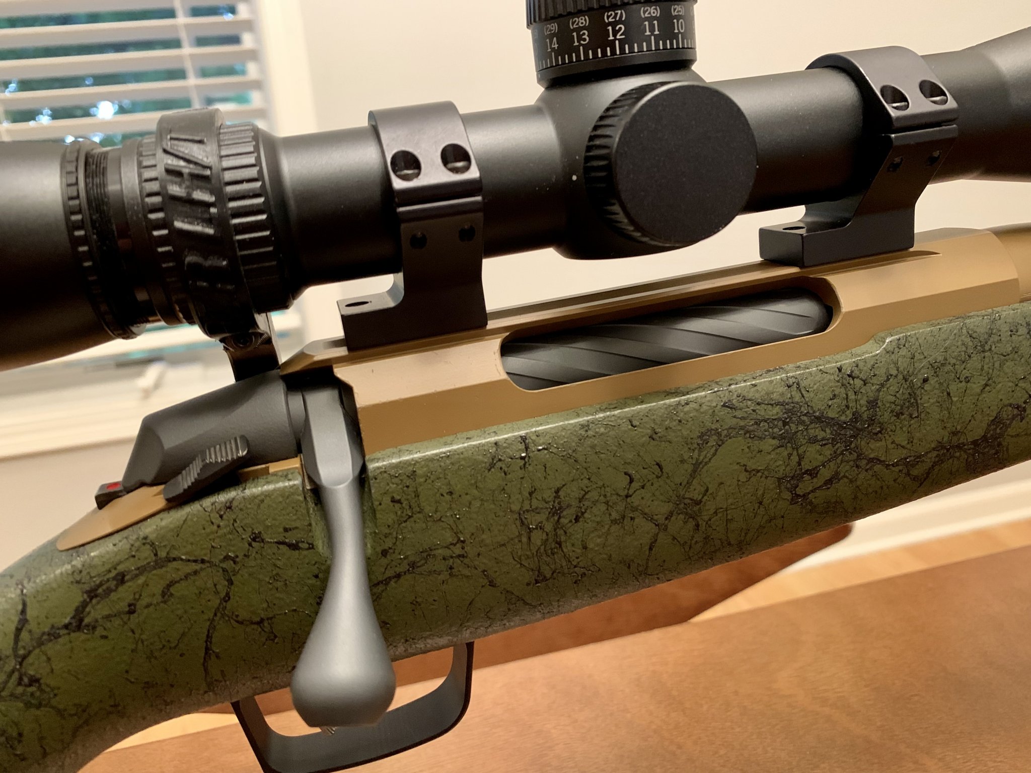

300WM cut to 21.75
Threaded to 9/16x24
Barreled action is Colt Coyote cerakote
Bolt is fluted and Sniper grey
BC stock
Talley rings
Vortex LHT 3-15x44
Weight includes a Bultler creek mountain sling and a 3rd empty mag.
8#14oz with my omega direct threaded

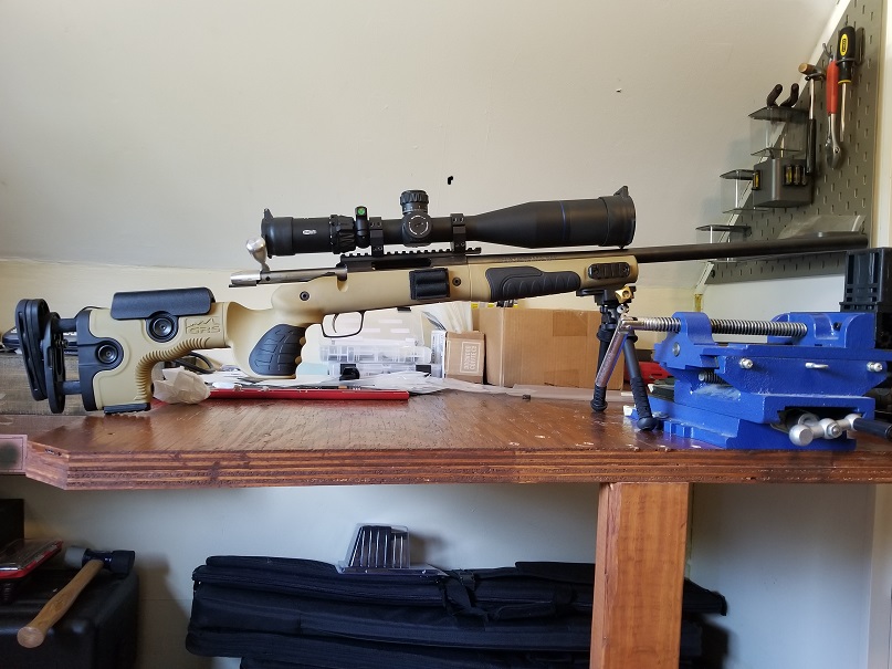

So, I went through all my mounted scopes, focused diopters and sharpie marked them.
Sporter just waiting for me to get my ass to the range.

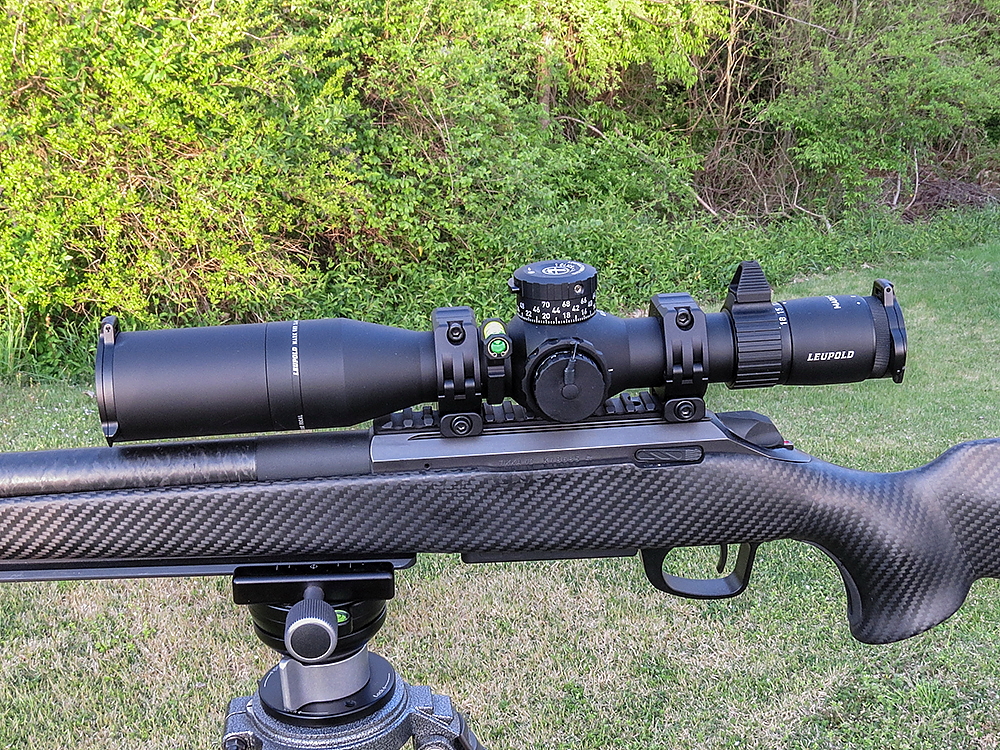

T3 Sporter 308 24", restocked in GRS Bifrost (brown). Mountain Tactical bottom metal, 20 MOA rail, bolt shroud.
Meopta Optika6 5x30 MRAD reticle w/ Talley Modern Sporter Med rings (1.069, oops a bit too high), Vortex caps. Holland level.
Atlas BT46-NC PSR on Henderson Precision 3" ARCA w/ 419 clamp

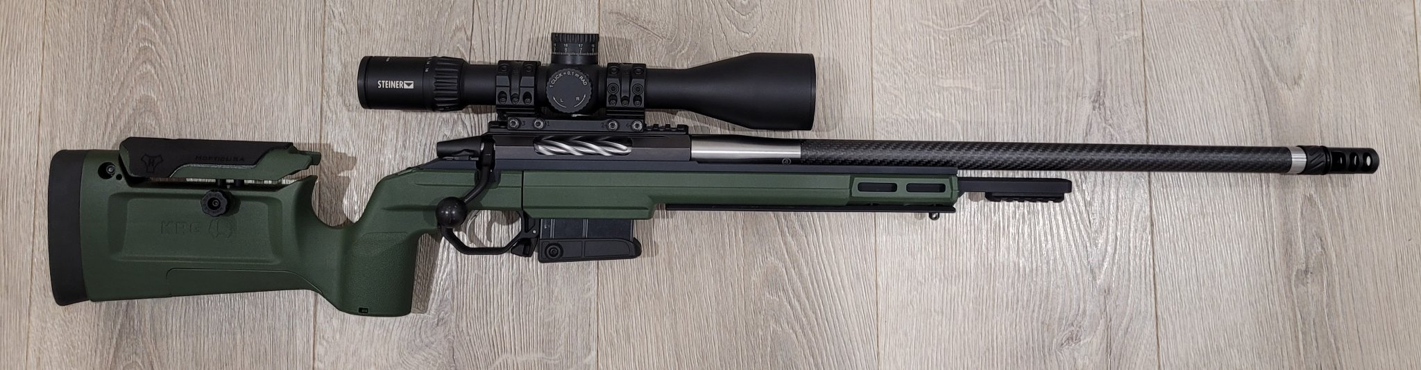

Had the new IBI 300wsm barrel fitted / chambered up.All it needs now is some cerakote on the bolt / barrel tennon and it's done but that'll have to wait. Keen as fuck to shoot this , overall very happy.
CTR mags are feeding flawlessly with the 300wsm View attachment 7689221
Looks great, did you have to tweak the feed lips any to feed reliably?

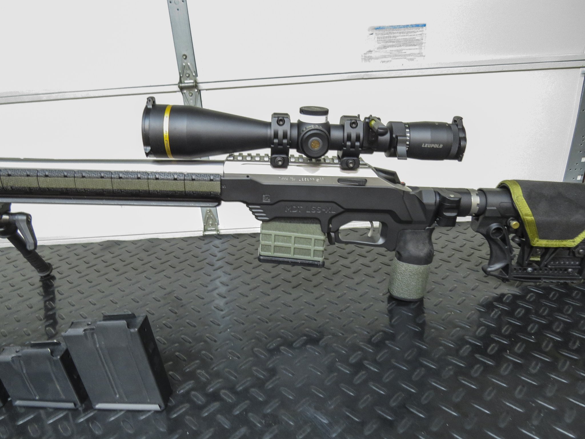

Will the ctr magazine fit into the bottom metal of the super varmint? No. Pic is lite bottom metal in a ctr stock.

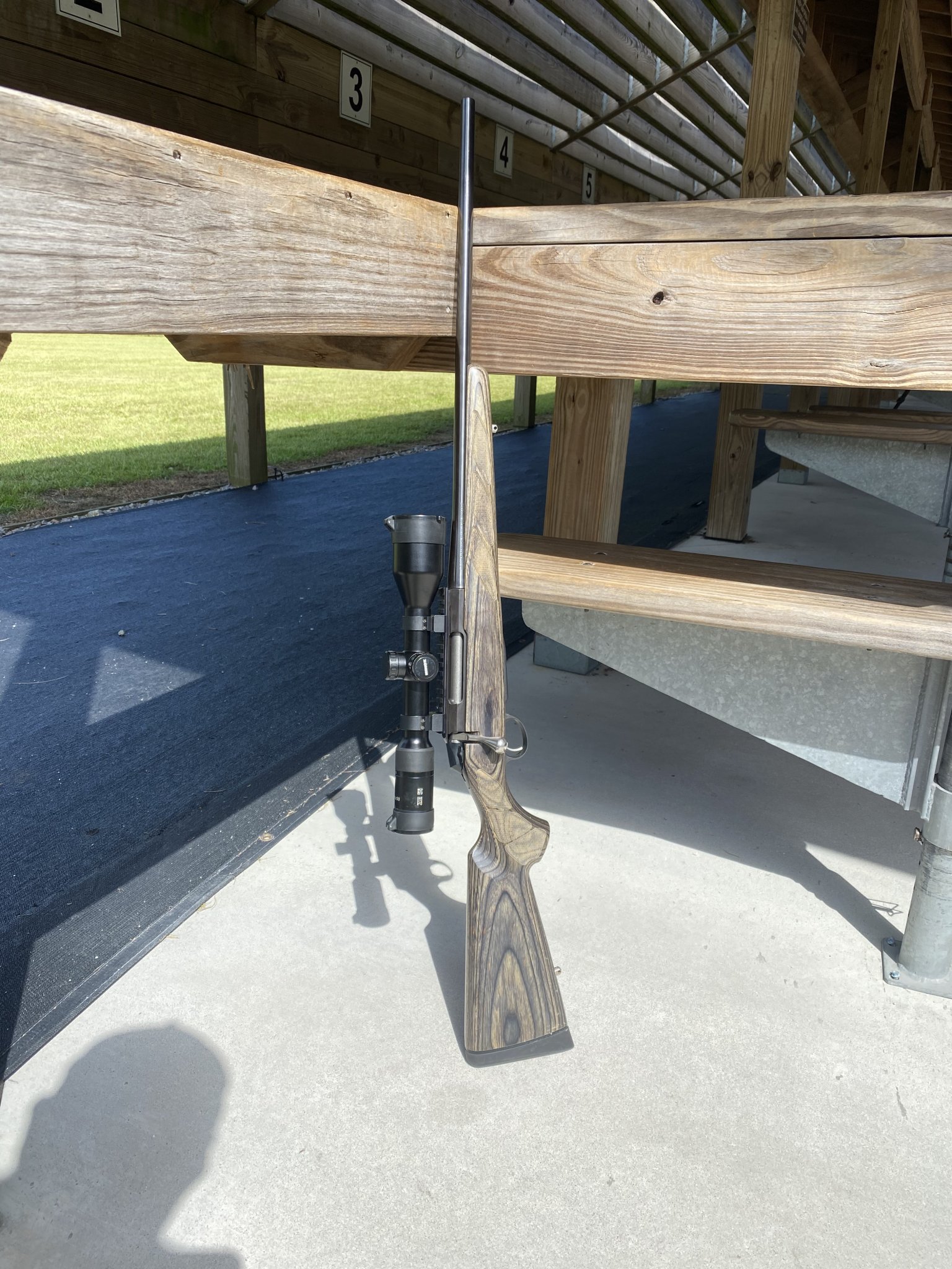

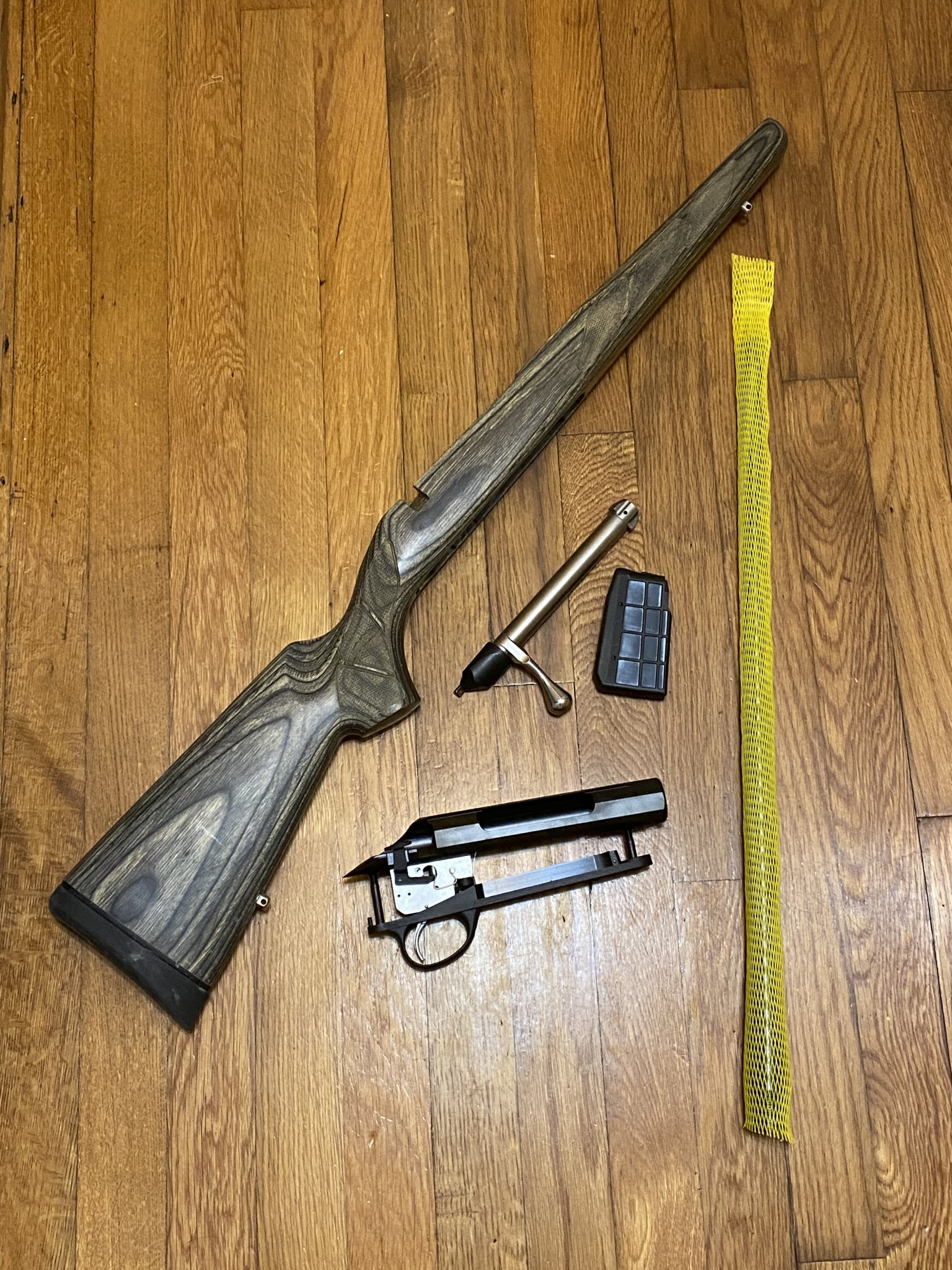

So I had a pile of spare parts. All of them from different rifles.
I decided to clean off the workbench and noticed all I was missing was a stripped action.
Well, after months of bothering a dealer on another forum about a stripped action, he came through.
Pictures tell a story faster than words.

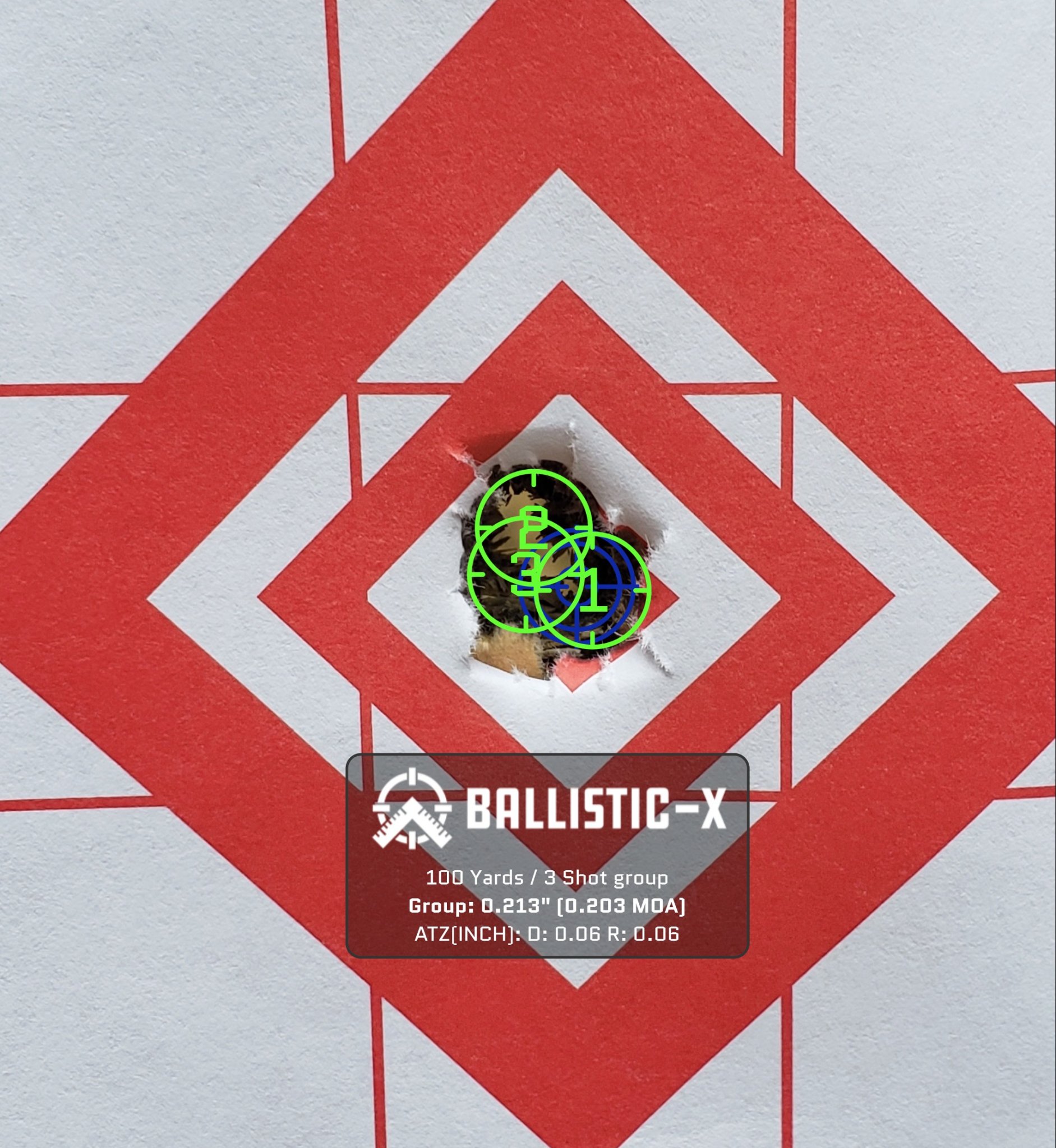

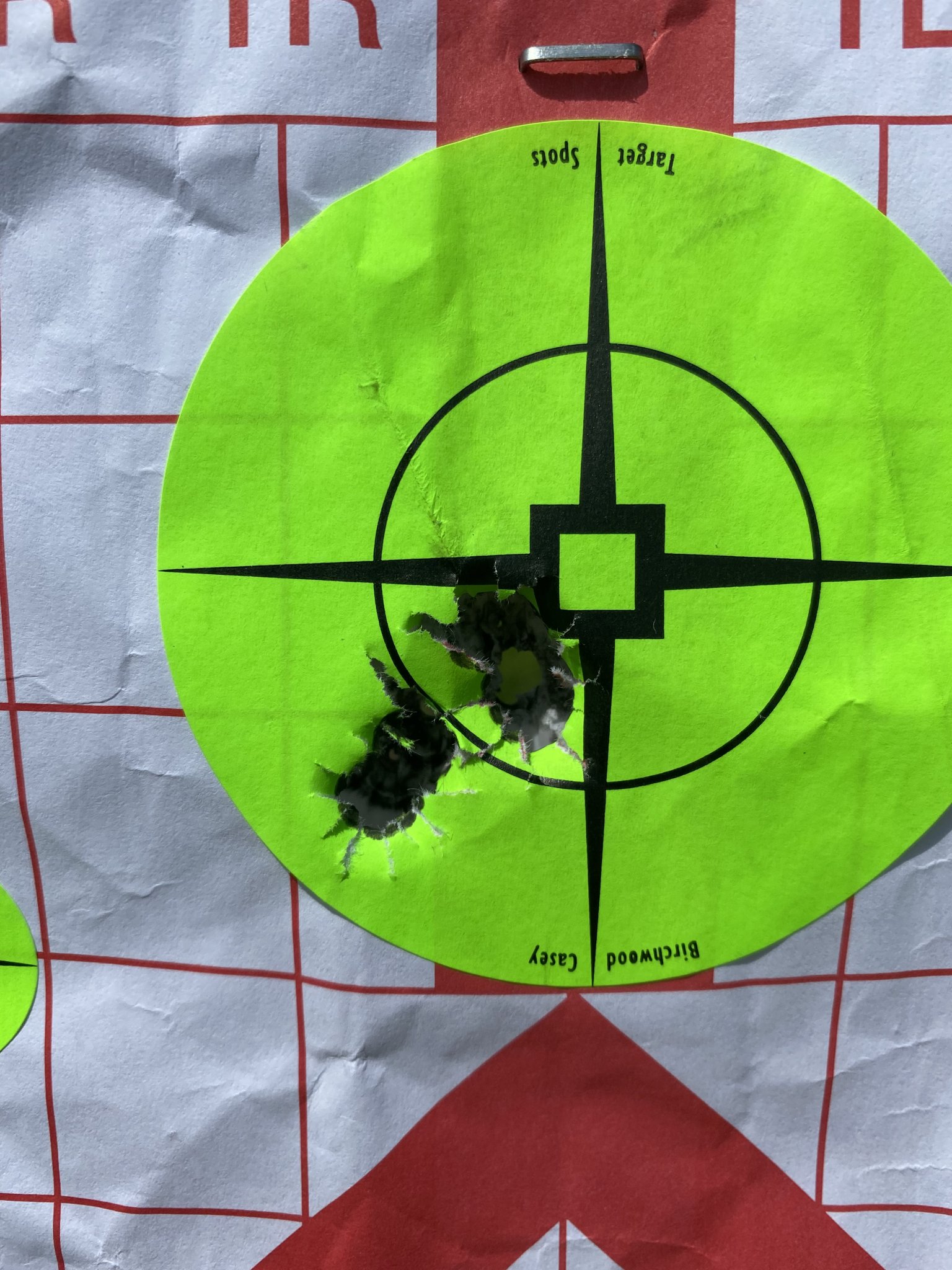

The target is four shots at 100yards. Some leftover target loads from a friends match rifle. first two on the left, adjusted and shot the second two.
I’ll be keeping this spare parts rifle.
The scope is a Minox ZE5i 2-10x50 that has been sitting idle for years. Literally sitting in a shelf covered in dust.
