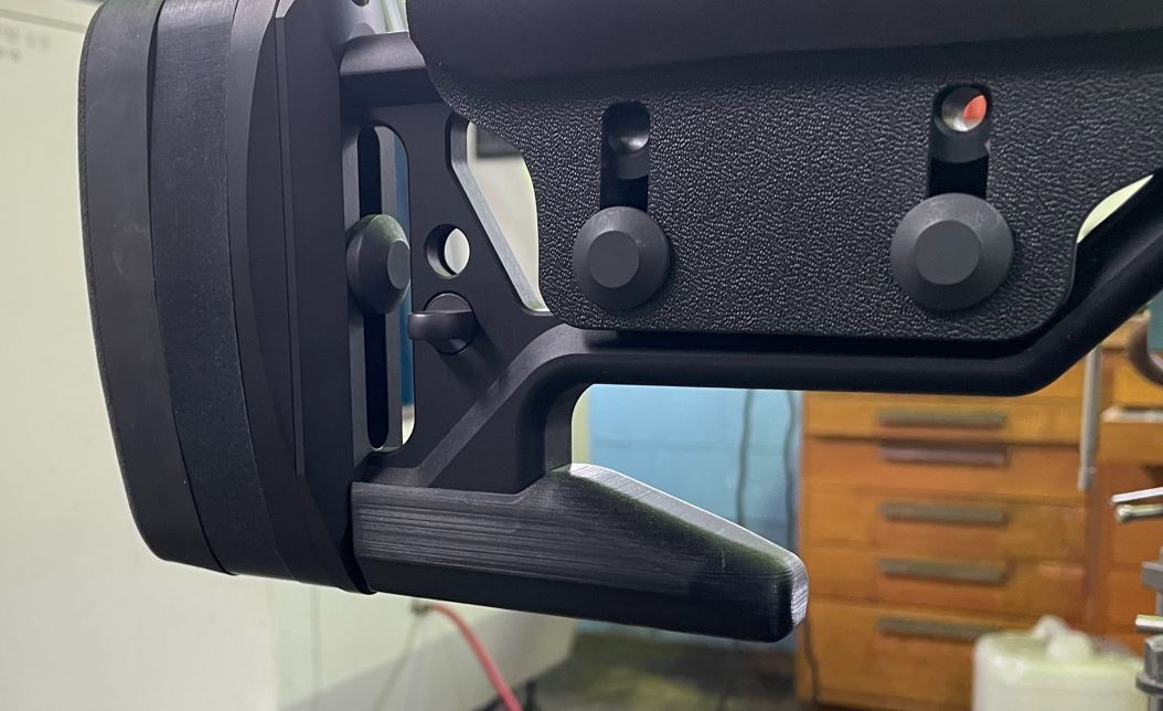

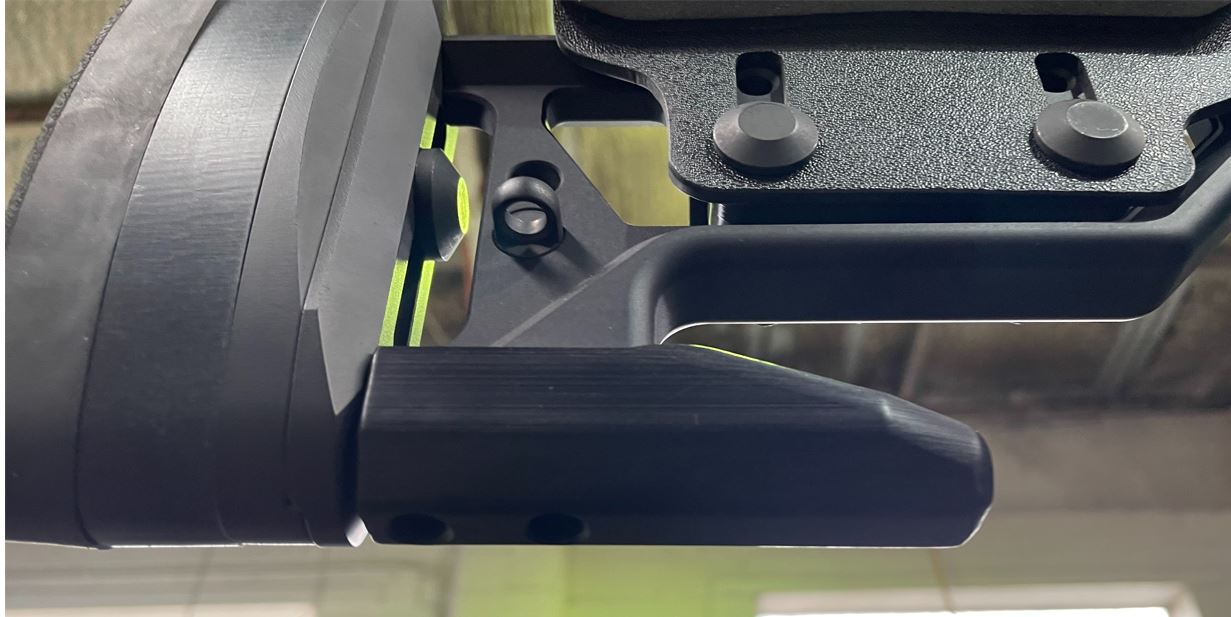

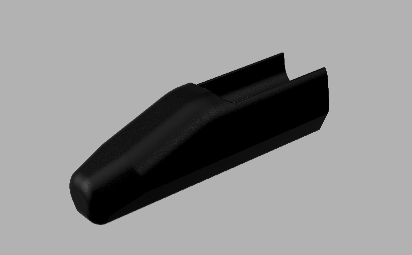

I designed and printed a bag rider to suit the Tac A1 stock. It replaces the picatinny rail and uses the same screws to mount. It's not overly long but sits in a rear bag really well.
I've had a couple of people ask about getting one, I'm in Australia so it's not really worth the postage cost. You can download the file at https://www.thingiverse.com/thing:4963816 and have someone print it for you though.

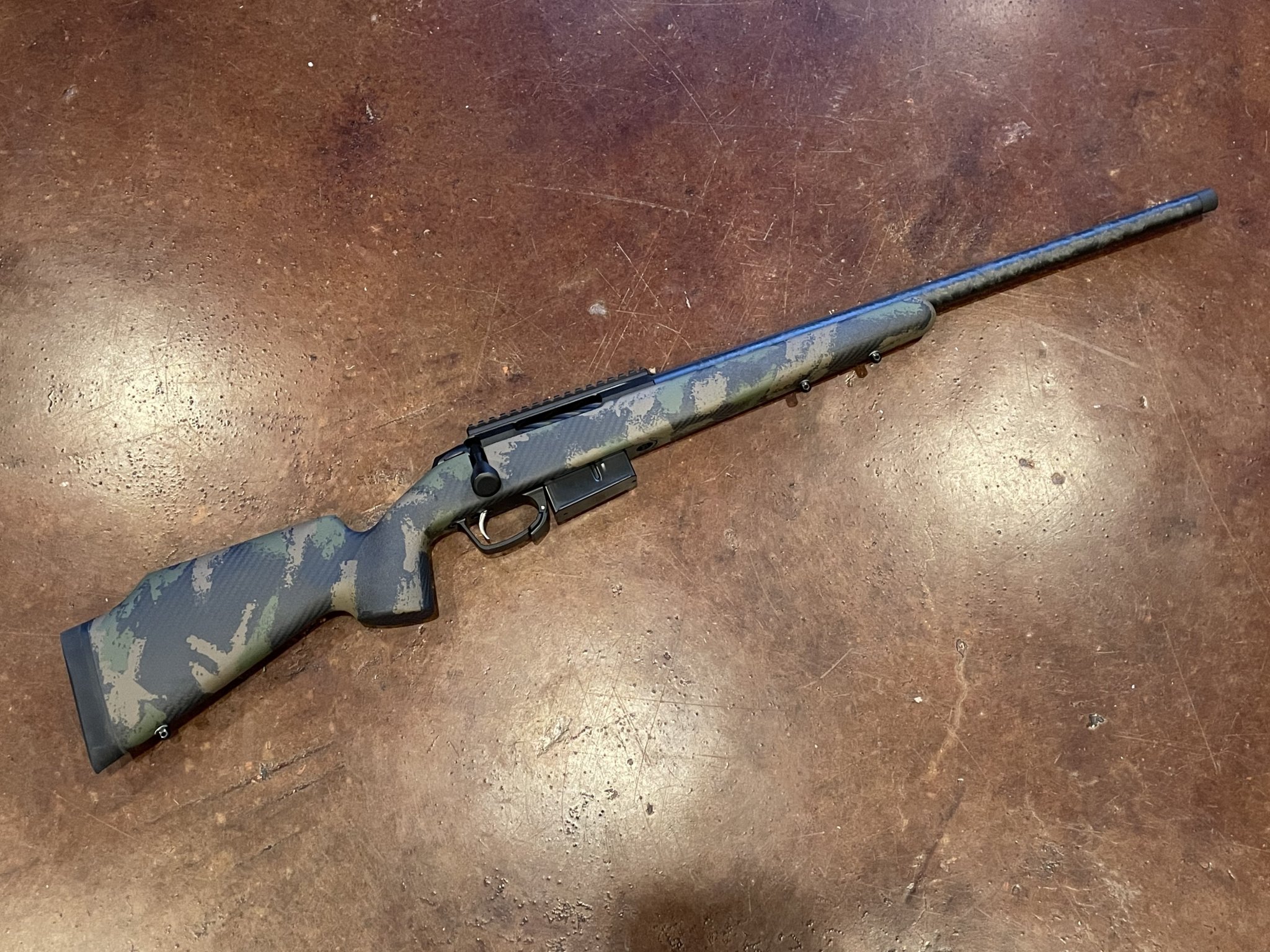

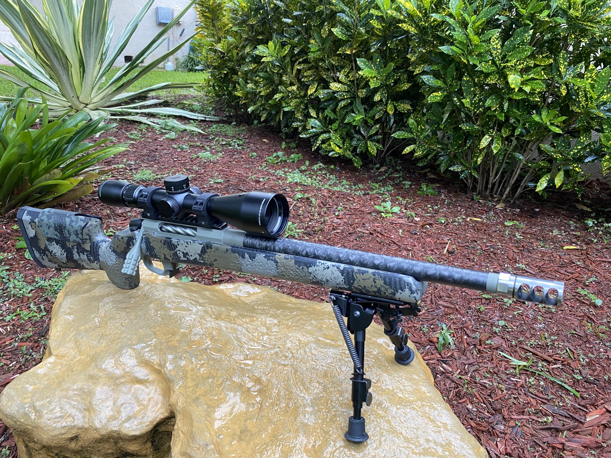

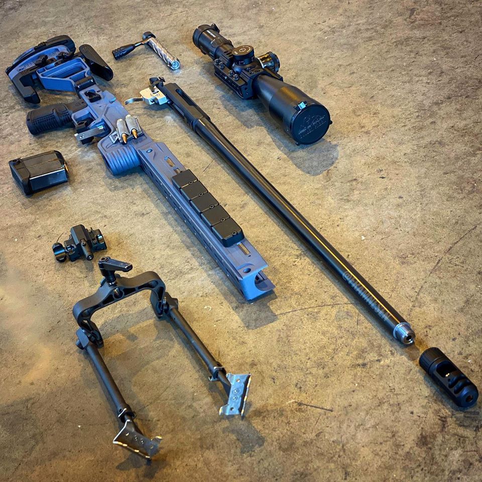

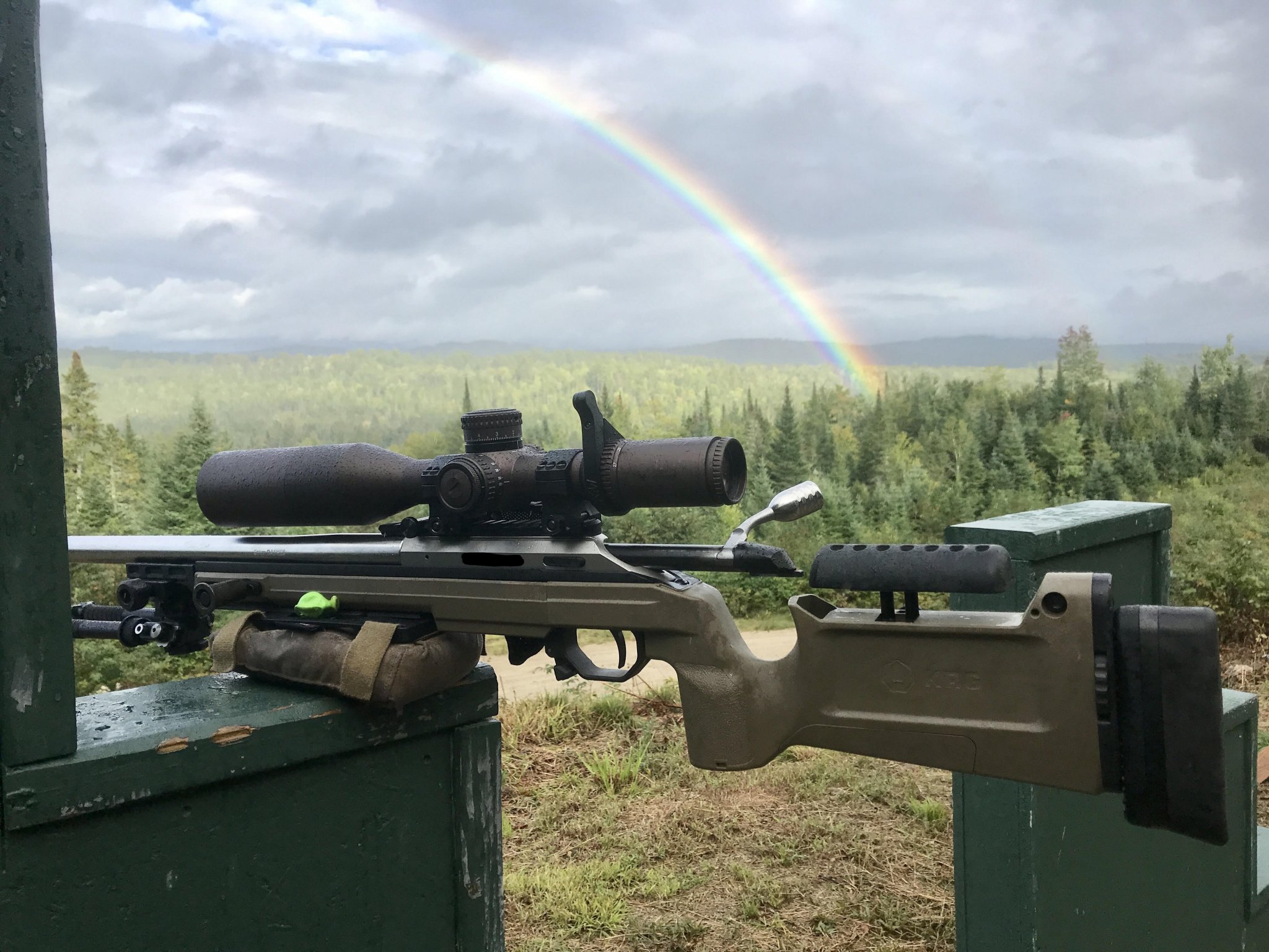

I had my Tikka CTR re-barreled with a Hawk Hill barrel and chambered in 6 Dasher over the winter by ICE rifles. He did an amazing job trueing up the face and chambering the barrel. It shoots better than I can. I like it in the KRG as it is a bit lighter than an MDT ACC. I changed the cheek pad to the more adjustable one but I am not sure it helps my shooting. I have fun trying though.

Yeah its pretty light. With a folder (which I want) its around 36 oz with the carbon butt stock and 48 oz with the tac butt stock... and thats with an ARCA rail the others dont have, its a folder, and the LOP is better (I'm tall). By the time I lengthen the LOP (which I cant do in a lot of the other lightweight stocks) and add an ARCA rail, they will probably weigh more than the XLR with the carbon stock, and not much less than with a TAC stock. I mean, just like you said - I sort of want the new Manners for the looks, but I'm skeptical that it will as good a hunting tool when its said and done.
But I do still want to bump my original question - I know there are feeding issues with aftermarket LA bottom metal and AICS mags with the Tikka's. My understanding is this shouldn't be an issue in an XLR since its a full chassis, but wanted to hear some first-hand experience.
Thanks so much for providing the file. I have never had anything 3D printed before. Is this a preferred material type to specify?
No problem (y) PETG is good as it's a bit tougher but PLA is fine. If it's printed with 3 perimeters and about 25% infill it will be plenty strong enough.

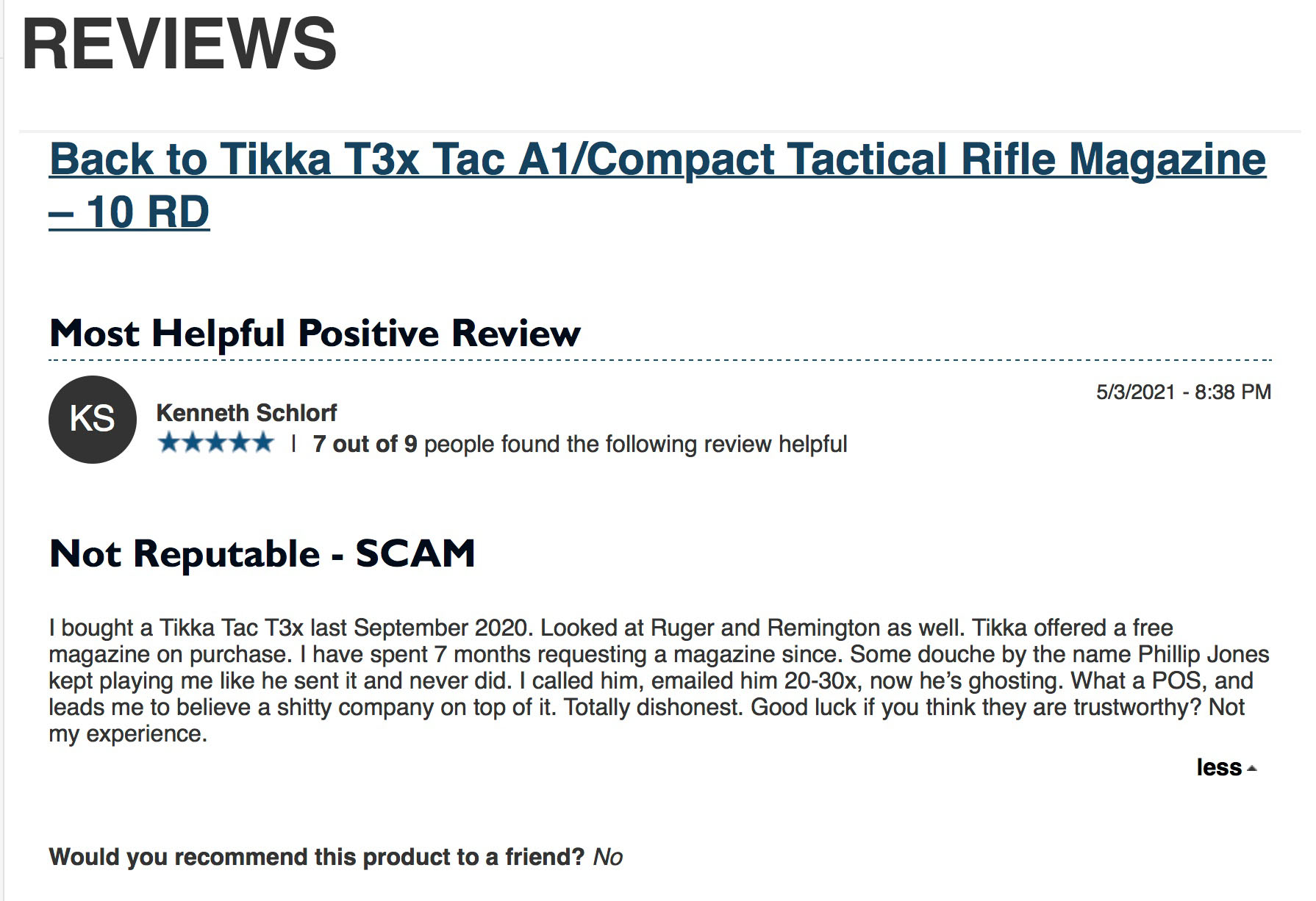

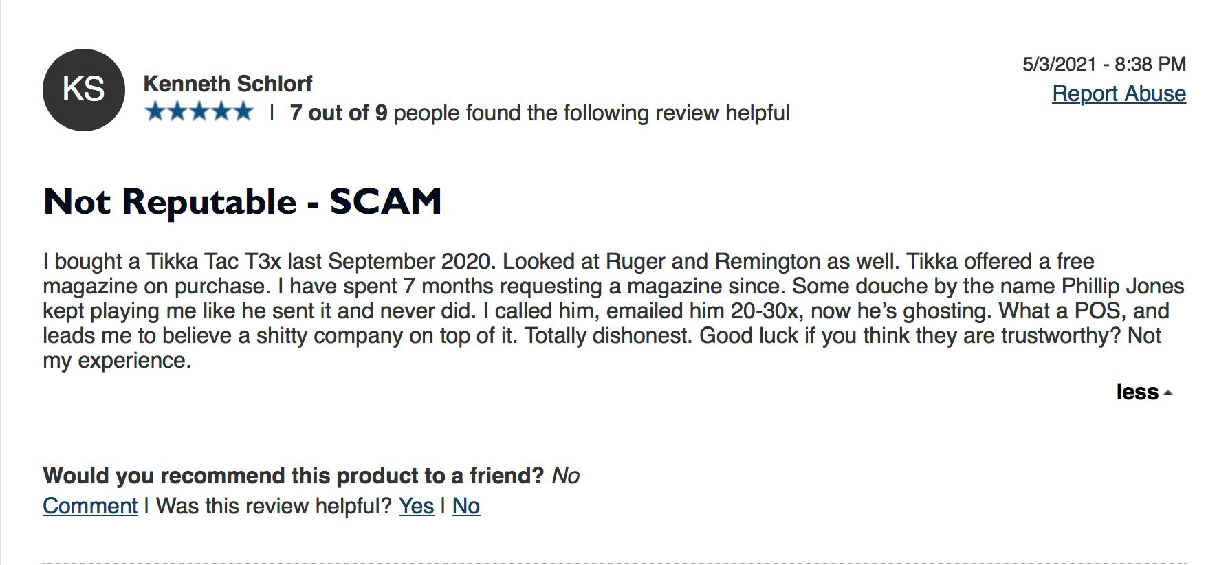

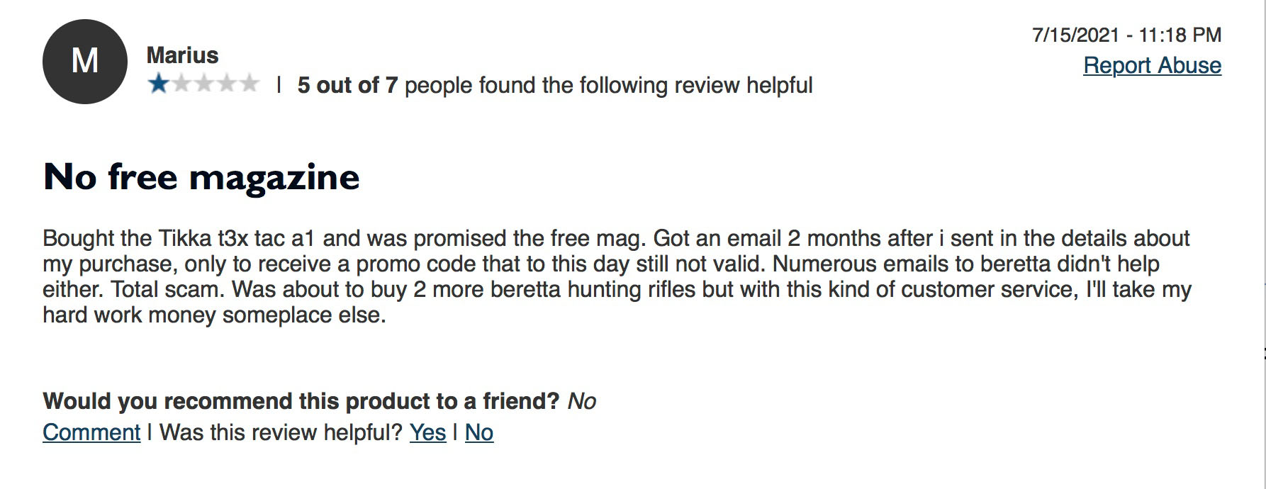

Free TIKKA T3X TAC Magazine Promo
Back in July of this year my submission for the Tekki T3X TAC Magazine Promo was received and acknowledged. It took two months, but I finally received a promo code. I tried using the code provided, but it comes back invalid. I looked on the Beretta page for the Tekki T3X TAC magazine and see 71% of the reviews state they had the same experience I had and never received a magazine.
All of my e-mail requests for a valid promo code have gone unanswered. Has anyone here had success recently getting the free Tekki T3X TAC magazine offered by Beretta? Below are screen shots of posts from the Beretta webpage of individuals that never received there free magazine.

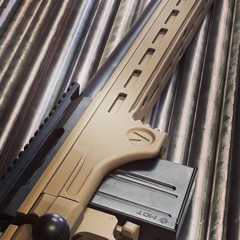

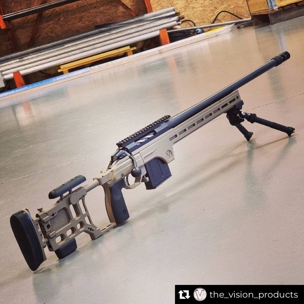

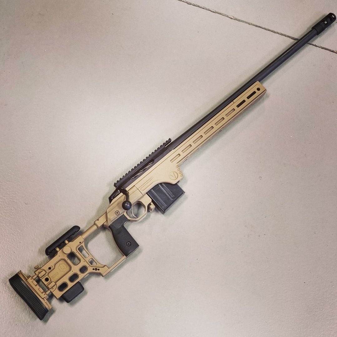

Here are the pics of the Vision forend for KRG chassis' and a pic of a Vision chassis that comes in a tikka inlet.
I think the CTR mag sits further back compared to the standard plastic one. CTR's don't have the mag spring in front of the trigger

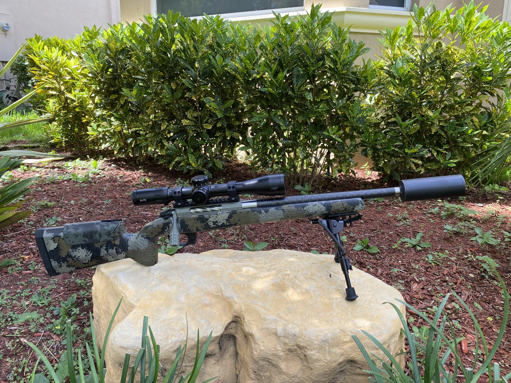

Critter Getter, T3 Carbon6 16.5” 6.5 PRC, CTR bottom metal and mags, Vortex LHT 4.5-22x50, 8lbs 9oz (bottom picture)
What did it weigh in the top picture with the LRHS2 and the can? I will be interested in seeing what kind of velocity you get after the barrel is broken in. I have a 18" 6.5 Creed Bartlein that I am getting 2785 with 130s and 2715 with 140s and Rl16. A Carbon6 will be my next barrel, trying to decide between 25 Creed and 6.5 PRC.
With the LRHS2 I was right under 9lbs and the can is 1.5lbs

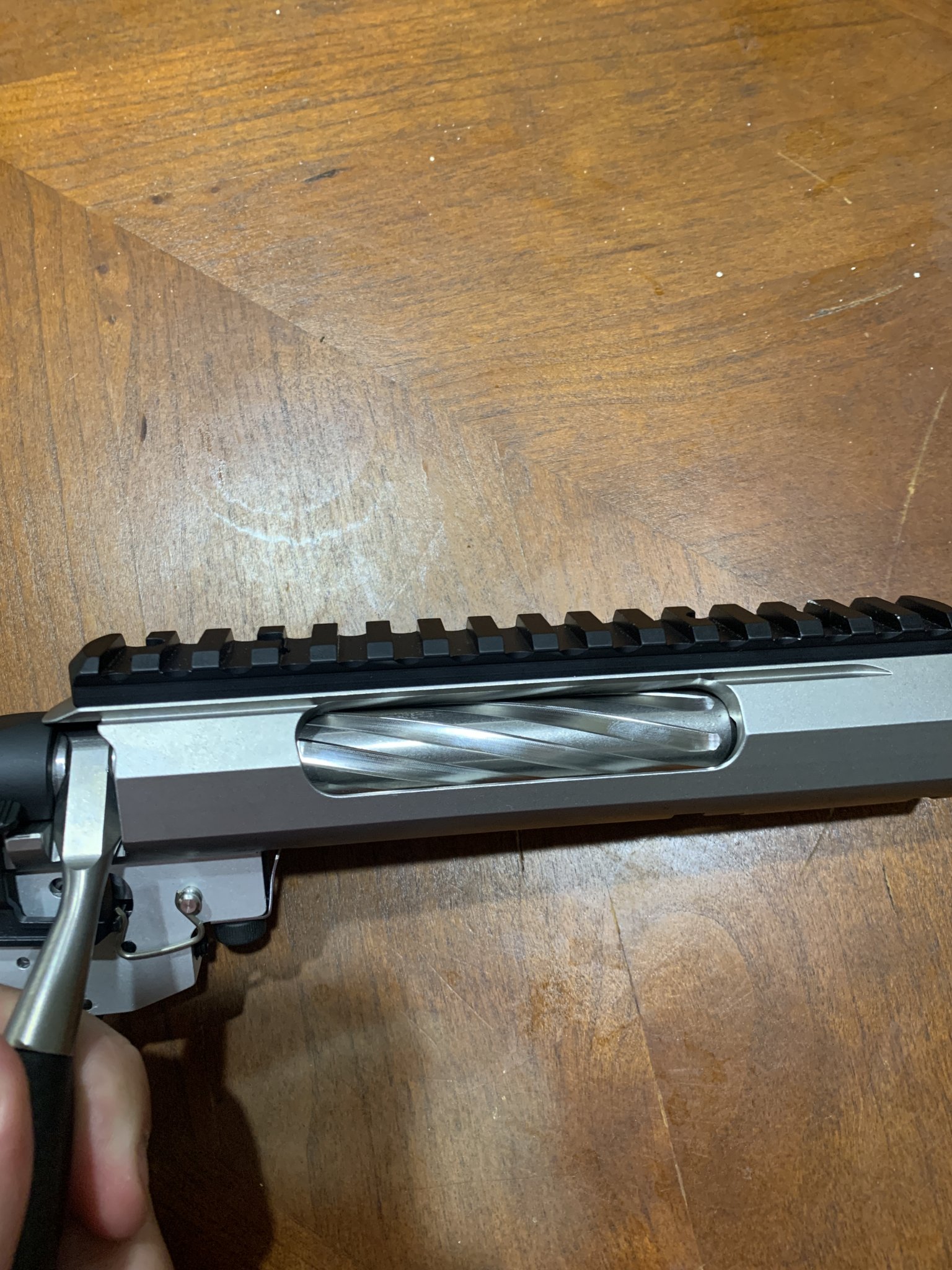

Any of you with fluted bolts on the Tikka's I have a question. I have a tac A1 in 260 rem I'm going to send off and have the bolt flutted. I'm just wanting to make sure it doesn't cause any issues or make the boot less smooth? I have had this done on other rems and rem style actions with no issues and just wanting to make sure the Tikka is the same.

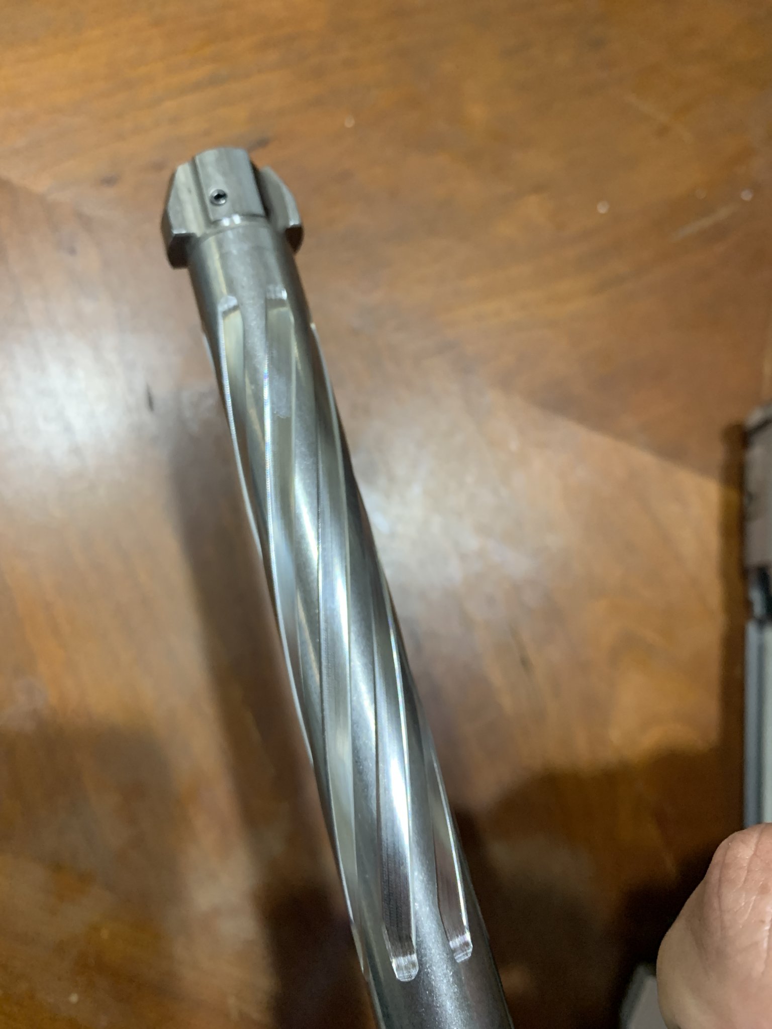

Got my LRI bolt fluted. Then coated it with T coat. It’s butter
Just got mine back from LRI about a week ago. Went ahead and had them pull off the factory barrel as well. They’re fast and give updates through the process. Mines the A pattern standard helix. I planned on eventually cerakoting the whole action, but I’ve never heard of T coating. I’ll have to look into that as well

Just got mine back from LRI about a week ago. Went ahead and had them pull off the factory barrel as well. They’re fast and give updates through the process. Mines the A pattern standard helix. I planned on eventually cerakoting the whole action, but I’ve never heard of T coating. I’ll have to look into that as wellView attachment 7708869View attachment 7708870

T coat has me interested, as I want to send two or three bolts off to LRI but I am not sure if I want them cerakoted after or not - but I dont want any of them stainless anymore.
This is all I can find, and no real threads on it here. Mind expounding? https://black-t.com/applications/
Birdsong is local to us here is one of the main reasons I use it. @Deep South Tactical can get you squared away if you have any questions about them. David coats all his Havoc actions in it. It's a smooth coating I quite like it. Springfield used to use it on their professional.
Jason is also correct Chad will cerakote a bolt and still keep it very smooth, he does very good work and his turn around is quick. He cerakoted my friends 6cm and it was still very smooth.
Personally speaking if you're intending to get the smoothest coating, I think DLC is the way to go but it's pricey. Chad Buie at club custom guns is a great choice. I had him do that to my tempest and it is to this day the smoothest action I own and have felt. Short of a bare tempest or deviant there hasn't been anything that has come close. He also DLCd my father's Bighorn.
You have any better pics of the bolt and which patter did you go with, that's where i'm sending mine. Also what is T coat I have never heard of that.
So I should've gotten more pictures while I was at DST the other day. But I didn't get my fluting done from LRI, accidentally forgot to add that to the order after I bought the bolt. Kampfield customs did my fluting, and then DST sent it to Birdsongs to coat the action and bolt.

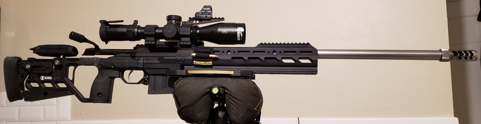

Is that @ Alderbrook?
