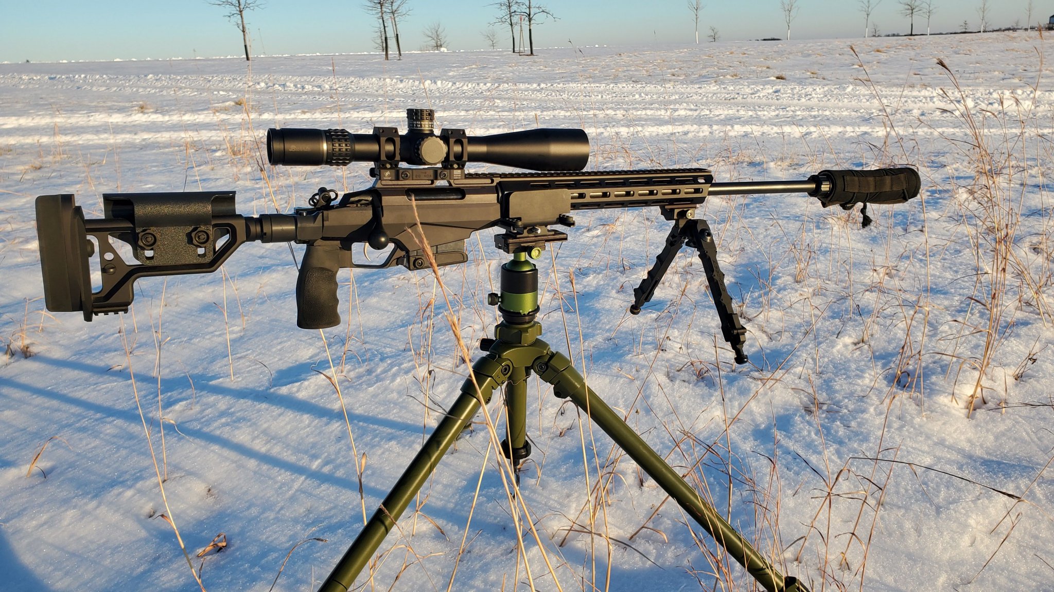

My Tikka T3x KRG BRAVO, vision forend, 26 inch proof comp contour 7 twist chambered in 25 creedmoor, NF ATACR 4-16x50, silencer tech single baffle can, factory trigger with yo Dave spring, sterk swag. It’s a great budget match rifle.

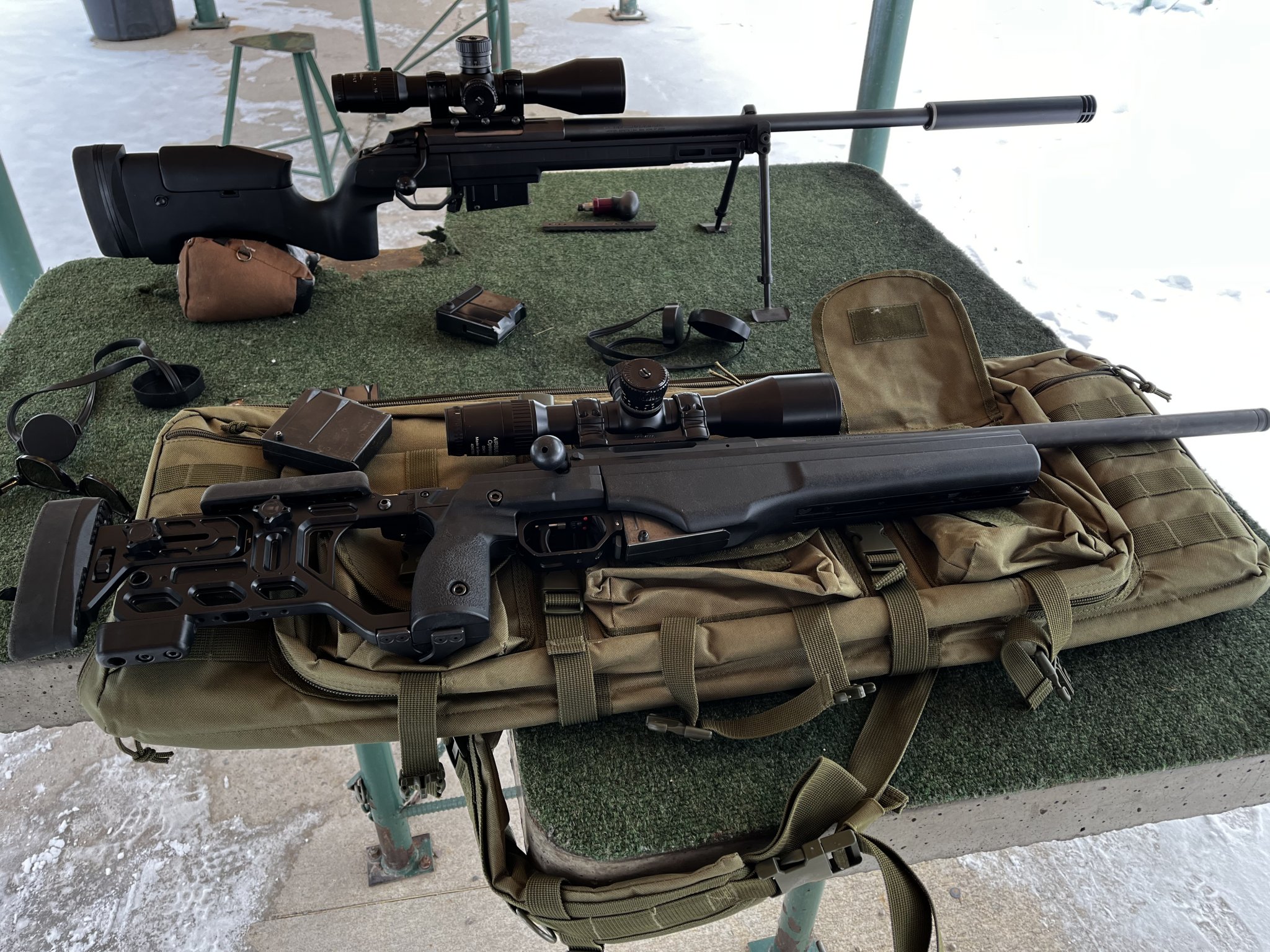

I put a KRG folding buttstock on my TRG then used the leftover TRG buttstock on a Bravo CTR forend with a CTR .223. I had to mill out the TRG buttstock under the tang a little bit to get it to fit flush. The TRG bipod fits on the bravo so it’s a great trainer.
sold my superlight for a 223 CTR. I kept upgrading the lite to get closer and closer to the CTR by threading the barrel, adding a CTR bolt handle, 6-shot varmint mags, etc, but it just made more sense to get the ctr, rather than to keep putting money into the lite.

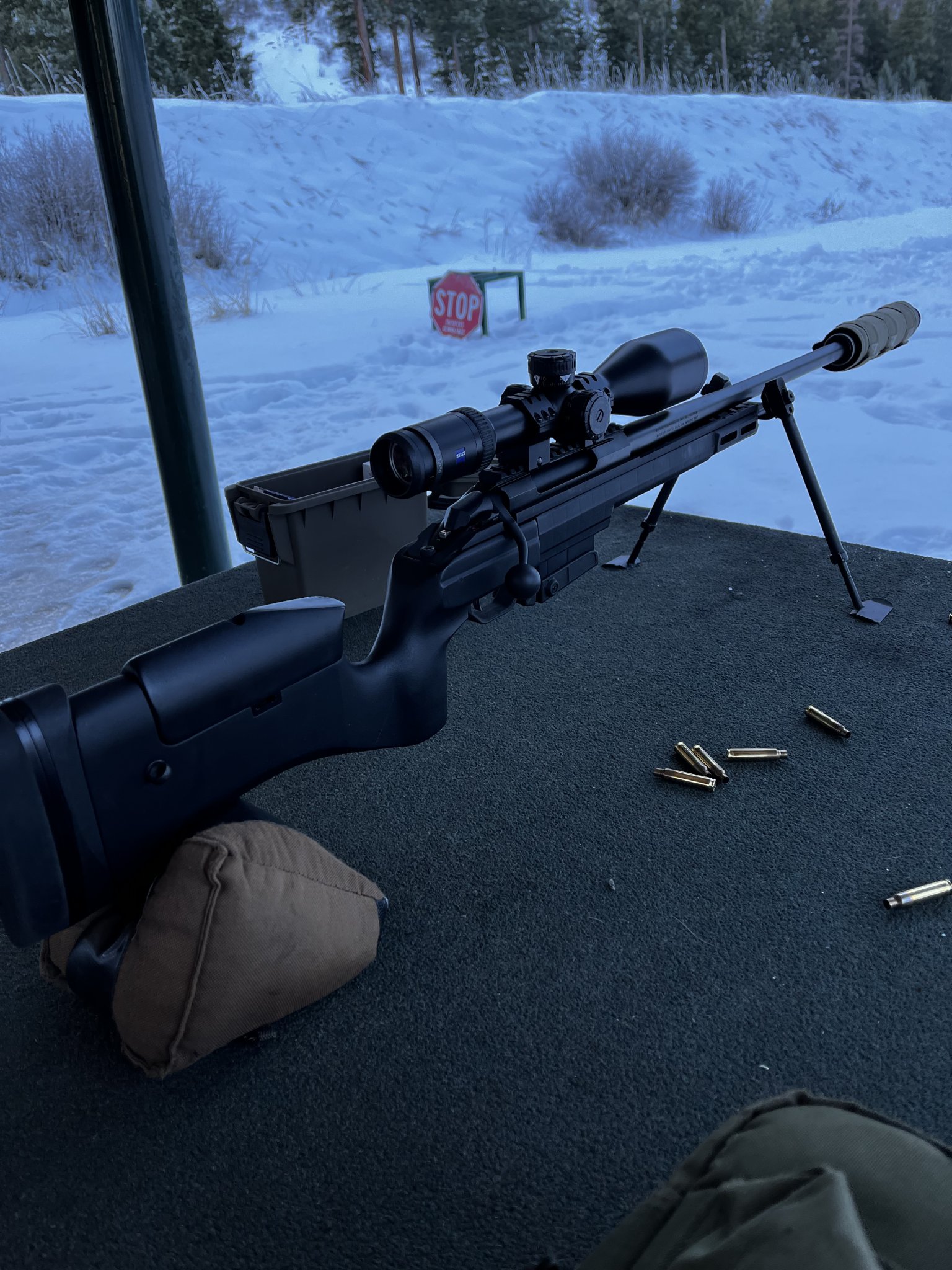

That's what's in my Cadex/Tikka pictured above. Seems to work reliably so far. I'd imagine the KRG chassis should work just fine with it.

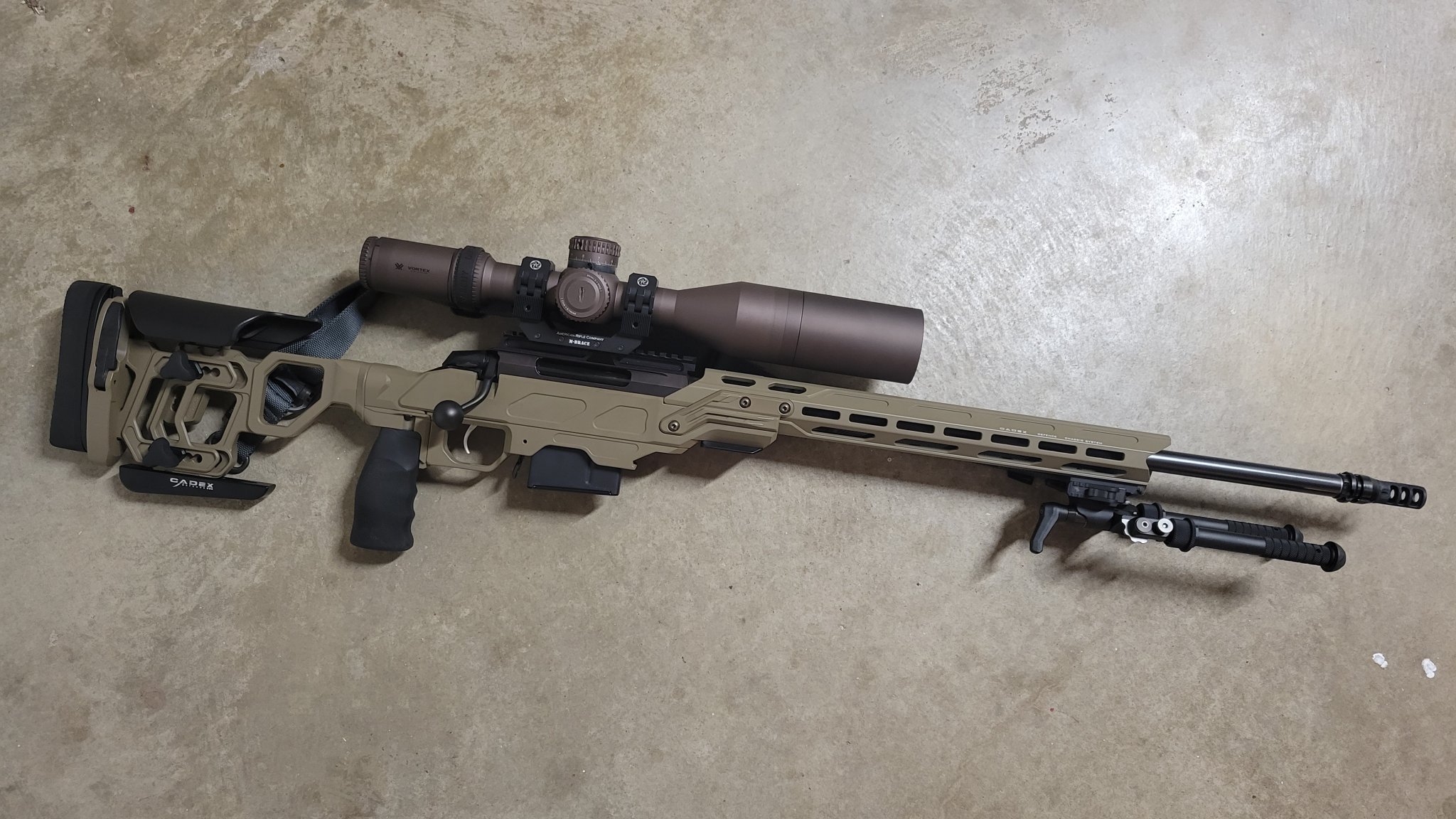

As mentioned, Cadex Field Competition using the AICS mag well insert, Sterk AI style bolt handle, ARC M-brace 1.5" height 30 moa mount, and Ergo 0° grip.
Thanks, gives me a few ideas. Already got a Sterk bolt handle and shroud. Eventually will rebarrel and may try a different chassis then. I don't suppose those ergo gross fit in the factory TAC A1 chassis?
Reactions: cannoncrossfire
It does and it works quite well. I hated the factory Tikka grip so much. The Sterk handle is also nice and im really glad I picked one up. I went to the cadex because I was having rust issues with the OG chassis (all the steel parts on the chassis but not gun). I just got tired dealing it popping back up everytime I took it out in the early morning (condensation). You'll notice the OEM scope base is still on there too. That's because it seems to work fine with other stocks/looks fine and because I'm scared from hearing the horror stories of getting them off 😂

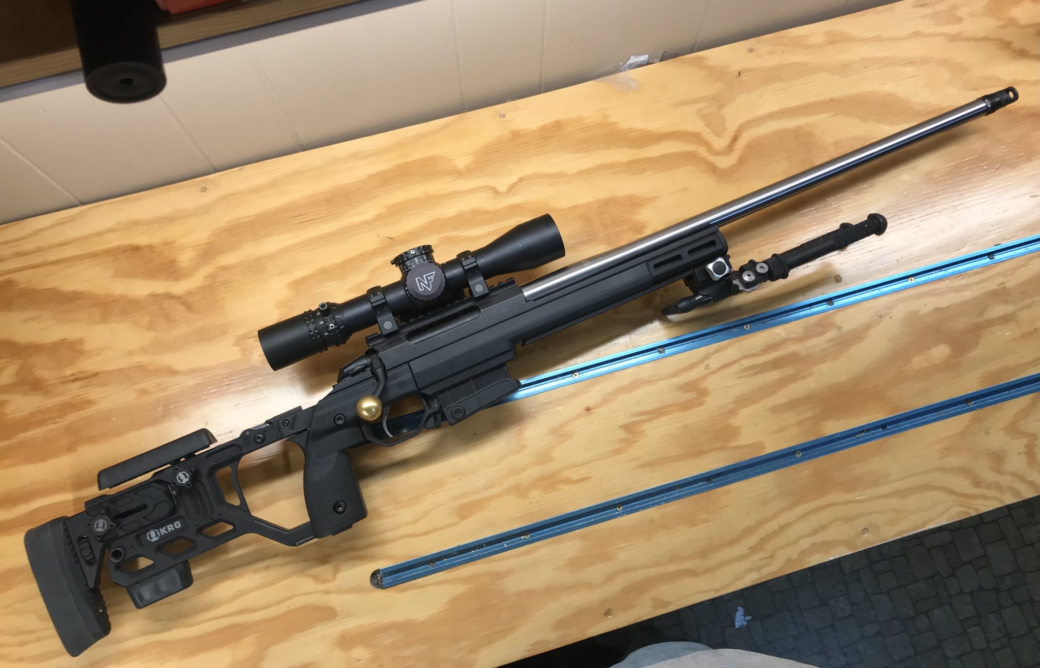

New glass, new barrel, new bipod. Range report later tomorrow View attachment 7806221
Doh.. forgot to update this post.
It's one of the new Osprey prefits from PVA. Shot ~60 rounds through it that weekend. The barrel shot good for being brand new. I'm confident it'll be a consistent 1/2" gun once the barrel gets settled in and I have a new load worked up for it.
What do you mean shot well for being new? Do they not shoot good at first and then improve?
Yeah, probably not worded the best. Still shooting ammo I had loaded for the factory barrel. No break in "procedure", just shooting and the last couple new rifles/barrels I've had shot consitently better after ~100 rounds.
