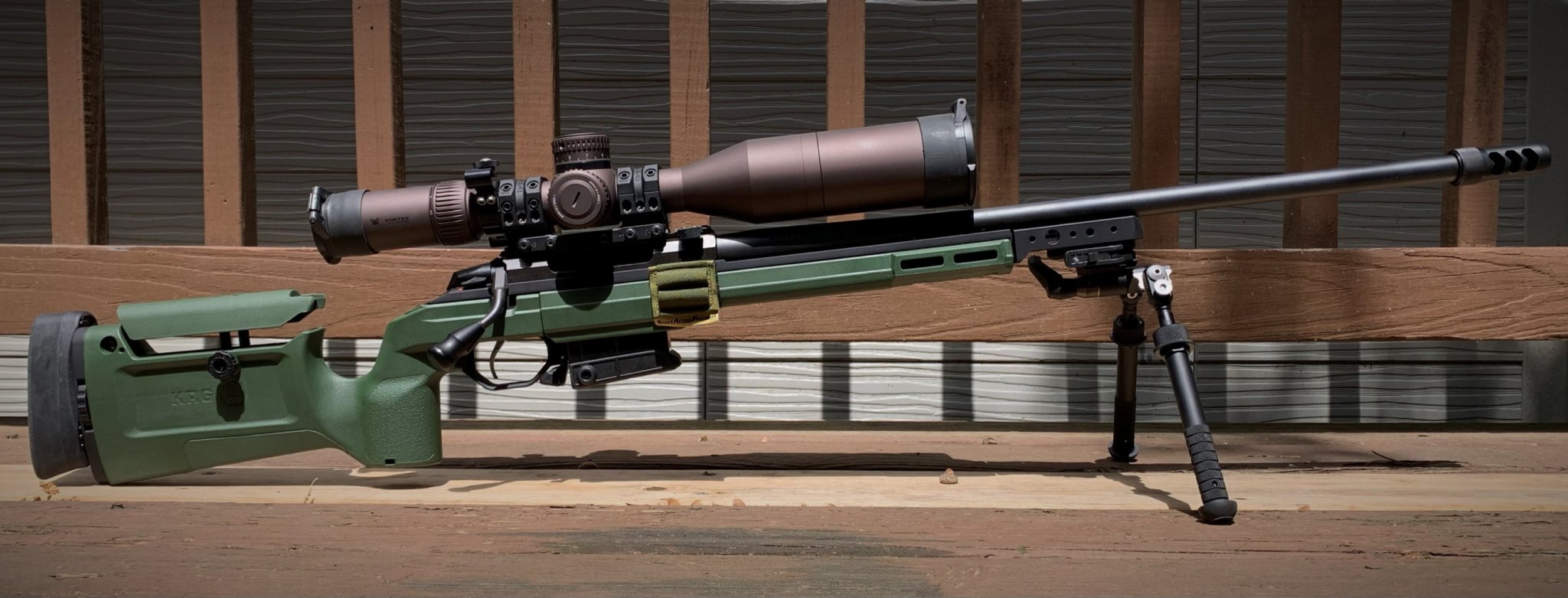

German Gun Stock Reaper or Ranger. My son has a T3 Lite in a Ranger in the first picture.

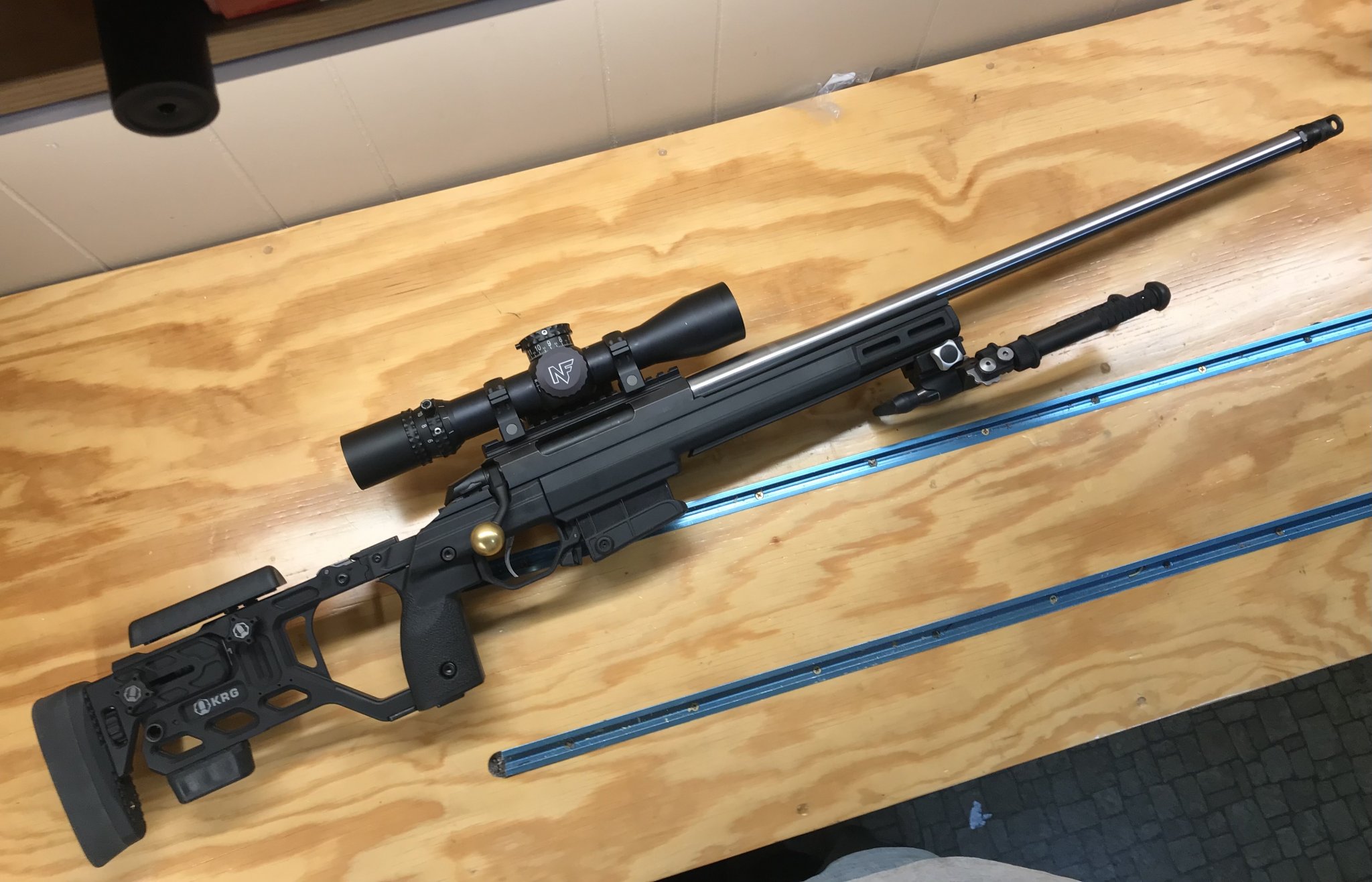

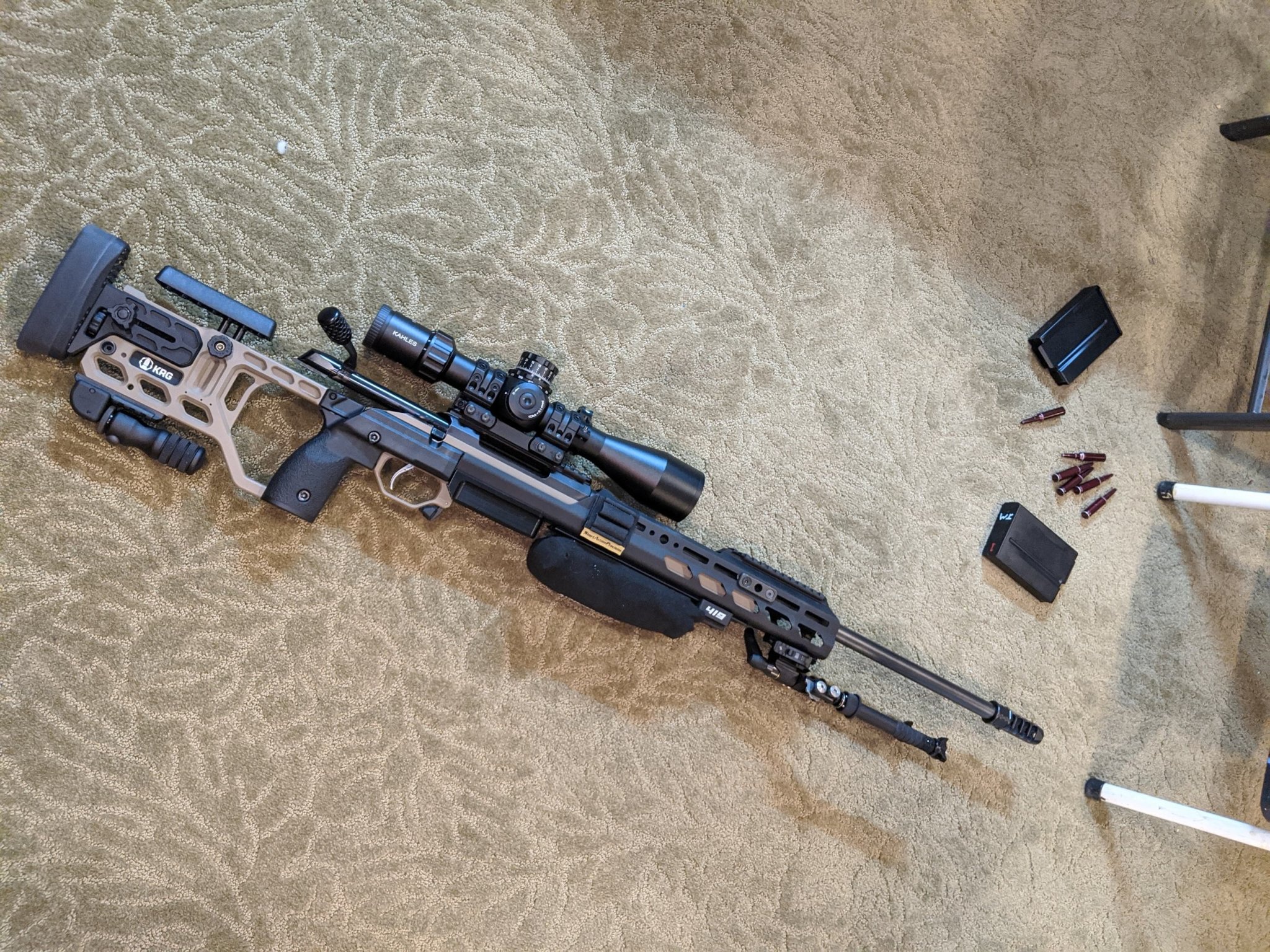

Makeover time.

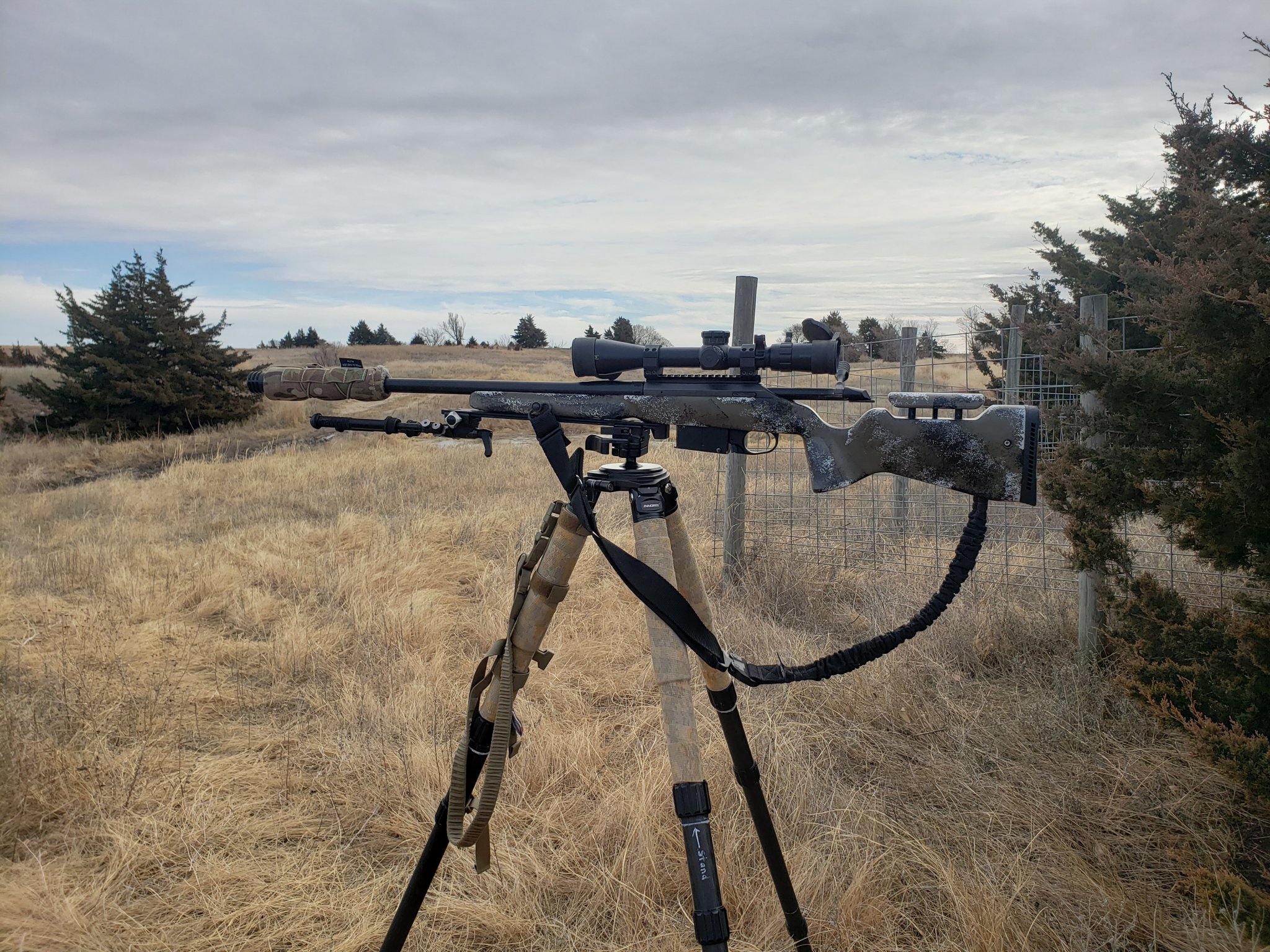

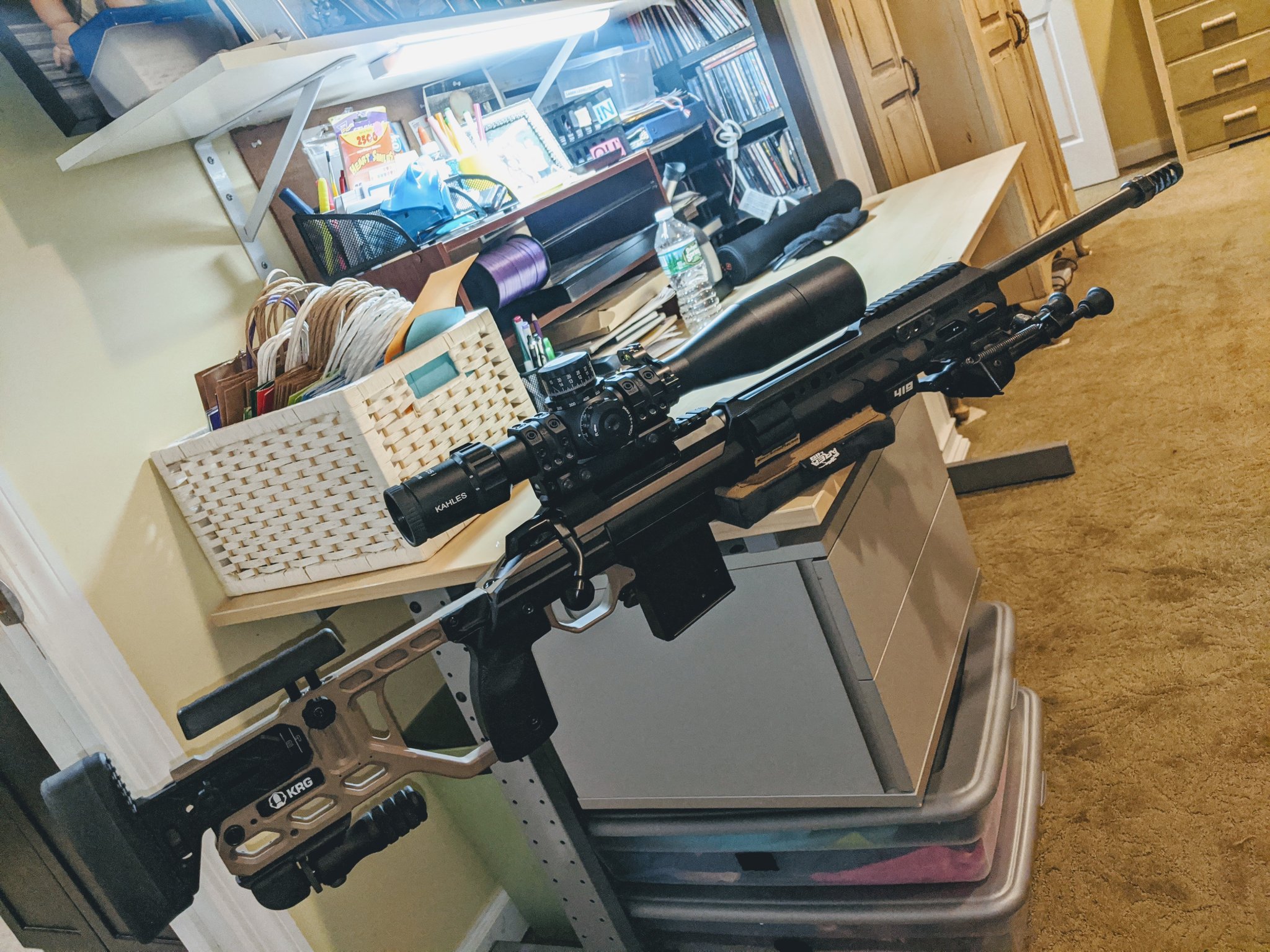

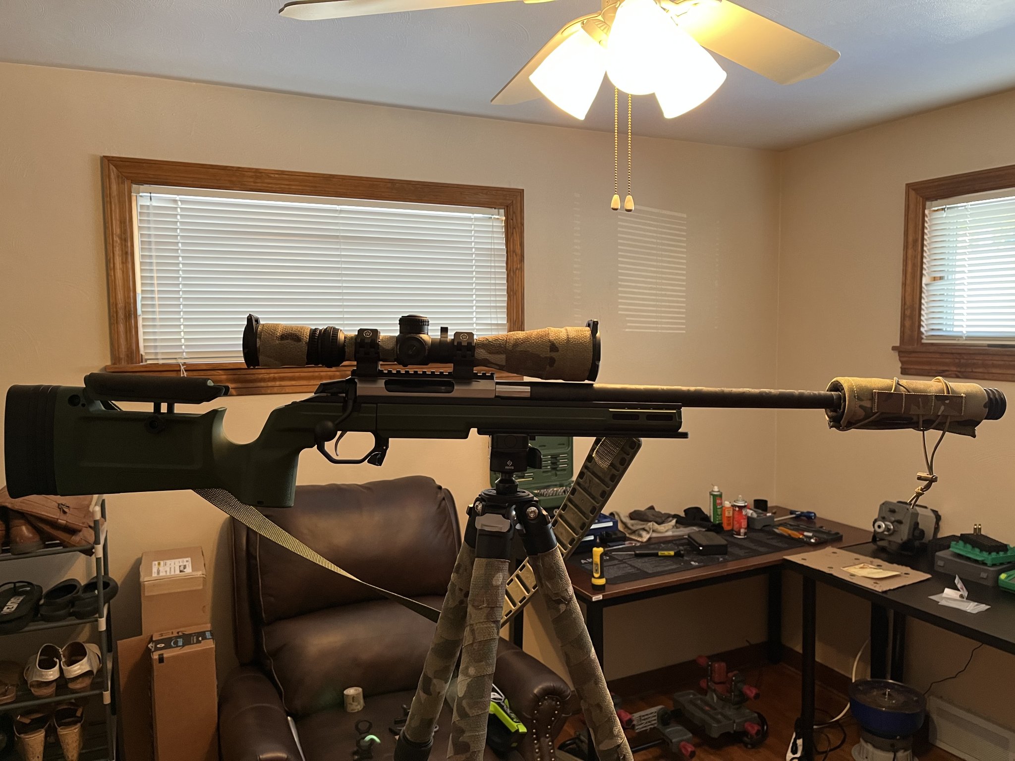

Swapping out my factory 24" CTR barrel for a Bartlein 18.5" 1/8 , 6.5 CM upgrade . Thinking Fluted Sendero (6 flutes) and a Midas 2 stage from KRG.
For ATV hunting in north Texas. Mounting a Bushnell 4.5-18 LRHSi / Spuhr combo as well.
Before pic :

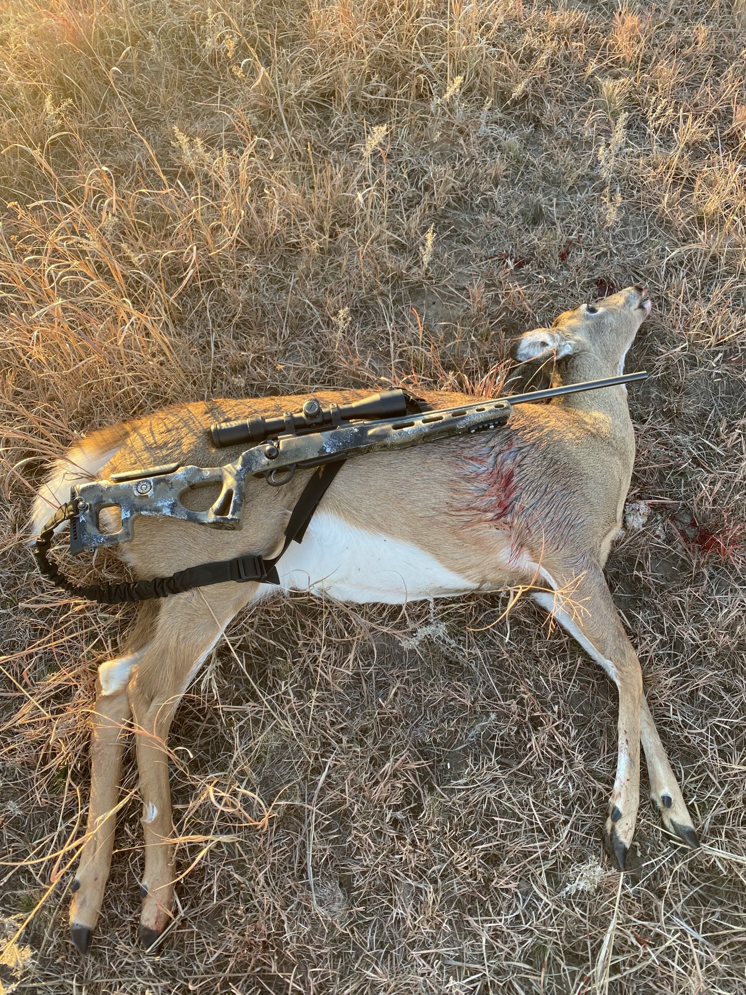

I will always love the krg chassis. Loved mine on my last rifle but sold it for reasons. Now coming back to the bolt boi game and will eventually put a tikka ctr in one.

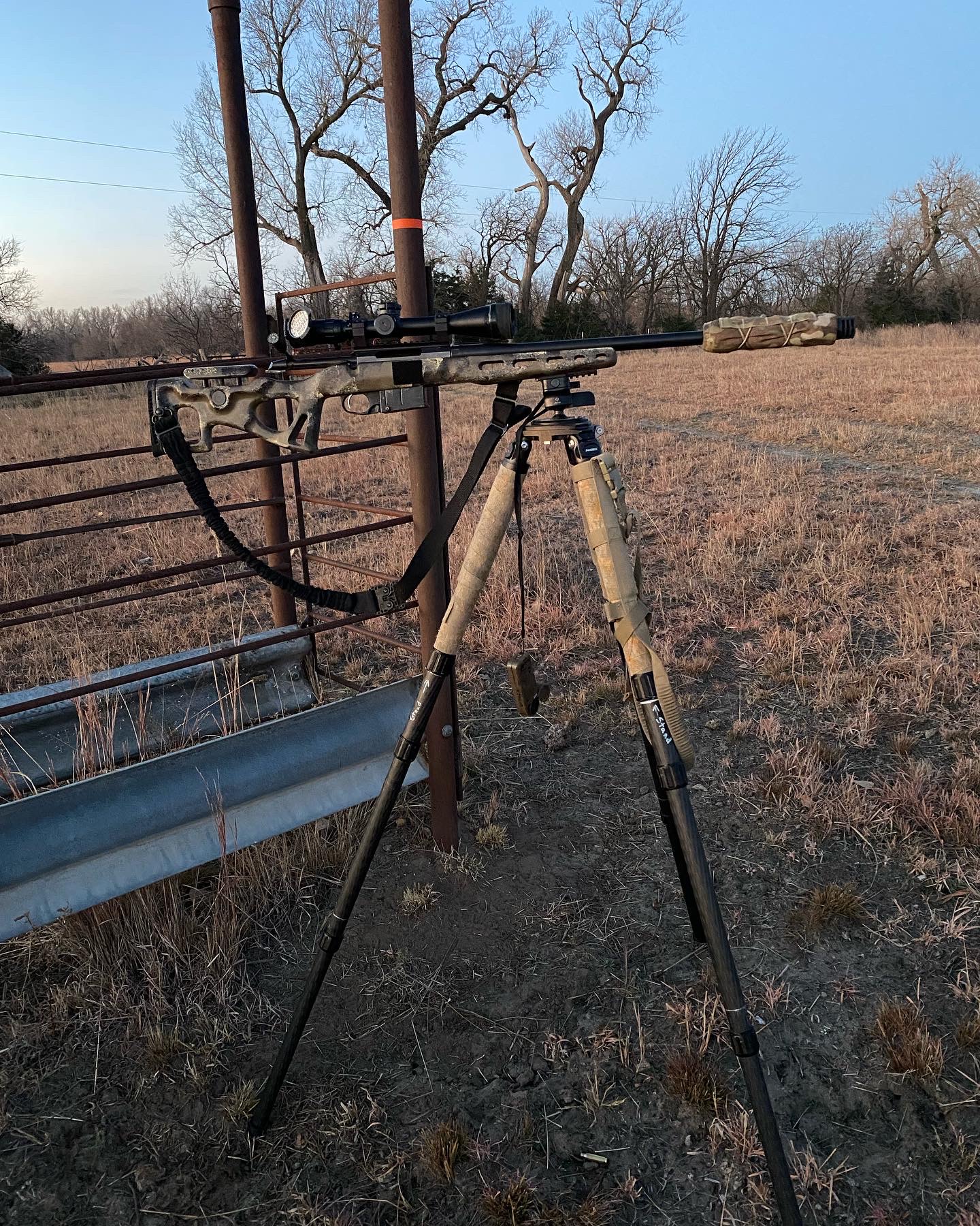

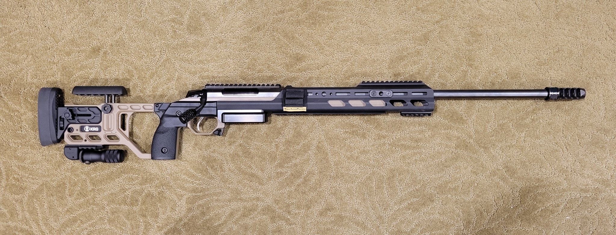

Love my Tikka CTR in it's Bravo chassis. 6.5 creedmoor/24" bbl
I will say this - the enclosed fore end does stiffen up the whole front . I'm waaay more confident in slinging the rifle with the aluminum qd points . The Standard uses a plastic reinforced design with flush cups. I wasn't to keen on those. Adding the Arca rail also gave more options. It does take a crapload of screws to attach everything, but as a whole its stronger than the standard. Since I'm transitioning this girl from competition rig to a long range hunter , wearing gloves is recommended. The aluminum rail mlok ports are slightly prone to scraping if you're slinging it.

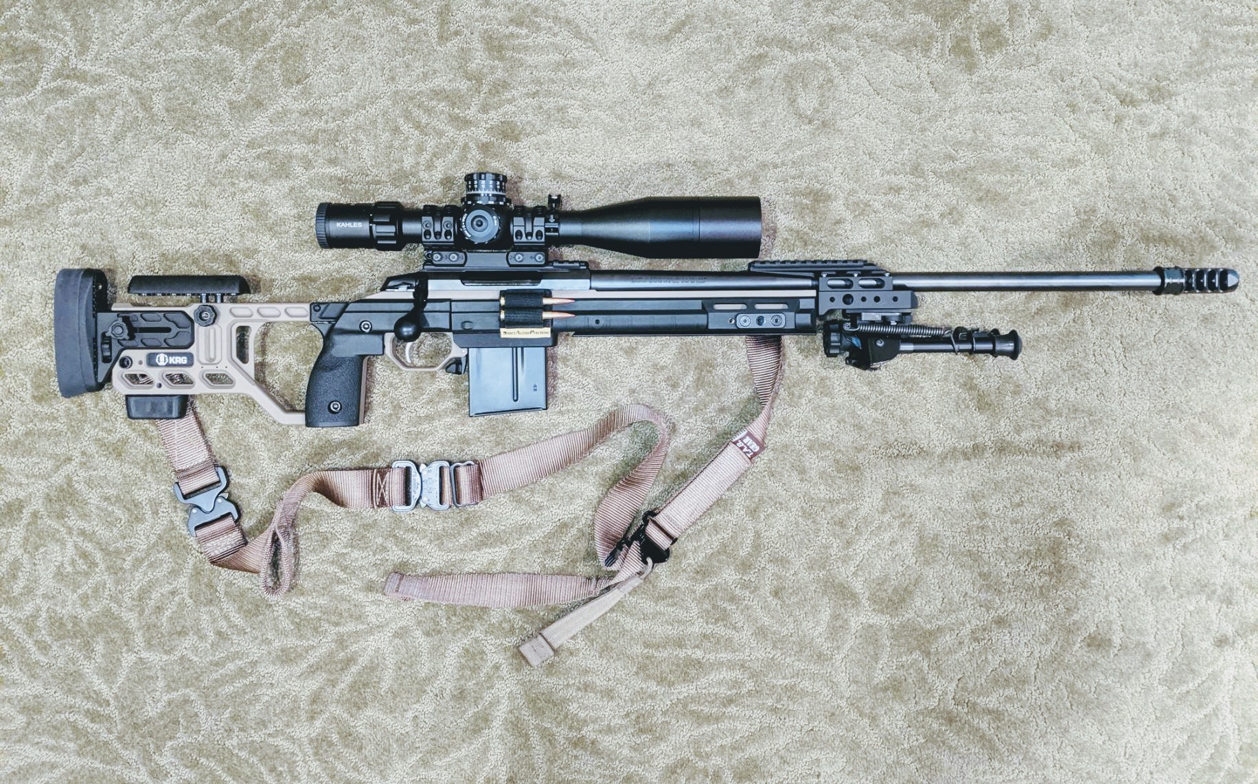

This is for guys looking to upgrade the standard chassis short of going all the way. By adding the NV Bridge and Spigot , I really liked the balance. And the looks. But ultimately as I mentioned, I preferred the sling attachments of the Aluminum piece.

I know other chassis can be customized but i like how the krg can be setup for gamer gun one night and the next night be setup for lighter hunting rig all by just removing some parts. Thats the big appeal for me. I had the xray and even made the krg impact mod thread a couple years ago here on the hide. But this time around my purpose is to develop the skill in prs to take out to hunting. I know not all aspects are transferable but still

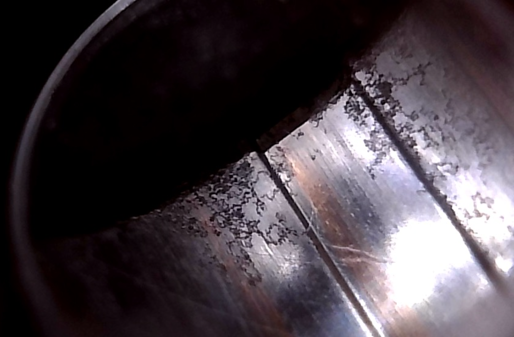

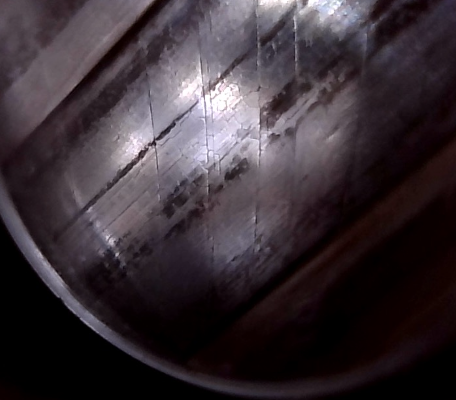

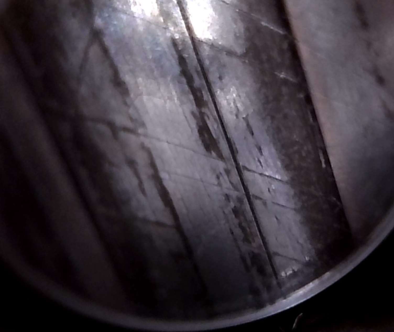

Have a Tikka Tac A1 I got here used on the hide, seller said there was 800 rounds on it. Shoots pretty good. But check out how shit the barrel looks inside. Goes to show you things can look quite scary inside but still perform. You will see fire cracking, and what looks like tooling scars, and some erosion from rust. It's quite crazy.
My 260rem CTR had gone well over 4K thru the barrel, stil shoot´s .3MOA.
Your barrel is like new, to compared to mine :)
My tac A1 barrel has alot of fire cracking also. Those marks are from the hammer forging u can probably see other small light criss cross marks in the barrel. Most aren't that defined but if it shoots that good keep it.
Hammer forging, I guess that makes sense.
Yeah agreed, it's a keeper, and actually my second Tac A1, crazy.. but when I do my thing most groups are really good.

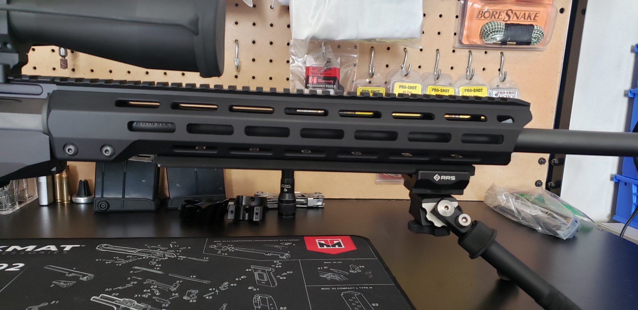

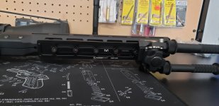

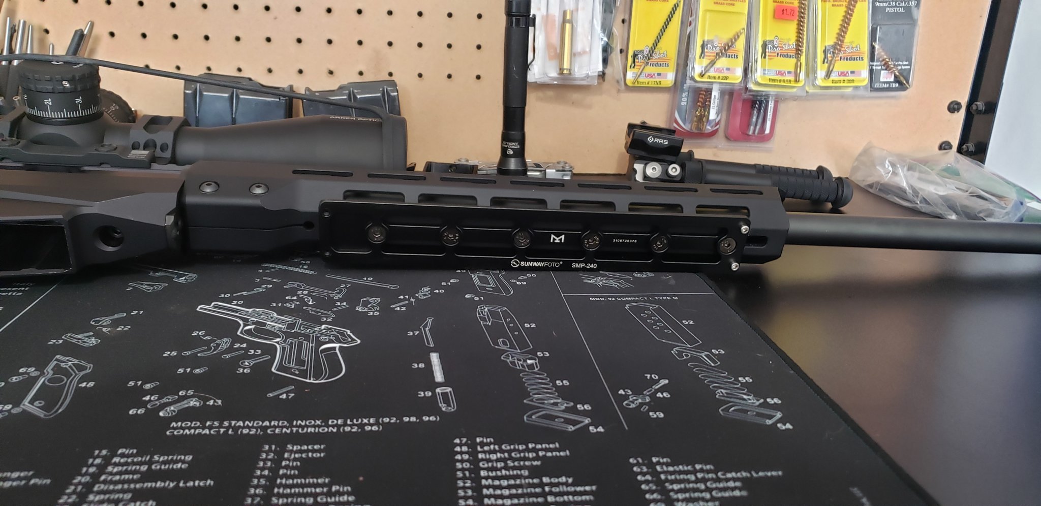

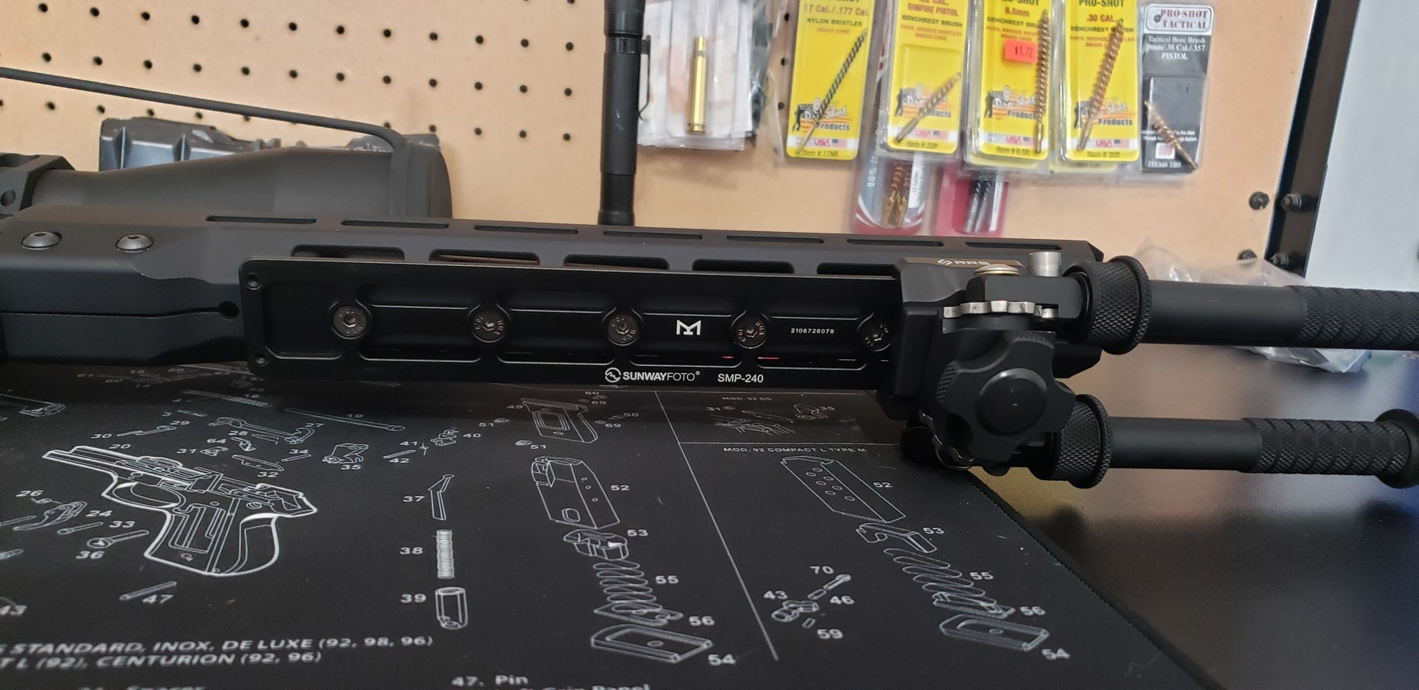

If anyone has ever wanted to try one of the cheap M lok arca rails on Amazon just wanted to let u know they work very good. I was looking for a cheap option and figured it's worth a try. It fits great with my RRS arca clamp on my atlas. I did put it on the mill and machine off one of the M lol nubs sticking up so I could slide it back a bit more to give it a better balance point on my tripod. It came out very solid.
Big fan of annex defense ARCA rails. https://annexdefense.com/search.php?search_query=arca&section=product
Cheap and US made according to them, with oem magpul hardware. Certainly not as long as that rail however. I have a small magpul arca rail on my tikka, but have 2 of their rails on my ARs.
