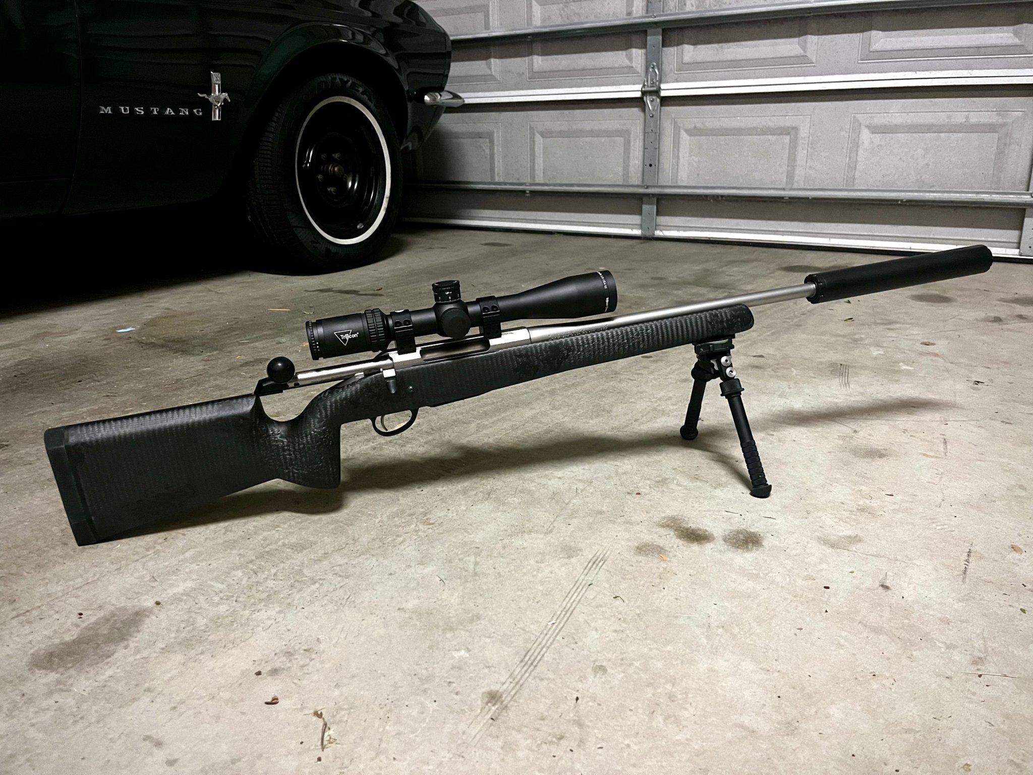

I opened up the mag well on a T3x sporter stock to land CTR bottom metal, and have the best of both worlds. I had to use washers to get the spacing right (that is make the BM stand away from the stock more) because the plastic stuff is thicker than the metal CTR BM.
I cut a factory stainless sporter in 308 to 19”, threaded it 5/8 x 24, and installed a brake/adapter for a can.
When I don’t want or need the 10 round mags, or just want lighter weight, I put it in a regular T3x stock with the plastic mags and go hunt.
I also pulled a few CTR cheek pieces, and put one on the sporter stock with CTR bottom metal, and one on the sporter stock with plastic factory bottom “metal” and mag. I use Sportsmatch medium 30mm rings, and the CTR cheek pieces align my eye to the scope perfectly.
I put a Karsten Kydex adjustable saddle cheek piece on my actual CTR stock.

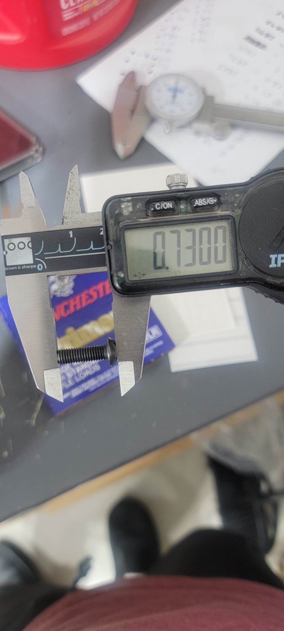

Hi,
Well it happened. Managed to destroy my screws. Before I get them out I'd like to buy replacement screws. I don't like the idea of Allen screws for obvious reasons, does anybody have the specs for these two screws so I can buy ones with a torx head? (The ones that attach the barrel nut to the stock)
Much appreciated!

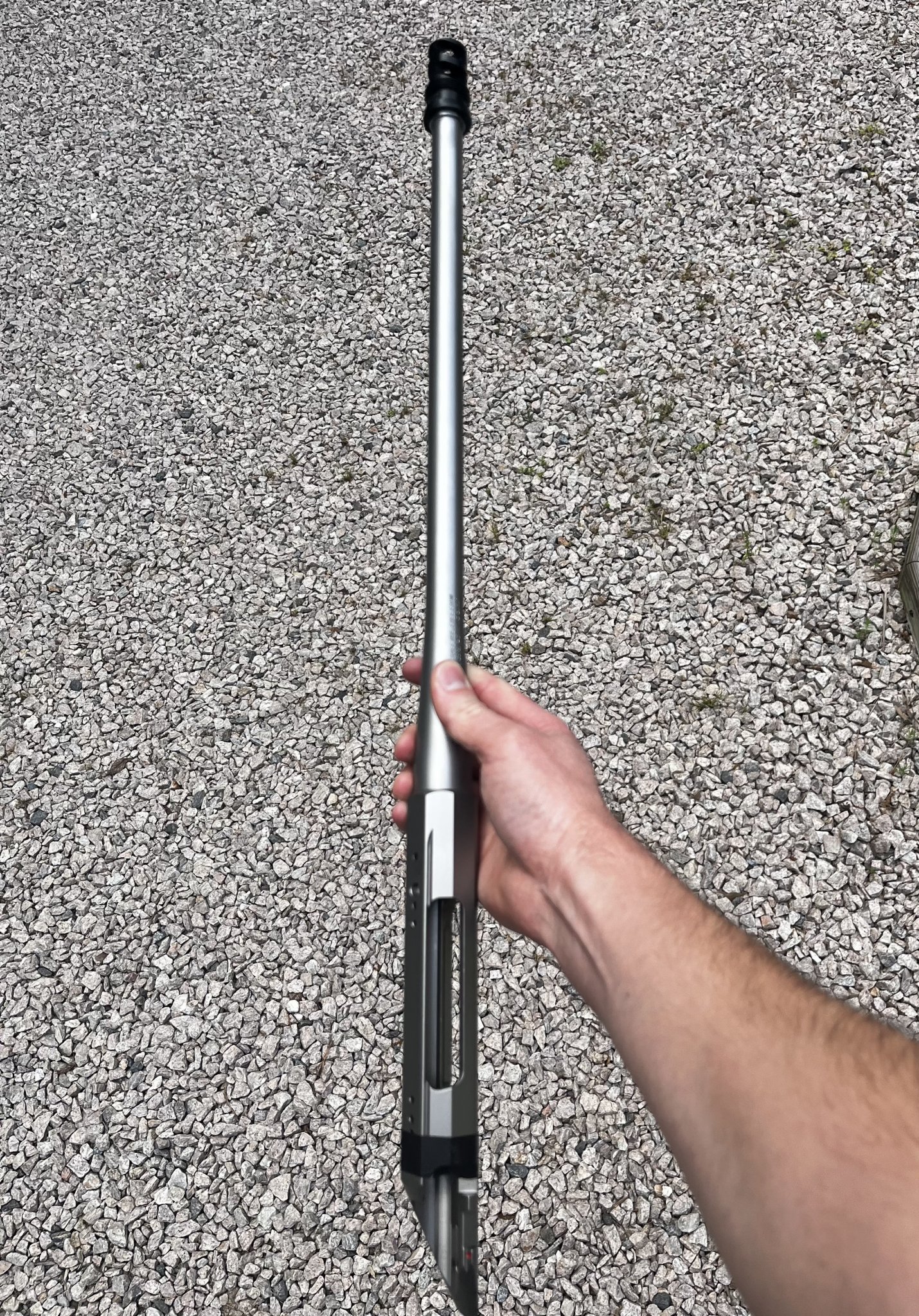

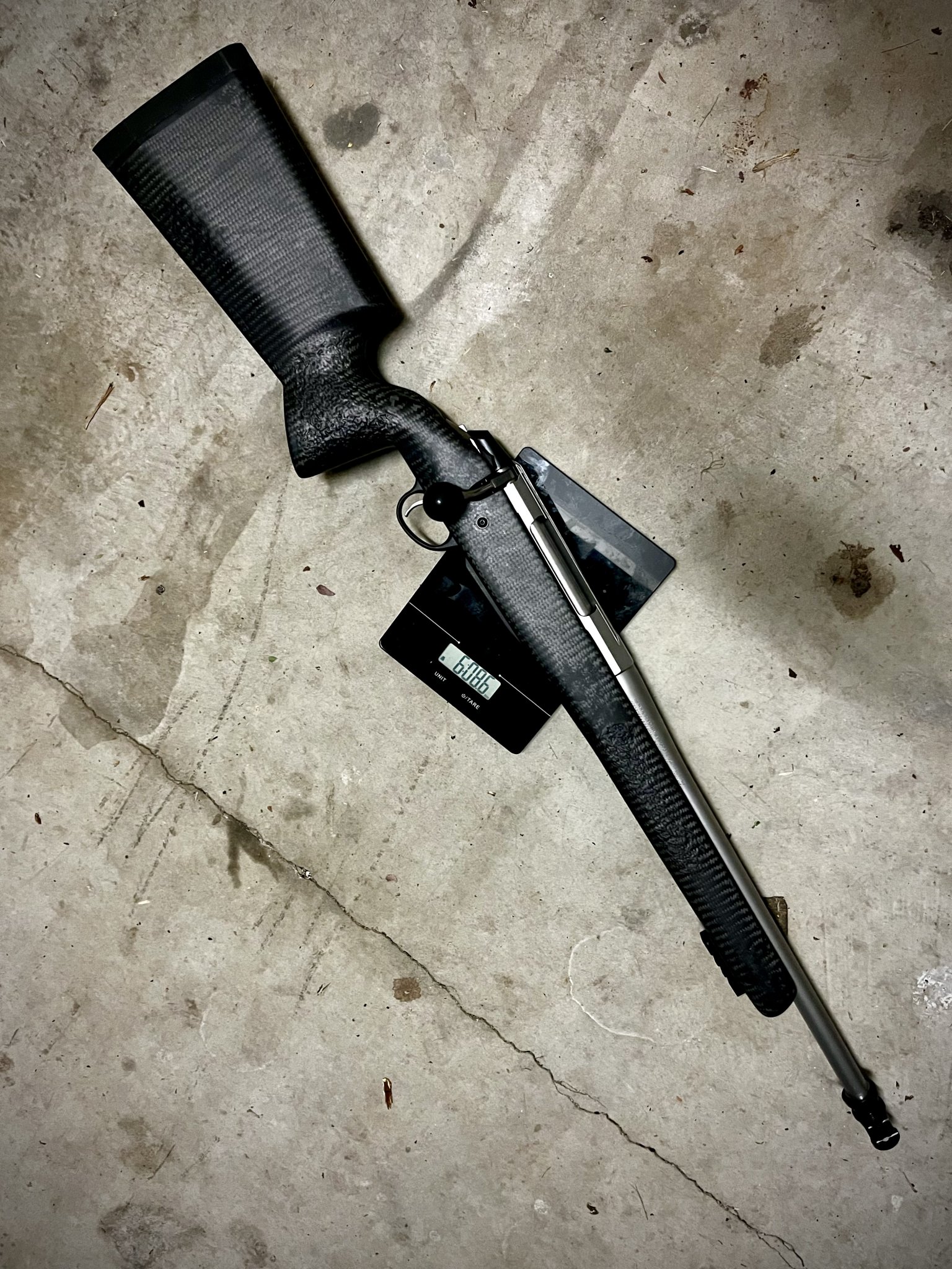

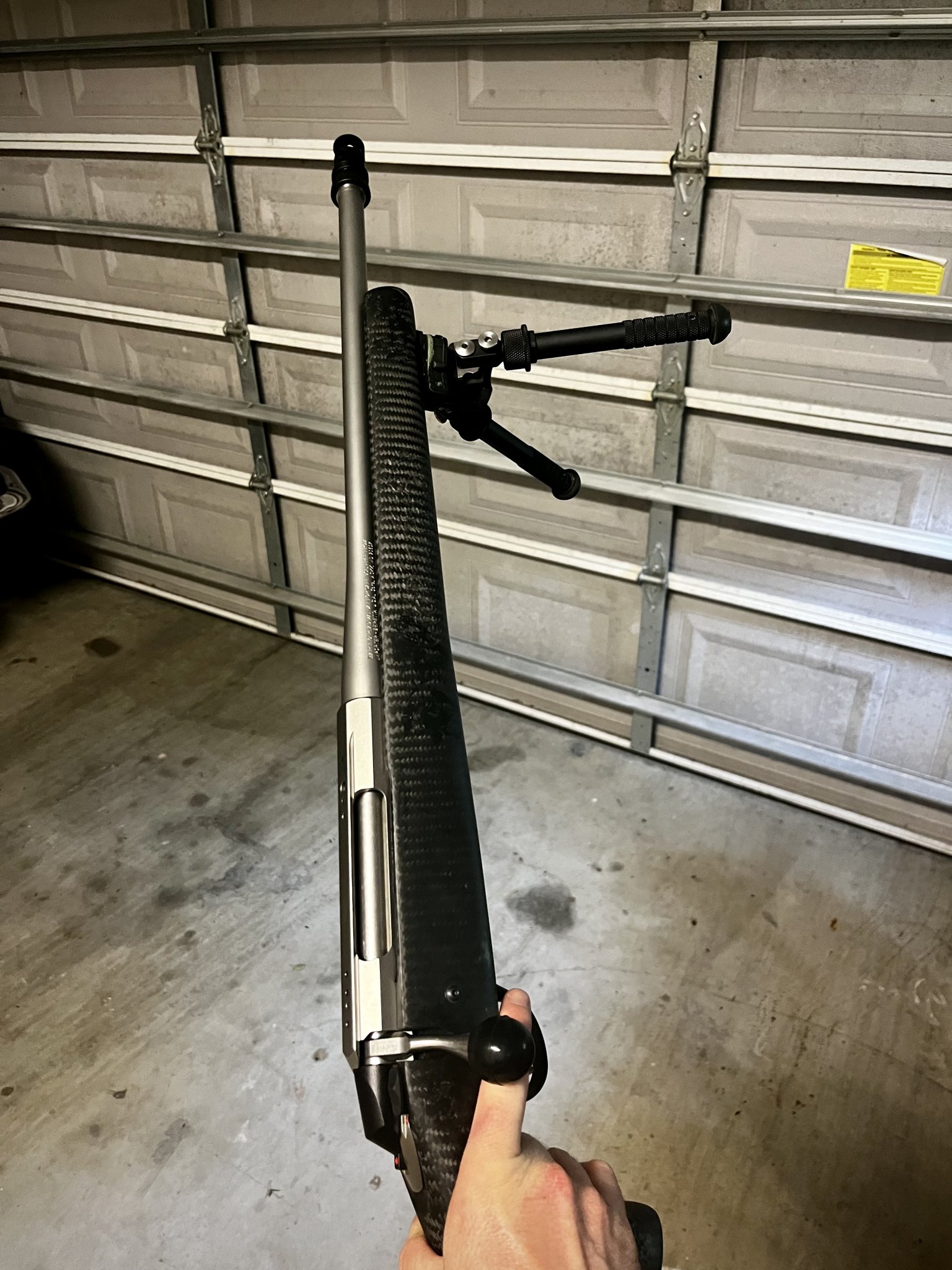

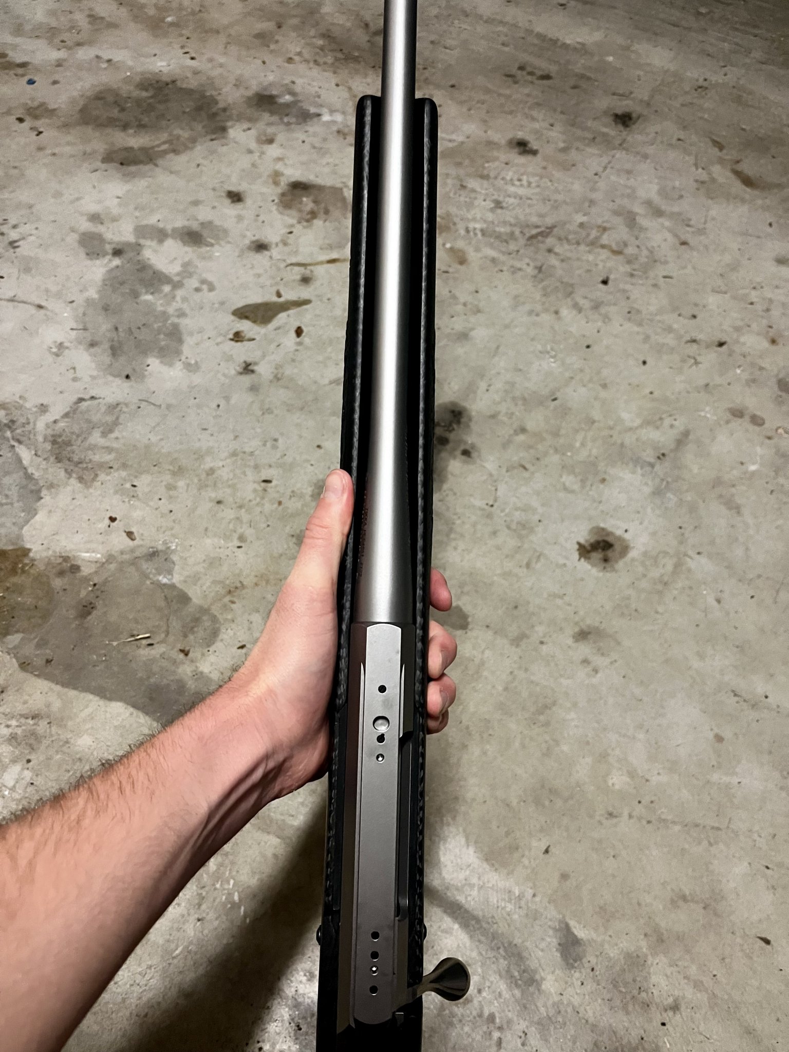

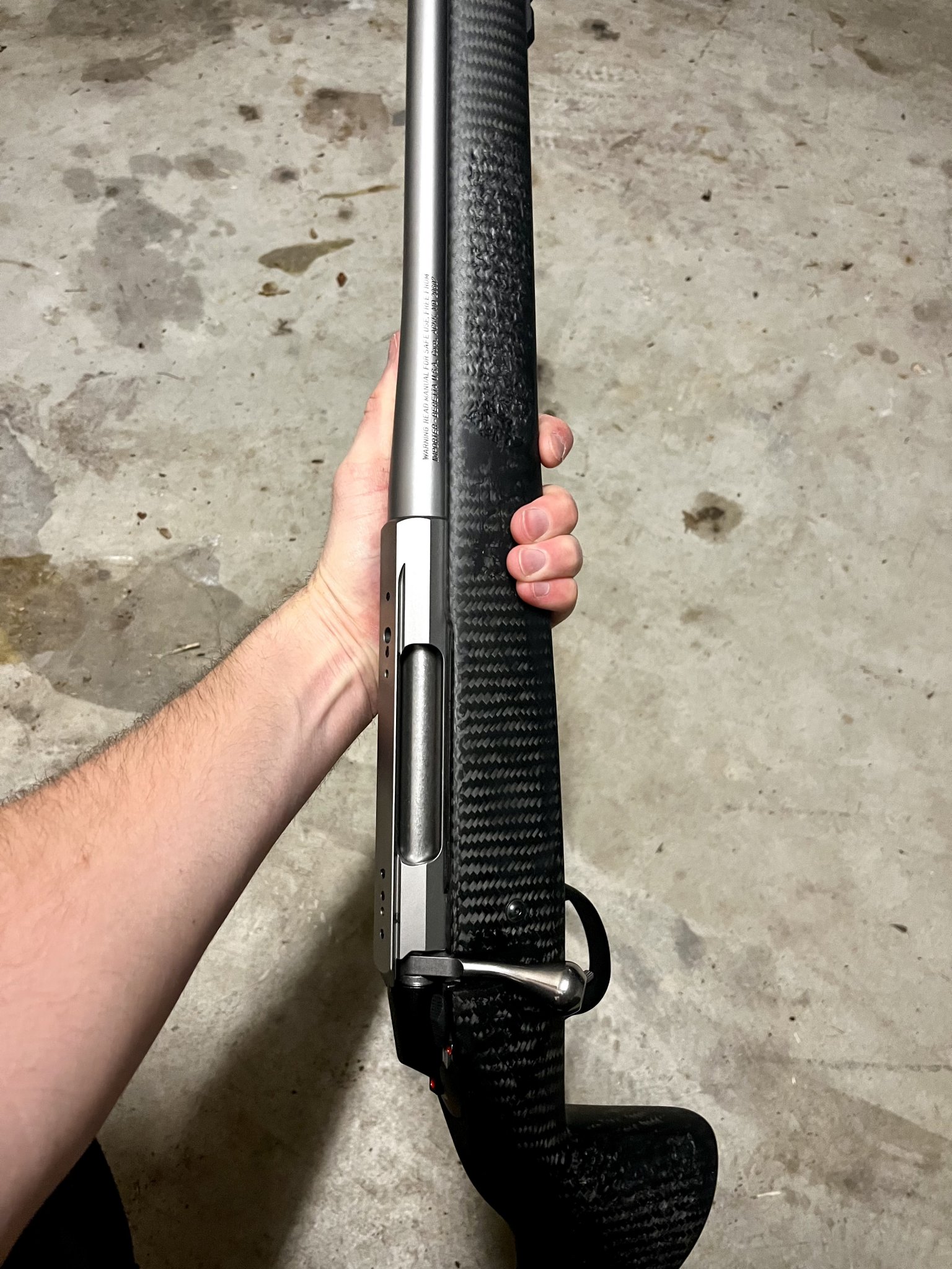

That's pretty much exactly what I'm thinking about doing with a 30-06 T3X SS. How does it balance with and without the bipod and what does your can weigh?
My can weighs 19 ounces, (need to clean it, that’s 3 ounces over new)
Balances right at the front/shoulder of the action with the can on without the bipod. Bipod pushes that point forward another inch or so.
In a perfect world with a 14-15 ounce can I think it would balance perfectly for me for a stalking rifle. As is it’s a good combo rifle with a touch more nose weight for a bipod. From feel, I think it will be good to go out of a tree stand which will be mostly where it lives.
